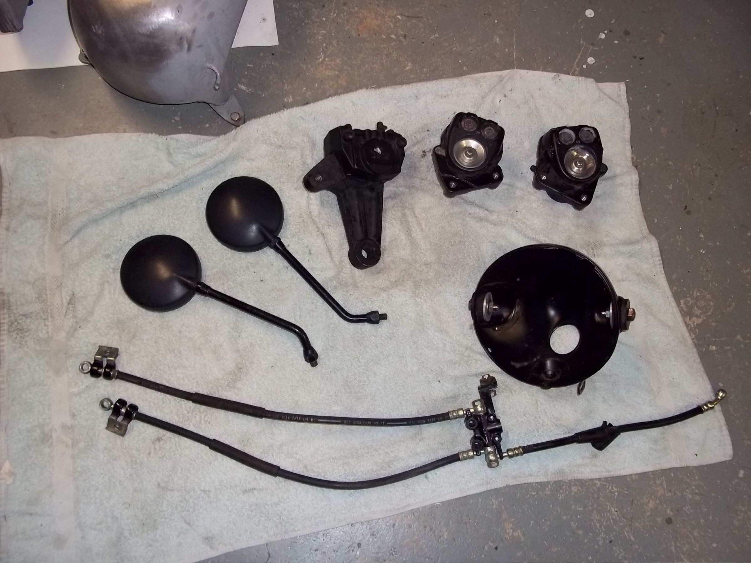

Thanks. I am good at following directions and patient. That goes a long way at engine work. I am getting somethings back together on the chassis. Cleaned up wire loom and will hit all connections with Deoxit. I put some paint on the valve cover. The paint is semi-gloss so it should look okay with the engine. Paint there is good, I did a few touch ups on the cases, but really the head and the block were fine for me. It would be nice to paint it all but I am lazy when it comes to painting. I am out of town a lot this week. The parts should all be here when I return. The truck is coming for the 550 tomorrow.
A few pics.
R
