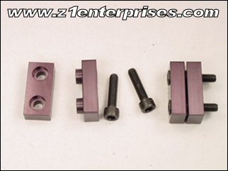

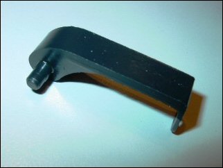

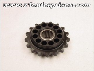

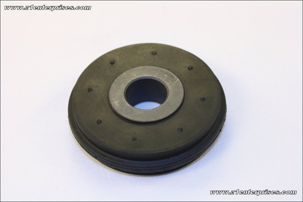

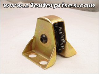

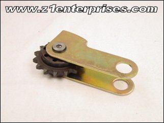

Hello all, I moved further into disassembly tonight. Head is off and block removed. With the broken starter bolt there is no way to split the cases without fixing that (two case bolt under the starter. Not sure a split is needed anyway. It looks clean in there and no adverse rod play or signs of wear that I can see. Pistons and rings look fine, the gap measures out and they are in spec. There is some cylinder bore scoring but not bad, I think a rehone will be fine. The guide rollers look somewhat worn but not sure if they need to be replaced. Probably should while there. All the rubber dampers were hard as porcelain. I cannot get the clutch cover off for the life of me, There is no decent place to tap and I have a suction cup and slide hammer on it with nor results. Any ideas? The clutch was fine and it ran thru all gears so maybe I will just button up. Anyway lots to go. Things will slow down some as I have some travelling ahead for both pleasure and business. Some pics.

You should take the starter out and fix the bolt. Replace the rollers with Liska's and the rubber ones. Z1E has them. You won't regret it.
