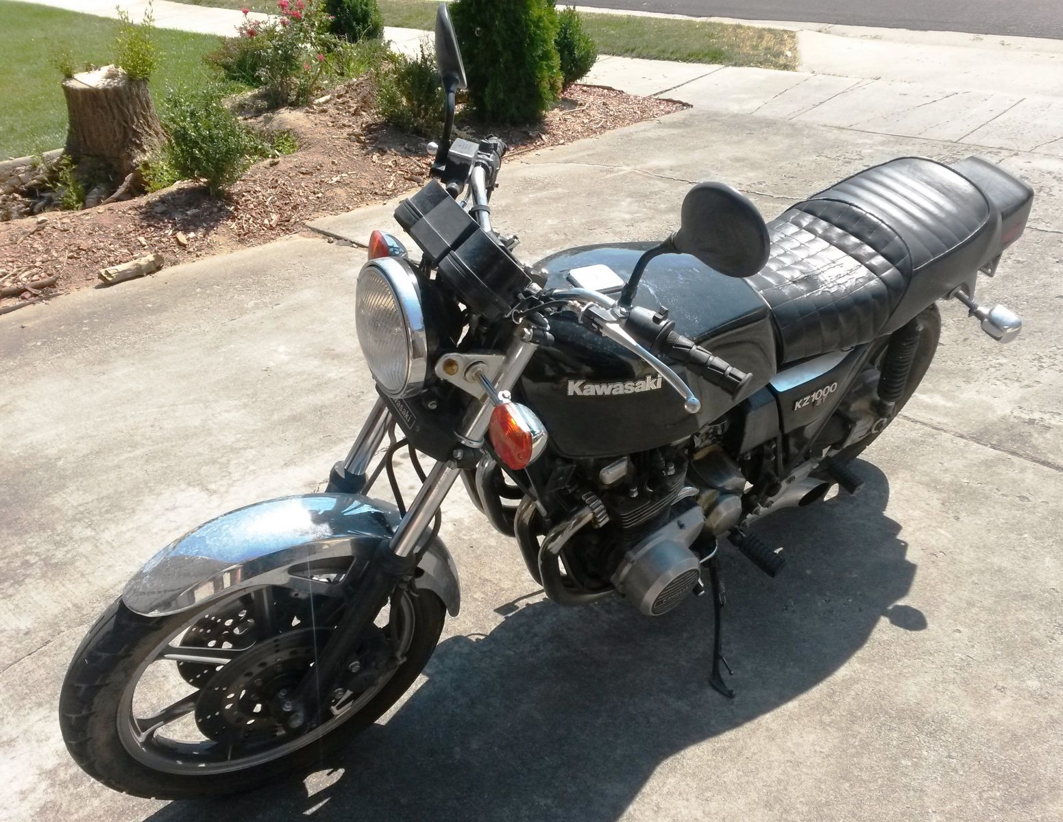

OK, beautiful sunny day. Here's some clear pics of the Good, Bad......

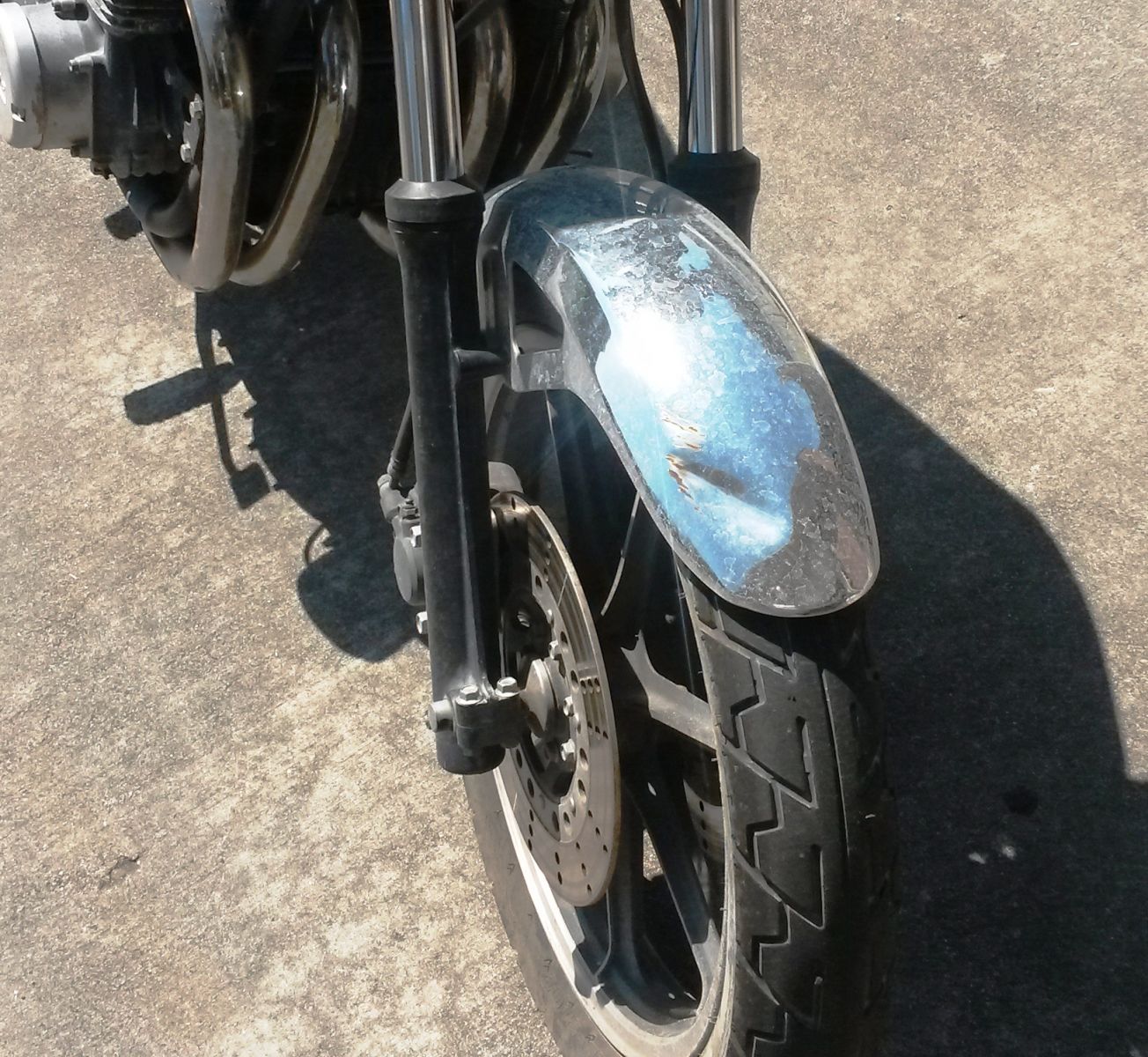

Big ding in the fender.

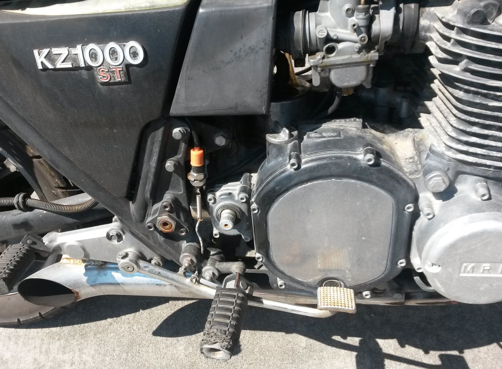

The worst part about it. I see at least a replacement head, maybe cylinder block in the distant future. I think I'd rather remove whatever crap this is rather than look at it.
What ever caused the above apparently took the kick start with it.

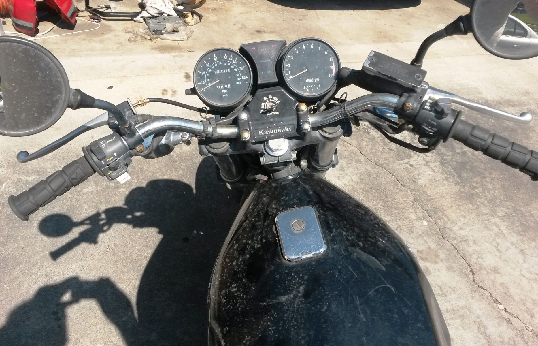

I thought at first the bars were bent but when i took this pic I realized it just wasn't centered. :laugh:

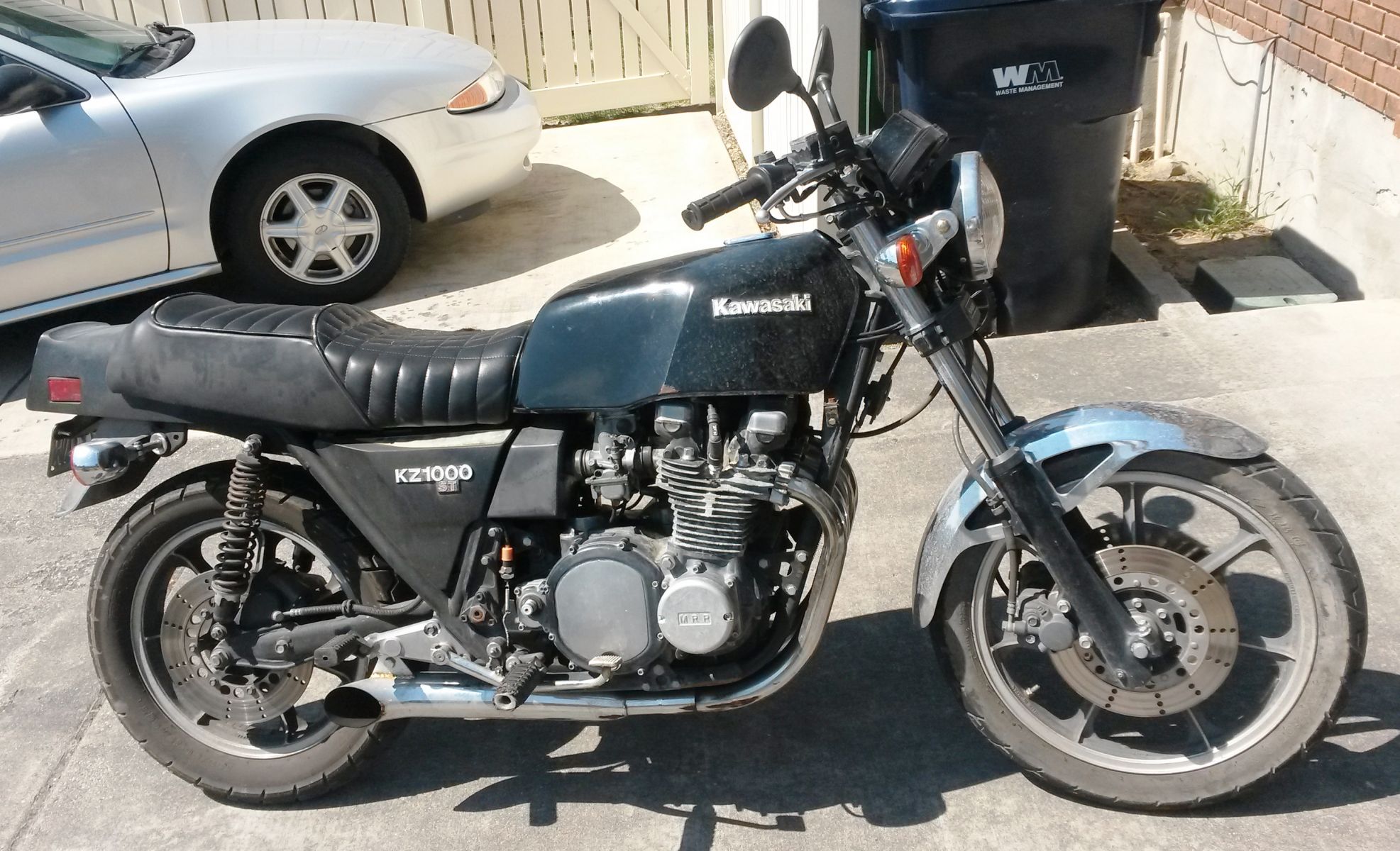

It starts cold. Which is a plus, The air box and intake boots are leaking which caused some awesome backfires last time i started it and let it warm up. I'm hunting down the right stuff for that right now. BTW could someone ID these carbs so I can get the correct kits for them?
The seller said the pipes were straight but they do have baffles in them so I'll leave them be for now. Some one put a K&N in the airbox which I don't think I'll keep.
Any one in the UK have or know where I can get a speedo for this thing? I'll bet it likes going more than 85 mph on regular basis or at least it will.

That looks like a good project. I would suspect the weak running is, as you said, from carbs and valve adjustment, but also probably from the open pipes. They rob low and midrange power.I have two bikes that are mislabeled on the title even though the vin is correct. I wouldn't worry about it, as long as the vin matches up.
That ignition cover is sweet. is there some trick ignition behind that?
I would take some measurements and see if the frame is bent before you too far into it.

If you remove the handlebars and lay them on a flat surface you be able to see if they are bent. If they are, you can straighten them without special equipment. I had a spare handlebar that was a little out of whack. To straighten it I placed one end of it between two pieces of 3/4" plywood (to protect the surface), laid it in my driveway, and parked the front wheel of my truck on the top piece of plywood. That held the bar steady and enabled me to grab the other end and bend back into shape. Granted, it did not need a lot of adjustment, but if yours are bent I suspect they are bent very little at all since they look pretty good. It took me a couple turns of bending a little, checking on a flat surface, bending a little, etc., but after a few tries I got the handlebars perfectly aligned. Ed
- GPzMOD750
- Posts: 1365
- Thanks: 148
Re: KZ problem developing! DAMNIT!
12 Sep 2015 14:55I centered them up and they are still slightly bent. I have a super bike bars that I was going to put on the GPz. I think drag bars would be more to my liking on the GPz anyway so I'll use them on this one.650ed wrote: If you remove the handlebars and lay them on a flat surface you be able to see if they are bent. If they are, you can straighten them without special equipment. I had a spare handlebar that was a little out of whack. To straighten it I placed one end of it between two pieces of 3/4" plywood (to protect the surface), laid it in my driveway, and parked the front wheel of my truck on the top piece of plywood. That held the bar steady and enabled me to grab the other end and bend back into shape. Granted, it did not need a lot of adjustment, but if yours are bent I suspect they are bent very little at all since they look pretty good. It took me a couple turns of bending a little, checking on a flat surface, bending a little, etc., but after a few tries I got the handlebars perfectly aligned. Ed

12 Sep 2015 15:02i just took it around the block and it idles way high and backfires like crazy with the choke full open. if you give a little choke it settles down. i pulled that cover an it just looks like a factory set up to me unless it's supposed to have points, I just think that cover replaced the buggered up factory one. it doesn't fit quite right nd whoever fitted it bent the screws to get it to seat.DoctoRot wrote: That looks like a good project. I would suspect the weak running is, as you said, from carbs and valve adjustment, but also probably from the open pipes. They rob low and midrange power.I have two bikes that are mislabeled on the title even though the vin is correct. I wouldn't worry about it, as long as the vin matches up.

Sounds like its running lean. It probably was not rejected for the open pipes
