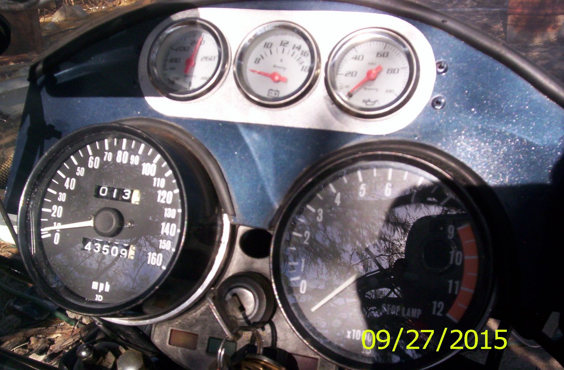

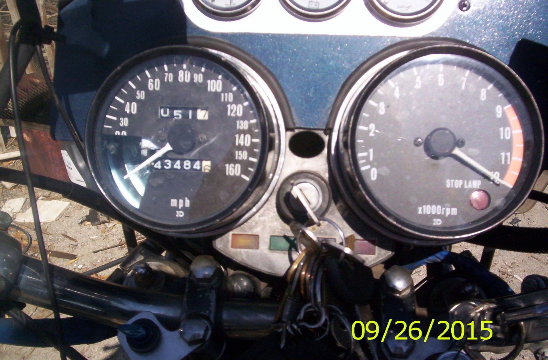

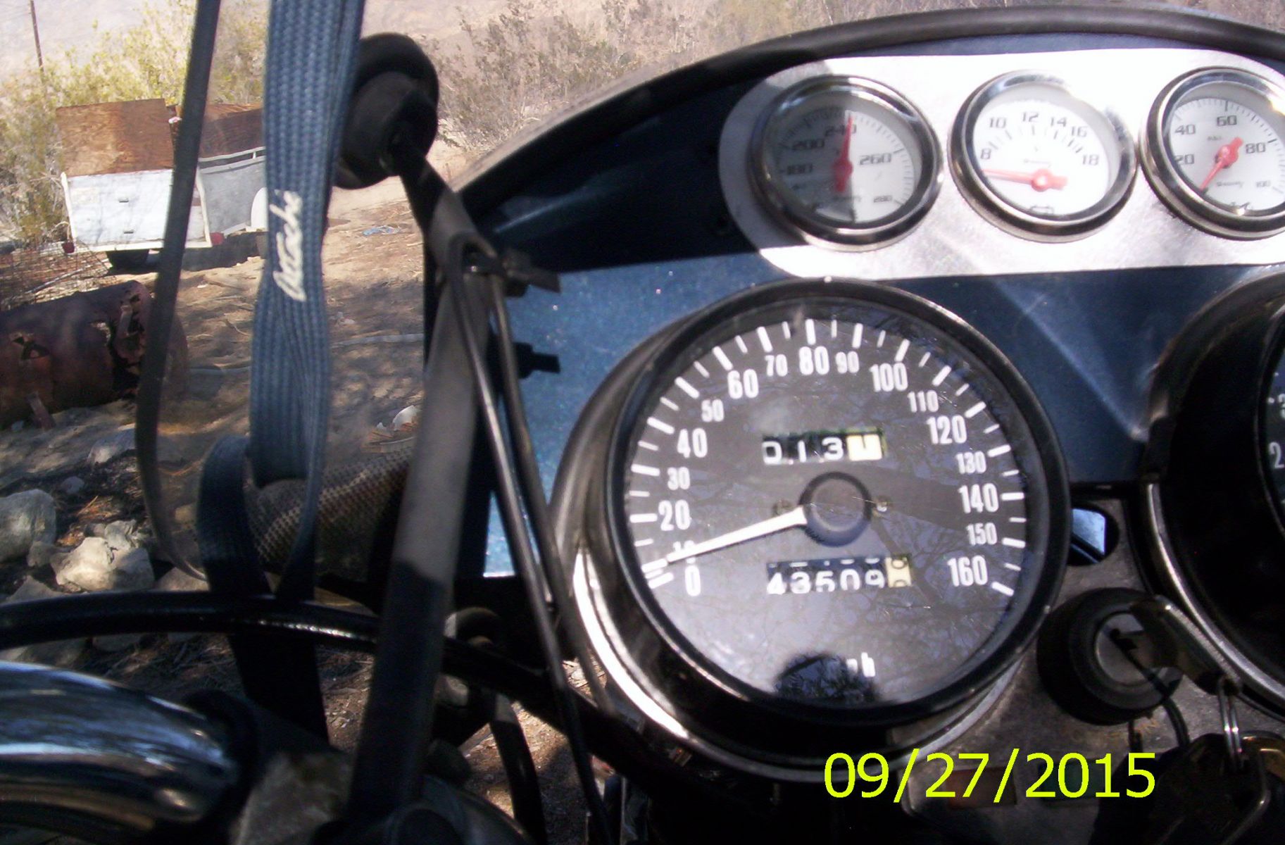

The spring was broken in the speedo. I took the guts from the other one and replaced it. PITA.
It works, I set the preload so it doesn't jump around as much but I'm sure this spring will fail too. I put in the new face plate and checked the speedo cable. It's spongy. The cable I got from Z1E two years ago. I'm going to order another one in a few days. I might disconnect it until then.

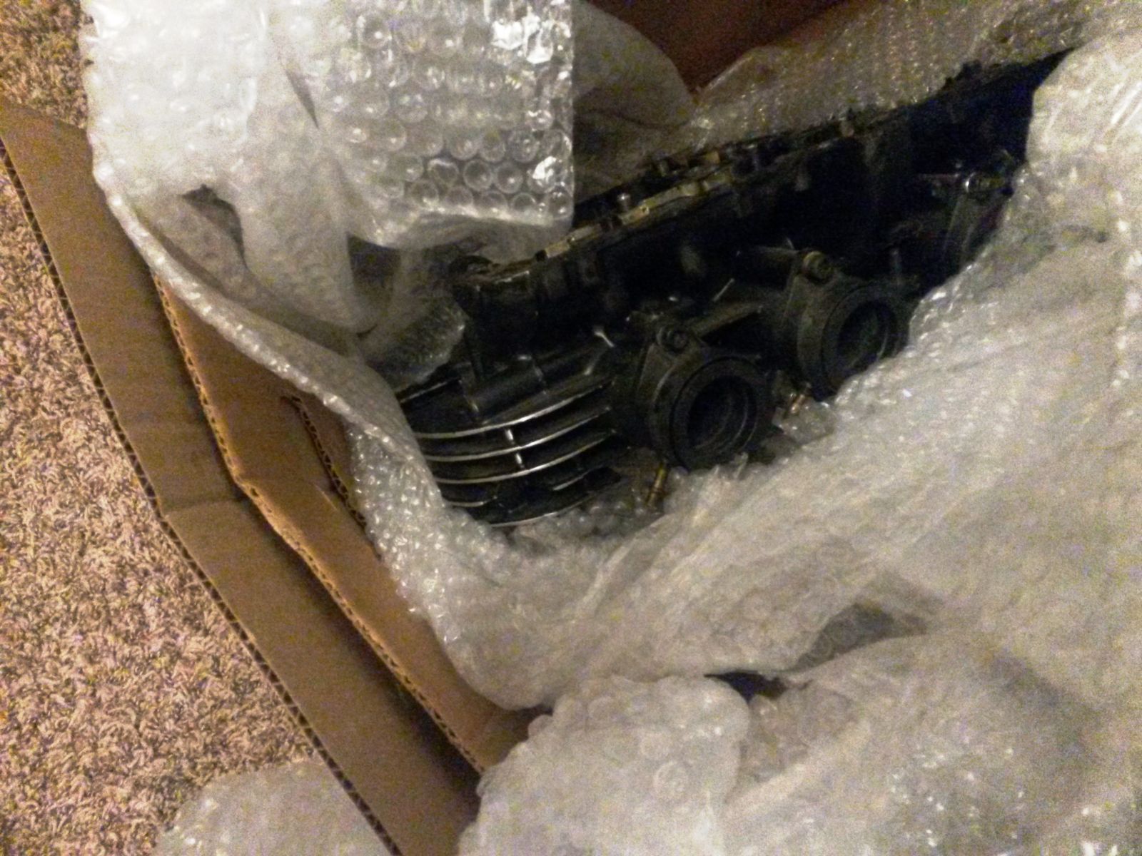

I'll post pics when I get a chance to spread stuff out. I have the cylinder block and pistons too. I'm going to prepare to split the engine completely down. No point tearing it half way down just to figure out I have something going in the crank case even if it's just a leaky seal.

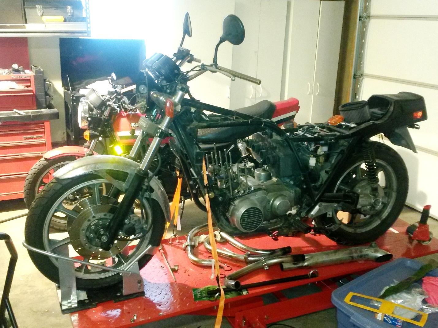

I completely forgot that I'd posted this much on this thread!
I was only reminded of it because i was trying to find a thread I started about bike and helmet cams that seems to have disappeared. Oh well, no one seemed interested anyway.
So I've been in a complete slump on this bike. I started just taking things off about a month ago just because If I didn't make the point of it It would never get done. I got the complete top end apart a few weeks ago and it took until this morning to verify that the cam chain is within serviceable limits so i don't have to tear it down any further.... for now.
Here it is as of now.
So I guess I need to look at the rings on the pistons that came with my replacement cylinders to see if they need replacement. Does anyone have a good guide for evaluating them? They looked pretty good when I pulled them out of the box but i'm far from being an expert.
I guess I then need to order a set of gaskets and seals so i can get it back together. I hope nothing is too much of a pain. One thing I should mention is i bought a '78 head instead of a '79 because of the price and I hope that isn't going to be an issue.
