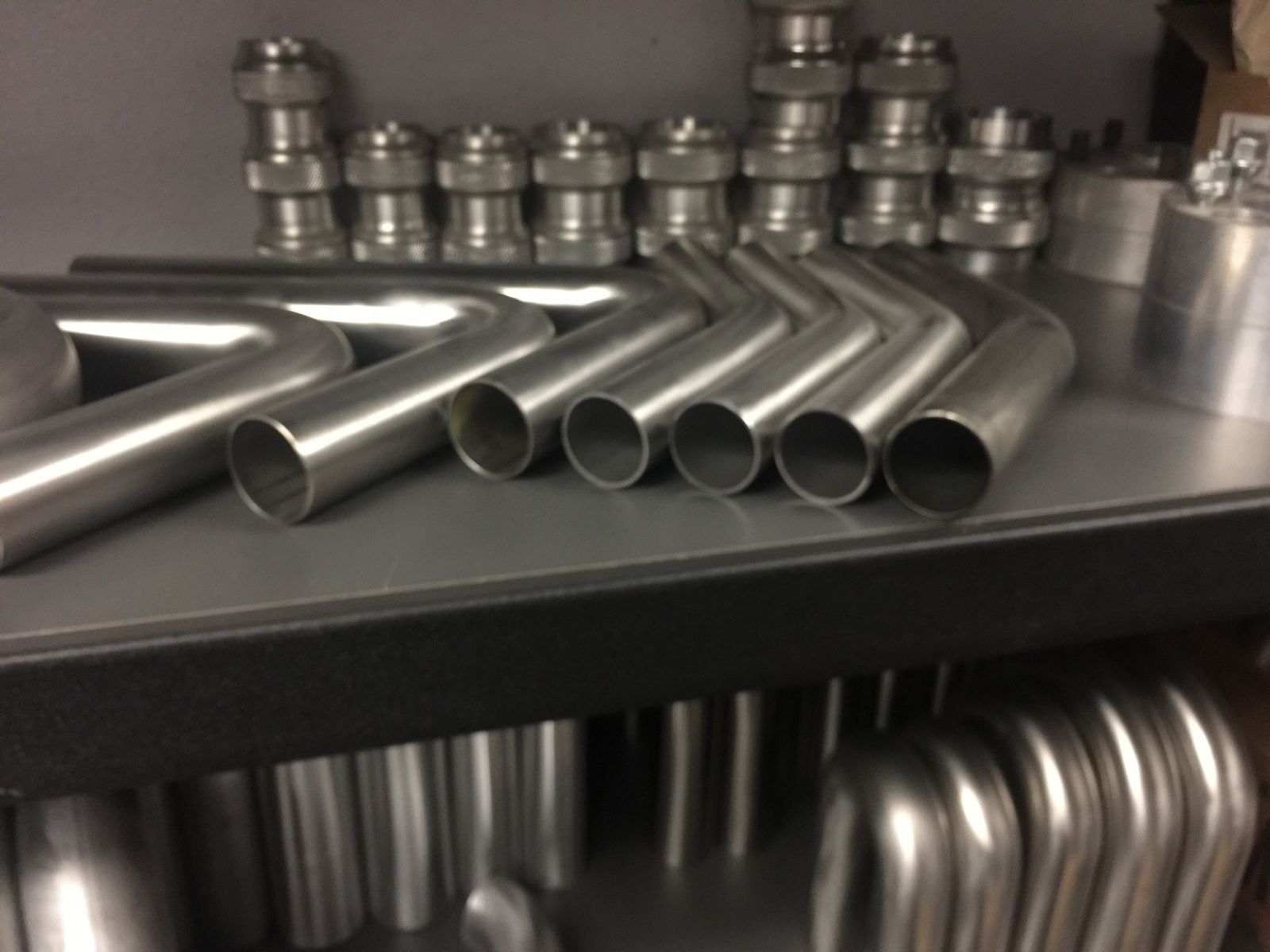

Looks good, hopefully you'll be able to get a nice ride and put some miles on her before your weather acts up. My bad I didn't read about your exhaust problem sooner, I definitely could've helped you out, just would've needed 2 measurements from ya.
You're waiting on something along the lines of this I'm guessing..

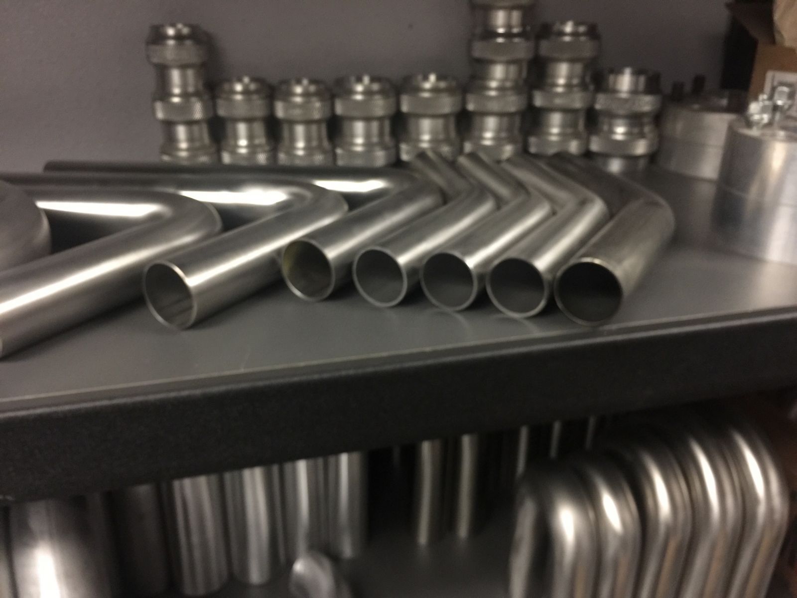

I can't wait to start doing my exhaust once I get my newly acquired rod knock taken care of.

Ed! Man! Do you have to tease me with all that properly sized and fitting exhaust?
So... The order from England? 1-3/4" ID and OD... :sick: Somebody didn't read my note!!!! Or get my drawing...
It would have been perfect. Exact bend and length. 5" long with a 5-10* bend on a 1-1/2" ID to OD exhaust extension sleeve. I guess triumph rebuilds on the other side of the pond like these! Just the wrong diameter.
I took it back. £59 in the end translated to just over $100. Now, a shop in Calgary is making the sleeves by hand for $40? I'll find out tomorrow when I pick them up.
