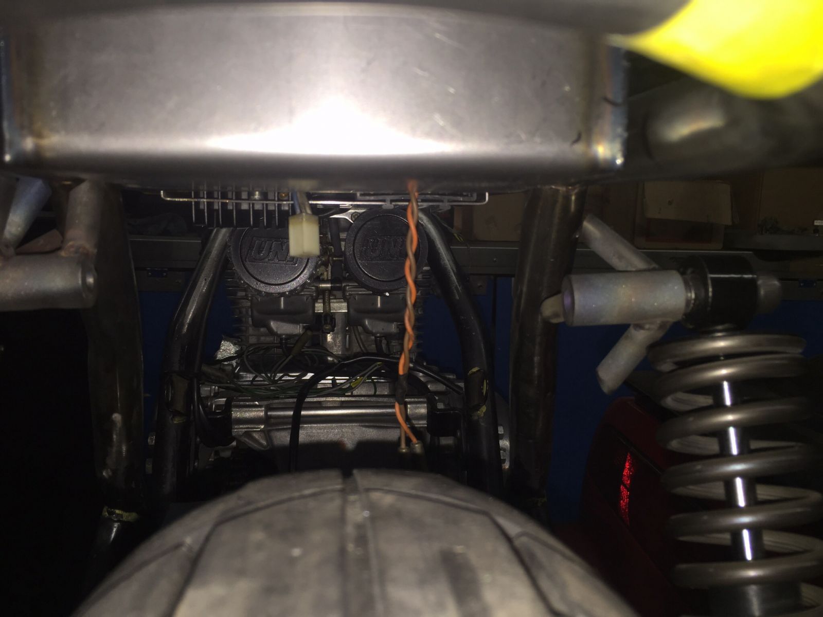

This week's discovery however was the carb pod filters. I had assumed 44mm pods fit based on a mechanic's search and prompt ordering a year ago saying, "A yeah these will fit!" They'll definitely fit on someone else's carbs! I wasn't at a stage to try until now. 44's on 55's are like a leprechaun playing basketball- a bit of a stretch! Davido, thanks for the note on oval pods earlier because I was able to trade straight across for a set with my old unused pods. I think it looks saweeet! Fuel line is going on now too. Any tips on cleaning out the petcock?

Jbosh, if you manage to get that bike running with those pods you are going to have to let me know how! My two 440s refused to run anywhere near correctly without the airbox,

Dom, I will absolutely let you know how that works out. I am currently under the assumption that rejecting will have to occur as my exhaust plan is shorter than stock and I am implimenting pod filters. I highly dislike the stock airbox just for the reason it does not look clean but really hackish. I still have it though as a few have mentioned theirs running better with them. Pod filters just feel tidier and a better design? 3/8" foam and chicken wire just has less appeal yknow! Out of curiosity, do you guys have 55mm carb air inlets on your Keihins? I am almost wondering if I have non stock carbs on my bike...

Also the 440s did have 55mm carbs.
