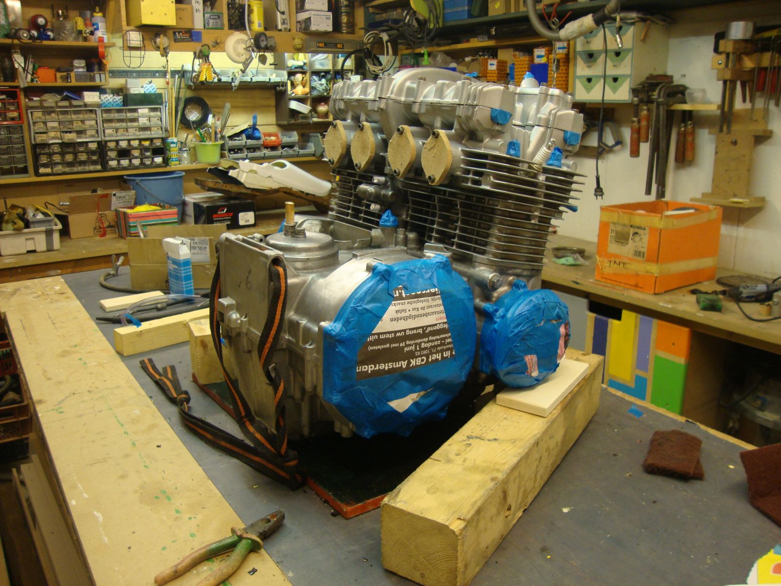

Heres my engine after cleaning and before painting.You can see the ports siliconed on this one;

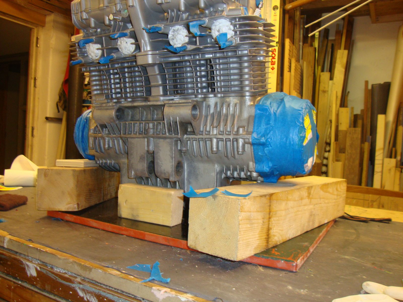

And heres how I did the inlets and the crank breather; (you can also just about see the silicone in the starter motor hole)
First I cut small plates from 9mm MDF .Then I cut a second set from a plastic milk bottle to act as a gasket. I put a bead of silicone around the ports and bolted everything down.

I wasnt too worried about the electrics as they are for later on. The easiest way to protect them is to put them in a plastic bag ,twist it around the wiring and tape it closed.
When you say its off to the cleaners,what do you mean? Are you having someone else wash It? Think about that.
I borrowed a power washer from a friend in work and did it myself. Then I was sure about what was happening. I wouldnt have trusted it to anyone else. When I did my frame,I took it up to my local filling station/petrol station/gas station. They have a car wash in the back where you can do your own thing.
