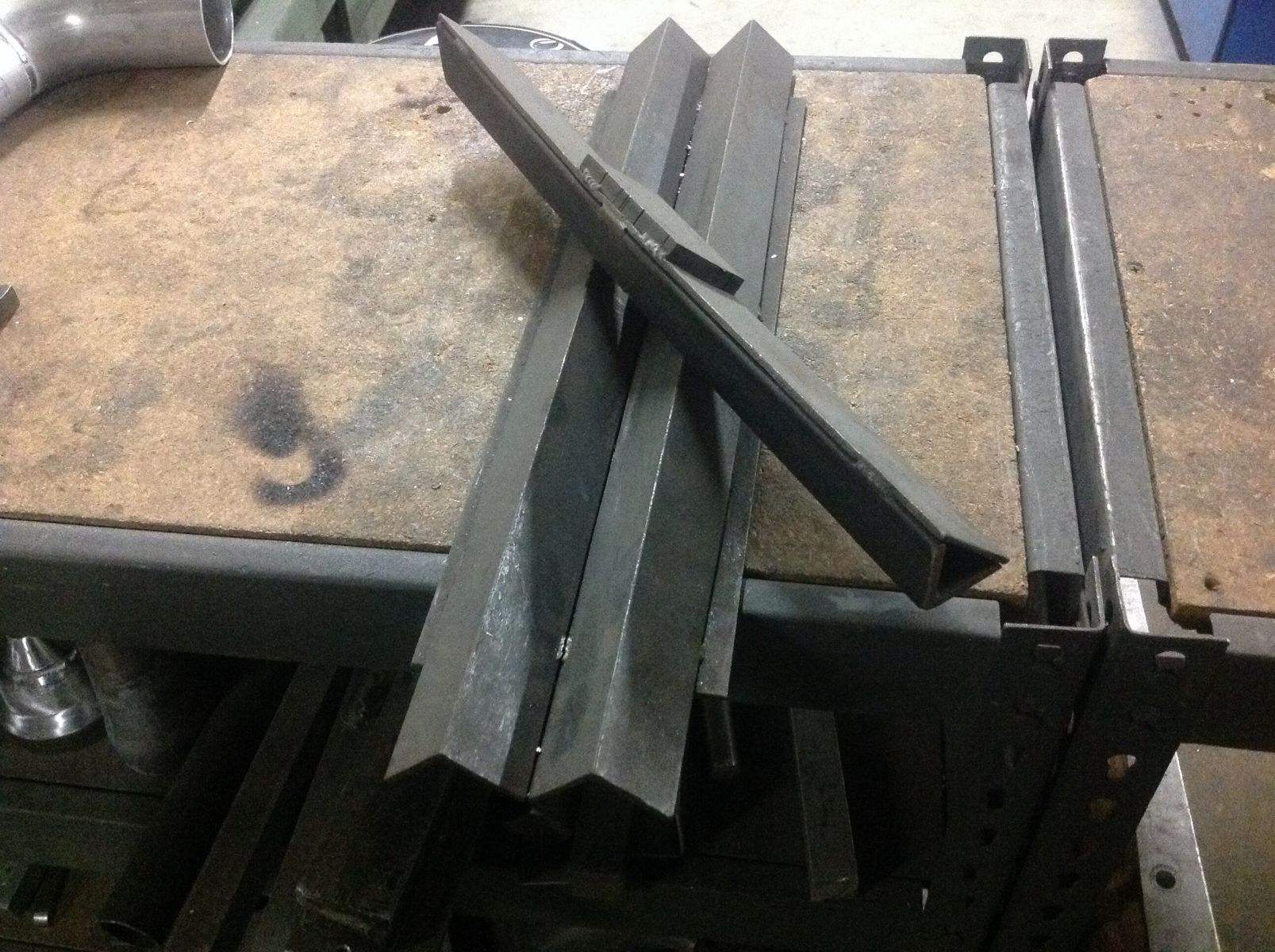

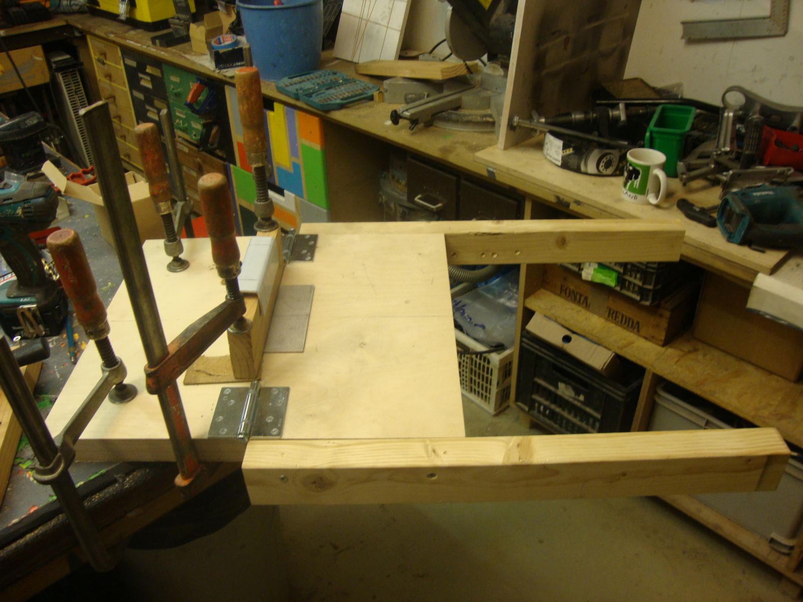

18 Aug 2015 00:16
I made this up for bending the aluminium sheet for my undertray and tail light bracket. Very easy and effective. I used a circlesaw to cut inside the bends 1/3 of the thickness of the plate. It made for far cleaner bends.
Bikes coming along.I like the red and the engine came up well.What did you use?

Davido, I really like that breaker press! The handles and clamping system are bang on what I'd like to have at some point myself. Thanks for sharing and kindling some further ideas!
