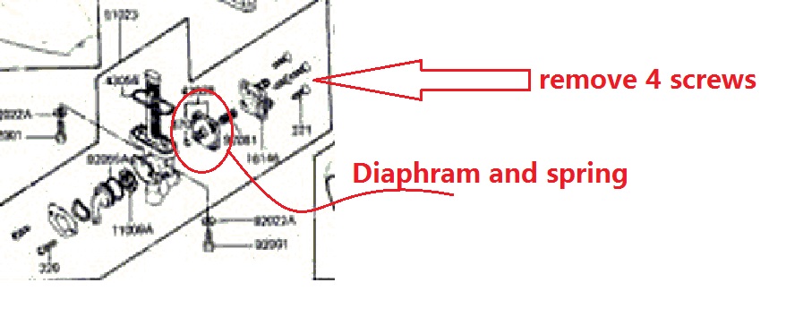

28 Sep 2015 19:34tk11b40 wrote: I am scanning your thread. I owned one of these when it was brand new. I had a very similar noise after about a year. It turned out to be the vacuum diaphragm in the fuel petcock.
Drove me crazy at first, I kept adjusting the valves. lol
I had no money and a good friend who was the local tech. he listened to the bike, pulled the diaphragm out of the petcock (it turns into a manual when you do that)..25 minutes later..no noise.
Tk, how do you remove the diaphragm? I'm unclear concerning the terminology for the petcock. I have fully disassembled and cleaned with carb cleaner though. Any direction is helpful.

4 screws on back. I can't remember but believe the diaphragm
is also a seal so you may have to just remove the spring this disables the vacuum operation. You just leave it on "PRI" to keep fuel running.

www.bikebandit.com/oem-parts/1981-kawasa...d5/o/m150576sch87091
Or for about 20 bucks, you can buy a new diaphragm.
