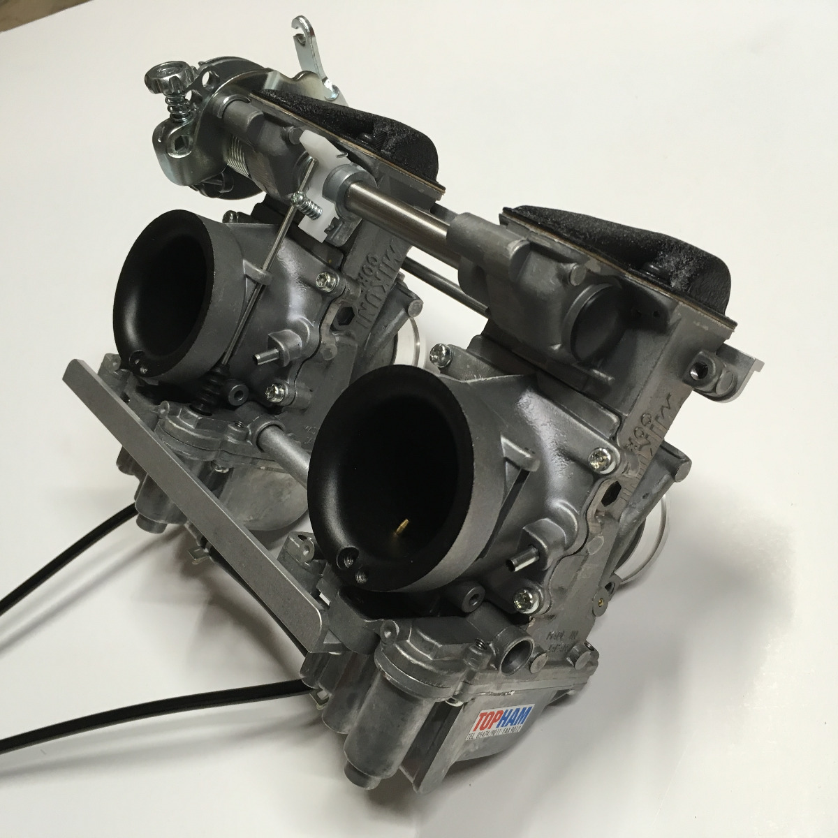

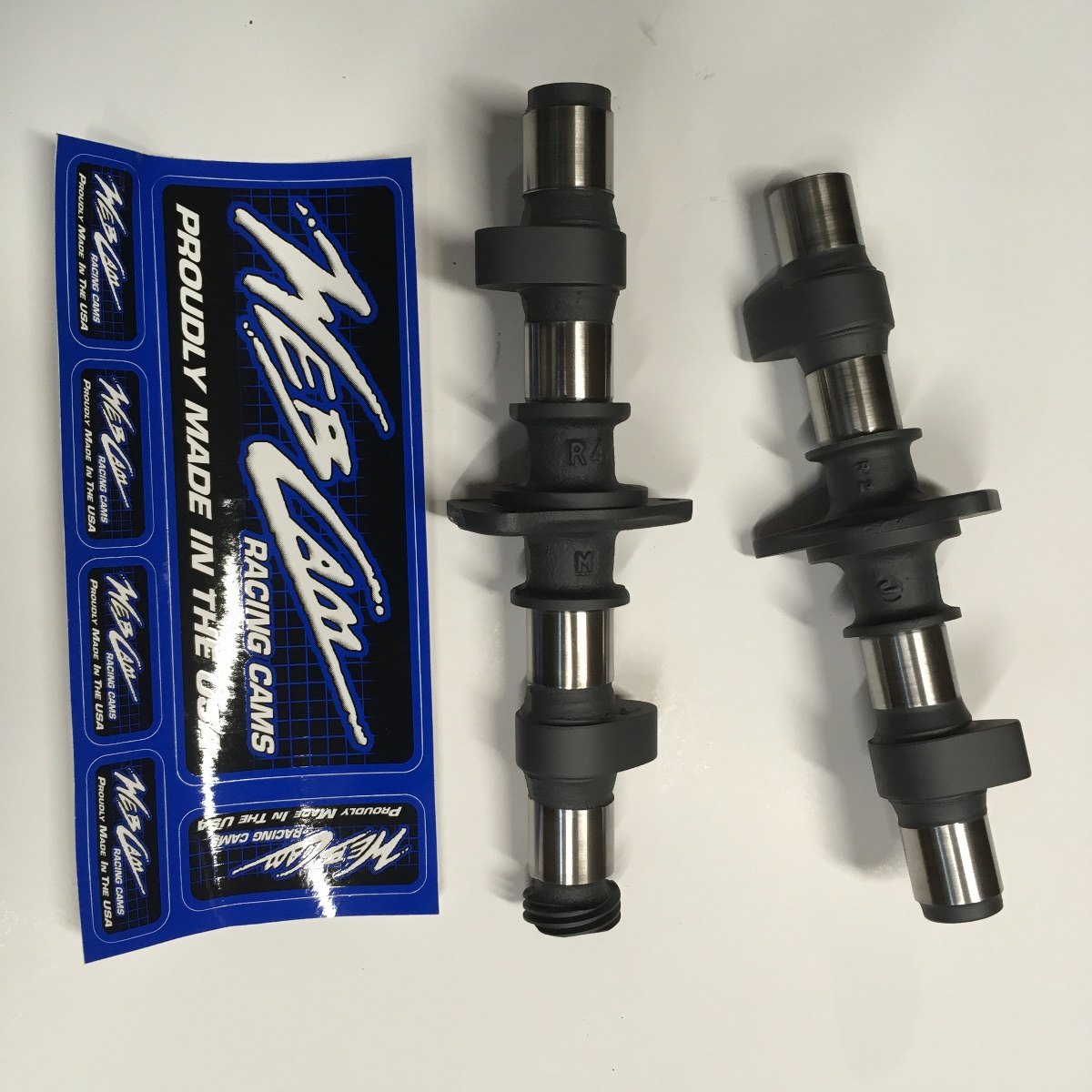

Finally some updates here. I took a little break and saved up for some goodies. RS34 carbs all the way from Germany, and a custom grind from Web camshafts!
I ended up decking the head .050". that , combined with the higher compression Venolia pistons, puts static compression at 10.6/1

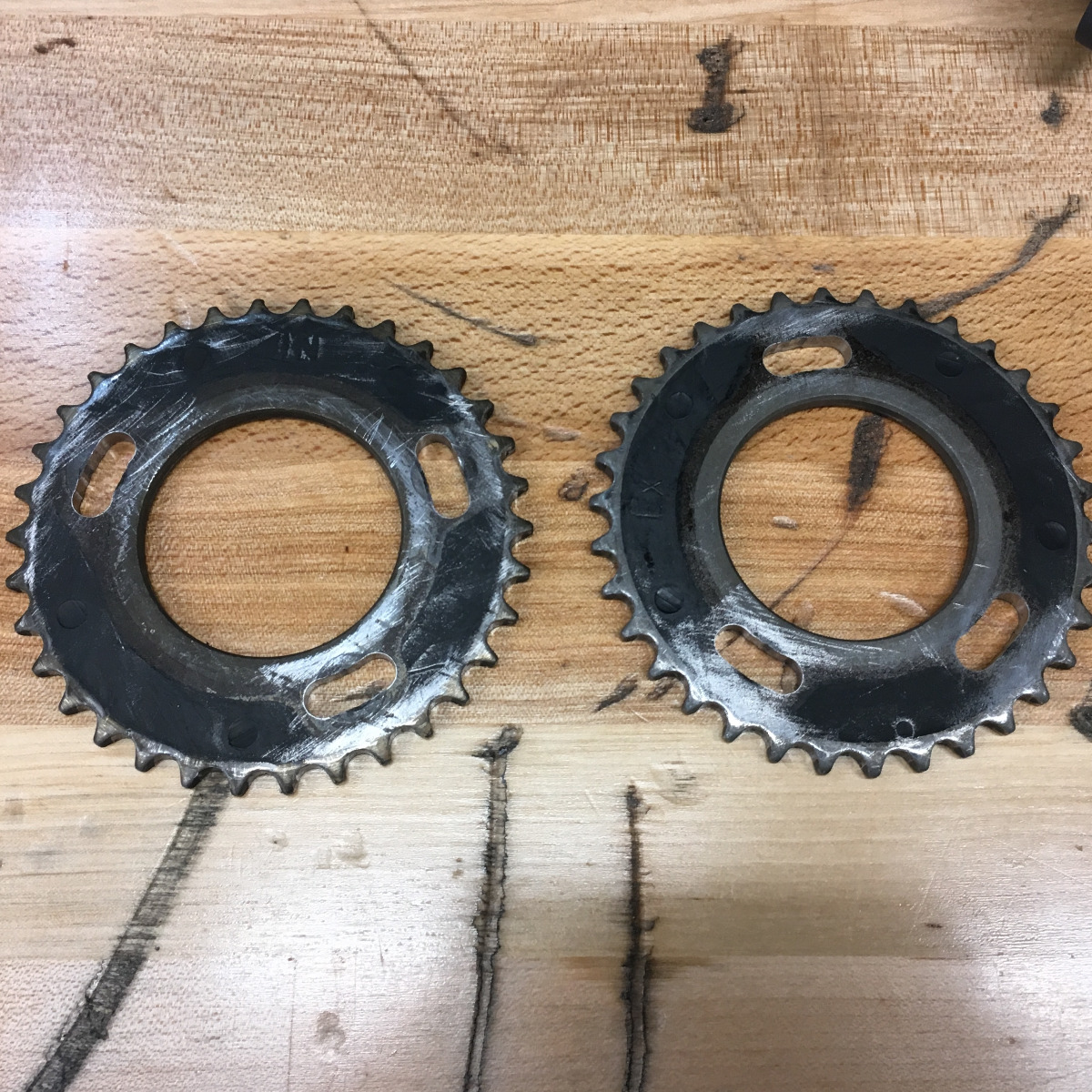

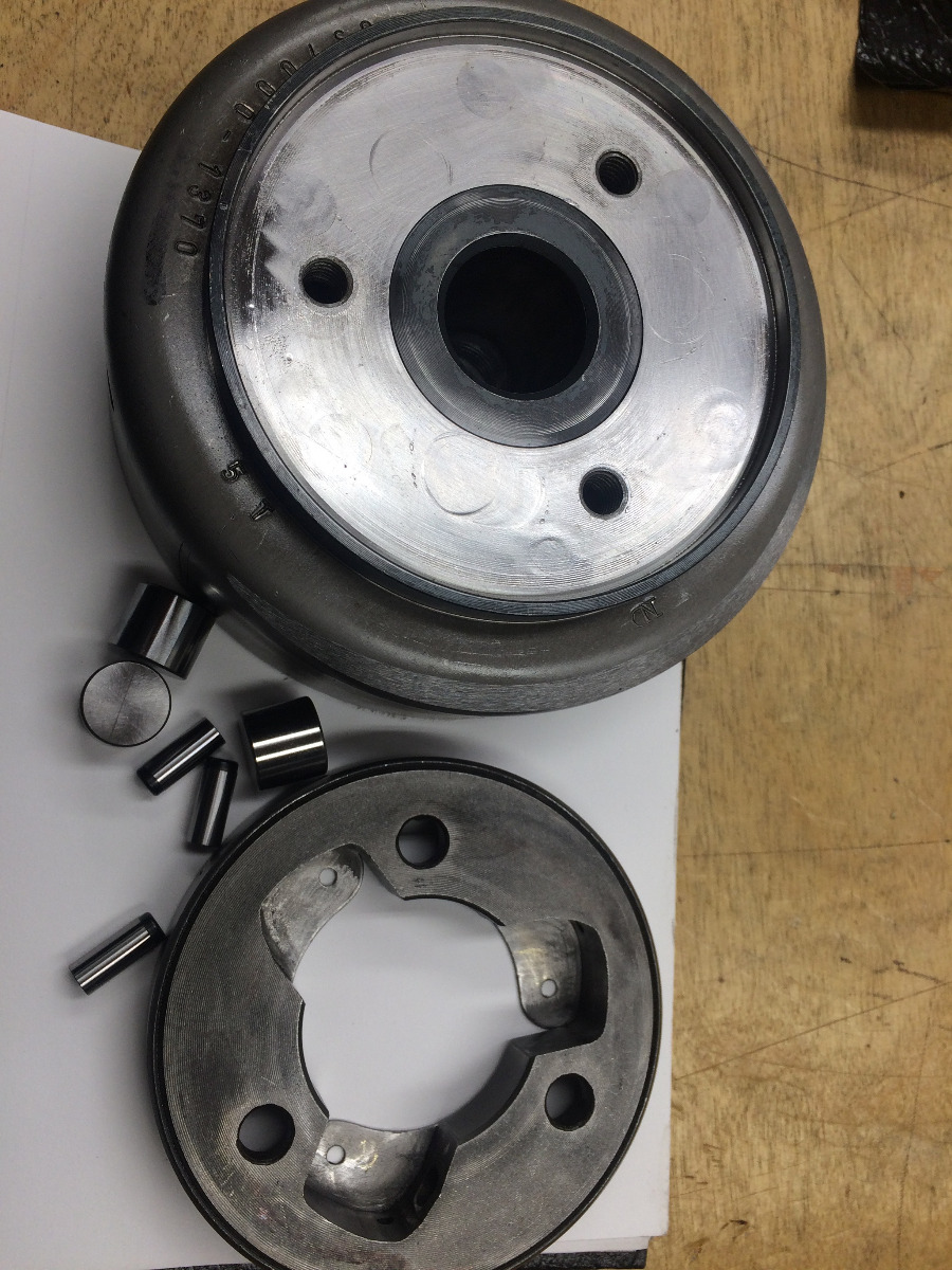

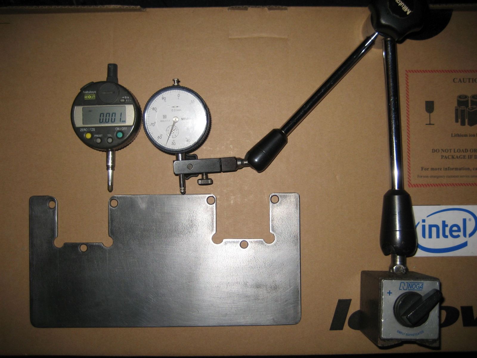

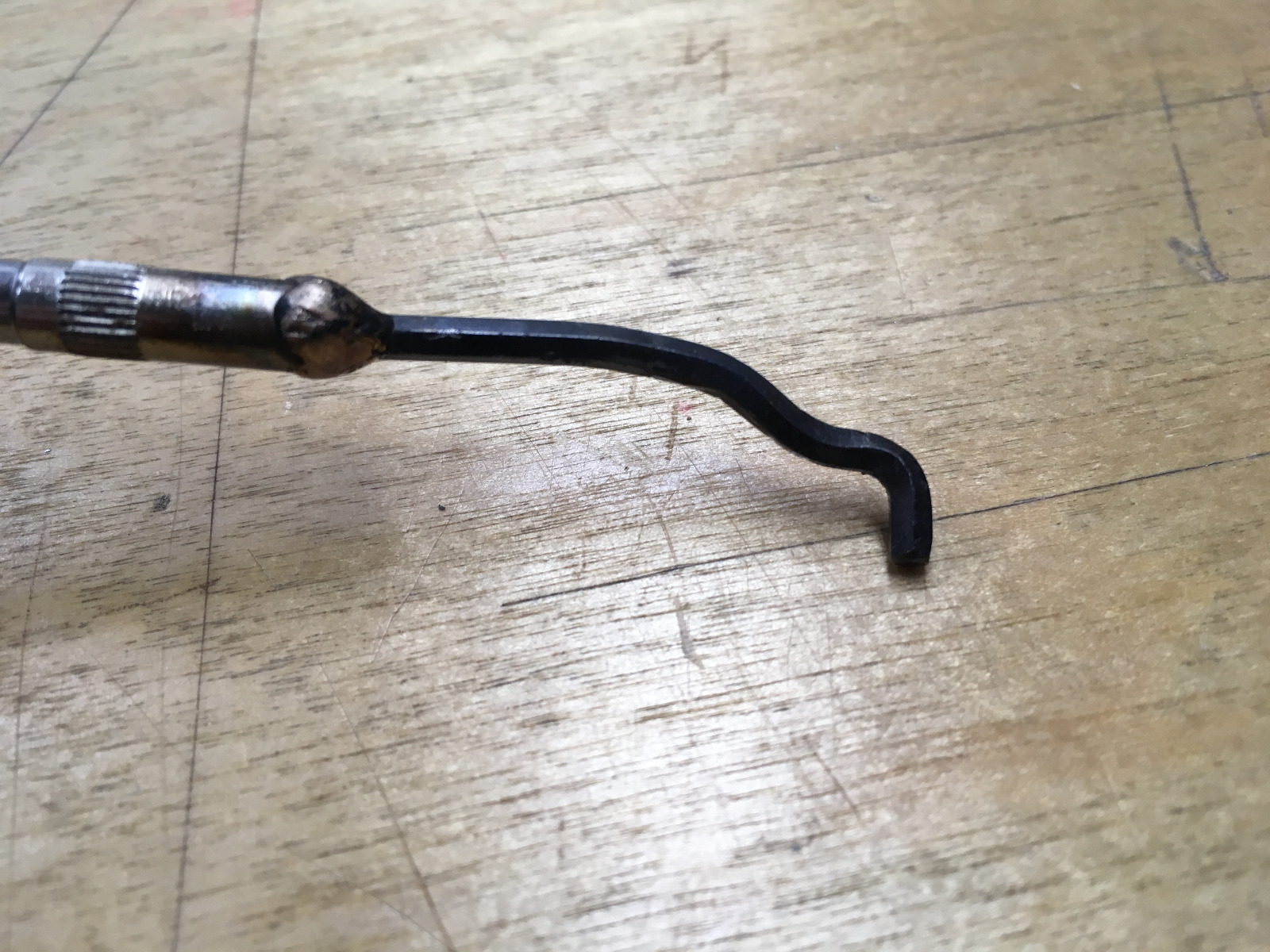

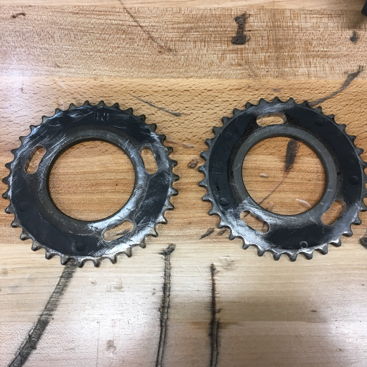

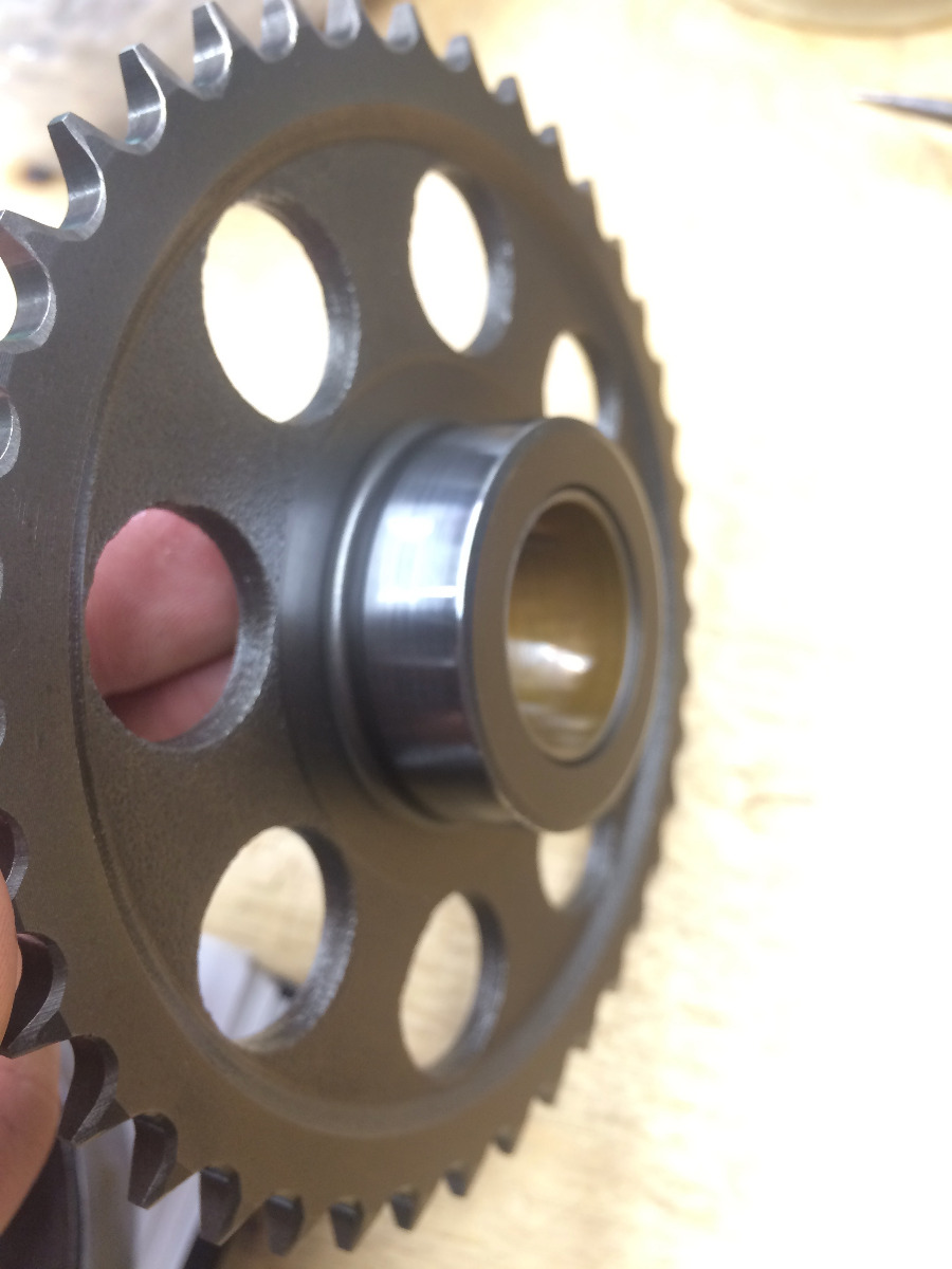

I slotted a second set of cam sprockets properly on the mill because my original job that i did with the file was pretty rough and i wasn't happy with it. I also finished machining the starter clutch. I thought it would be tougher and need to be ground but a carbide cut it just fine.

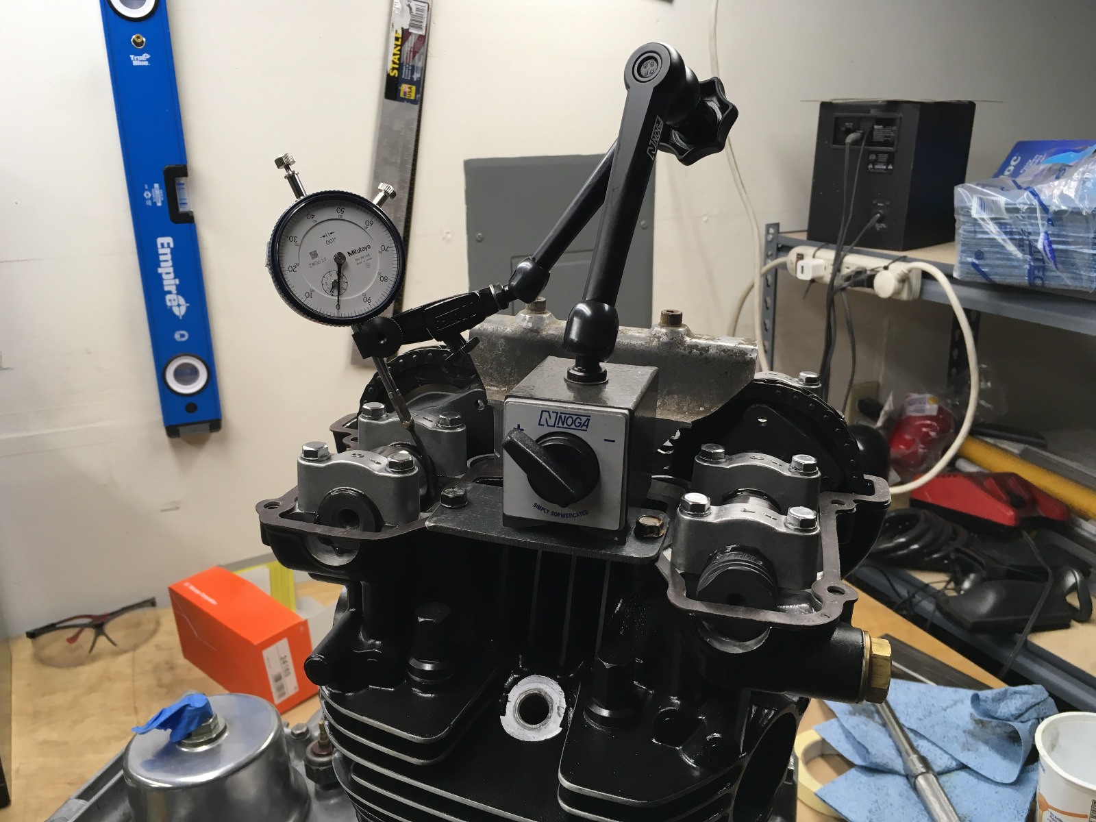

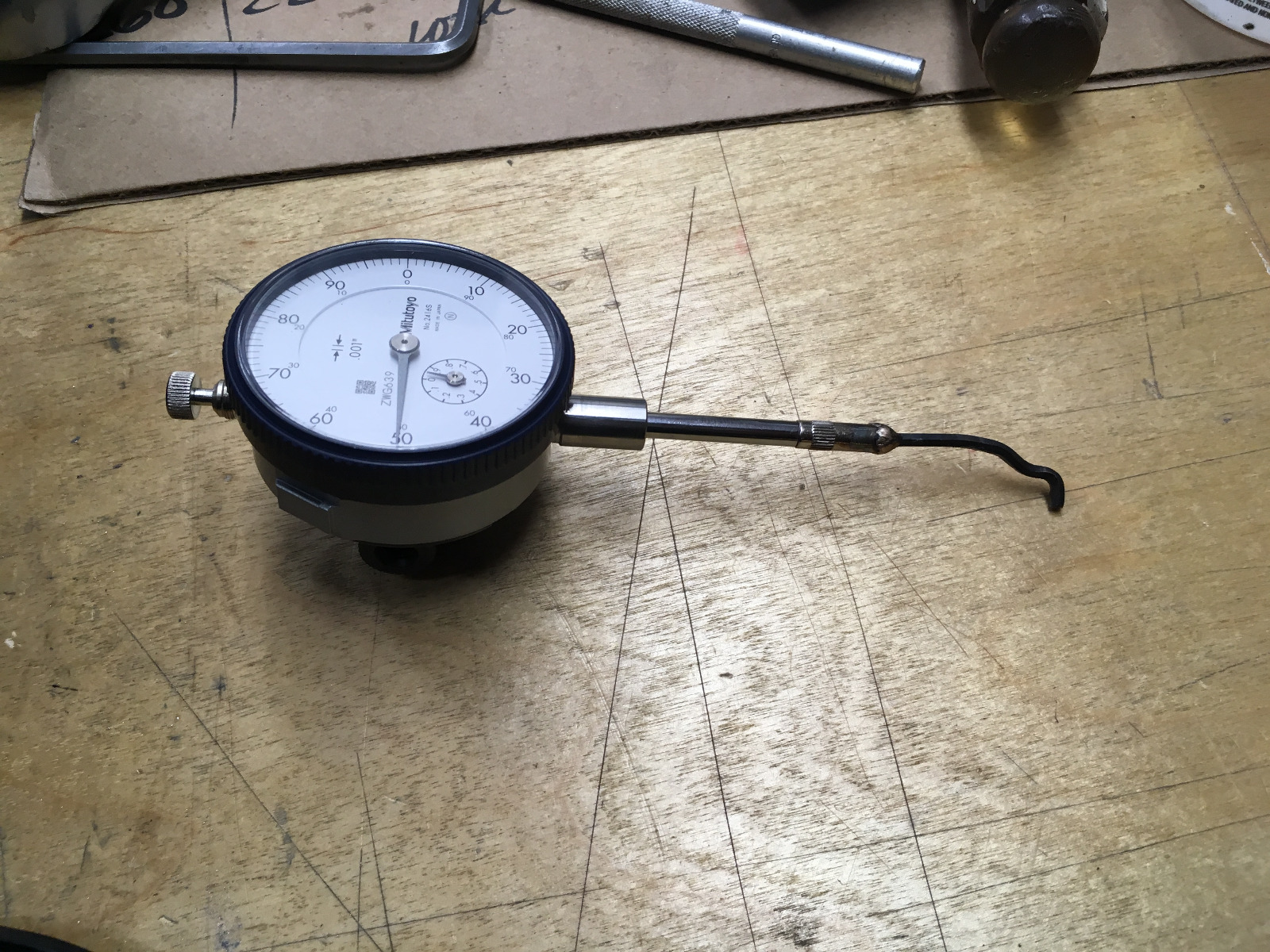

I have been screwing around with my tool setup to time these cams. A lot of trial and error to get make a feeler that can touch the tappet AND not get in the way of the cam AND go that deep into the head, finally got it right only to break my dial indicator! I then borrowed a friends dial indicator only to break my tool holder! I was getting super irritated with my cheapy Chinese dial indicator setup anyway, I just couldn't get consistent numbers with it here for some reason. I did what any sensible human does when they get pissed at their tools and splurged. I got a nice Mitutoyo drop dial and a NOGA magnetic base. Ive never had so much trouble timing a cam.
TLDR; I don't want a pickle, i just want to ride my motor-sickle

The new tool setup is soooo much better, I can zero the dial in 5 seconds as opposed to 5 minutes. The adjustability and rigidity is much better as well. However, I am still getting a small bit of variation on the degrees.
The indicated degrees will fluctuate +/- half a degree on my target, despite the dial coming back to zero every time. This means the lobe center can be as much as 1 degree off target. I have tried many things to try and tighten it up and nothing has removed this. I checked to see if the feeler was dragging at all and it clears everything completely. I called Web Camshafts up and they thought it could be variations in the cam chain or the OEM style spring cam chain tensioner. The cam chain is brand new, so im scratching my head. Right now the cams are very close to where they need to be, but they're not perfect.
After I got the cams timed I clayed the pistons to make sure there weren't any problems. You can see in my tool setup I cut off most of a spare cam cover so i could access the cam sprocket bolts without moving my tool setup. this made dialing in the timing much easier.
Any suggestions on what I could look at to remove the small degree variations? I'm stumped.

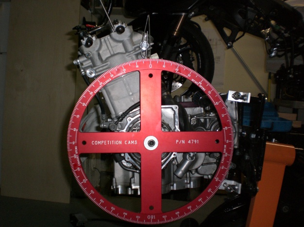

Don't take this the wrong way. Operator error, you need two things to correct this.
A longer wrench to turn the engine over and a bigger degree wheel. A tight engine is
hard to turn over and thus harder to control. With a longer wrench it will be easier to
finesse that last .001. A bigger degree wheel make it easier to differentiate that last degree.

21 Mar 2019 19:20Nebr_Rex wrote: Don't take this the wrong way. Operator error, you need two things to correct this.
This degree wheel works great for old blind people like me!!!!! Its from Comp Cams.
There is about 1/8 of an inch between each degree on this wheel. I love working with a degree wheel this big!!!

I asked my friend a retired mold maker and he said " A dial indicator measures distance, not degrees"

22 Mar 2019 00:53bluej58 wrote: I asked my friend a retired mold maker and he said " A dial indicator measures distance, not degrees"
I may get a better answer from him in the morning.
The dial indicator measures the lift of the cam. when it reaches .050" you look at the degree wheel and note the degree that the valve "opened" at so you can determine the lobe center.
Thanks for the tips guys. I will give that a try. That comp cam degree wheel is $200! it looks nice, but damn... $200 I'll figure something out.
