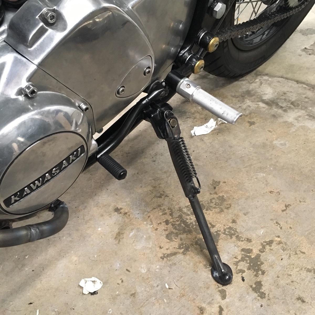

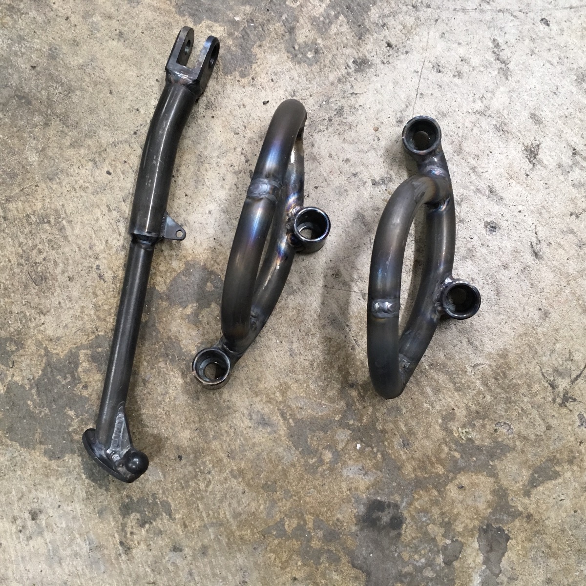

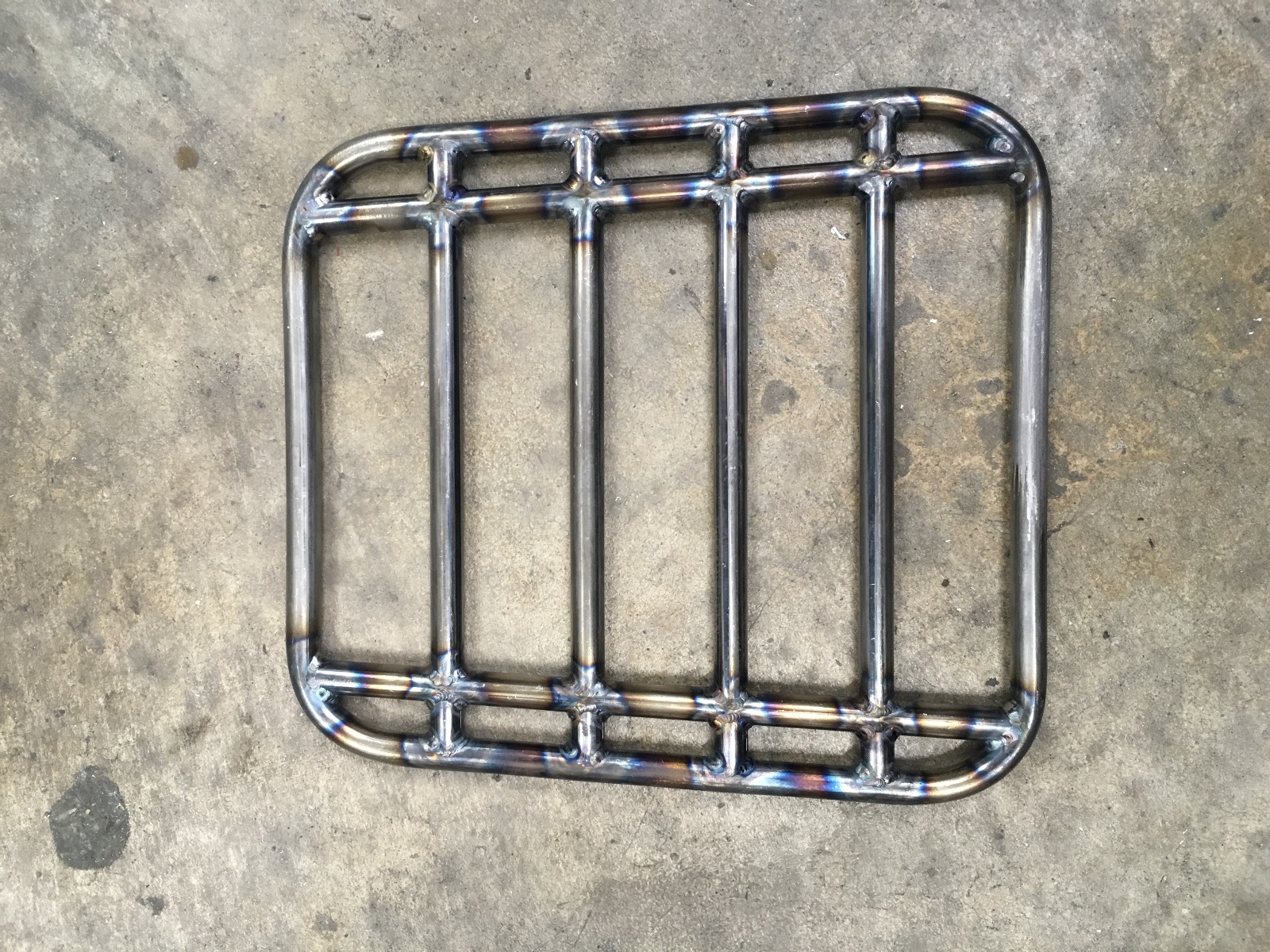

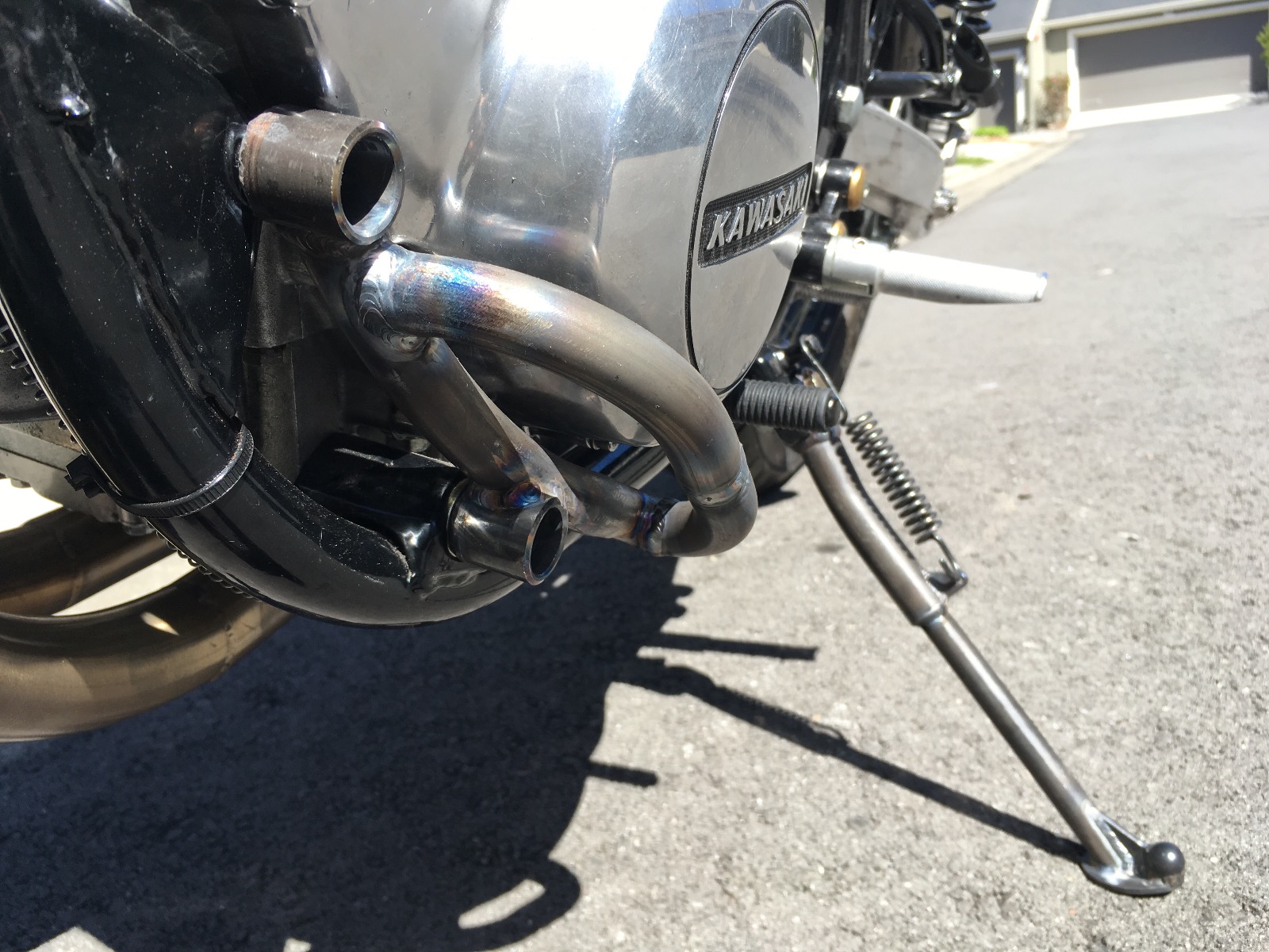

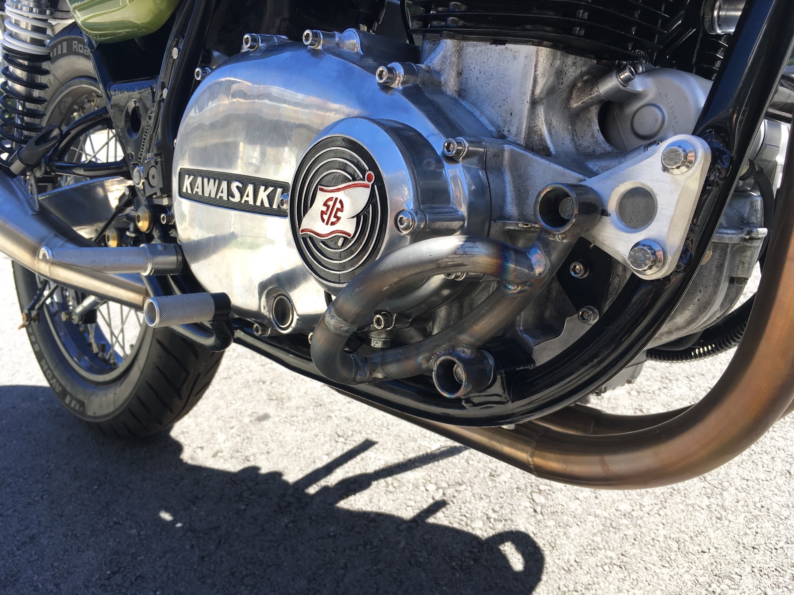

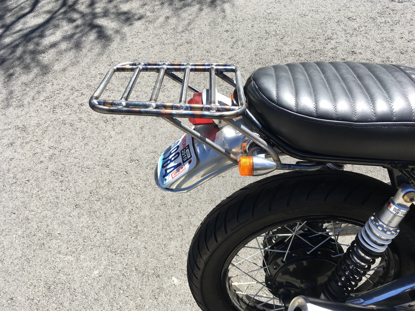

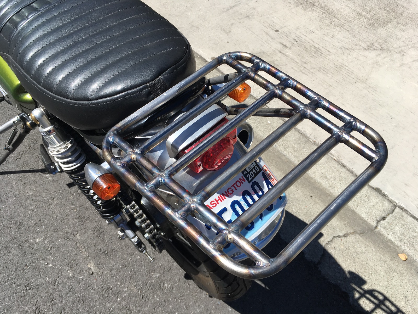

I’m takin this bike on a road trip this summer so I fabricated a luggage rack, crash guards, and a better kickstand. Also got it running. The video really kill’s the sound. Makes it sound a bit “ farty”.
Sadly this will have to sit for 2 months until I’ll be able to ride it. I accepted an amazing job in LA so This will be in storage for a bit while I move. The bitter sweet part is I will loose access to all the cool tools I have had at my disposal. I have been working 1 or 2 days a month at my old college to retain access to their shops. That’s all going to stop now

31 Mar 2019 21:58 - 01 Apr 2019 01:05bluej58 wrote: She will make a good mountain bike.
Cool parts Doc, are they stainless? I couldn't get the vid up?
Congrats on the new job good luck!
Not sure why the video didnt work last time. I entered the URL again and seems to be working now.
The rack is just regular mild steel, the crash guards and kickstand are chromoly. I'm going to polish the butt welds back on the crash-guards so they are seamless and then everything will get powder coated.

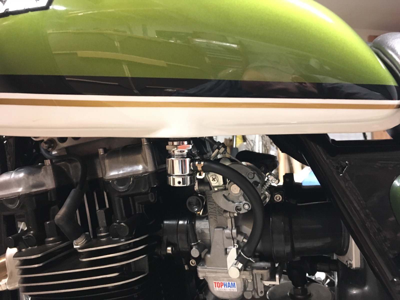

New petcock came in and I had a little time while moving to install it and go for a ride! It just barely clears the cables but clearance is clearance. I only rode around for 20 minutes and first impressions are; needs taller gearing. This thing rips to redline way too easy now, noticeably smoother with the crank balanced as well. I didn’t have the balls to go WOT yet but at half throttle bursts I was impressed by the power. The new race tech goodies in the forks have transformed the front end as well. It was diving pretty bad before and that is completely gone, it also feels more stable as well. The new brake setup seems adequate but because the pads are still bedding in I didn’t reef on em too hard. Overall good improvements all around, however is has brought a handful of small things to light that I will need to address, like a shorter turn throttle. Can’t wait I get this bike on the dyno to see what kind of power it’s making.
