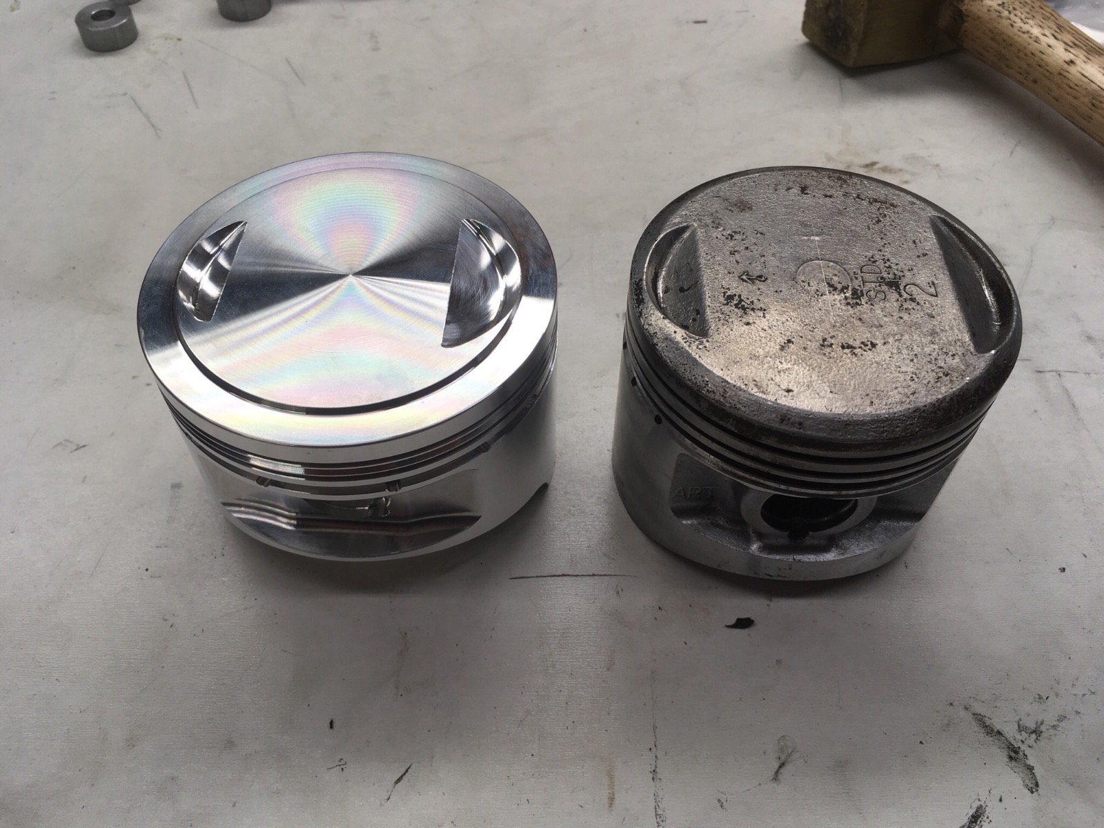

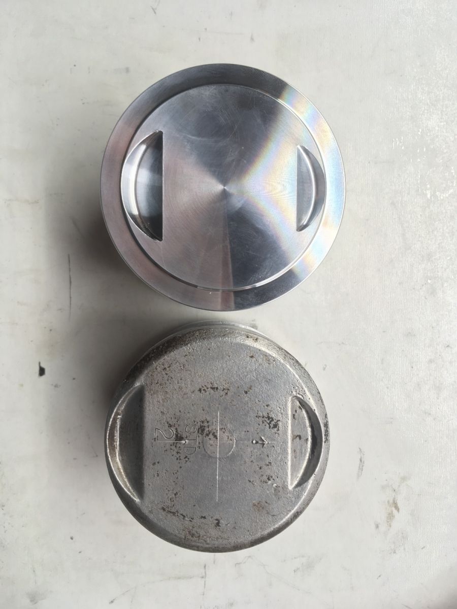

No eBay APP ID and/or Cert ID defined in Kunena configurationI am not sure it's the best choice: someone was meddling with those crankshaft balancing (two fresh drilling marks where should be none).
I also prefer ebay lots with clear description and mileage indicated, even if this features certainly do not guarantee anything.
Here is 1980 crankshaft with connecting rods (which might be a bonus in your situation).
By the way, I ike this custom pistons of yours and I like design of 750 twin engine. Hope one day I would be working on one of them.

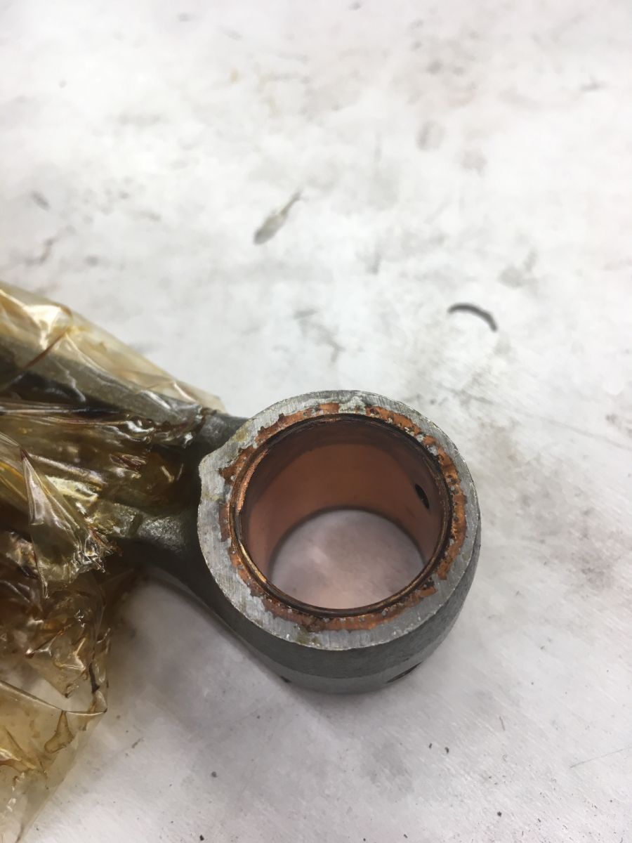

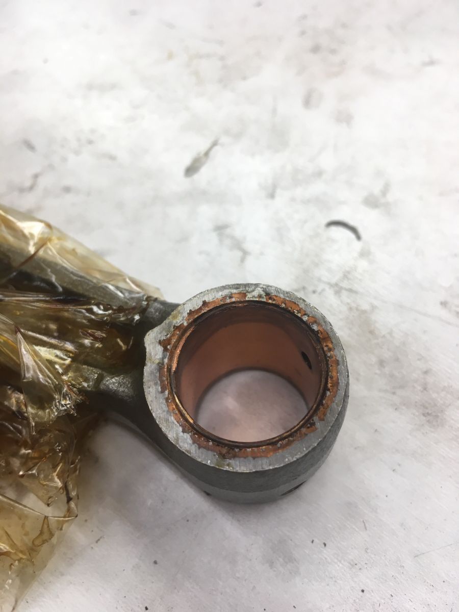

I dont want to buy a crank that isnt showing the rod journals, because who knows whats hiding under there. I don't need rods as I managed to score some NOS connecting rods for $50. In doing so I discovered the difference between the early rods (76-79) and the late rods (80-83). Early rods have the small end copper plated, the late model rods do not.
- Nebr_Rex
- Posts: 1889
- Thanks: 295
Re: Saving a 1980 750 twin.
27 Feb 2020 19:17
When you say copper plated would that be a small end having a bushing?

The small end is indeed plated. I thought it was a bushing at first but i was able to scratch some of it off in a nn crucial area .

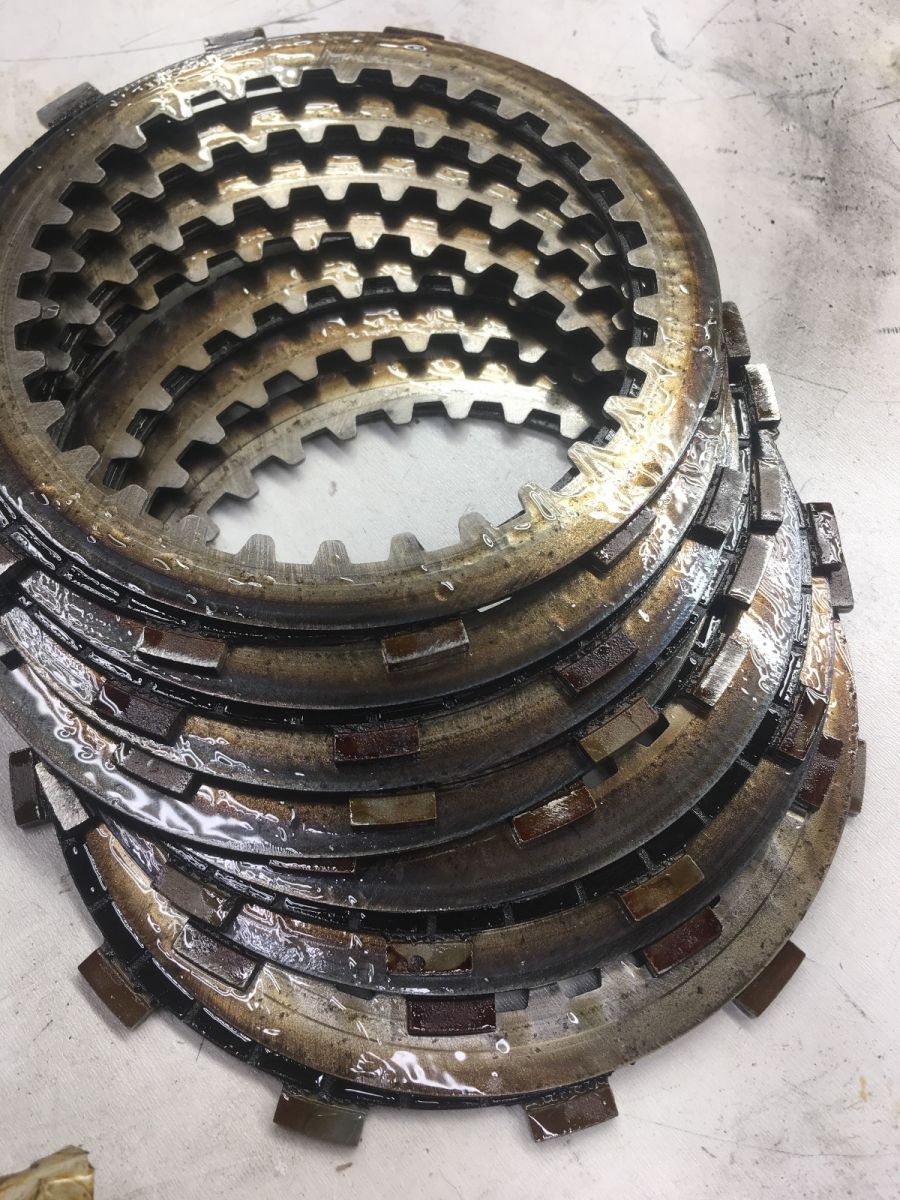

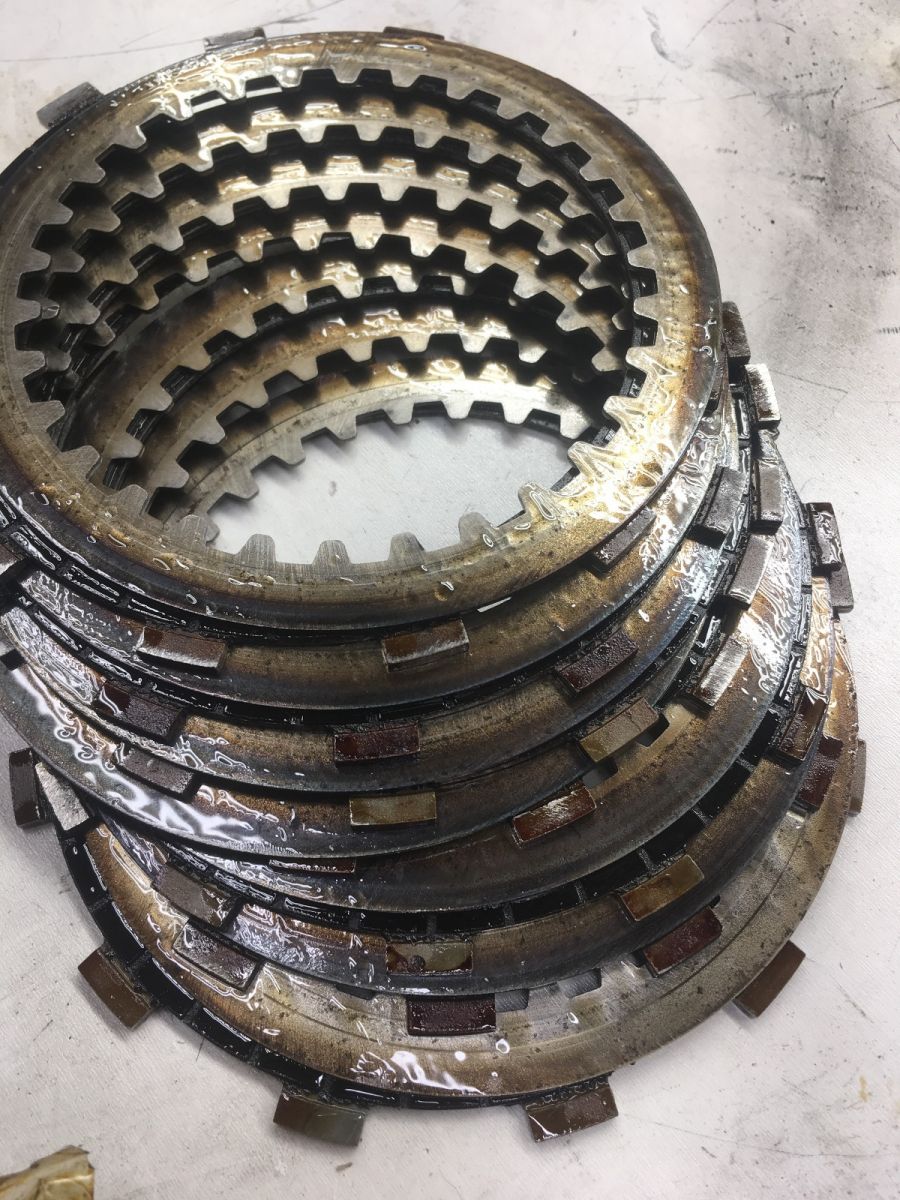

Ive been inspecting the components one by one and the glitter from the bearings is everywhere. its like the aftermath of a stripper party. Its in the transmission bearings, which are available, however it also is in the needle bearings for the balancer as well. Those are unavailable, and reading the manual it states that they should be replaced if removed. The bearing material is quite soft. I'm wondering if it did any long term damage, and if it would it be safe to clean everything extremely well and reassemble the balancer as is.
Also the clutch is well cooked. Maybe I should get a new engine?
