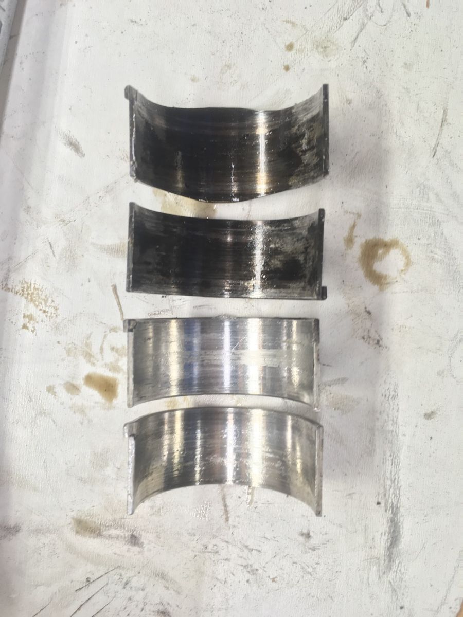

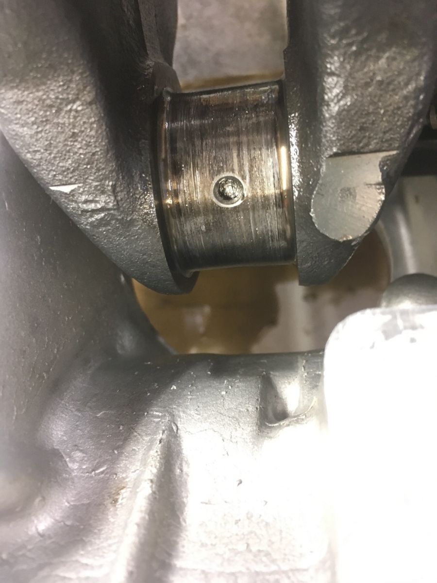

Think I found the source of the noise... unfortunately this went south so fast it damaged the crank as well

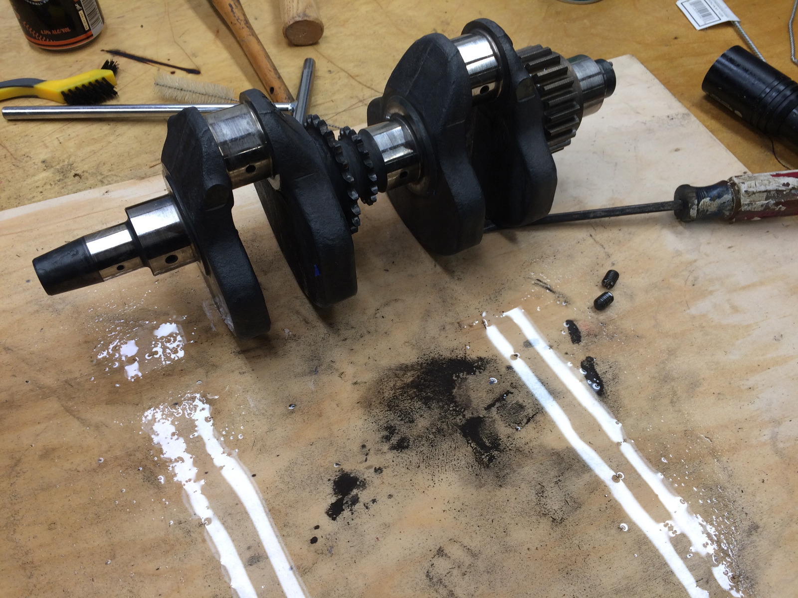

#819678
Go back to the post you made on Nov. 11 2018. Looks like the crank had issues from the start.

#819689
You think that black stuff was a symptom? I checked the crank for all the things listed in the manual and sent it out to be professionally checked. what else can I do?

#819708
Looks to me that one rod journal and the center main journal had been hot before assembly.

Hmmm that rod journal does look like it got hot. The main bearings all looked OK this time out. it was the opposite rod journal that got burnt up bad this time but both were shot. I’m thinking oil startvation. Gonna check out the oil pump closer. Any other suggestions for the next build?
