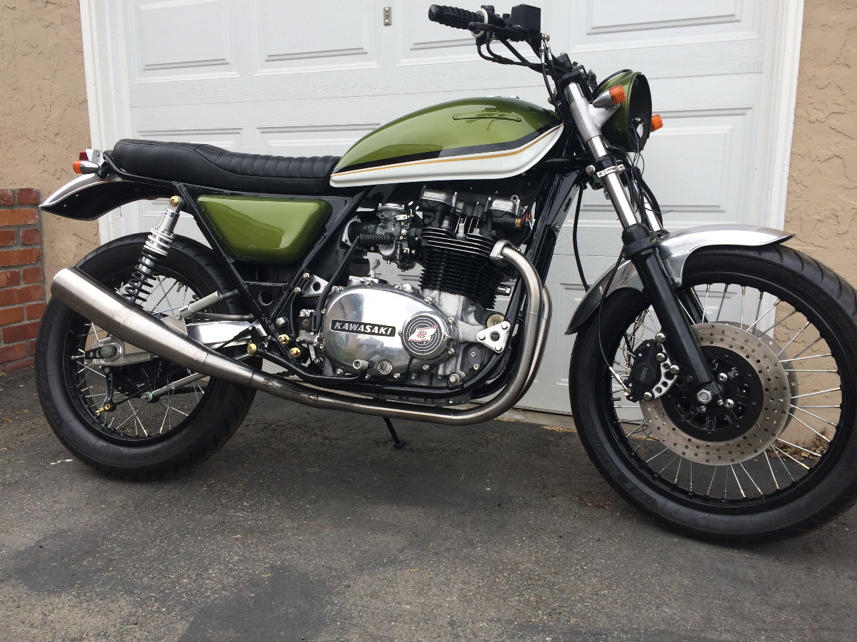

08 Jun 2017 14:10

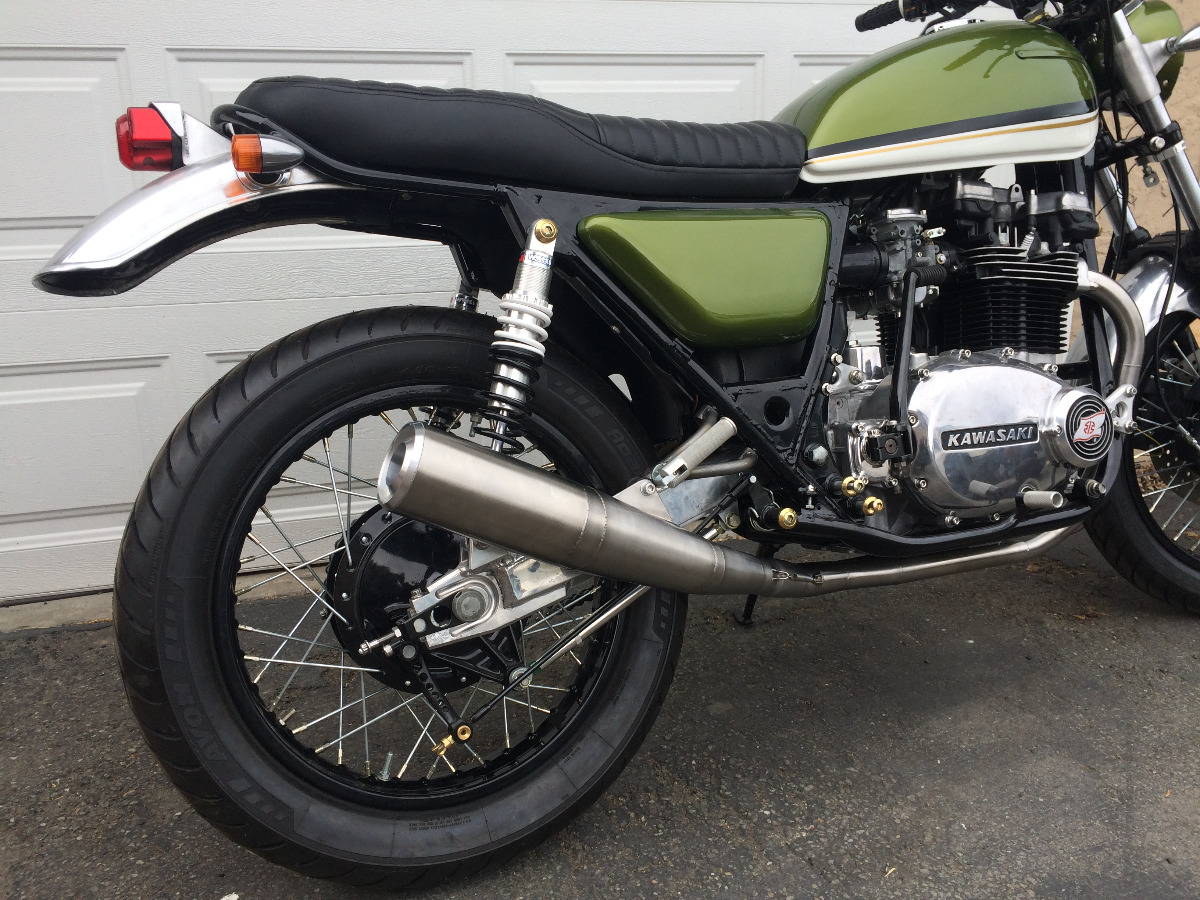

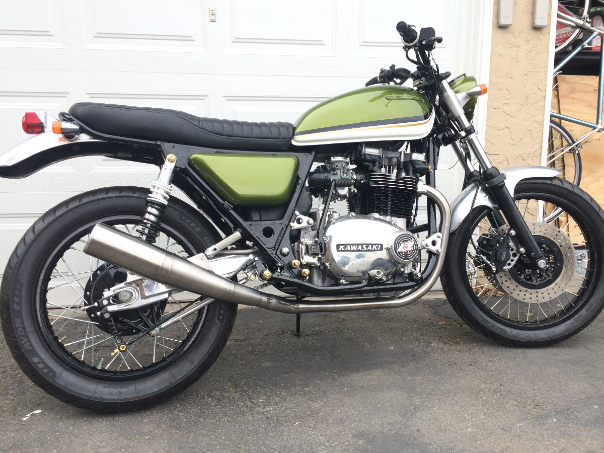

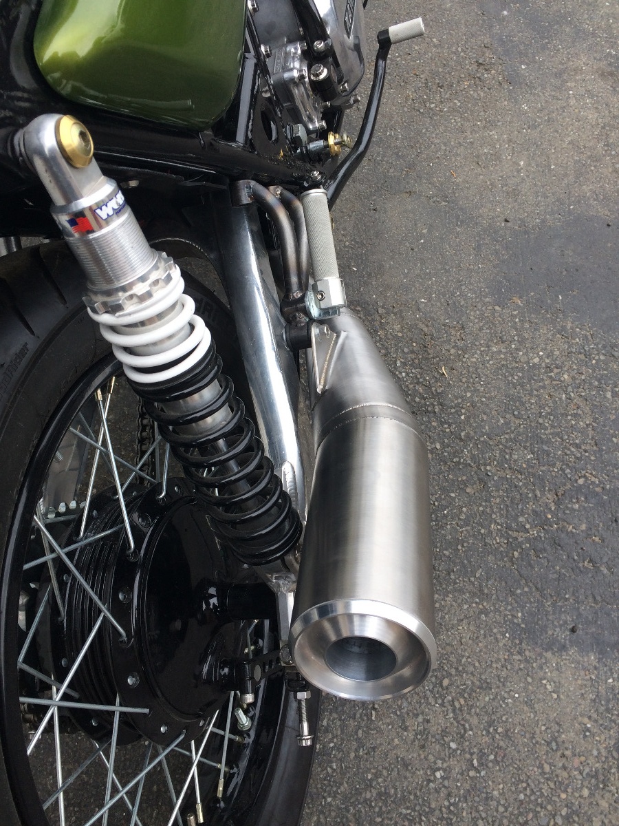

You may want to be careful about posting pics of that exhaust. Otherwise you will be flooded with orders to build them for others because it really is beautiful! Ed

Re: Saving a 1980 750 twin.
08 Jun 2017 15:06
Might have to change your profile to read I bowl, I drive around and I build master class exhaust systems. (Not to mention the rest of the bike).
09 Jun 2017 06:39
Wow! This build just keeps getting better.
If we ever meet, I will have to park on the next block and put a bag over my bike.

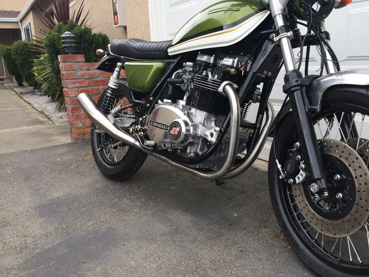

10 Jun 2017 19:00650ed wrote: You may want to be careful about posting pics of that exhaust. Otherwise you will be flooded with orders to build them for others because it really is beautiful! Ed
My thoughts exactly Ed! Would love to have a similair exhaust for the Z1/KZ. Or at least the megaphone and endcap that will slip over the Delkevic stainless steel headers. Similair in shape to the Kerker. Supurb work Doc! Keep it coming!
11 Jun 2017 07:31
This bike is turning out gorgeous! Very nice work.

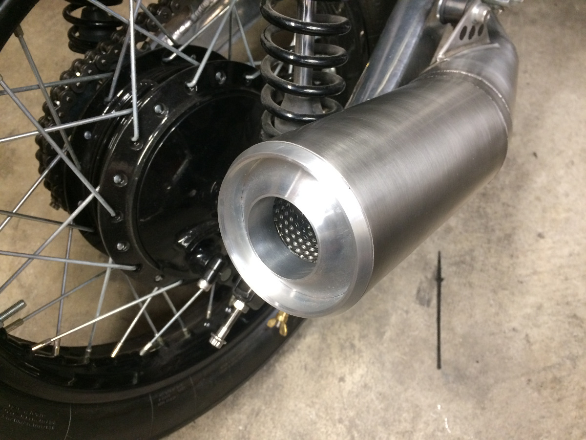

17 Jun 2017 00:47 - 17 Jun 2017 00:47

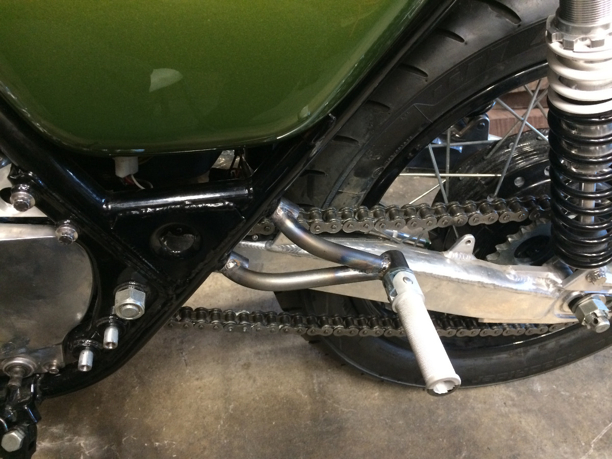

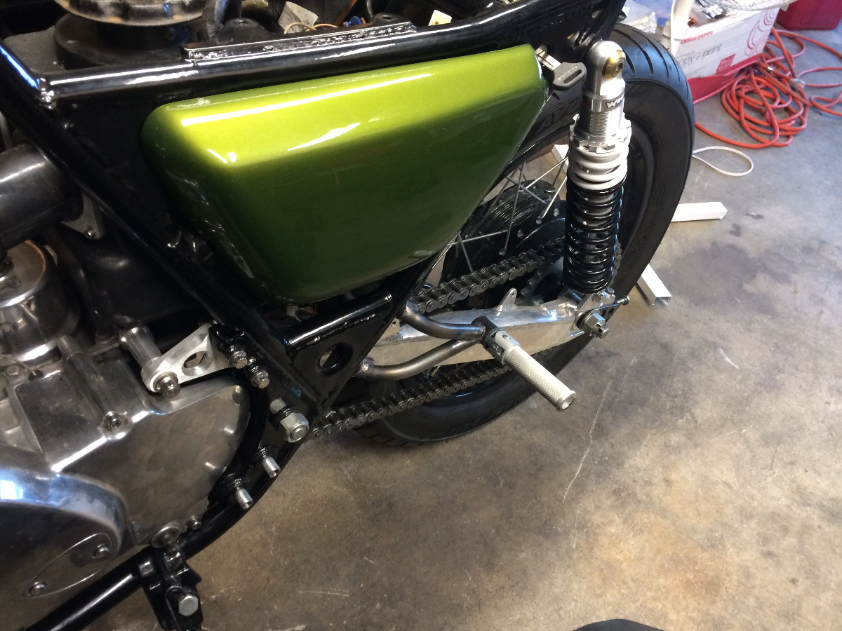

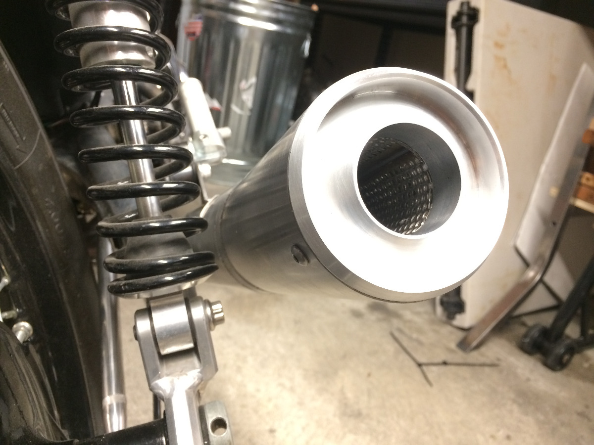

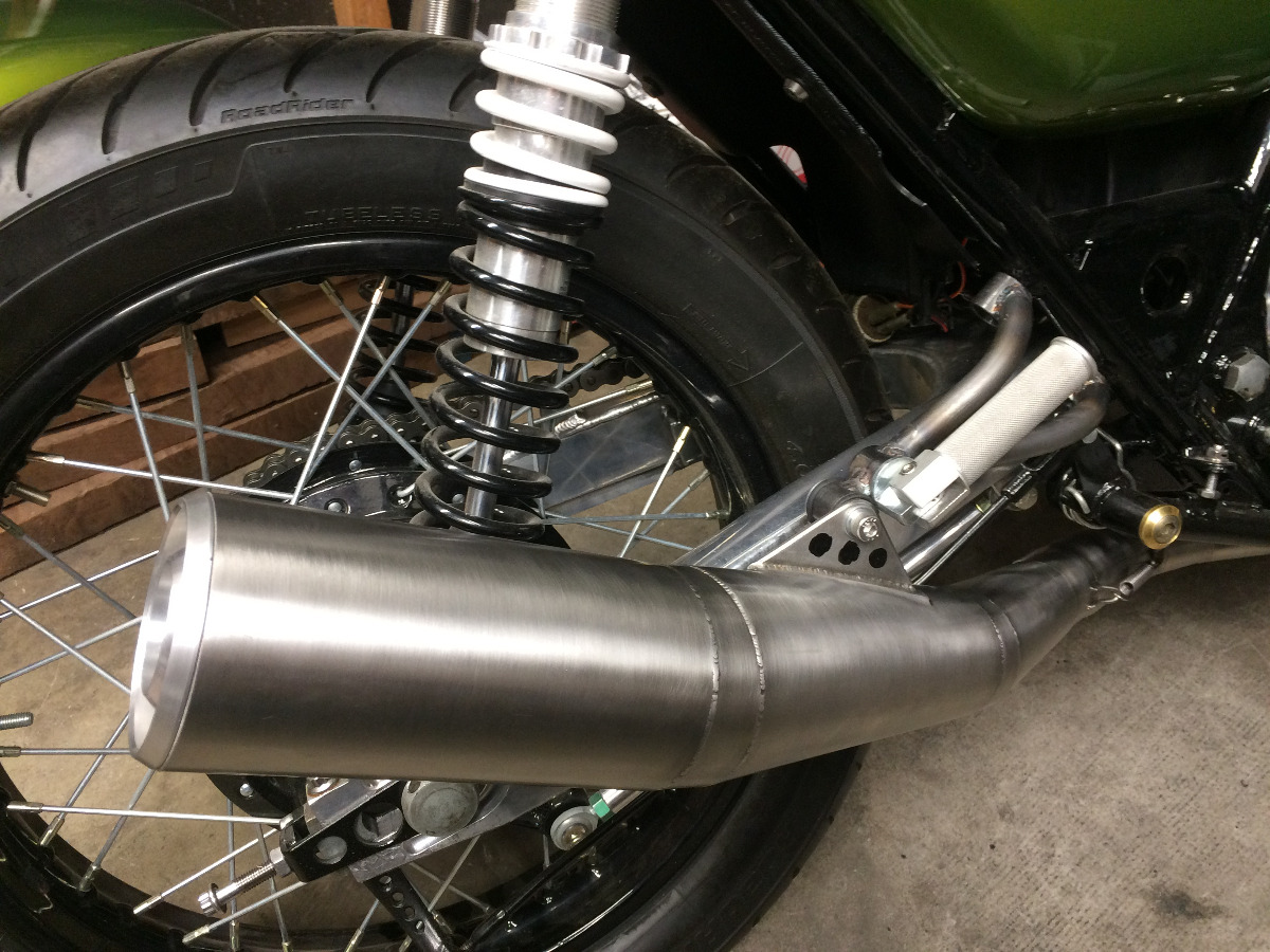

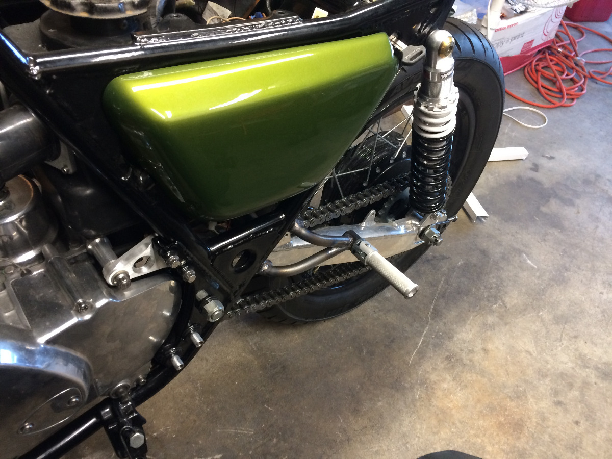

I definitely didn't make it easy on myself to pack the muffler with the kinks in the can. I bought a kit with stainless mesh, stainless mat, and fiberglass mat, its is in there very snugly. The perforated core isn't attached on either end but is wedged between the two ends, hopefully this will negate fatigue issues. I also finished the left passenger peg.
17 Jun 2017 04:56
The muffler is gorgeous, Doc! A work of art. Your'e almost there. Can't wait to see the photo shoot on this one.

One of my favorite builds.

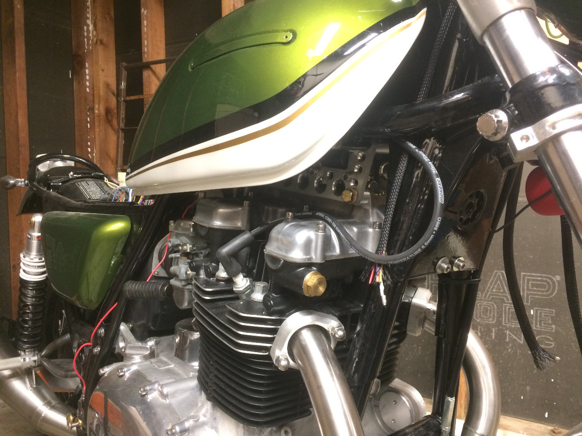

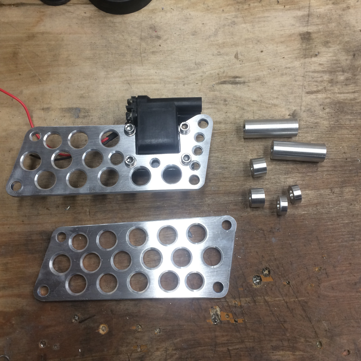

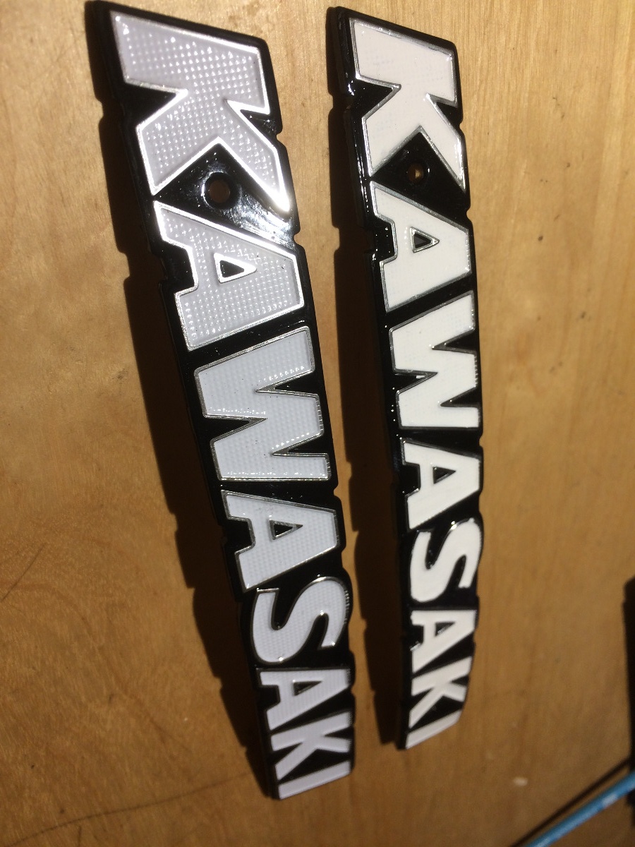

25 Jul 2017 00:25 - 25 Jul 2017 00:31

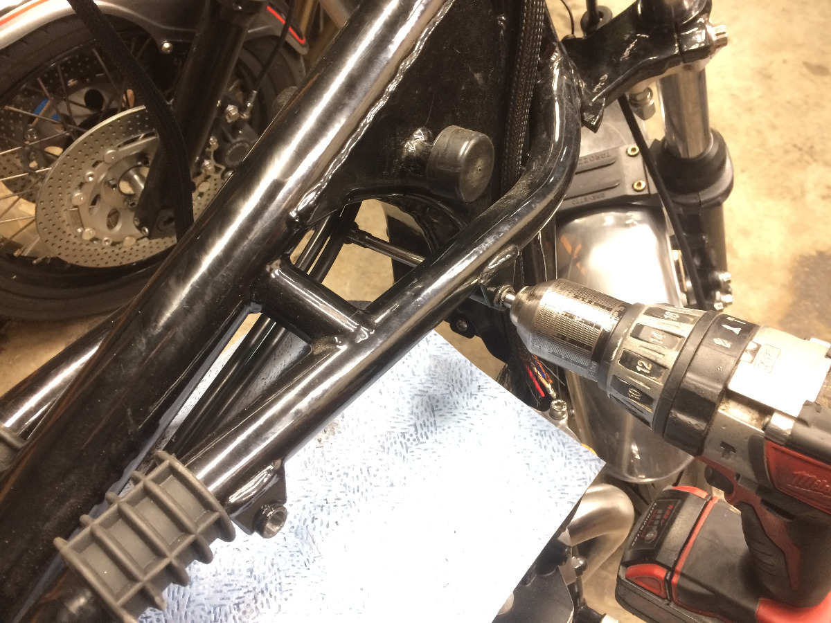

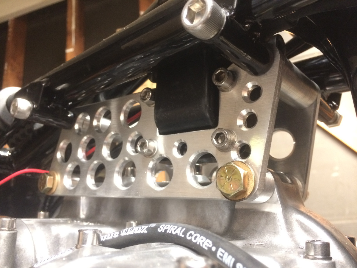

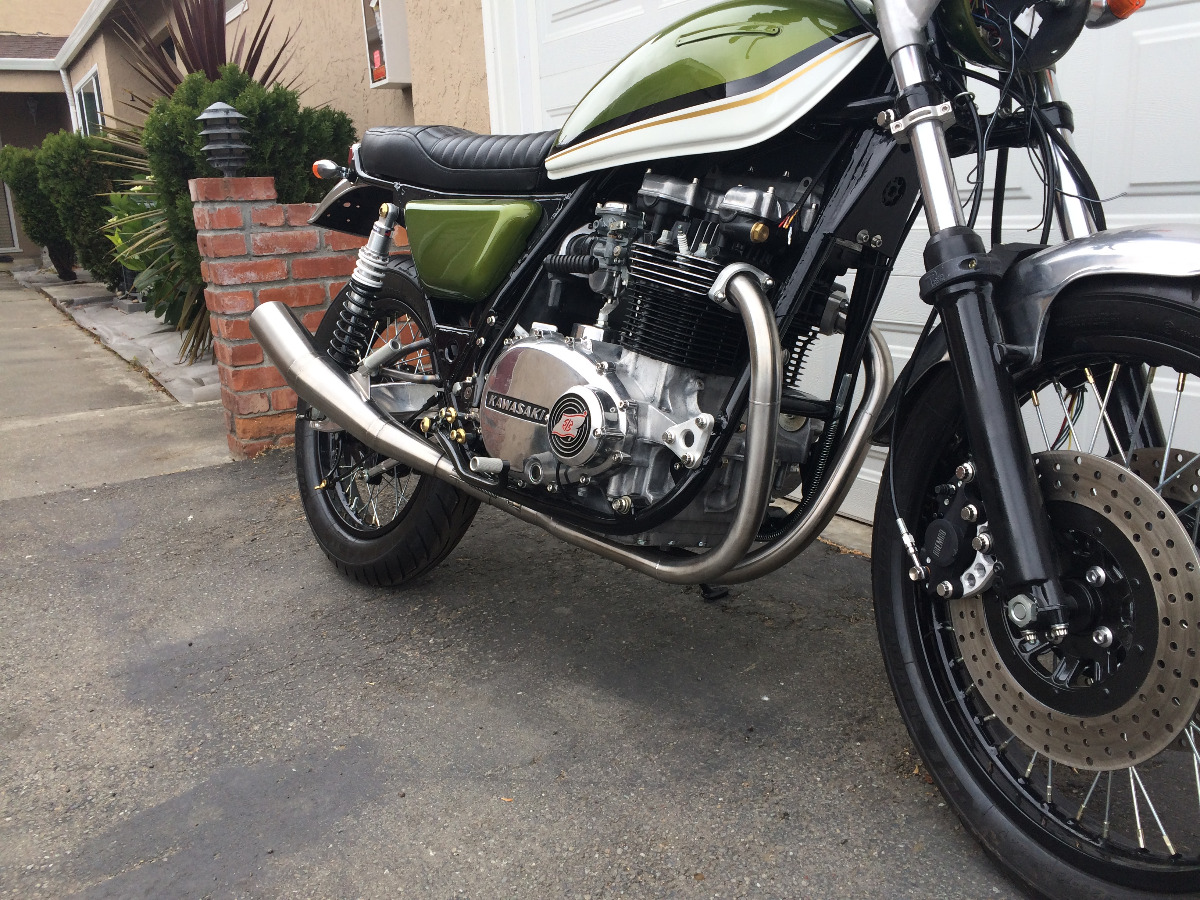

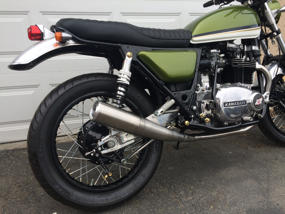

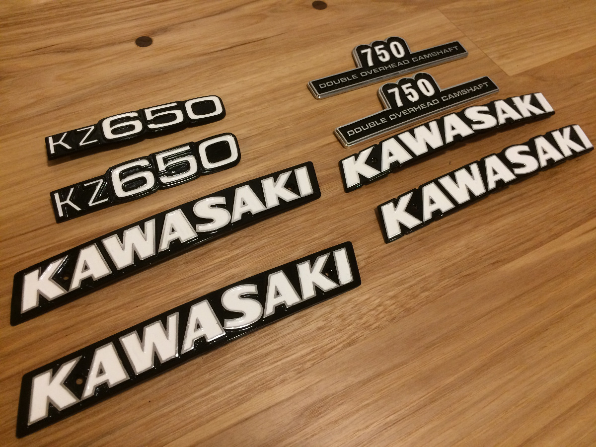

Got around to finishing the top motor mount. I ended up doing something similar to what NebrRex suggested. I used a 3/8" reamer in a hand drill to bore out the mounts and at the same time got them pretty close to axial, they were a little off before preventing a bolt through bolt mounts, so now I can through bolt side to side with spacers so it not only supports the motor but ties it all together and increases frame rigidity. I also milled the valve cover to remove the draft on it and now the mounting points are parallel. I ended up having to offset the coil to make clearance for the throttle cables and electrics that will go through the backbone as well. I like that you can see the mounts if you bend down to inspect the bike. I also refinished the tank and side cover badges I bought as I hate flat black paint, and the white didn't match the shocks or tank. details....
Last edit: 25 Jul 2017 00:31 by DoctoRot.
- Posts: 7442
26 Jul 2017 09:27
a very elegant solution sir!
