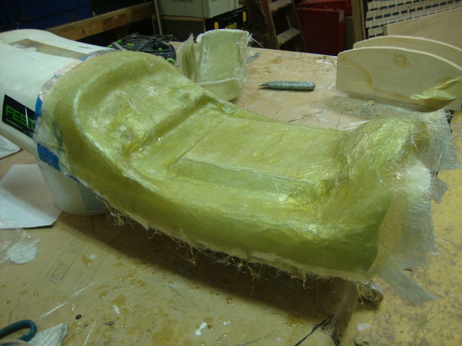

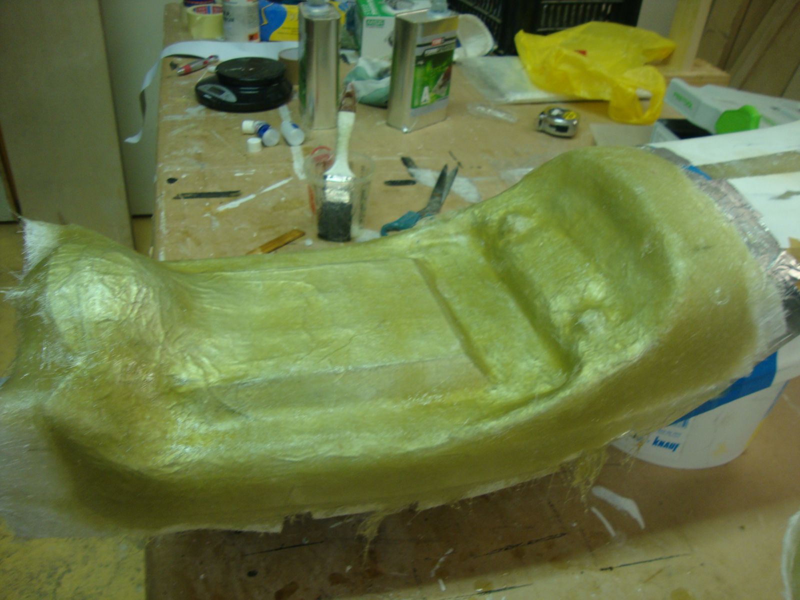

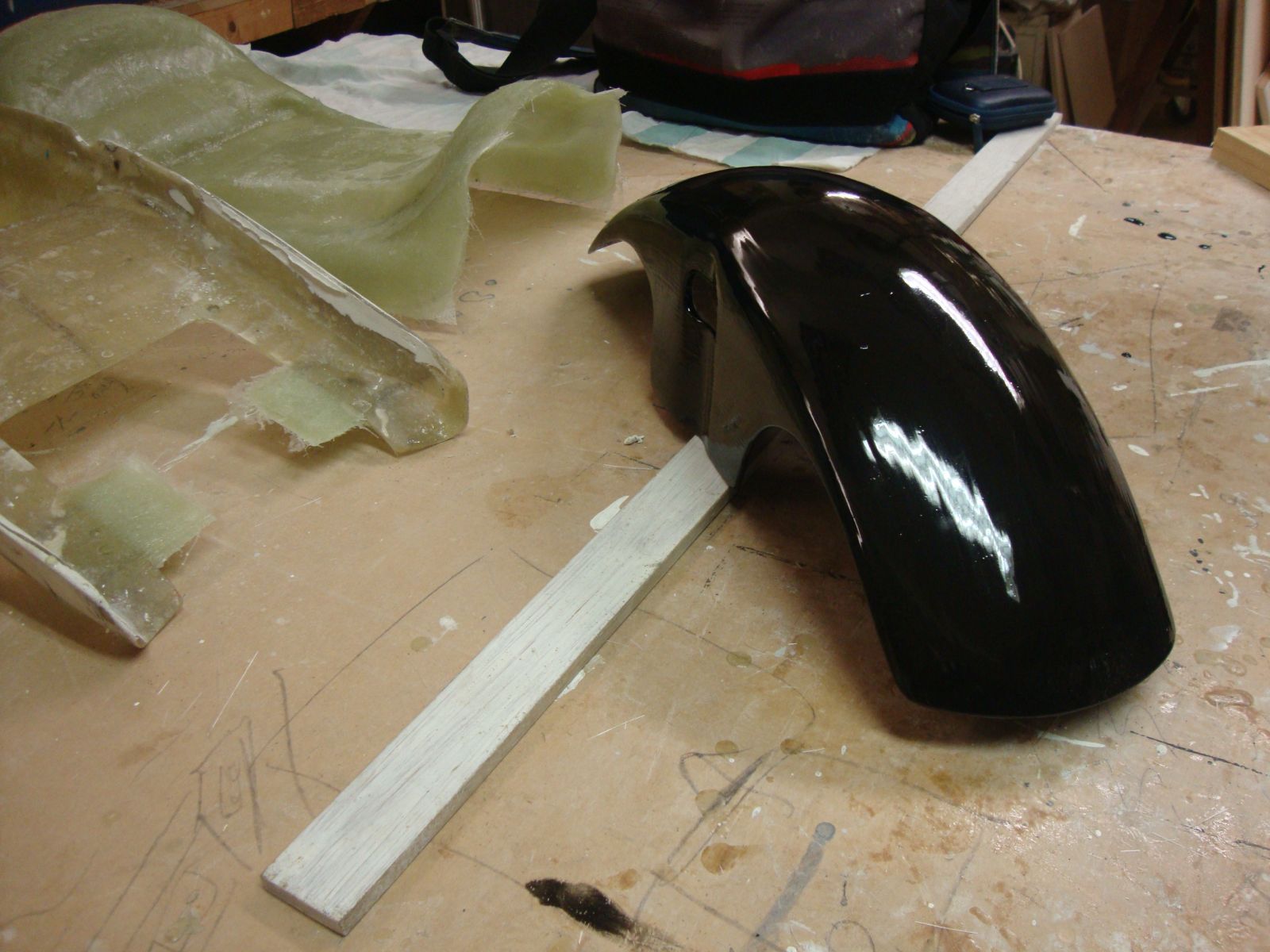

I got the mudguard beefed up a bit today with an extra couple of layers on the inside and around the mounting area
and I got the seat pan done,or at least started.Though I put quite a few layers on it so hopefully itll be enough.
Then I ran out of hardener,so thats it for today.

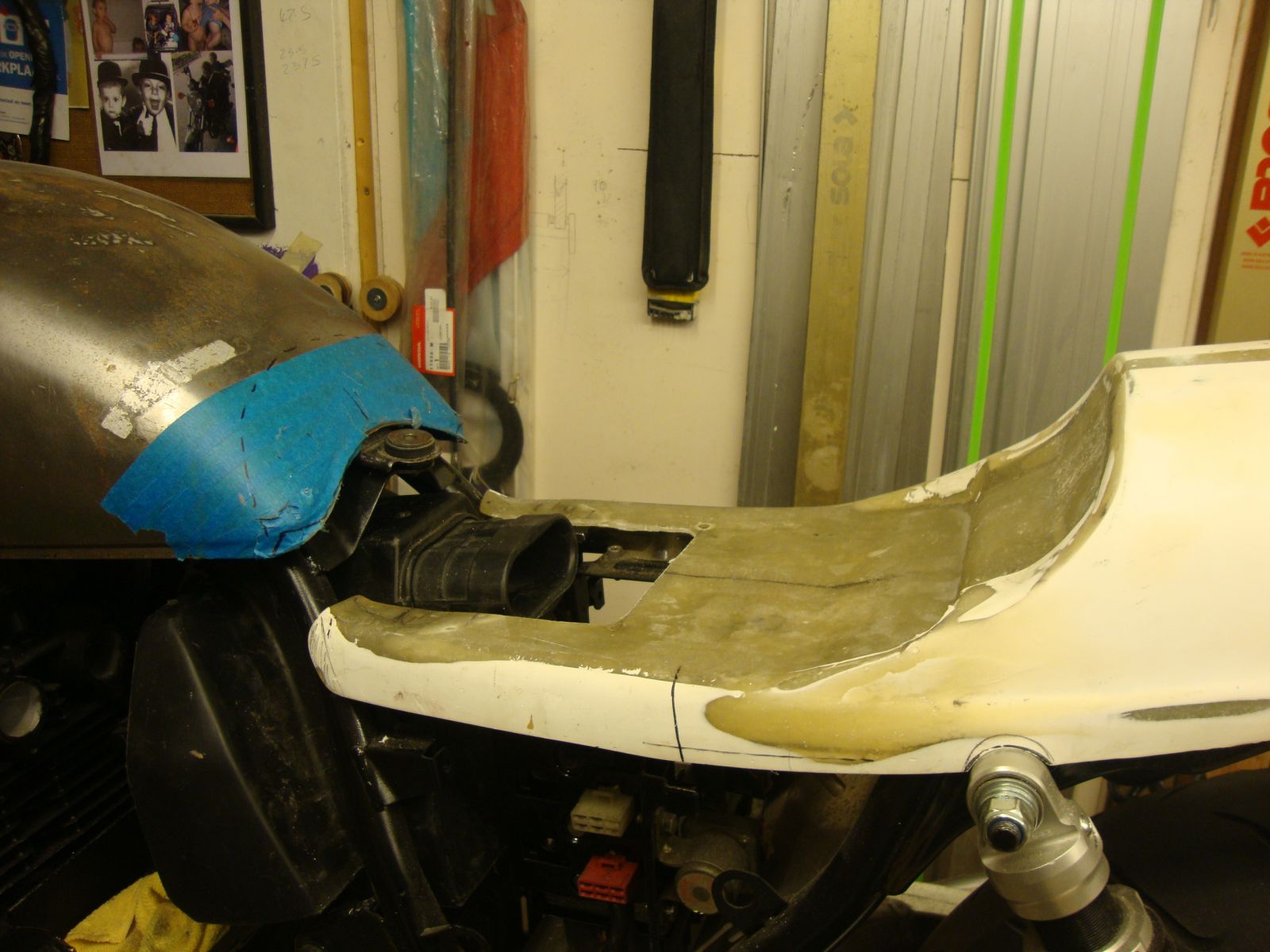

So I gave the seat pan a quick trim,just roughly for now and brought it home to check how it fits. Seems ok. Heres the tail unit with the airbox inlet.

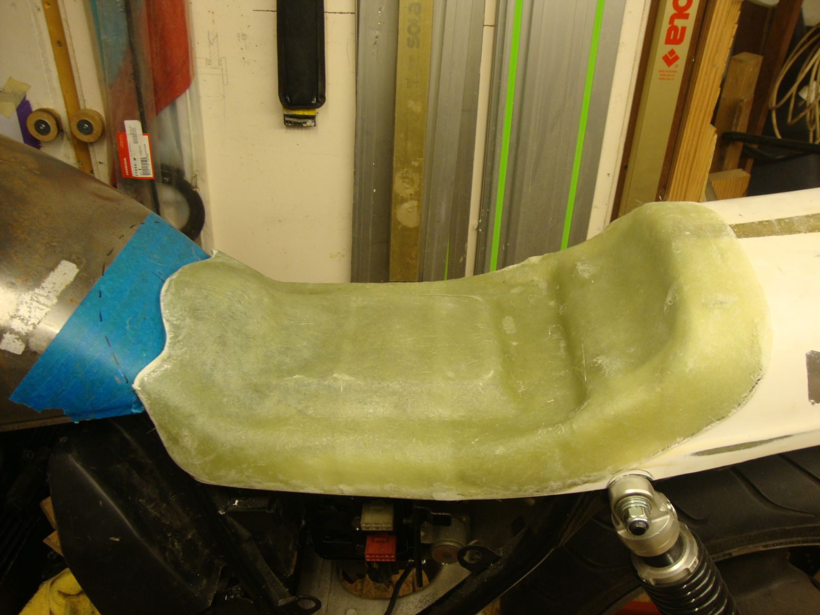

and heres the seat pan
I need to trim a bit where it meets the tank,should be able to get it in a tad neater and the edges will be trimed back all the way around. I might even lay some more fiberglass around the edge so that I can get it nicely rounded to prevent it cutting into the vinyl but thats for later.
For now Ill leave it overlength as I want to build a box around it for my next stupid idea.

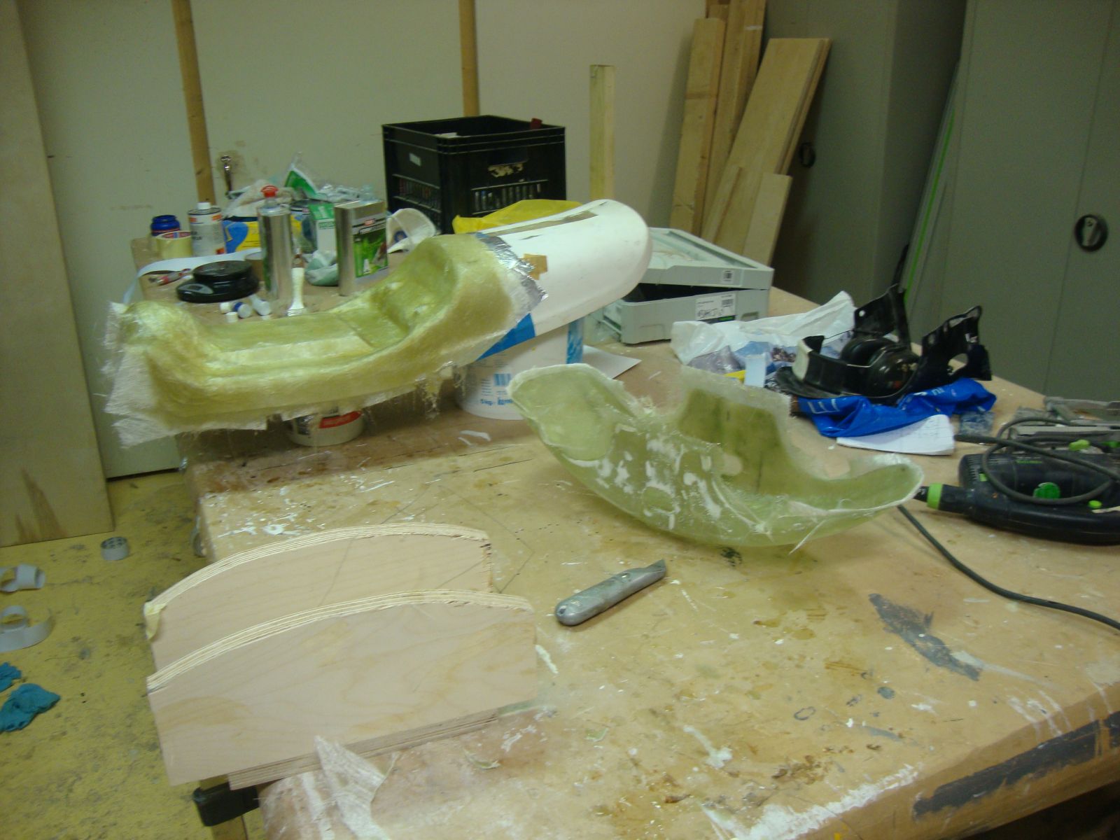

OK.Now Im getting sick to death of fiberglass!! Its neverending. I got everything sanded and preped (tail section/seat pan/mudguard).
The tail section ,I had to add a couple of tabs to bolt it down at the front. The seat pan,I laid on some extra fiberglass around the edges to thicken them up a bit. The mudguard,I put on the second gelcoat.This time with a black pigment mixed in.I was hoping that it would level itself
so that I could maybe get away with not painting it but it dosent. The brush strokes are still very visable
So Ill have to sand the bugger back again.Get the brush strokes out then paint it.
Seat pan still needs sanded and trimmed,Maybe Ill put a gelcoat on that as well,dont know yet and the tail piece needs a bit of a trim then some final filling and sanding. Again.
When will it end?!!!!!
