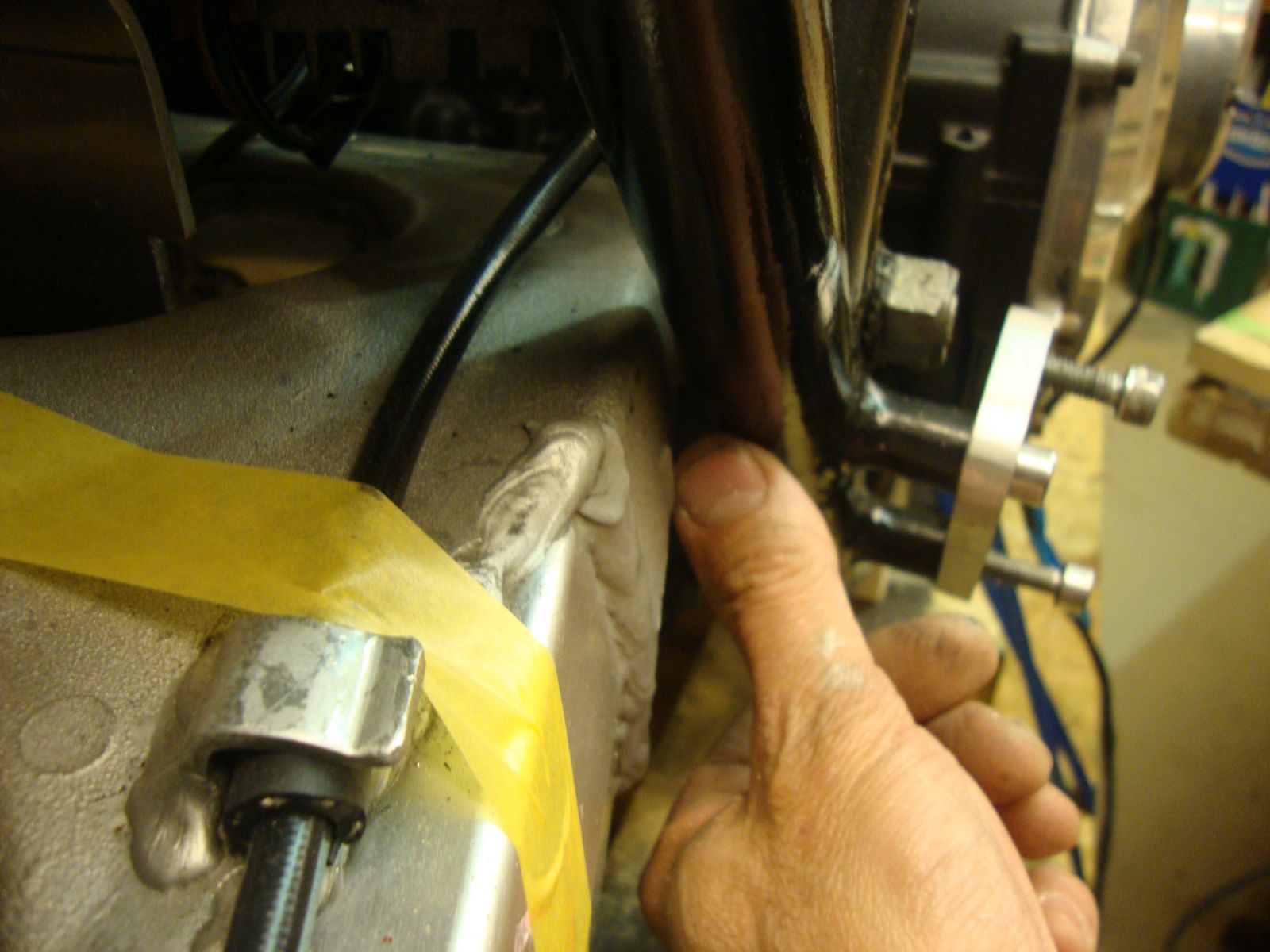

Then theres the swing arm.I was not happy with the clearance on the right hand side twixt the swingarm and the frame down tube.There was space but very little and any travel in the shock would have seen the arm wedged up against the frame.
I dropped the wheel out,pulled the shocks off and had at it with the grinder. I calculated a maximum 'swing' upwards of 8cm +- ,this would be the maximum travel of the shock at the most extreme. I managed to shave off just enough for about 10cm travel. Plenty.
Shocks back on,wheel in.Job done.

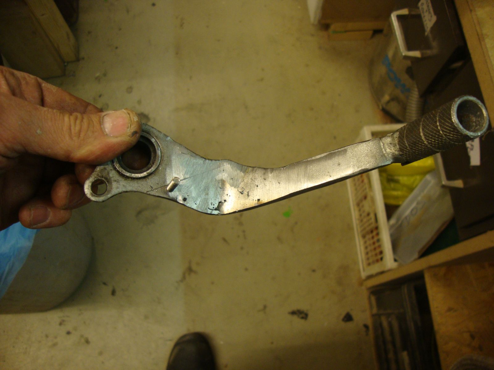

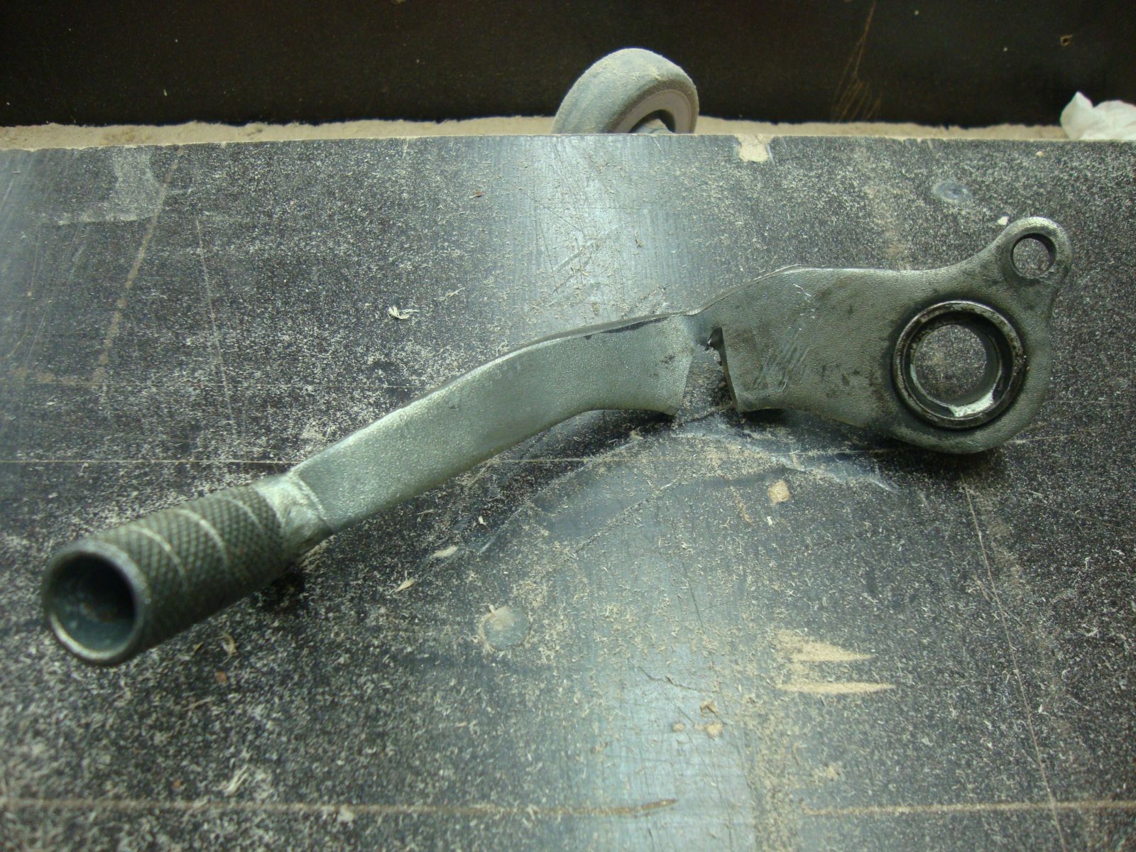

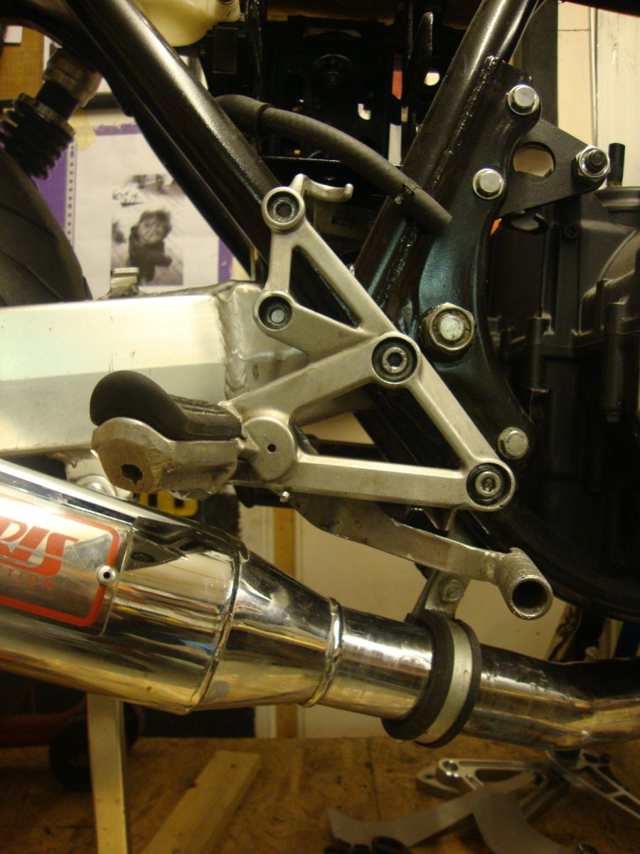

Next was the exhaust bracket. Im not happy with it and Im sure I can do something better. As I was staring at it,the back brake rearset started laughing at me.
Ive explained the problems earlier in this thread,so I wont go through it again but as it stands the brake pedal clears the pipe,which is what I was after but the rider position is not too good and my knees are almost touching the corners of the head.

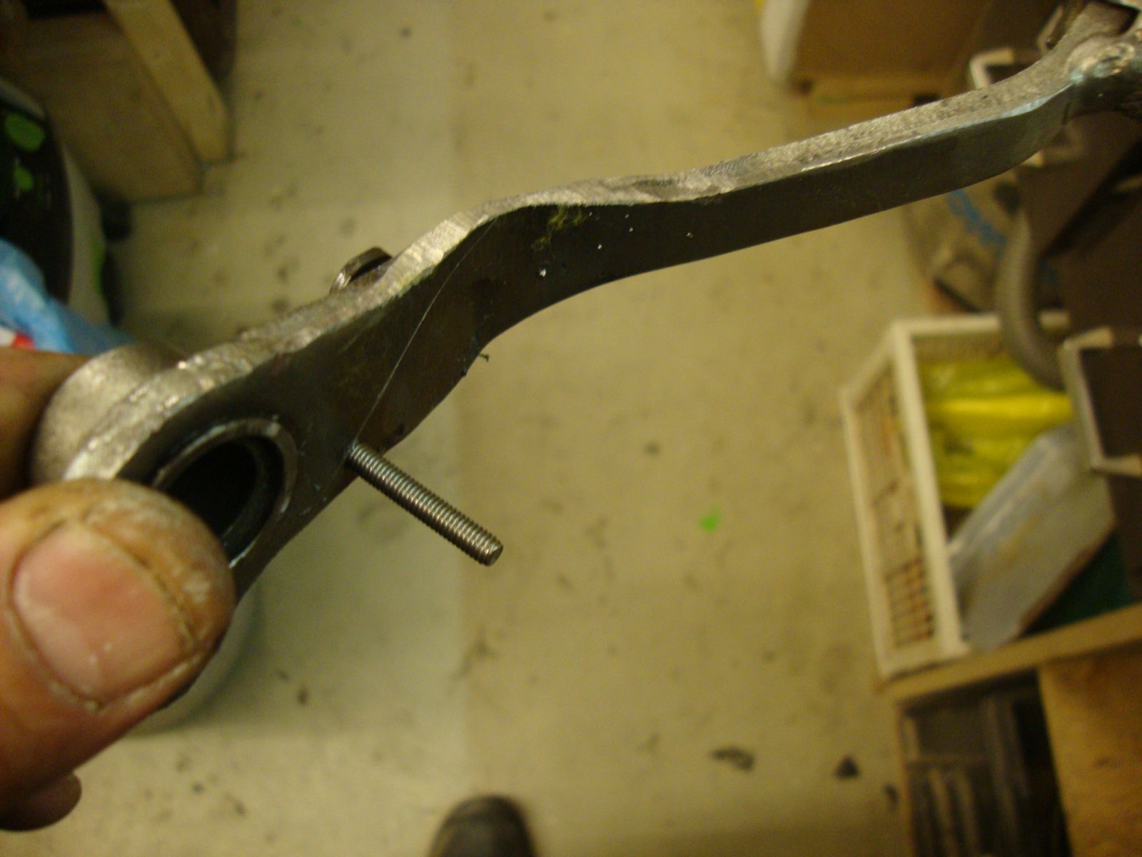

So,I had a thought. I took it off,took off the adapter plate that I made and took the grinder to the brake arm. I ground a bit off the bottom,opened it up to get the right position and welded it.
I drilled a small hole and tapped in an M4 bolt as a stopper,to keep the return spring under a bit of tension
and it works! Peg position is good and comfortable .Plenty of space twixt knees and engine and the brake lever has enough swing without hitting on the pipe! Result. Finally,its done and out of the way.

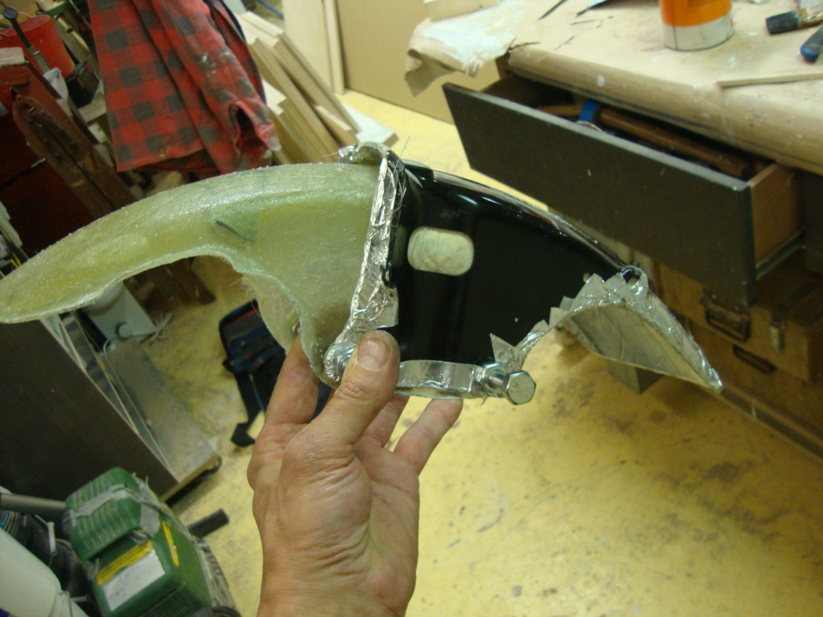

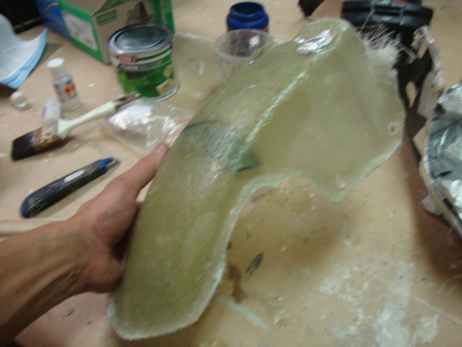

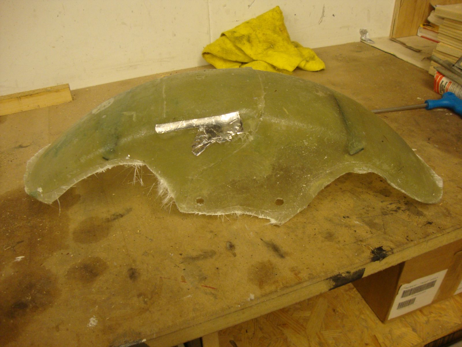

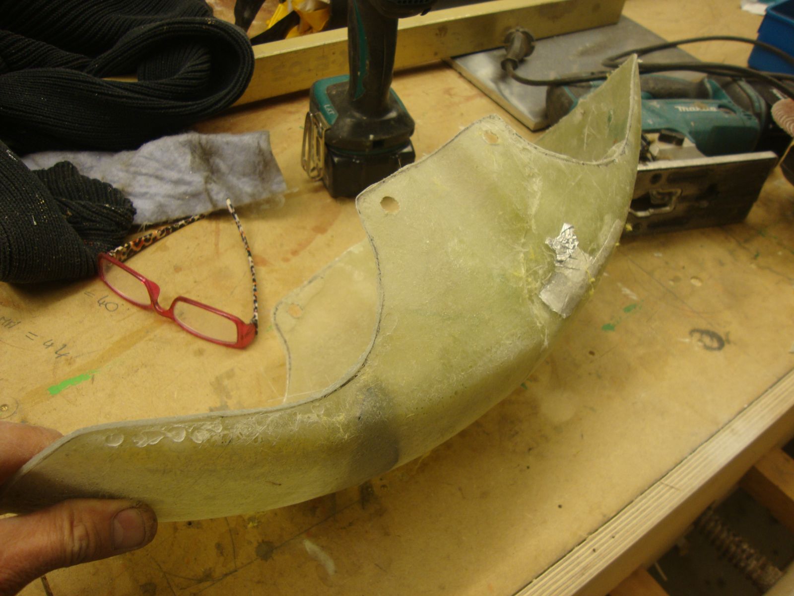

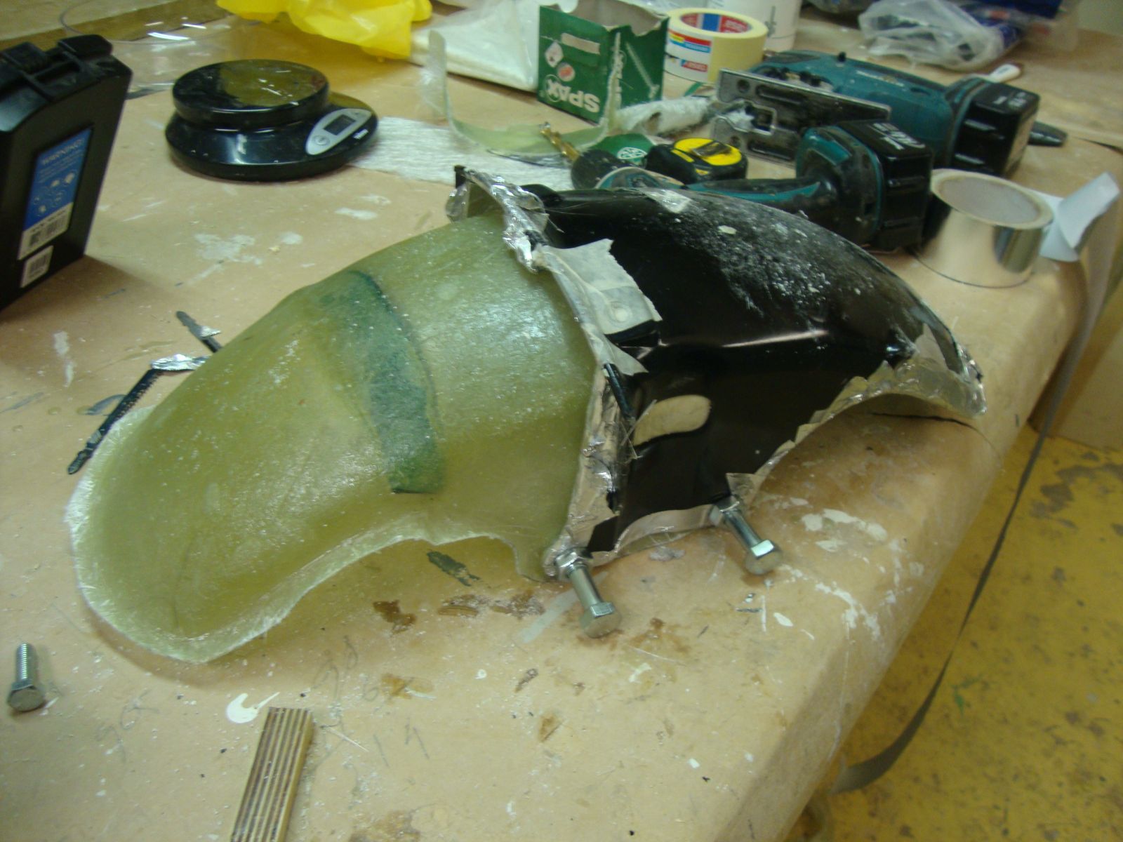

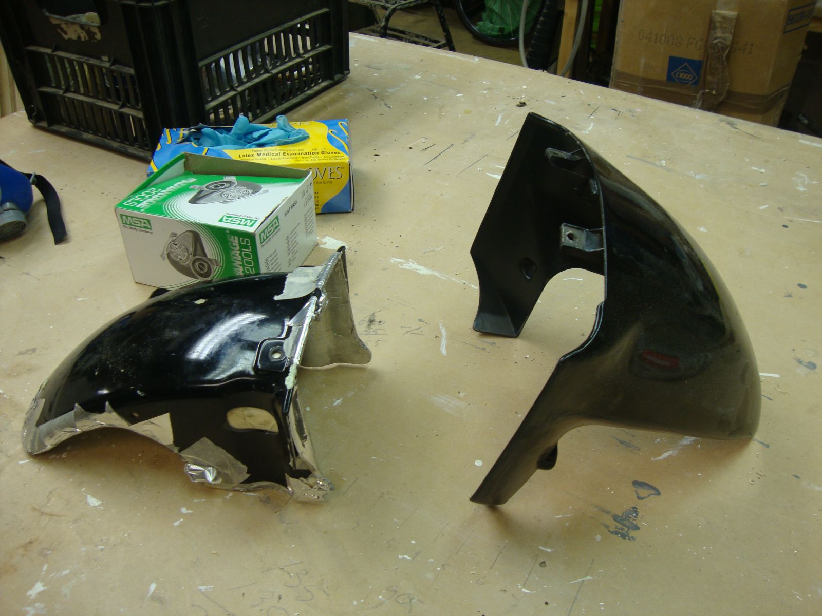

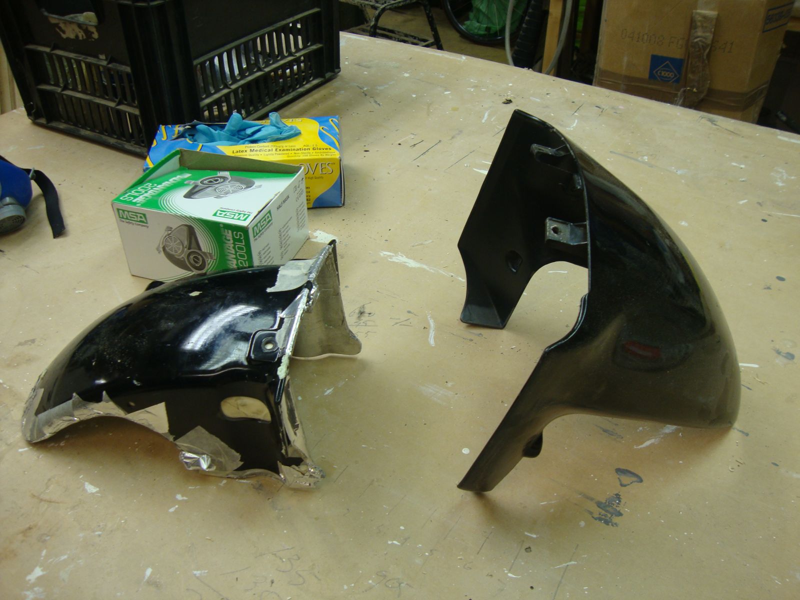

In the meantime,I had a go at the front mudguard. I didnt like the ZXR mudguard. The back is ok,quite normal looking but the front looks like Darth Vaders hat.
So I got the fiberglass out and made a mold of the rear section
Then I turned it around and bolted it back into the original and made a second part
Some bolts to keep the mounting holes lined up

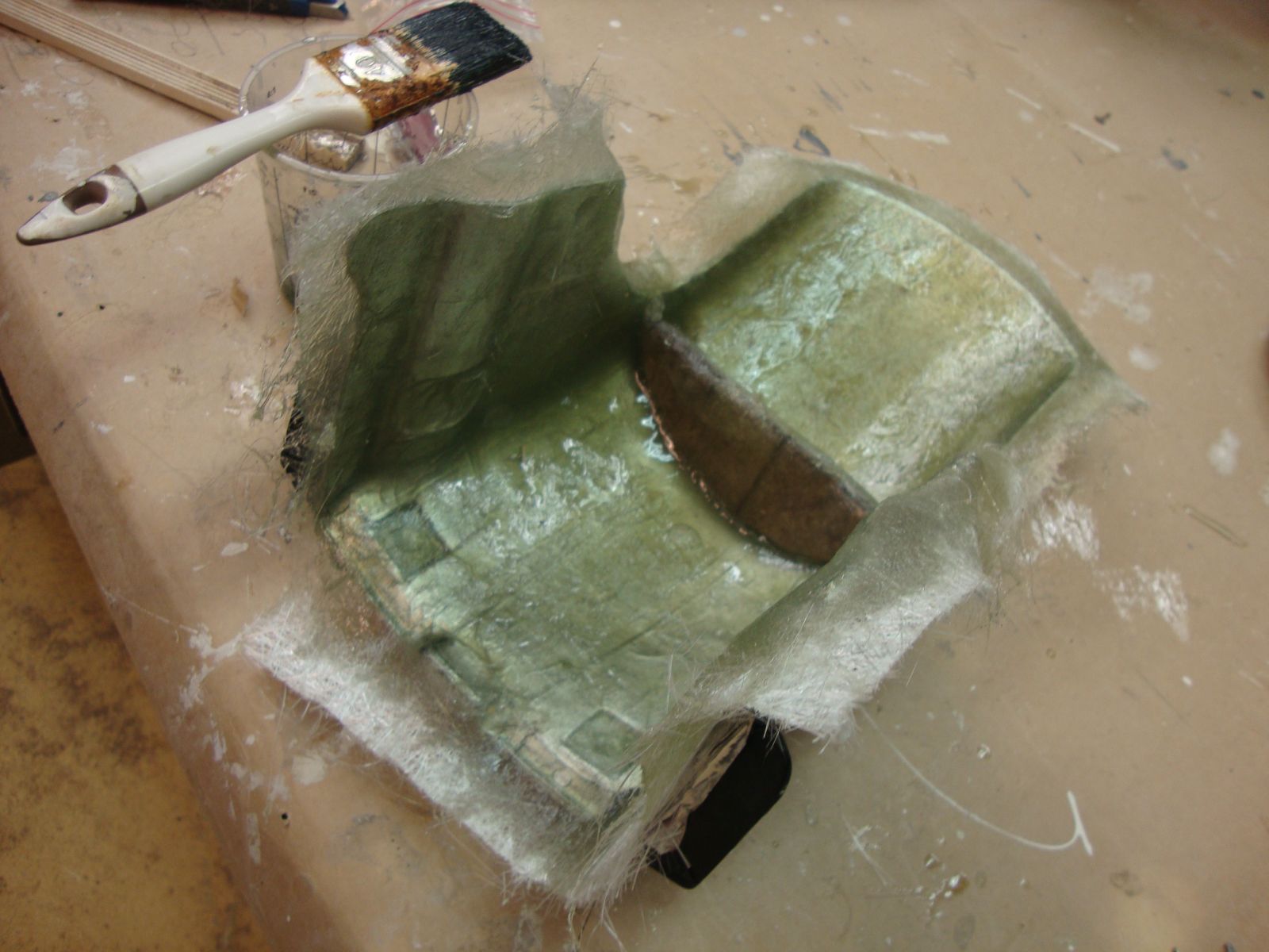

and hey presto! A mold for a new mudguard.

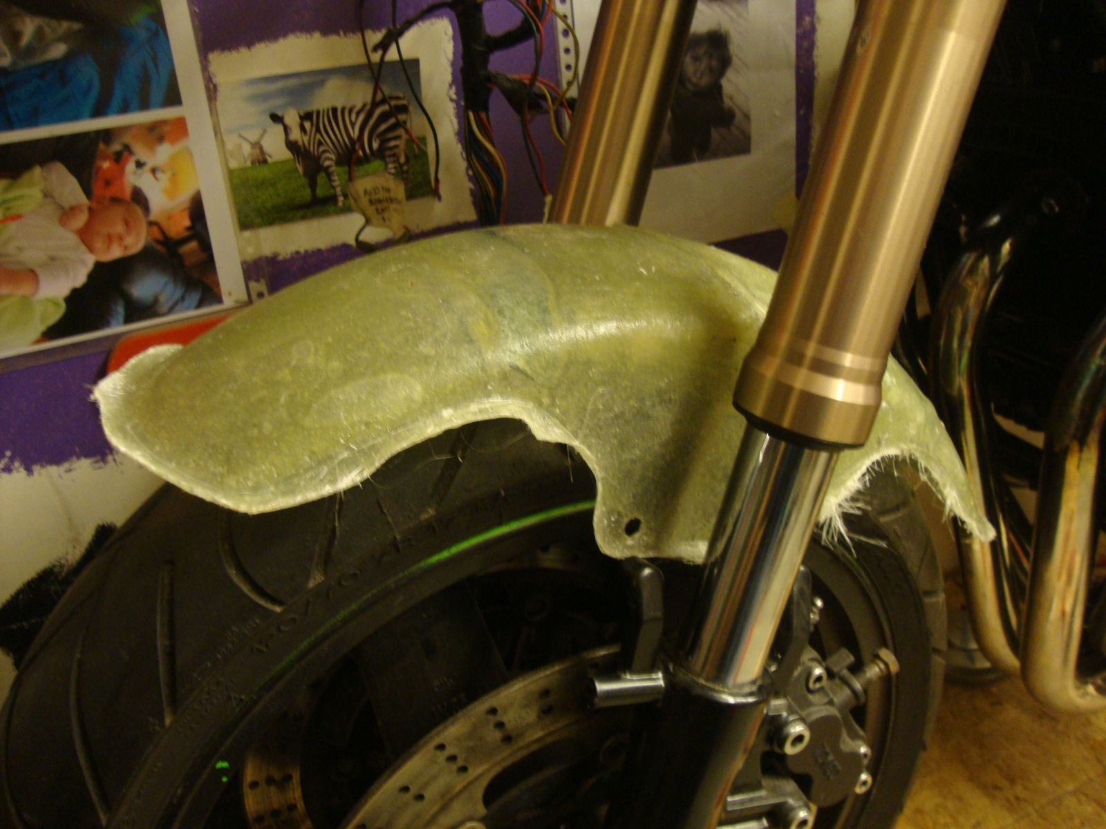

It wont fit down over the wheel because I put some cross bracing in to stiffen it up a bit.Looking like it will fit nicely though.
A trim on the edges
A bit of a tidy up and Ill be able to cast the real thing.
Another thing for the list of half done Things!!
A trim on the edges

hell yes!
that turned out a really nice shape.
that might be something some other folks might like to use on there front end conversions :whistle: .
i'm currently gathering parts for a cafed cb750 w/ modern front end (busa) with a custom arm and busa rear wheel,
with a classic cafe top line for a guy.
i have been exploring front fender options that will fit with the cafe treatment and the modern front end 17 inch wheel combo.
Last edit: 30 Oct 2015 03:33 by 531blackbanshee.
- kaw-a-holic
- Posts: 1808
- Thanks: 249
Re: CSR1000 Project Build
30 Oct 2015 04:05
Wow! Nice work on the fender Davido. After it's painted it will look like it was factory.
