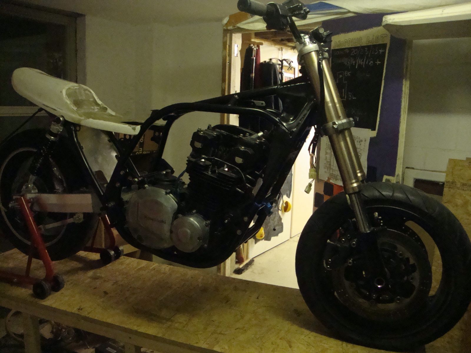

For now,Many other things to do. As I mentioned earlier,I always seem to be jumping from one thing to another so today,I jumped back to the headlight bracket.
Having the ZXR front end meant that the original bracket was not going to work. I did like the look of it though and I really didnt want to buy some off the shelf caferacer things so I went done did this;
I cut the bottom off the original bracket,bent some steel bar and welded it up to lengthen the whole thing. Ive also welded a plate on the bottom (not in the photo) which Ill drill a couple of mounting holes in and it all should fit nicely on the ZXR front end.A bit of a scrub and ill powdercoat it next time im at the bike shop. This means Ill be able to mount the original headlight with no problem.
Itll all become clearer once its all together and mounted.

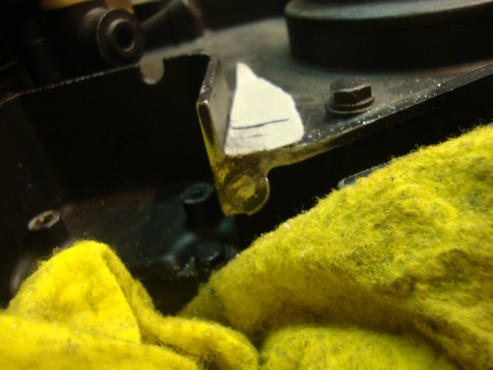

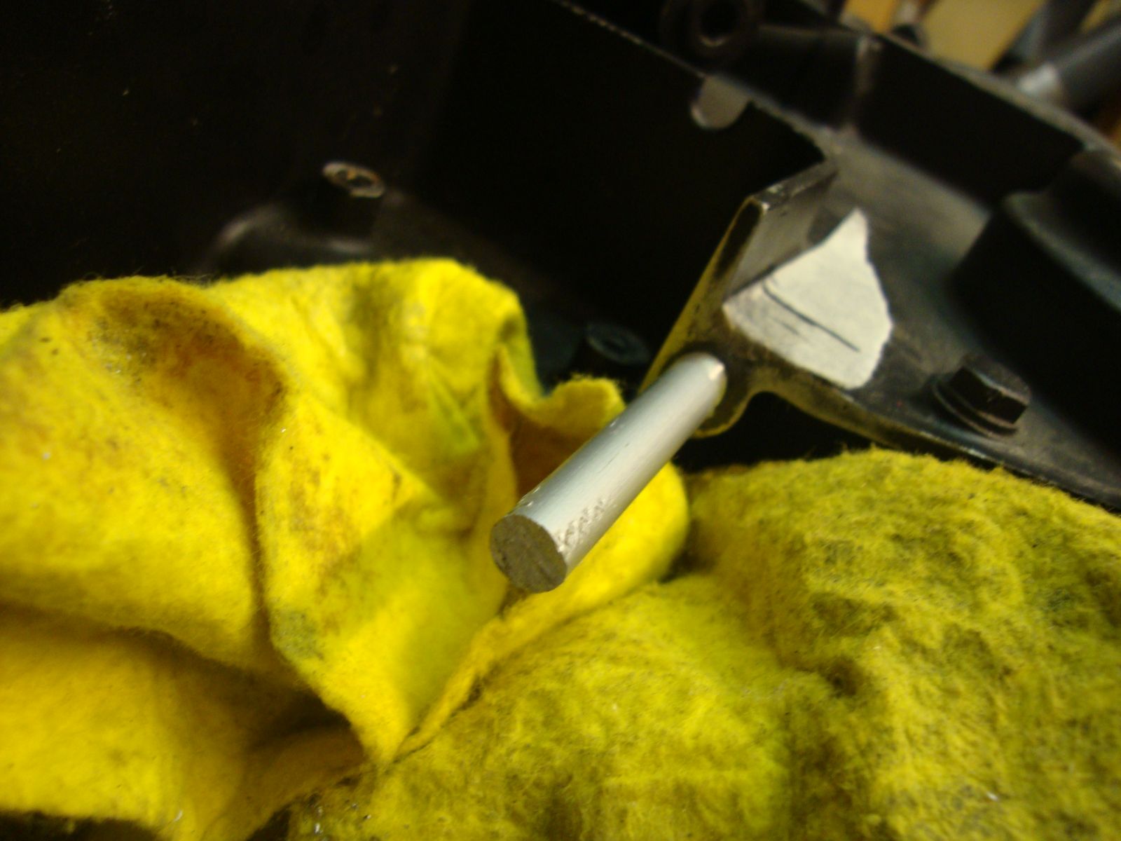

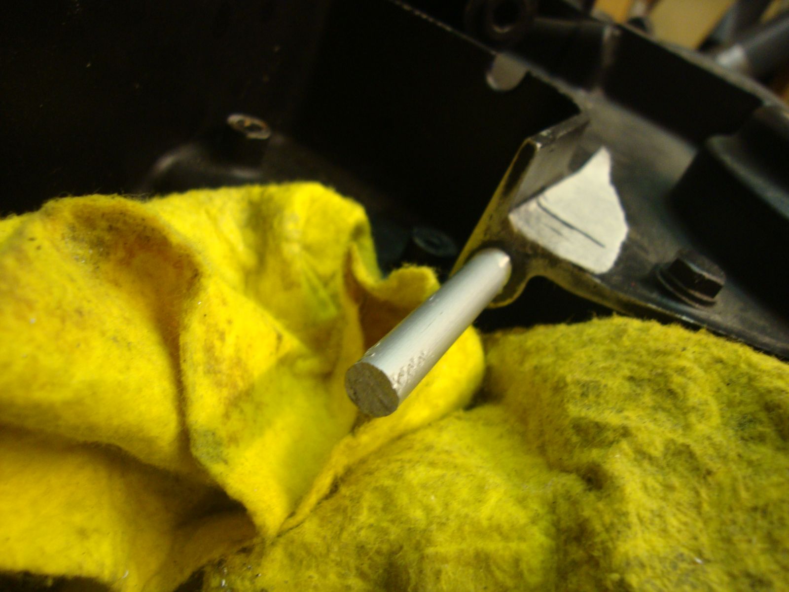

The stripped thread on the front sprocket cover turned into a real little bastard and got the better of me in the end. I couldnt get it drilled out more than 11mm+-. So,I went with that.I drilled it out and rethreaded it to M8 and threaded a piece of aluminium rod which I screwed in and cut off flush. I left it for the thread lock to set and Ill redrill and rethread it to take the original M6 bolt and hope the little bugger holds.

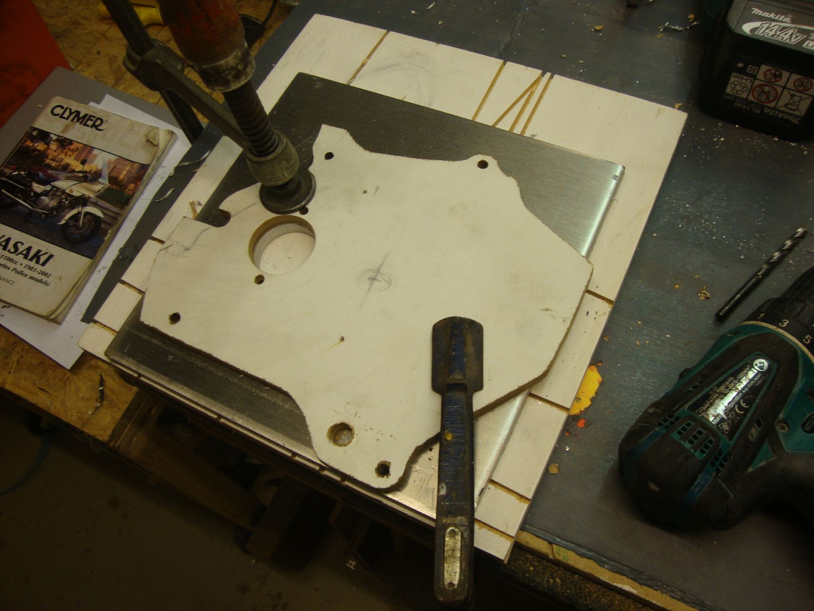

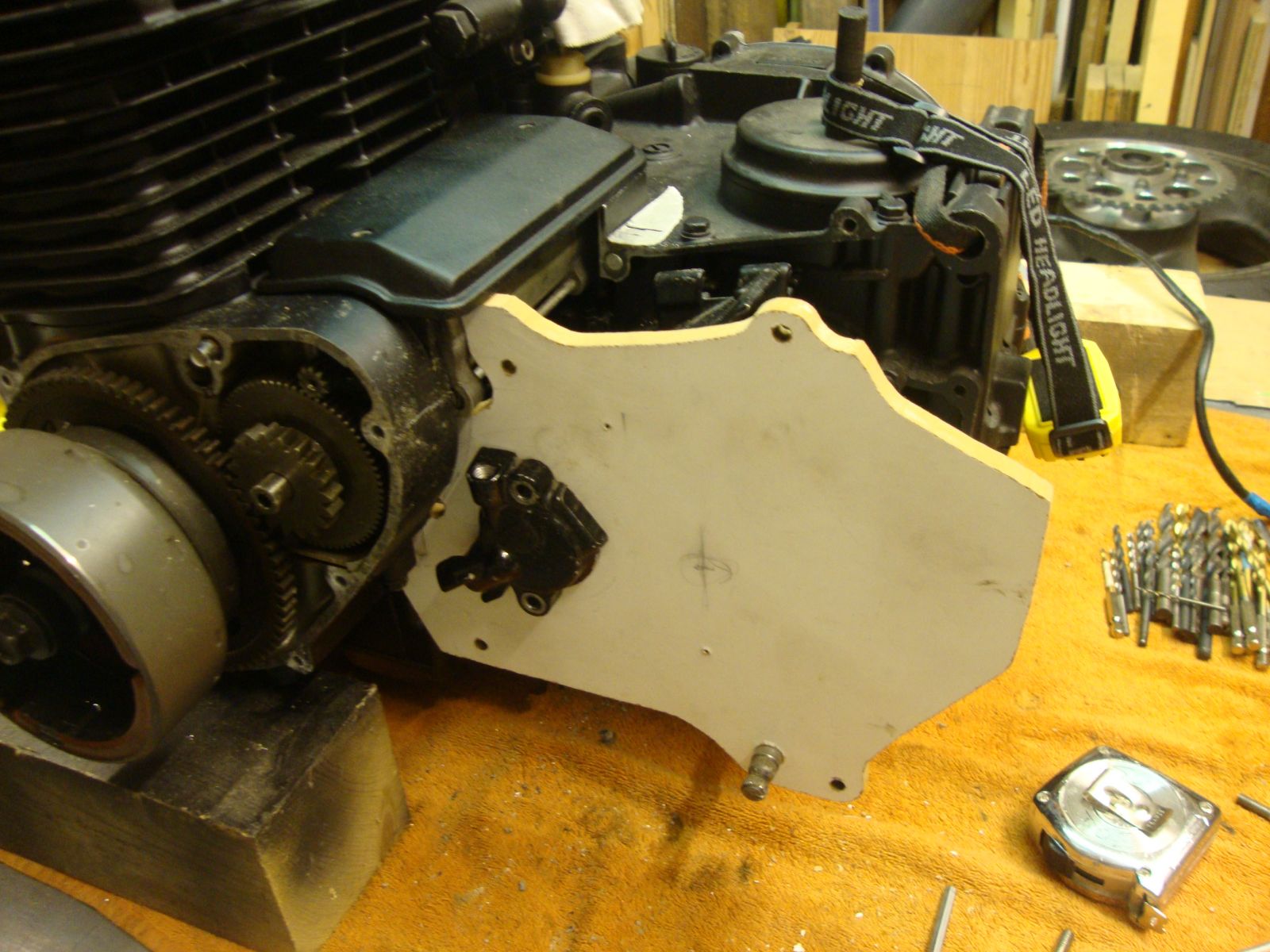

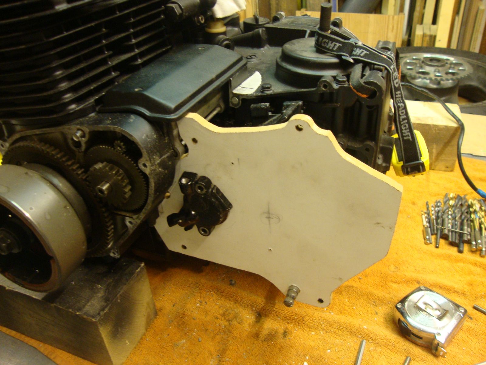

I messed around a bit with the MDF template for the clutch conversion and spaced it more or less where its going to end up.
Im still not convinced on the final profile,maybe Ill wait till its in the frame before deciding. I started to drill out the holes anyway. I needed a 12mm drill for the shift shaft so I went off to the shop and bought a 14mm drill ??????!!!!! My head is just not on straight at the minute!

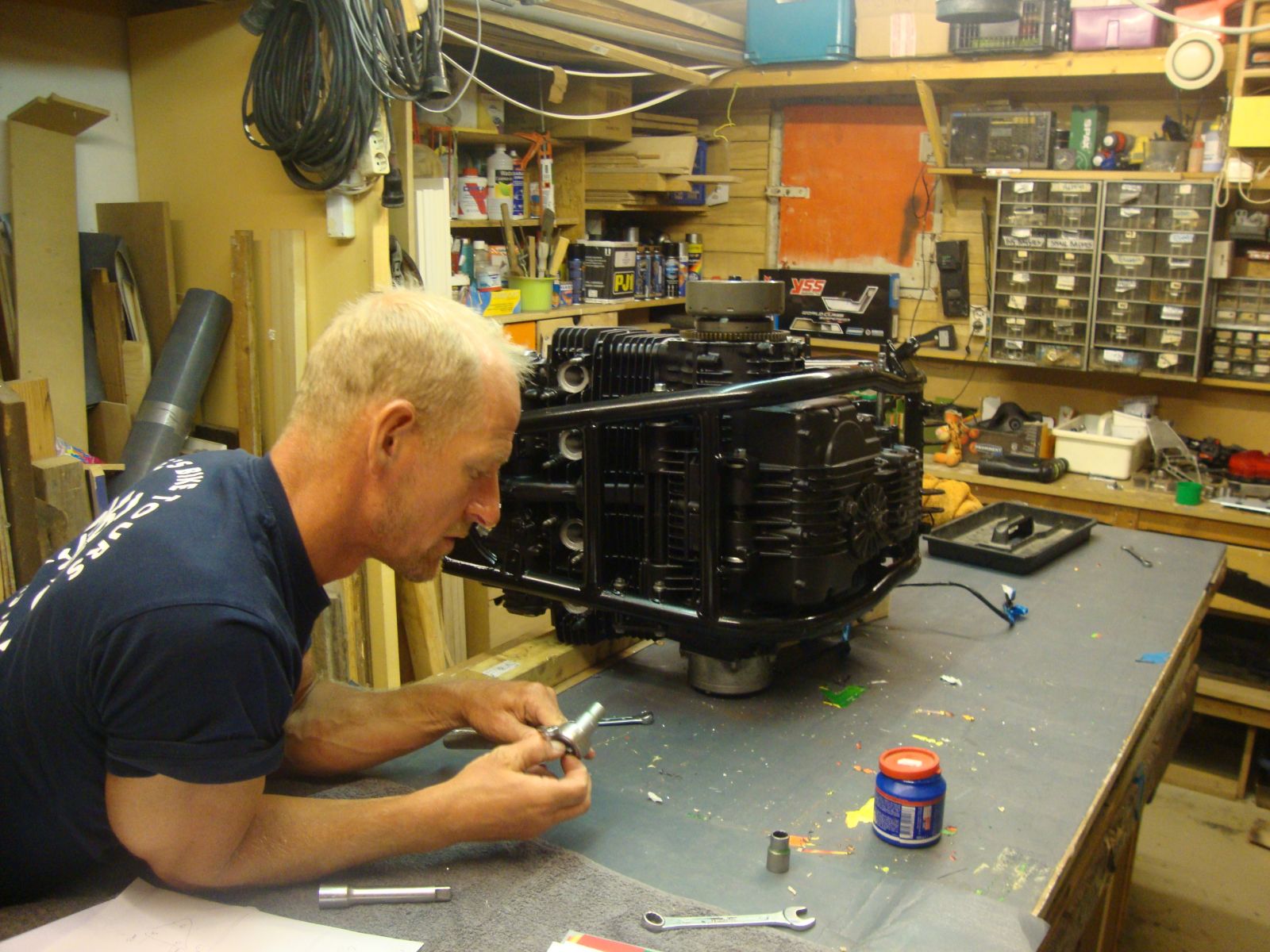

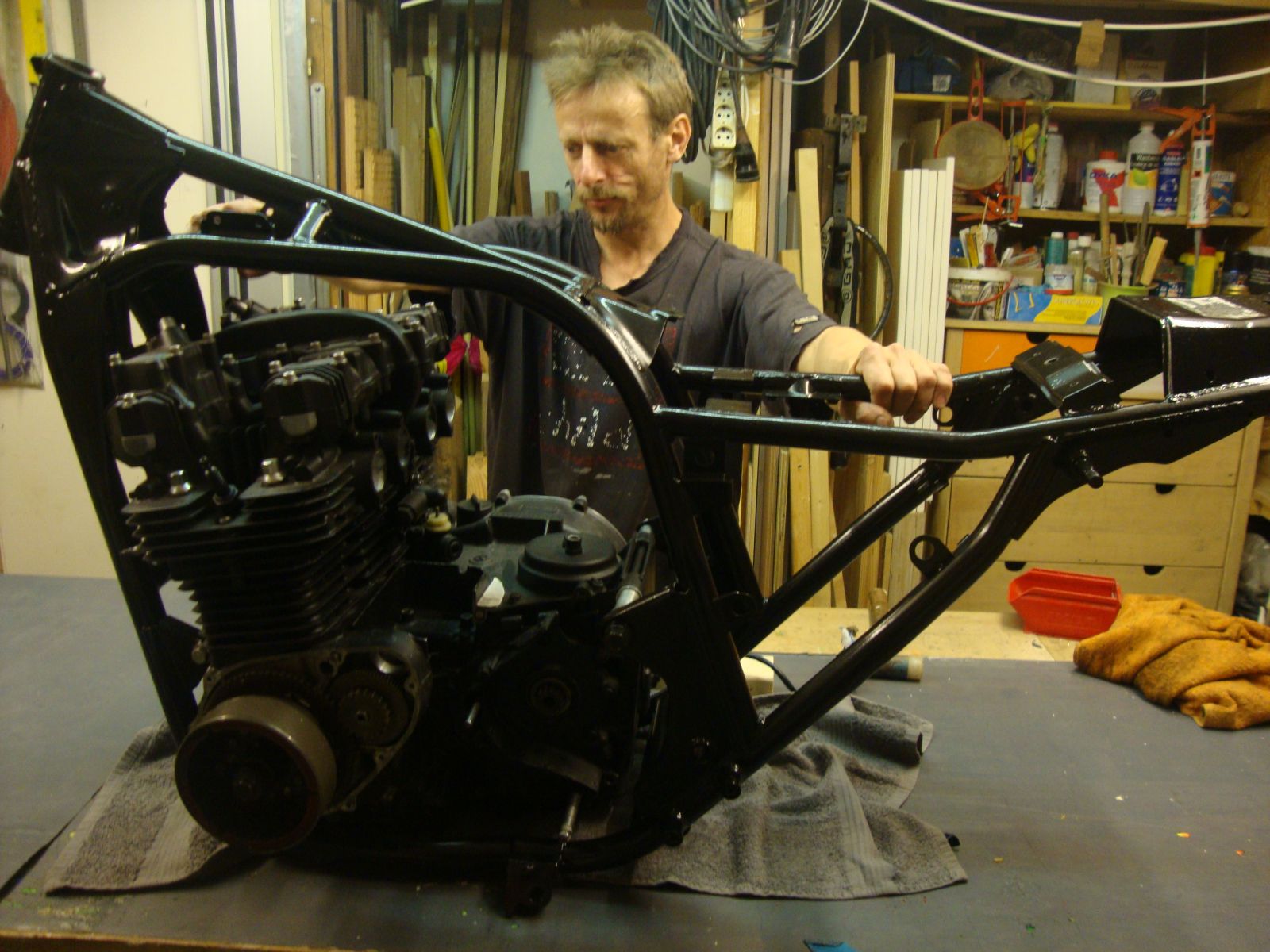

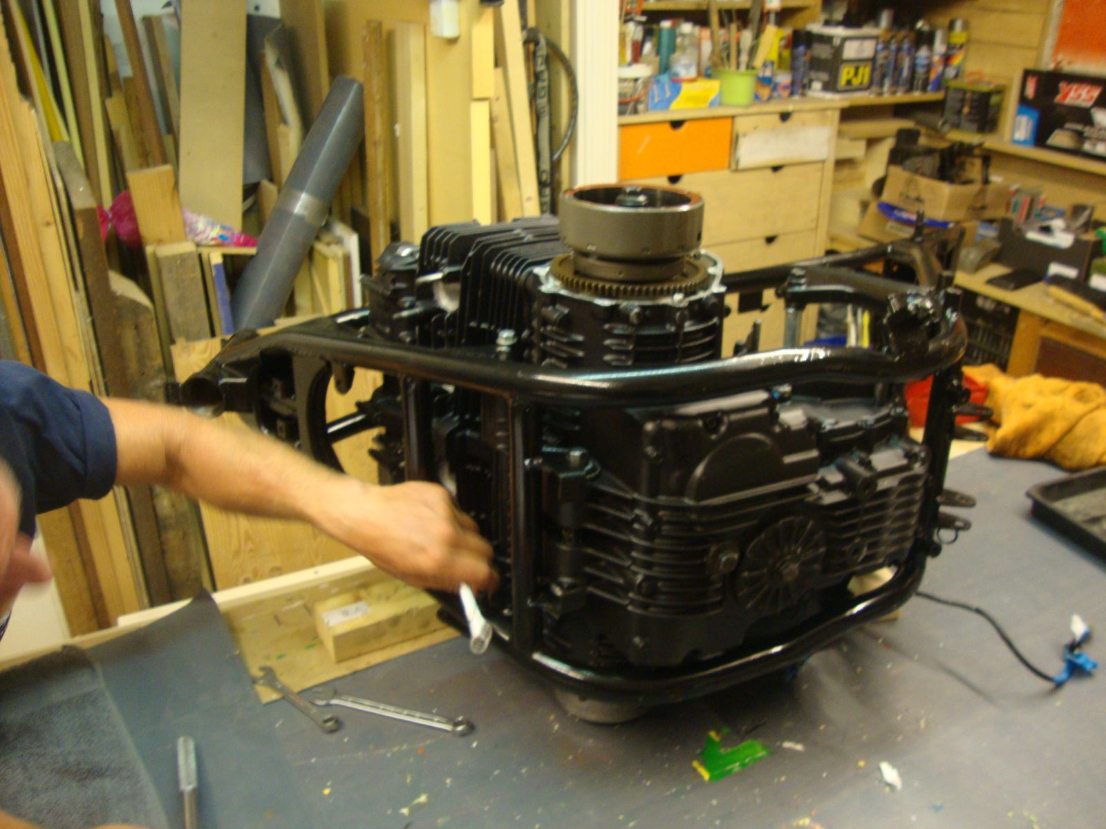

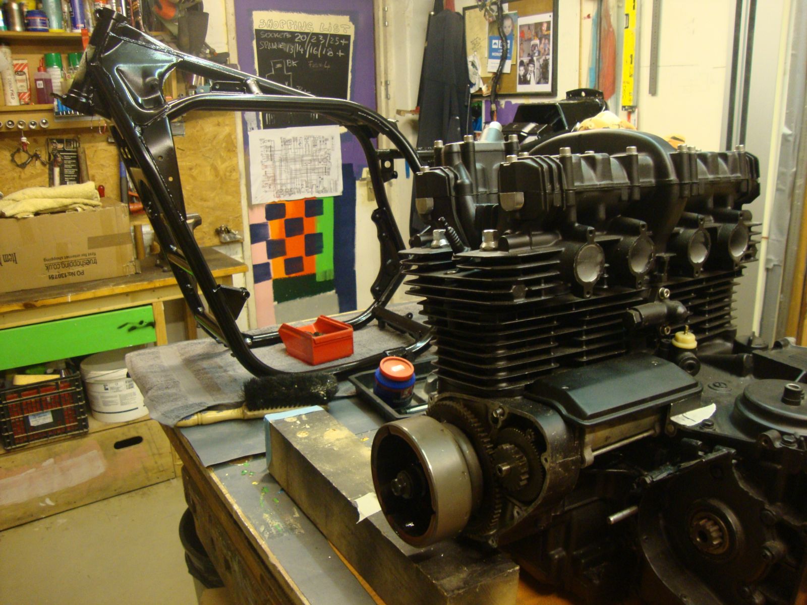

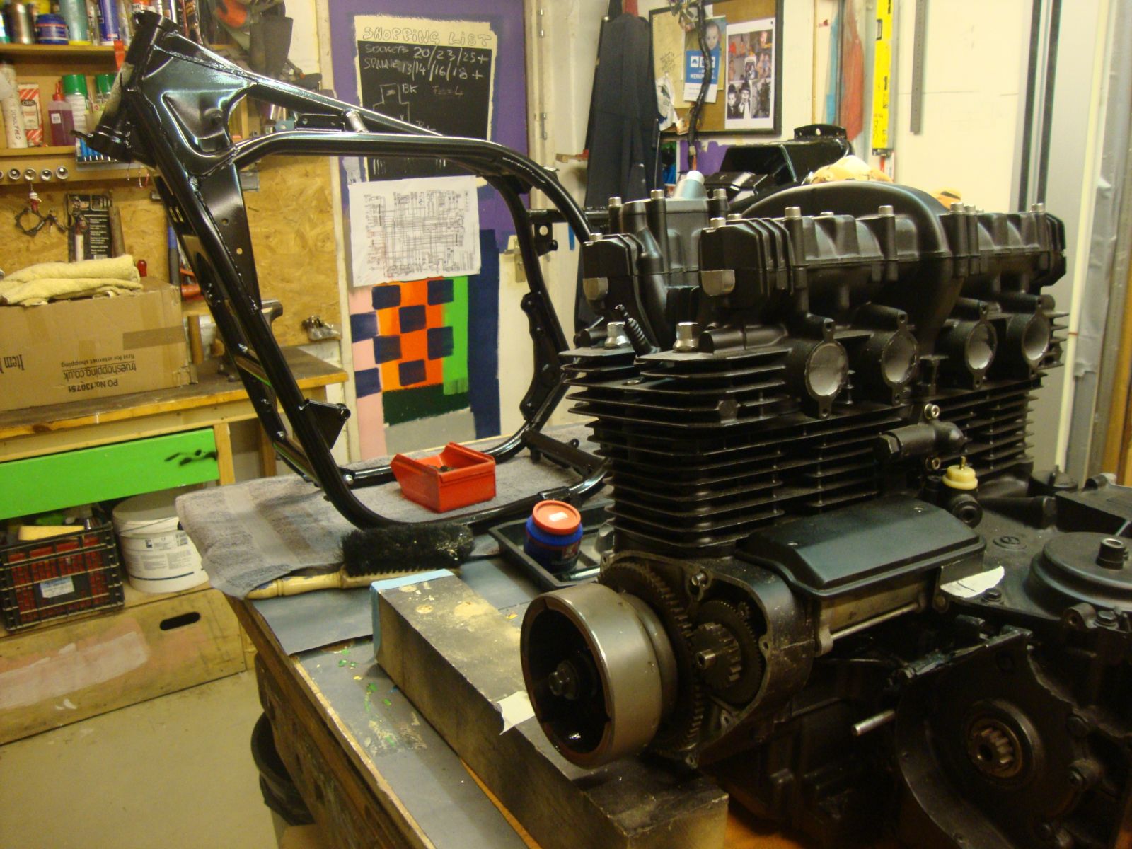

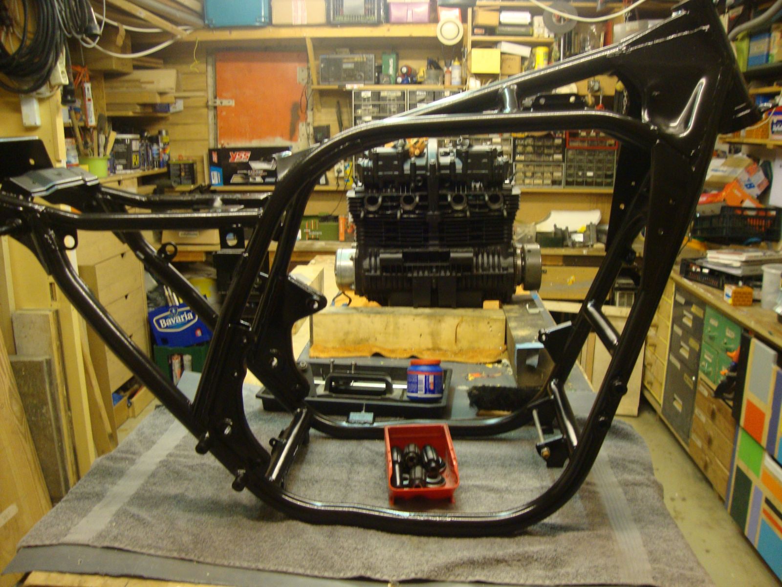

Thanks for looking. I risked it and I think itll be OK. Meaning? Yes! I went gone done did it! I got the engine in tonight.
Before
After
My extra muscle.A confused Canuck! 'So,what does this do??'
A happy me.(Yes,thats my 'Happy Bunny' face!)

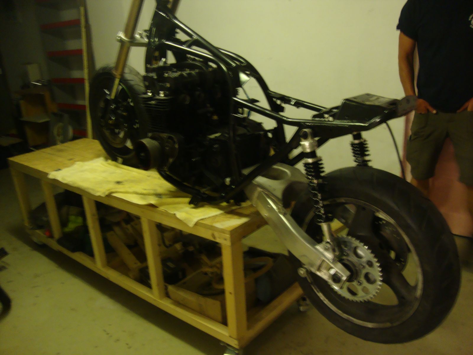

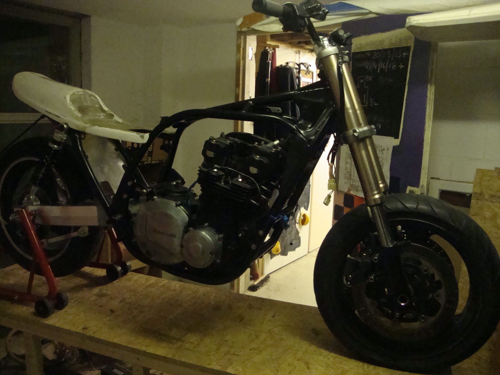

and I couldnt resist throwing the rest together to get an idea.
So,tomorrow I can start getting things bolted together.Without thinking 'Thisll have to come apart again'. Though the wheels will be coming off for powdercoat and new rubber at some point and I do want to throw the Harris on to check the ground clearence and figure out a new rear mounting point.
Onward and upward
P.S. The sump will drop out,no problem.
