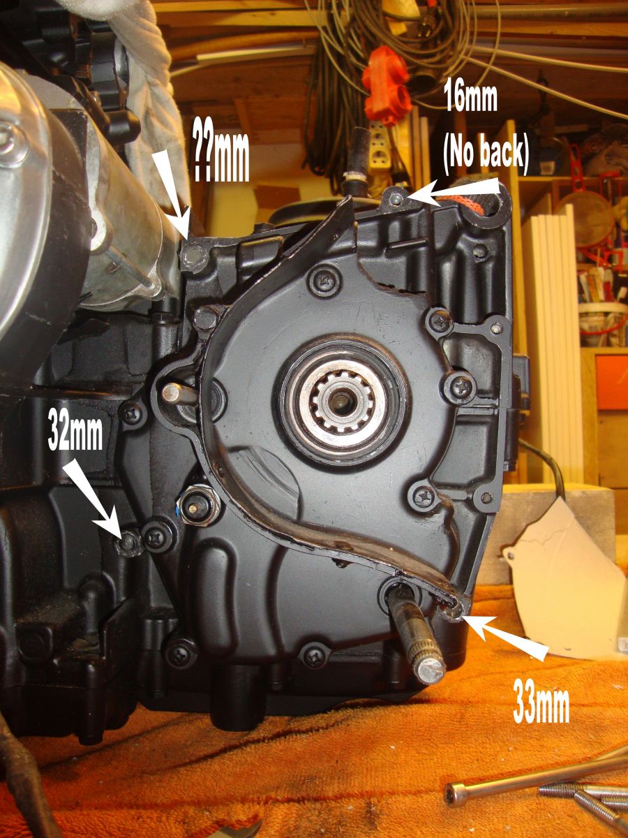

The last of the above. The hole is ready for drilling. I do have the original bolt somewhere but Im not sure exactly which one it is and dont want to risk drilling too deep. Just looking for the depth of the hole to be drilled. Simple as that;
Any help appreciated.

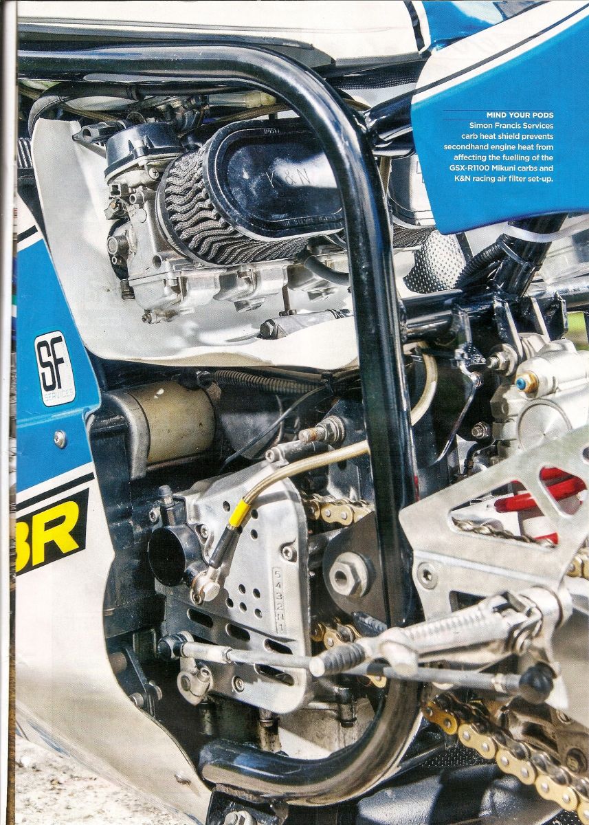

Dont worry about it, I rarely understand whats going on.The plan here is to replace the standard cable operated clutch operator thing with an hydraulic one.
Something like this;
Unfortunately,this is not my bike.Its something I lifted from a magazine.

I've got an 82 750ltd. It appears to be a little bit different than yours. I measured the hole depth and the top two were roughly 22mm.
You can see from the picture they are a bit different.

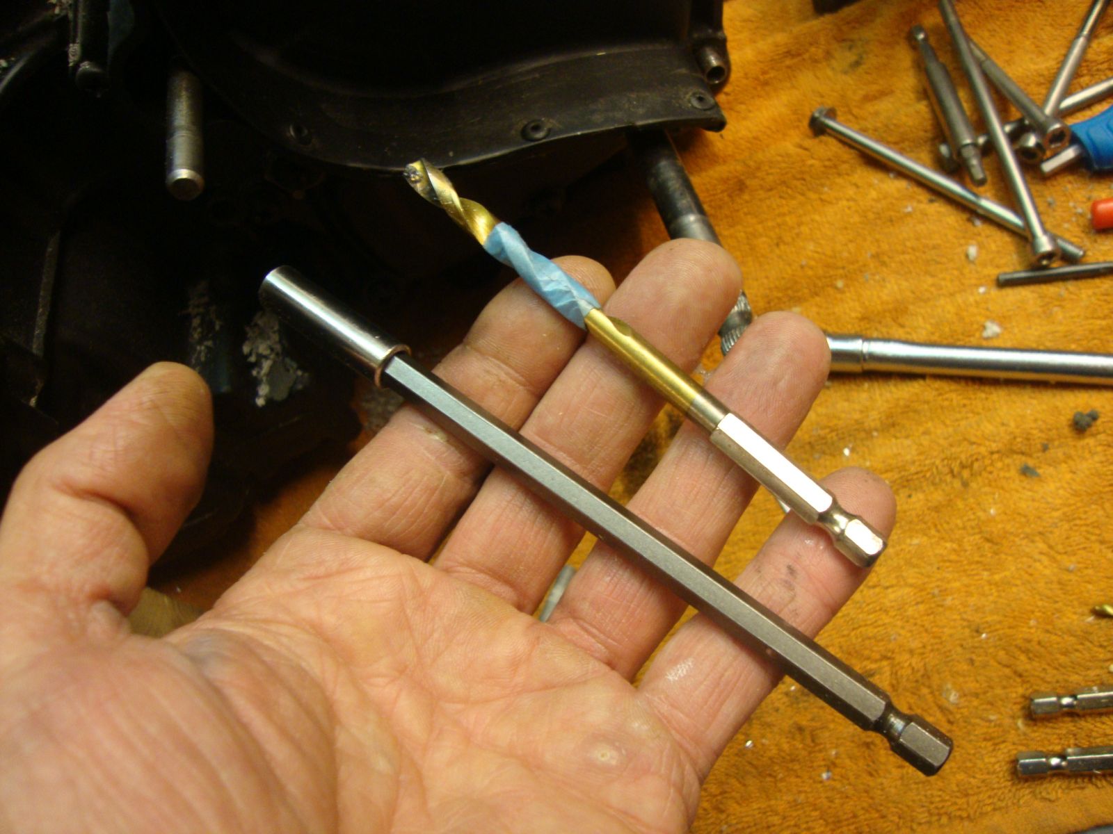

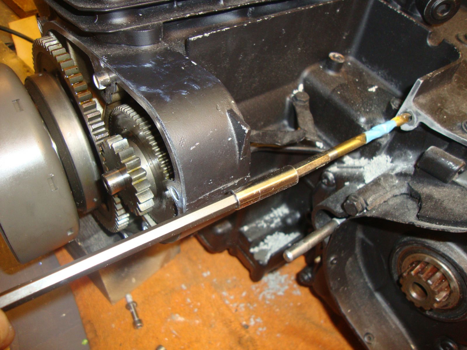

Bought some bits and bobs today to drill out the hole.A cheap drill with a hexagonal shank to fit a bit holder and an extra long bit holder.I took off the generator cover and was able to get at the hole.
I drilled about 10mm in and that was as far as I could go.I hit on something and didnt want to force it. I think the inserts are only about 10mm anyway. Ill pick up the kit tomorrow,if I can and see how it goes.

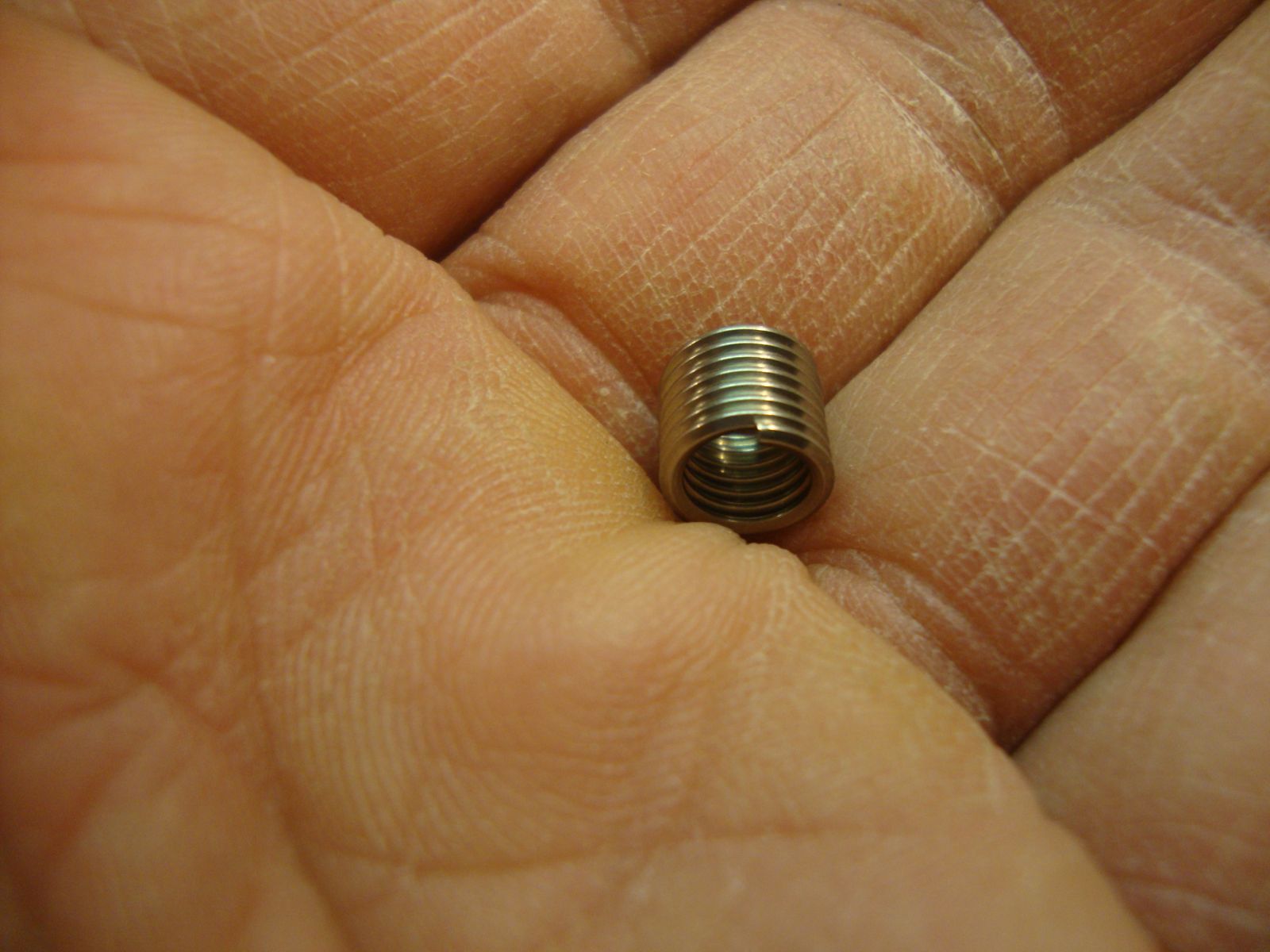

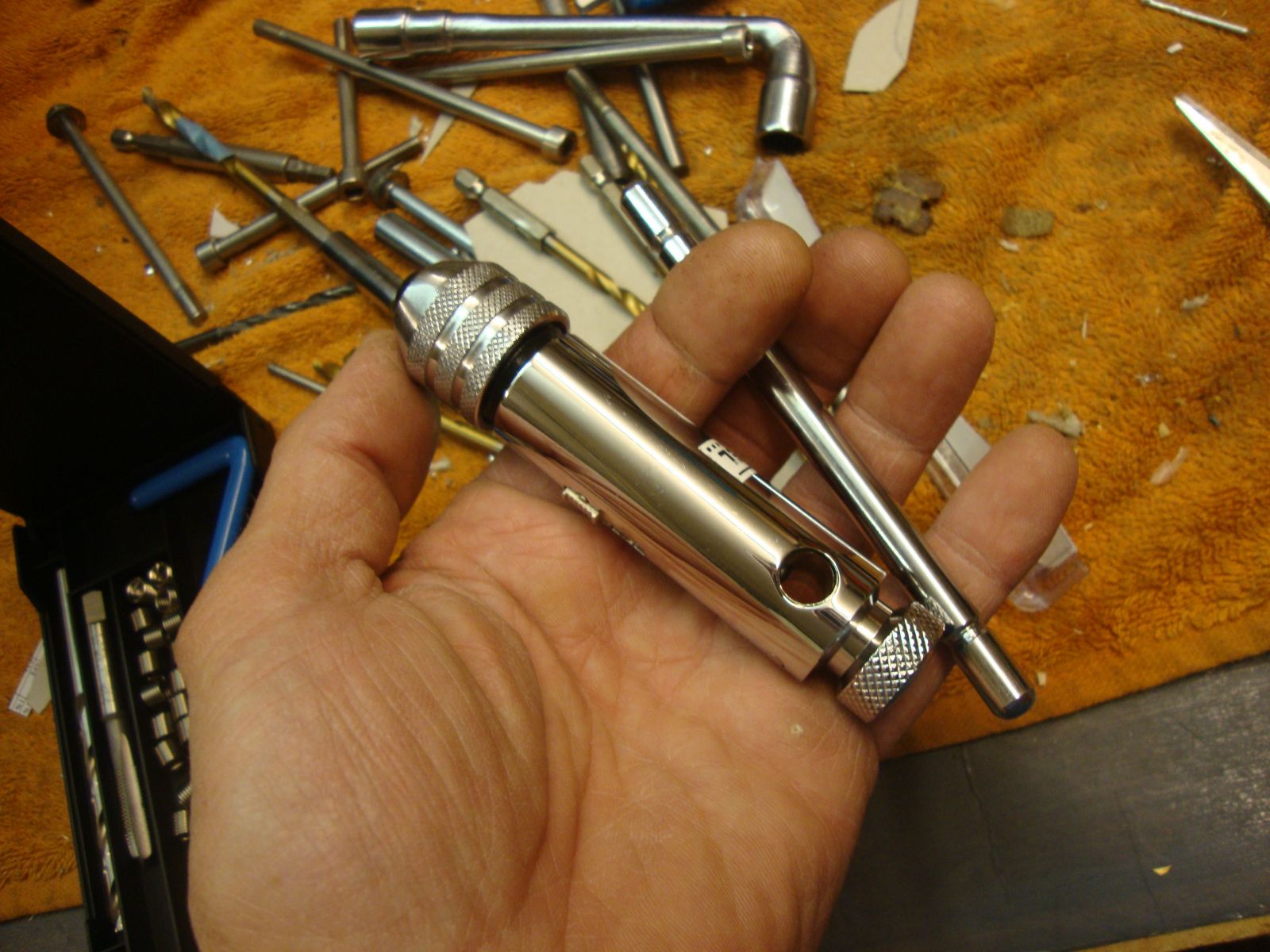

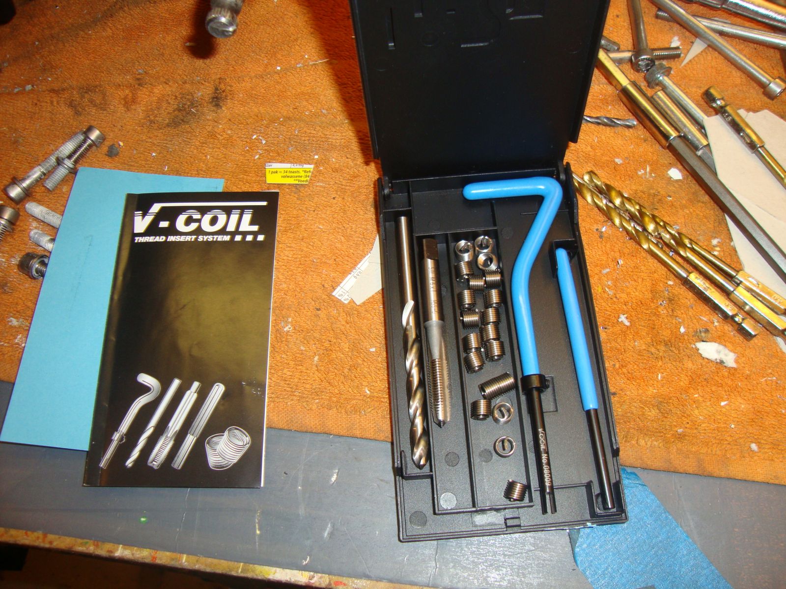

Got some stuff today. A nice insert set to fix the buggered threads on the engine. Good German quality.
and a (lesser quality) ratchet tap holder
So I just need to borrow a 90 degree head for my drill and I can get that hole rethreaded.

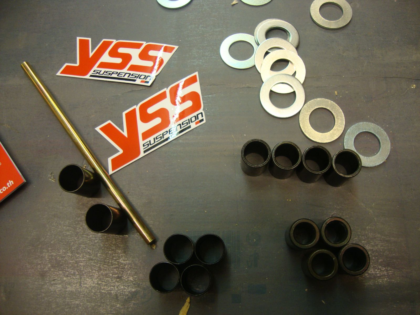

These were my consolation prize for losing out on a lovely Harris pipe on ebay. Apart from my brake hoses,S.S. brake pistons ,seals and chain and sprocket set, these are the only brand new things Ive actually bought for this project. Everything else has been 2nd hand so far.
Im well chuffed with them anyway.

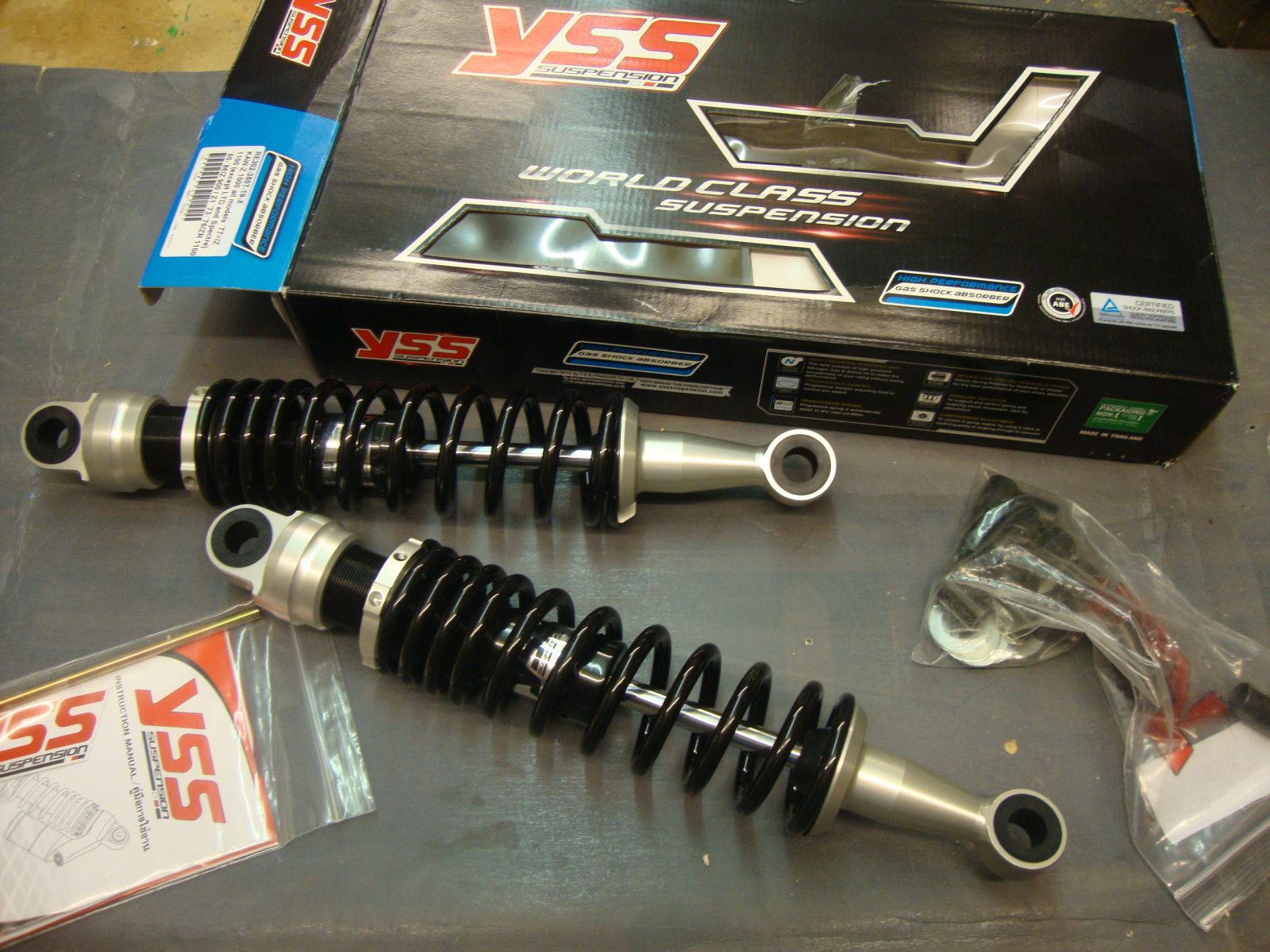

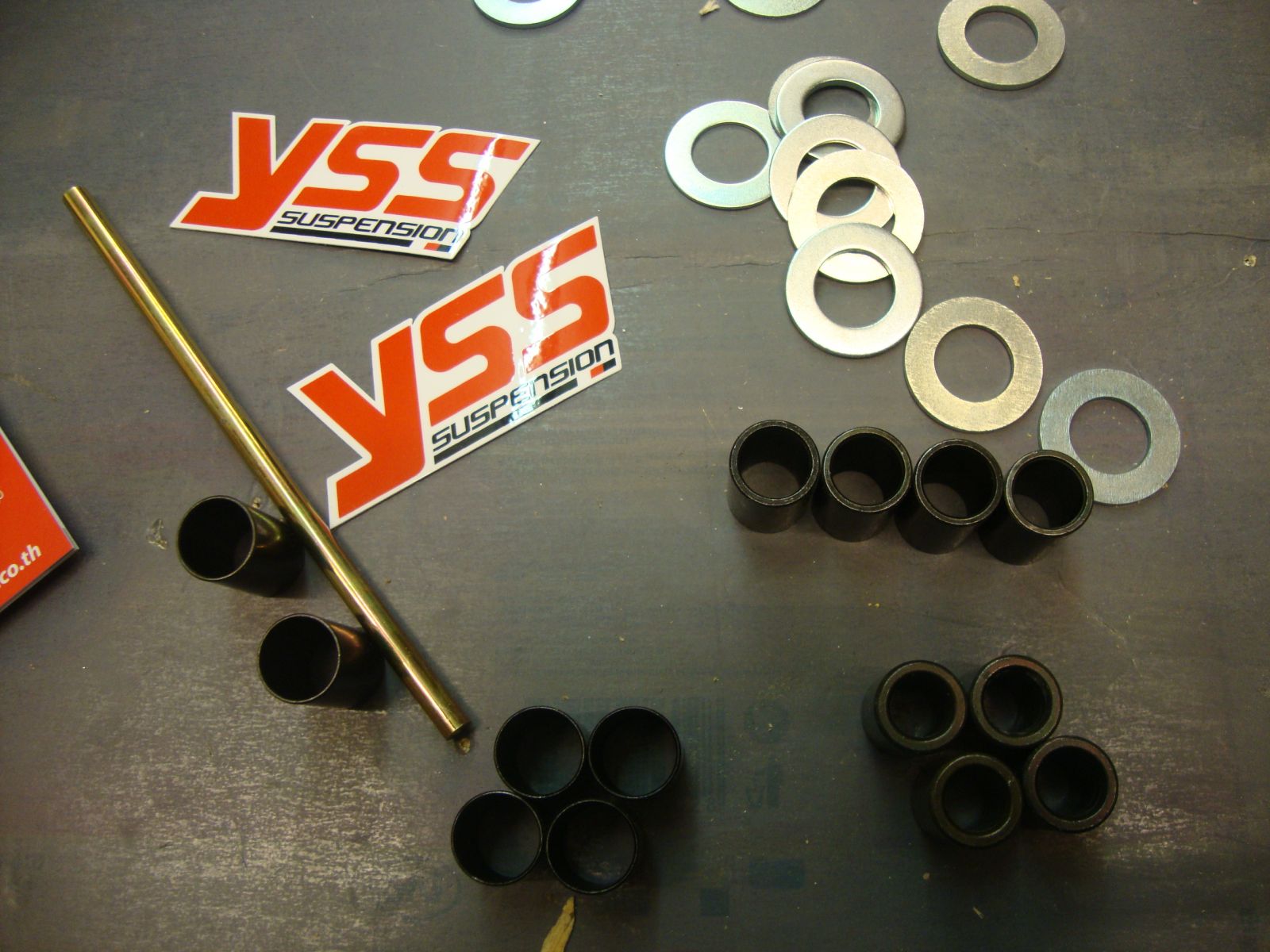

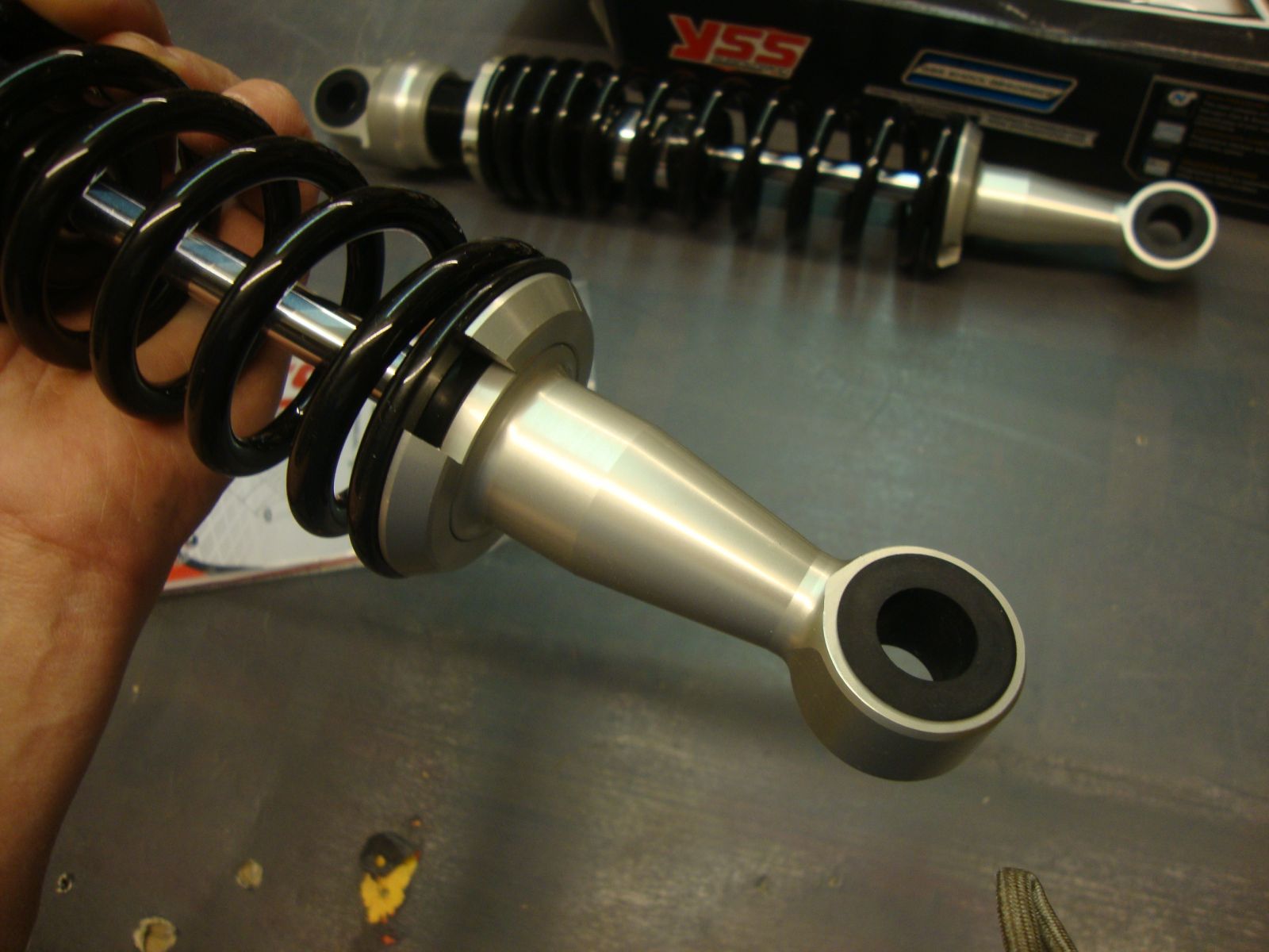

- monkeydoodle
- Posts: 63
- Thanks: 2
Re: Re:CSR1000 Project Build
20 Jun 2015 09:40

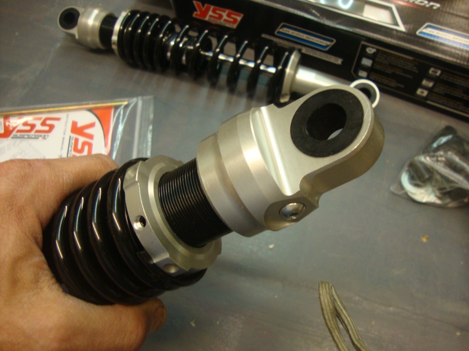

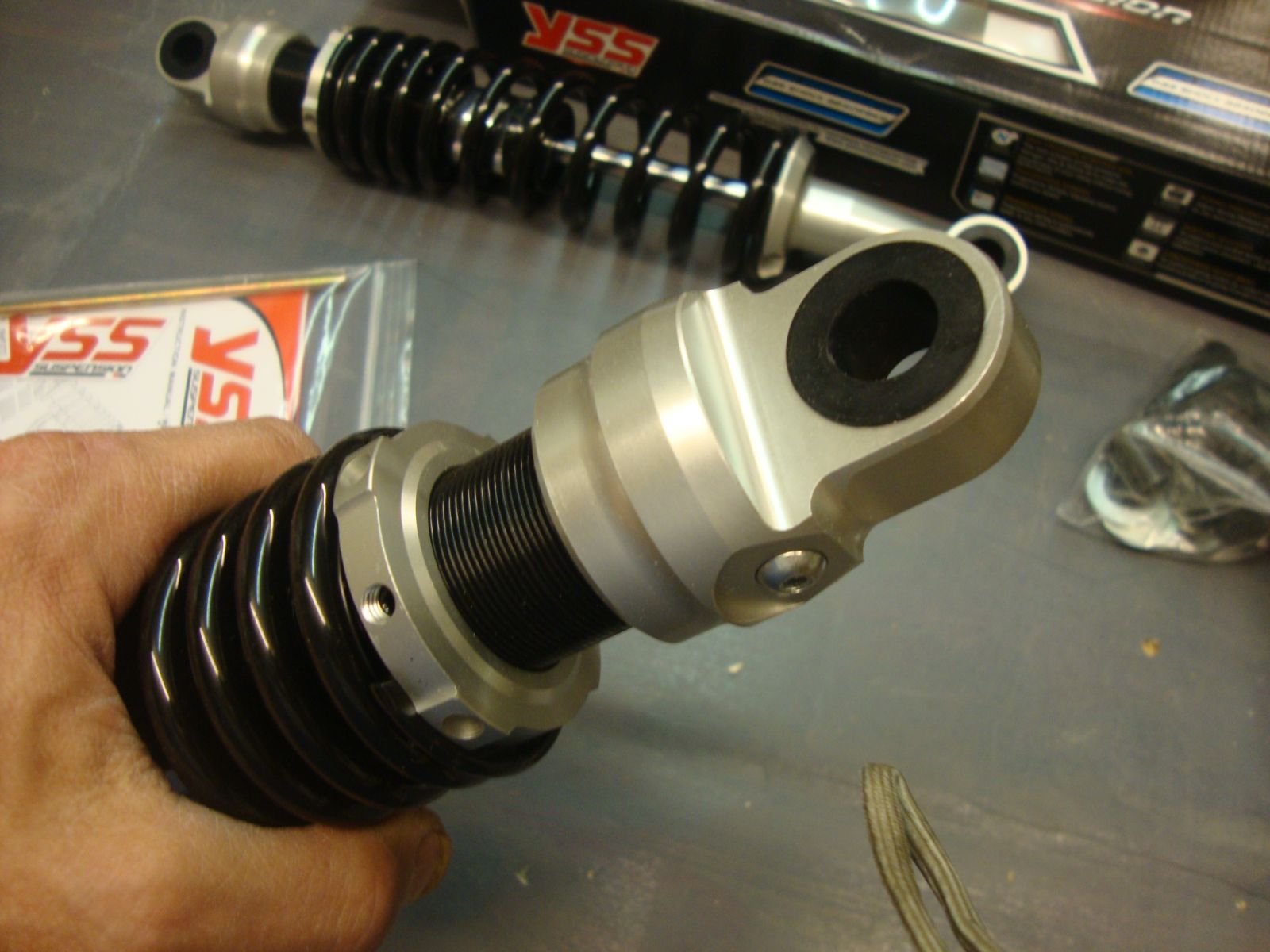

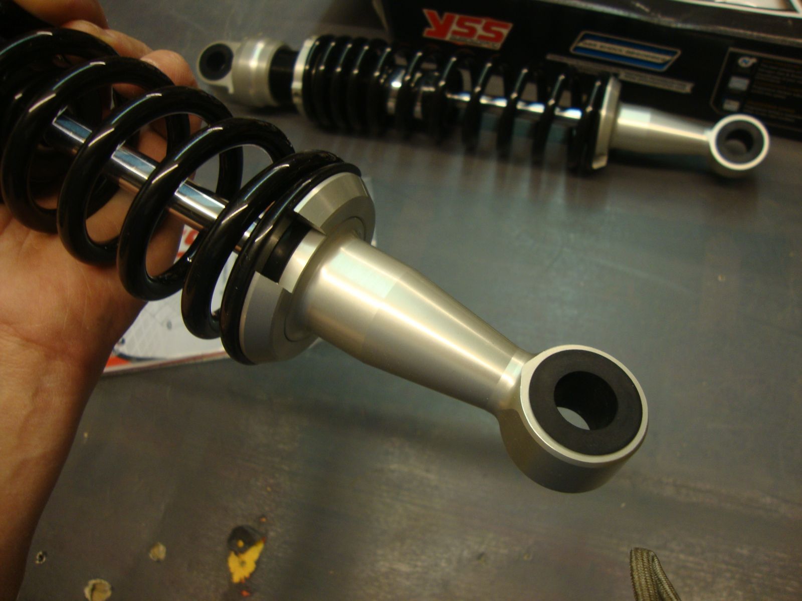

LOVE LOVE those shocks, seeing them makes me re-think my mono shock dilemma lol...did you mention Harris exhaust? I have a 4-1 original Harris waiting to be re-chromed or baked :whistle: :whistle: :whistle: :whistle:
