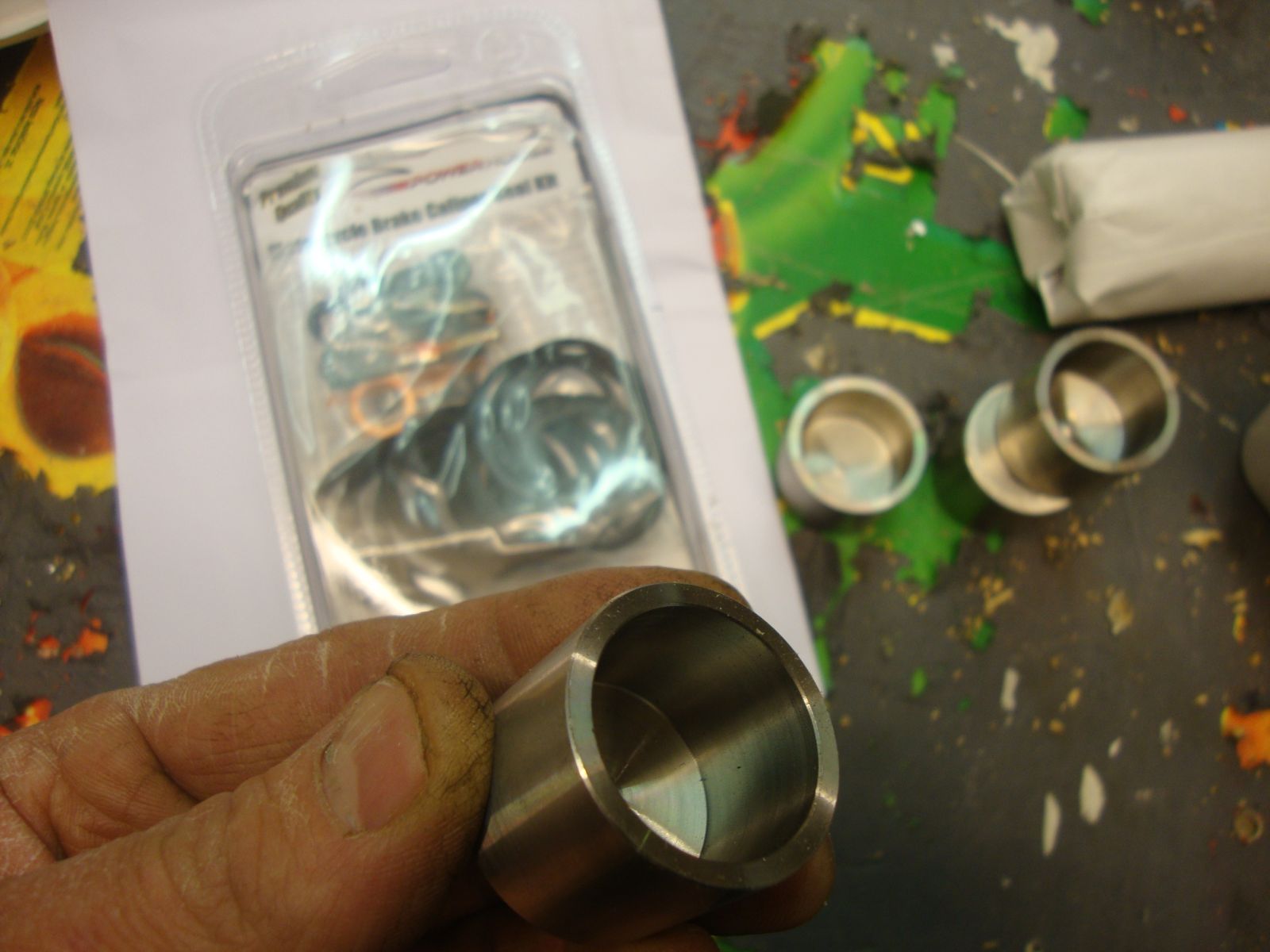

I did get a nice treat this afternoon.My stainless brake pistons and caliper seal kit arrived;

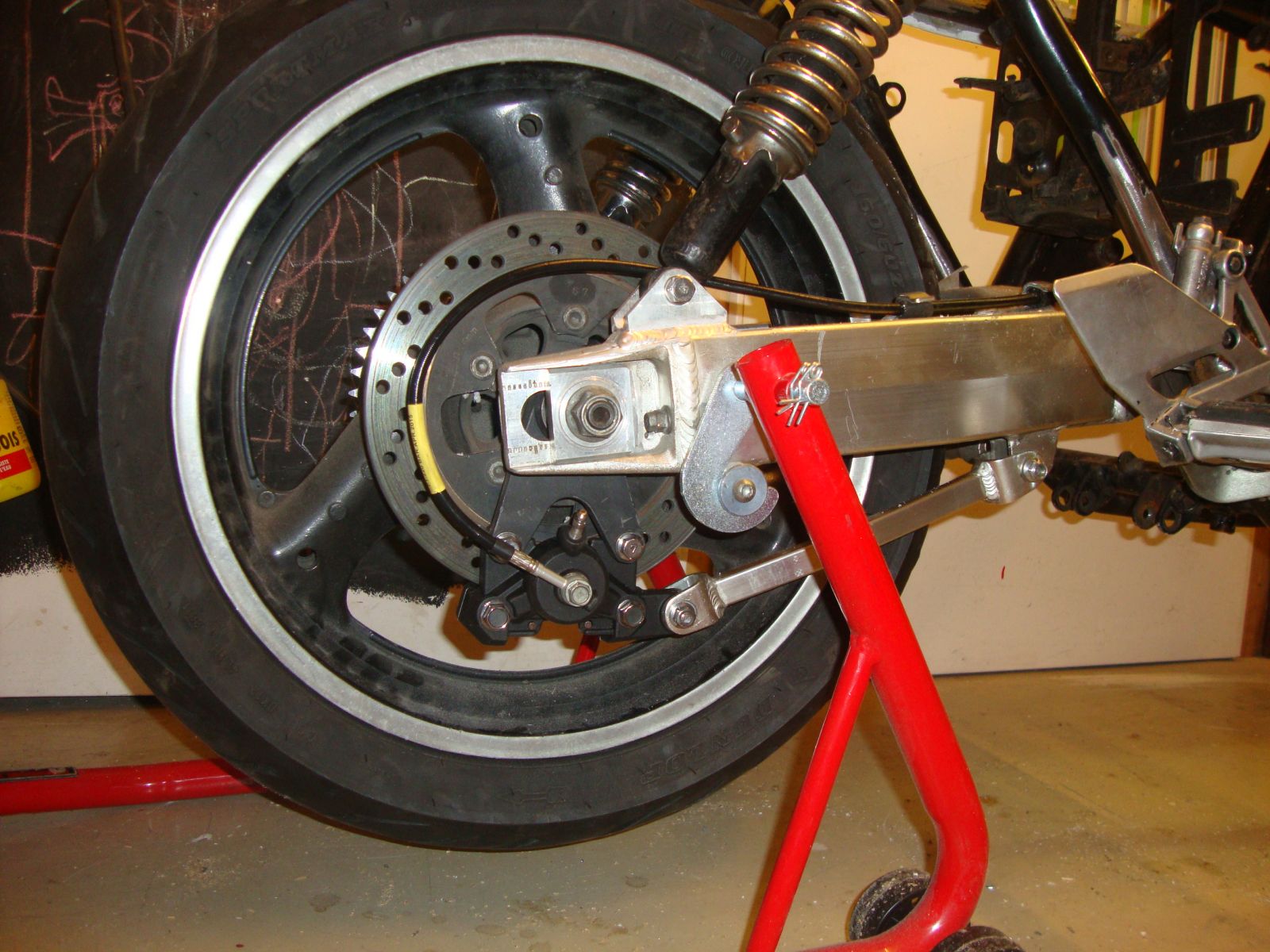

I spent yesterday working on the rear brake,cleaning it up,polishing the bolts and fitting the torque arm.Though I still need new pistons and seals for it (the ones that arrived today were for the ZXR front calipers) but Im nearly there with the brakes anyway.

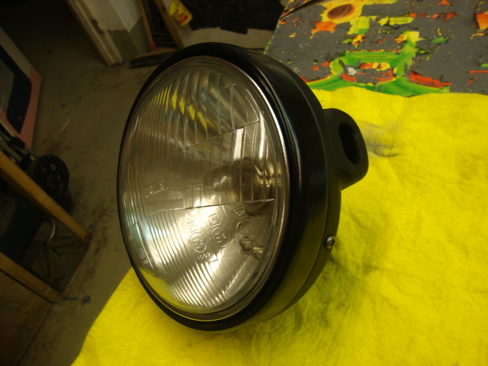

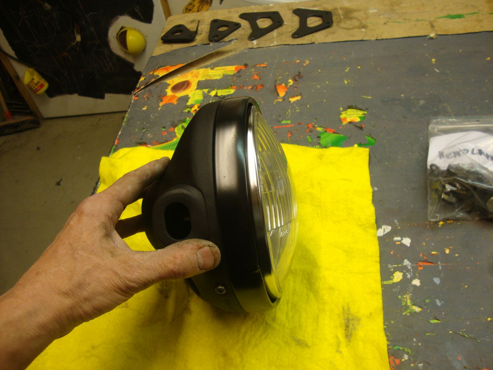

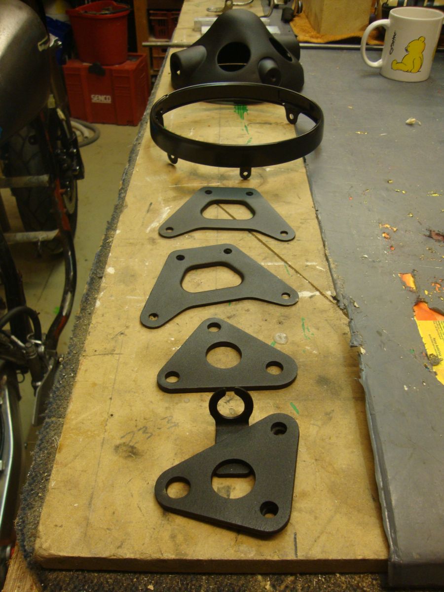

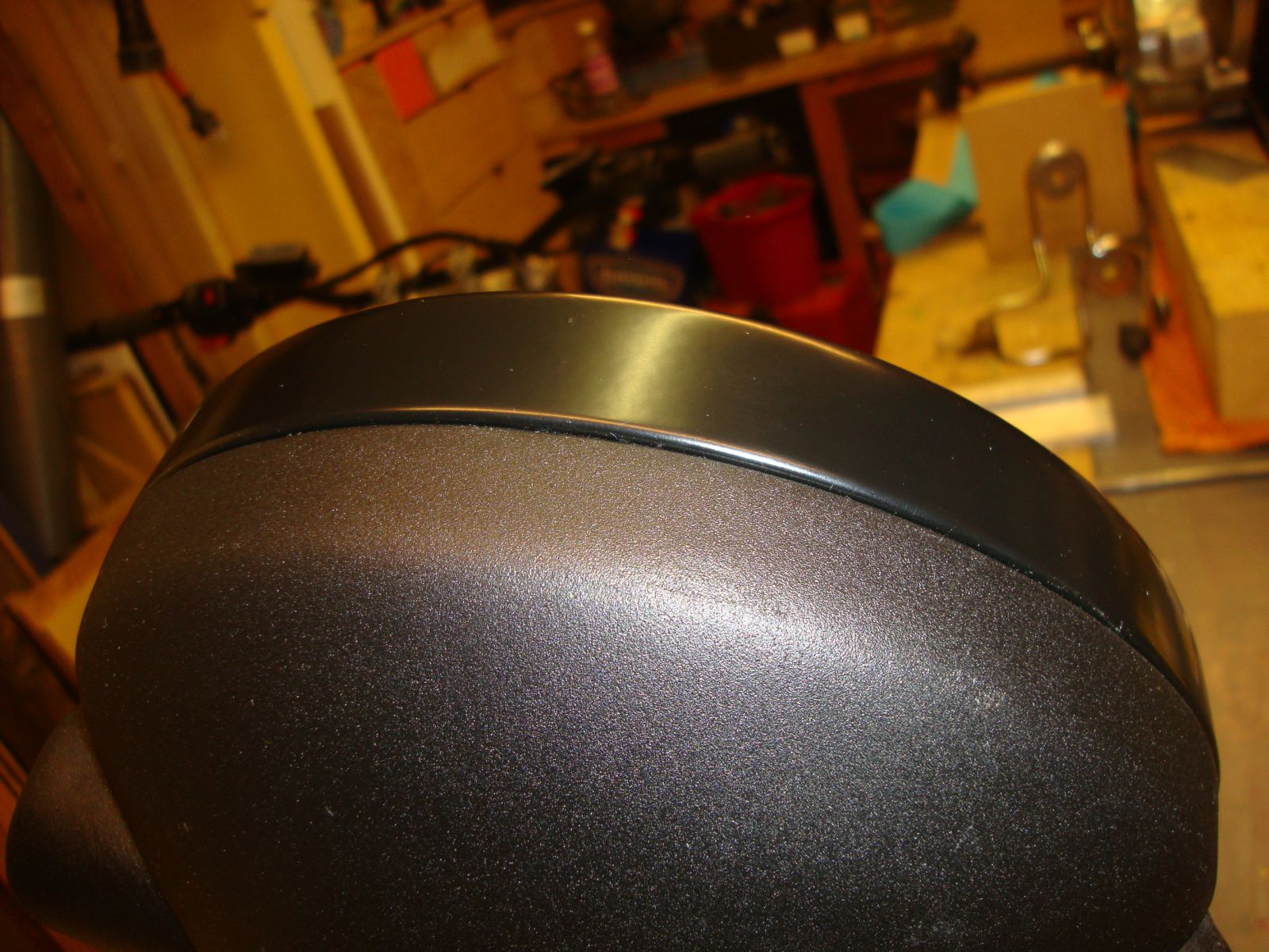

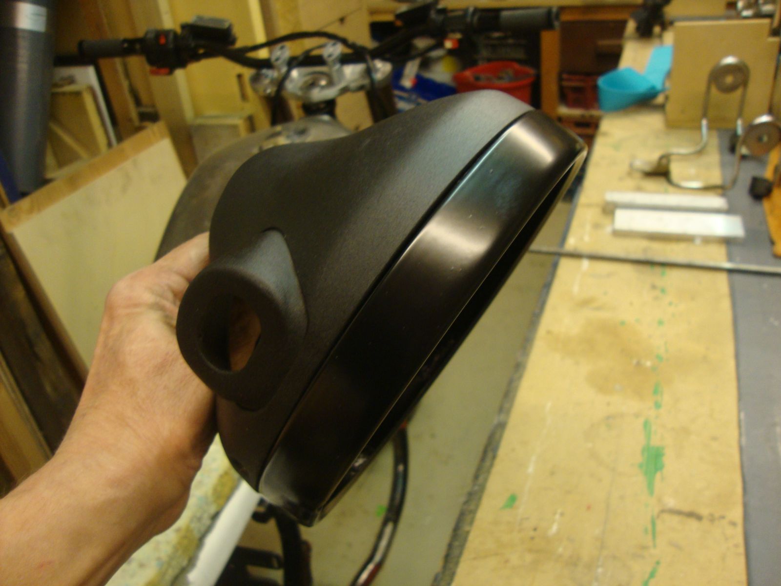

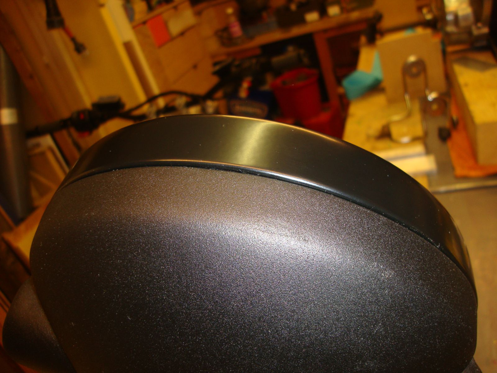

First time with powdercoating. Not a perfect result but good enough for a first attempt and it was fun to do!
From the top. Headlight bowl,headlight rim,coil mounts and rear engine mounts.
Headlight bowl( a rough type of matt) and rim (satin)
I like the contrast
and the best part is,I got rid of all the chrome!!
I like the contrast

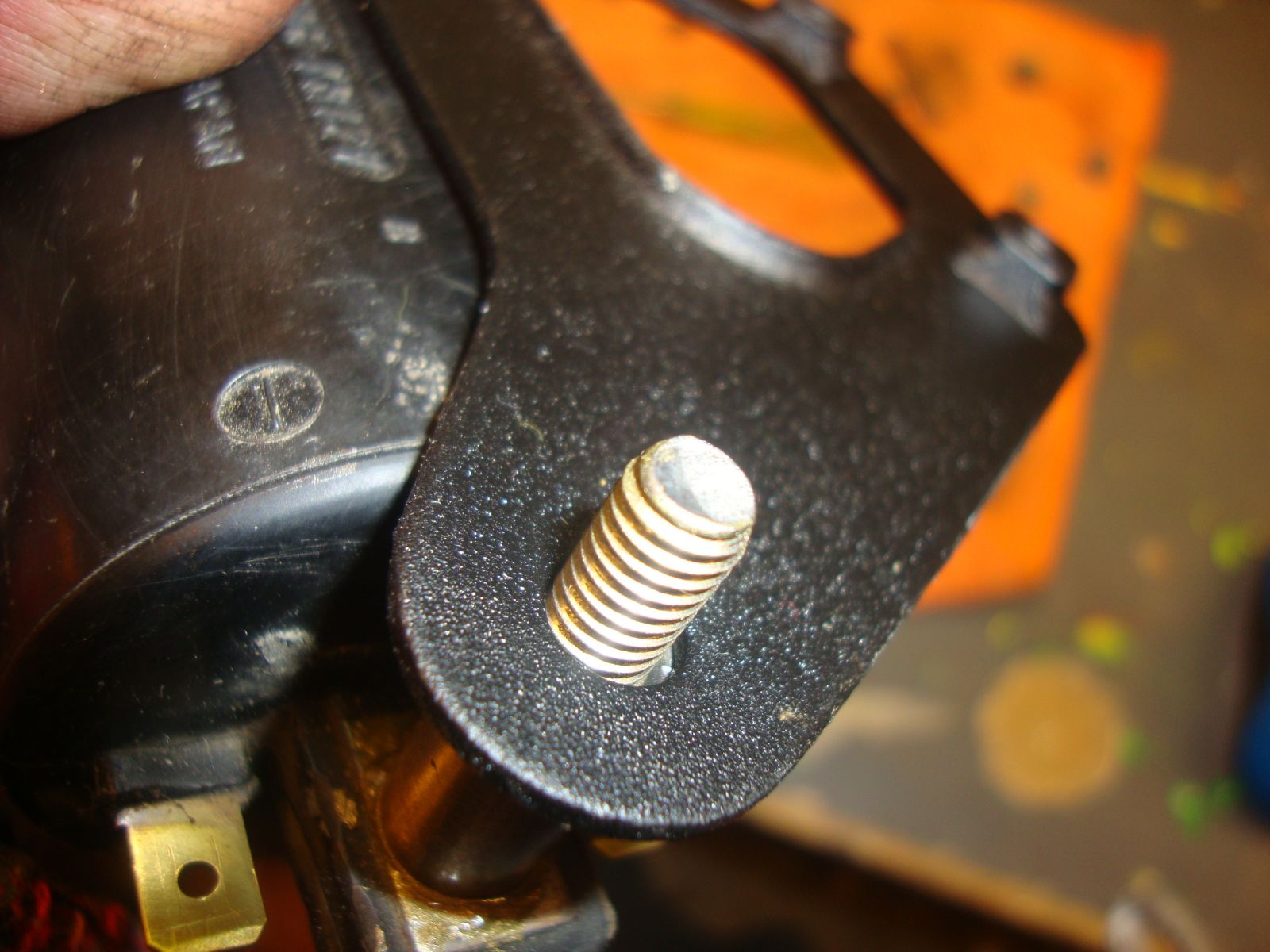

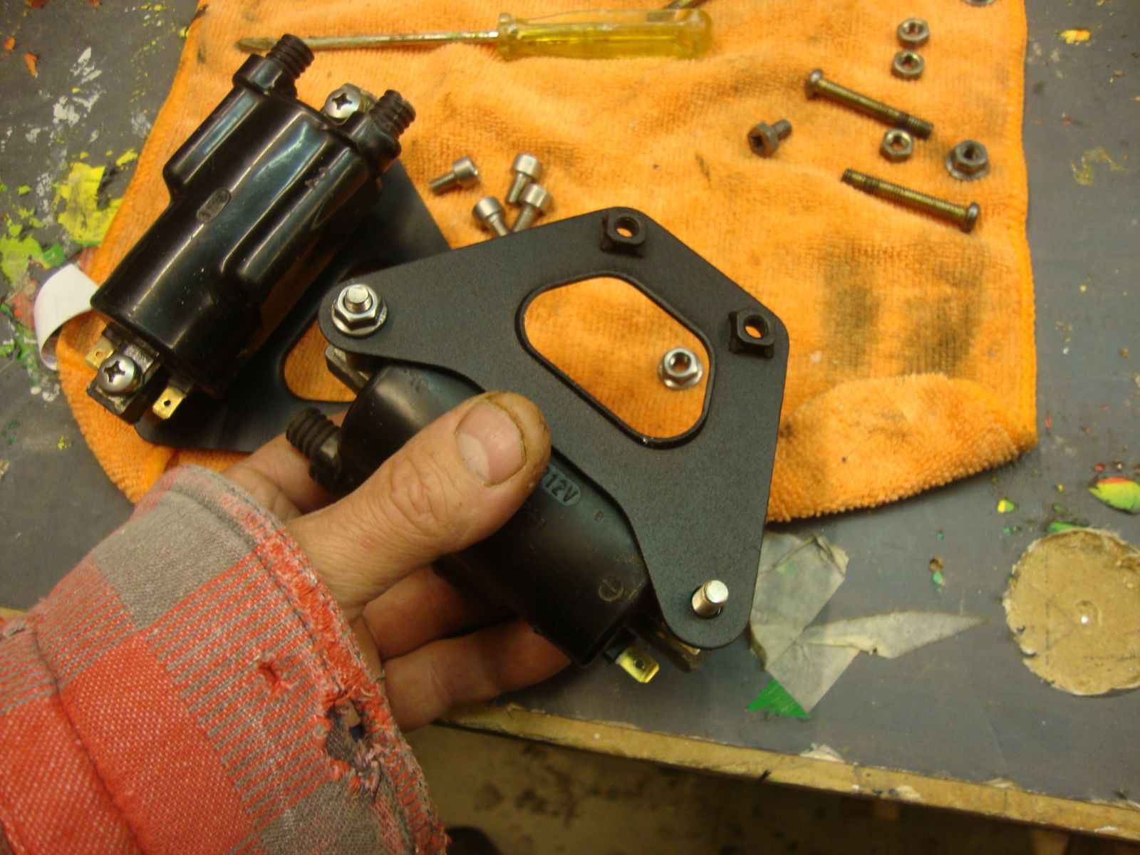

Anyway,I put the coils together today with my freshly powdercoated brackets and SS bolts.Very nice.
Do I need to scrape off the powdercoat here to earth the coils??

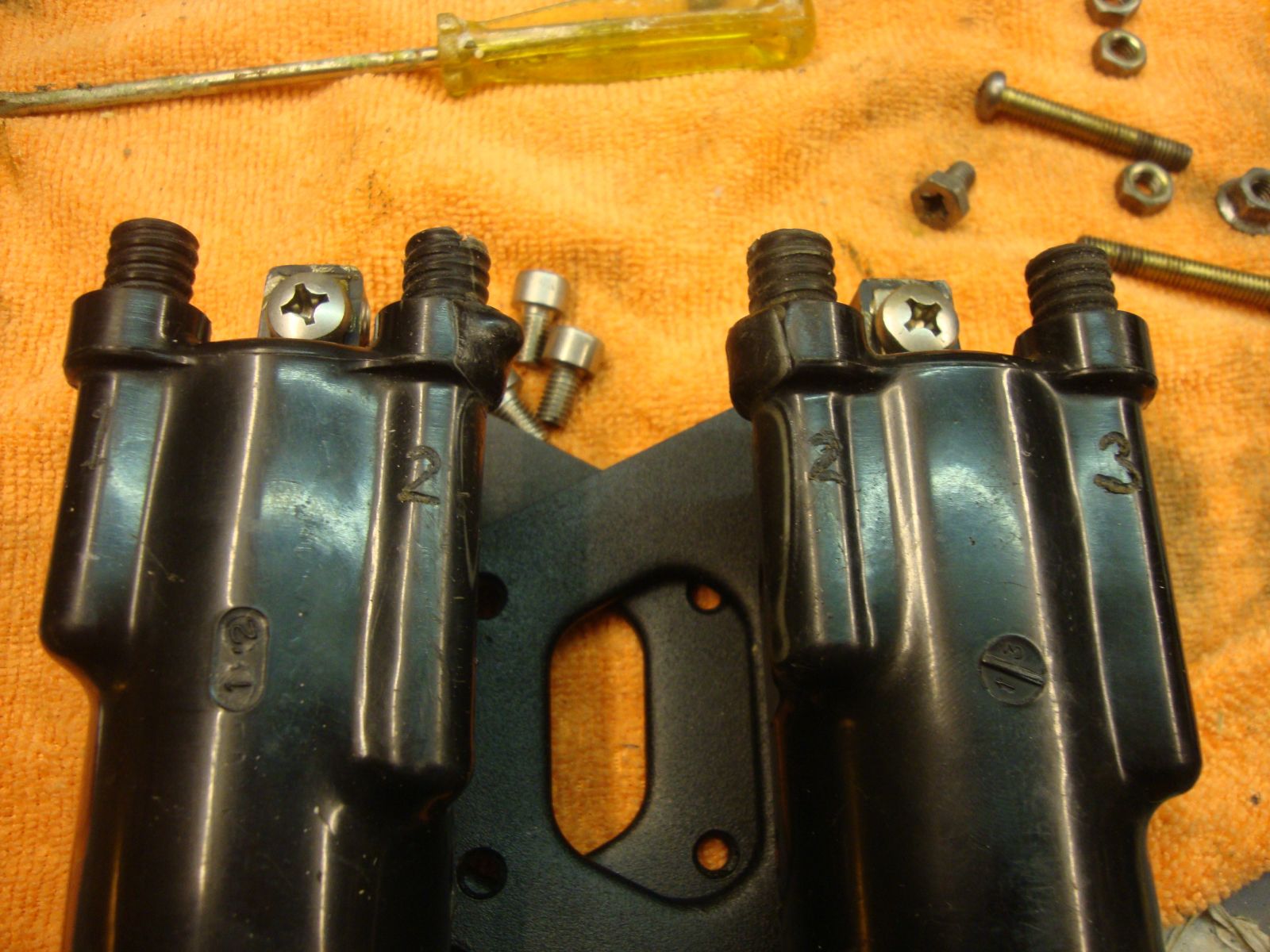

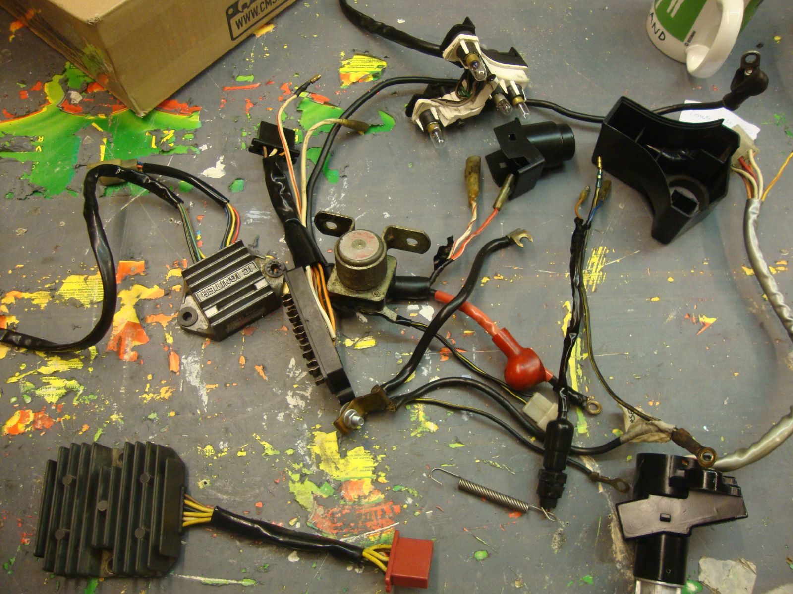

I like to mark things when I take them apart so I know where everything goes when it comes time to put it all together again . I did so with the coils for the HT cables. Something went wrong .My head was somewhere else and I ended up with this.
I cleaned up some of the looms ancilliary parts ,just a clean and degrease. Now I can work my way through all the bits and cheak the cables and connections etc.There was evidence of a fire on the bike at one time,though everything was working when I got it started.It still needs a good going over.

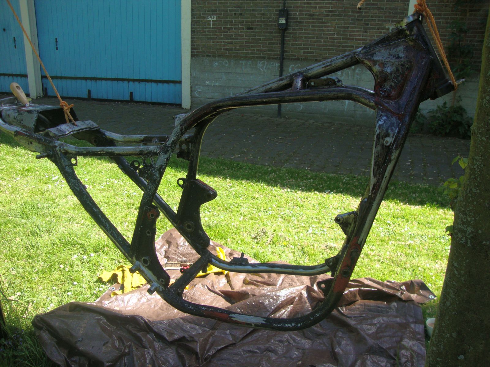

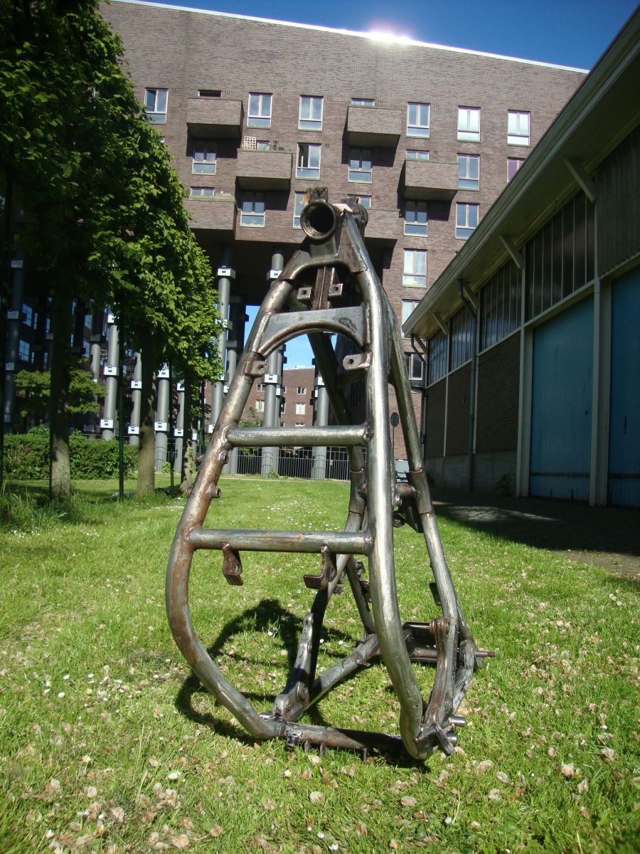

OK,the weather here is impoving.A cracking day today,so I pulled my finger out and dragged the frame outside. I decided against powdercoat
as 1. Its not cheap and I still have to find the money for a set of shocks and an exhaust and 2.Im not 100% sure on the welding that I did.If somethings going to crack,I want to be able to see it , repair it,and touch up the paint. So no powdercoat. Im not sure what paint Im going to use yet,I have to look into that but Im not going to farm it out,I want to do it myself.
So,today,frame outside and get it stripped. A few false starts with wire brushes and sanders. No good. Paint stripper was the best option.
Happy with the result,though its only the first go around. I got most of it off but theres still a lot in the joints and around the brackets etc.
If its a nice day tomorrow Ill go over it again and try and get it finished,then take it up to the local garage and go over it with the power washer

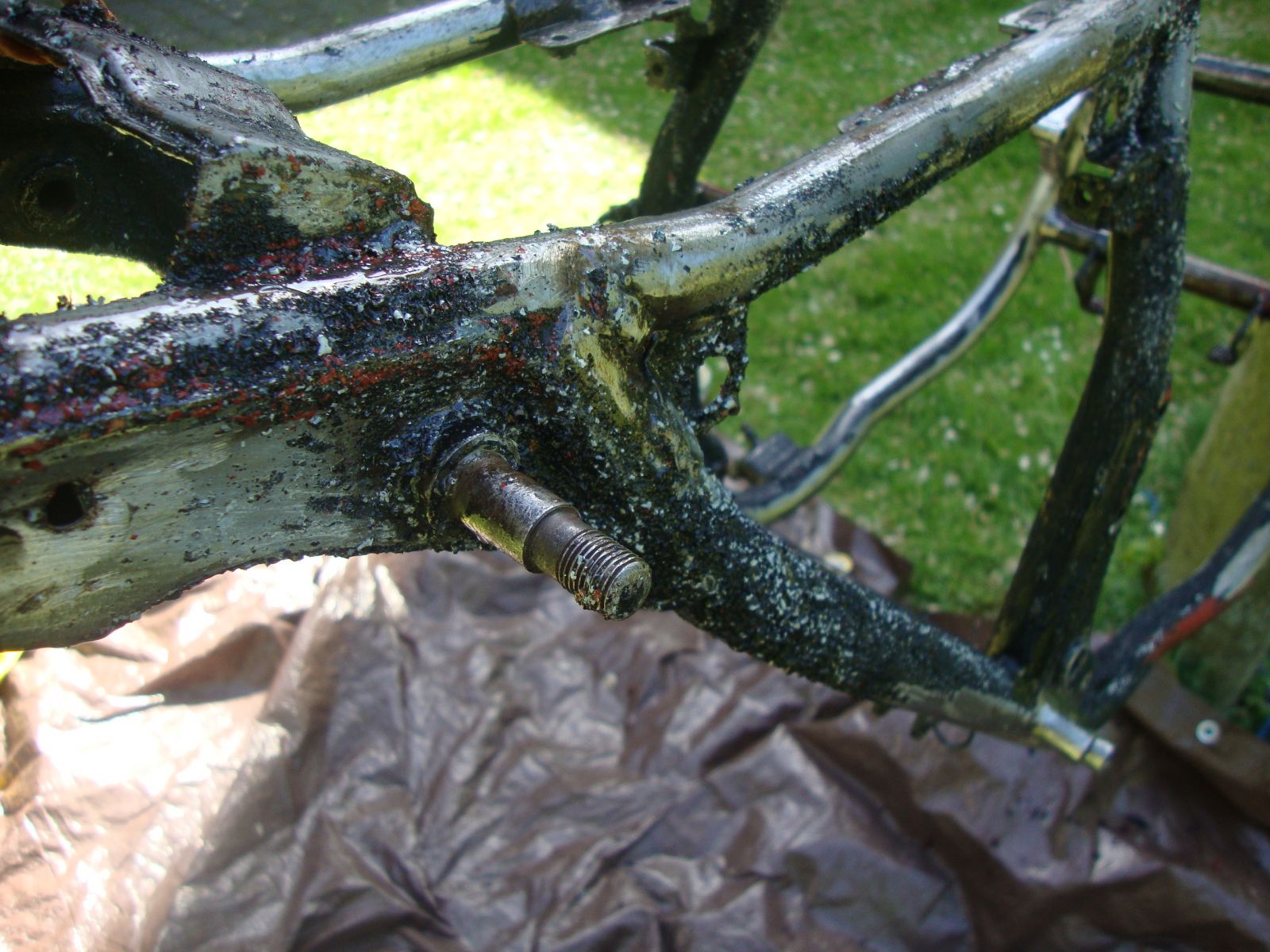

04 Jun 2015 10:50
Off to the local power washer with my minions to get rid of any lingering paint stripper

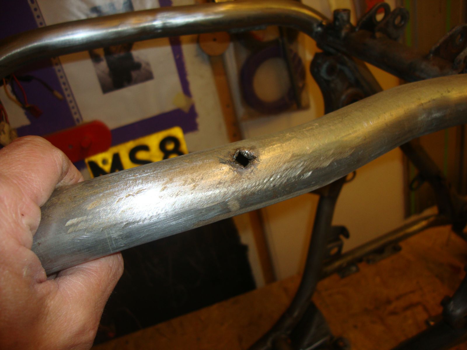

Started sanding off the remains of rust,paint and other kack and found this:
Not happy.More welding to do. I was hoping to get it painted this weekend,now thats out the window.
I did get hold of a bit of 10mm alu plate for my hydraulic clutch conversion.So,I might have a go at that this weekend.I also want to get some more 3 or 4mm plate to make an undertray for the backend.I might be able to get that tomorrow.
