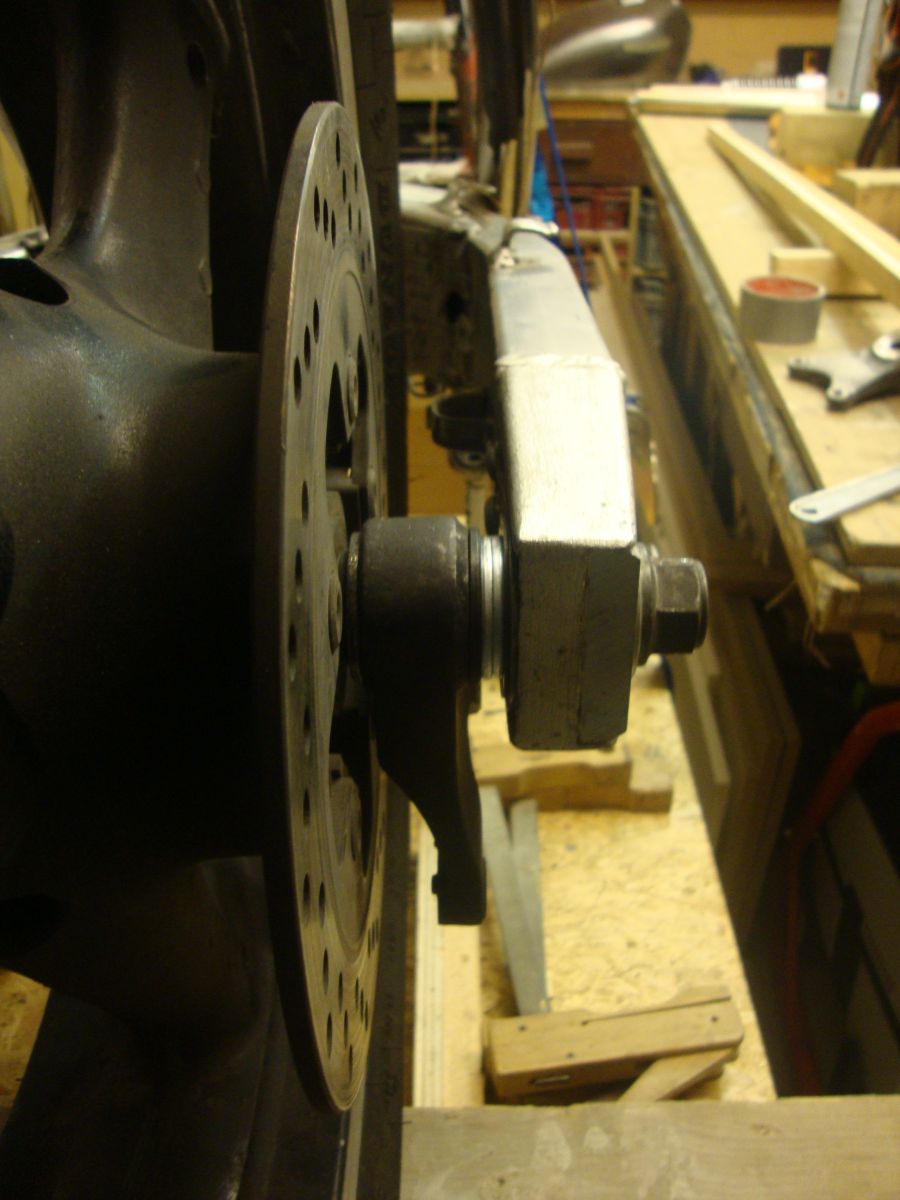

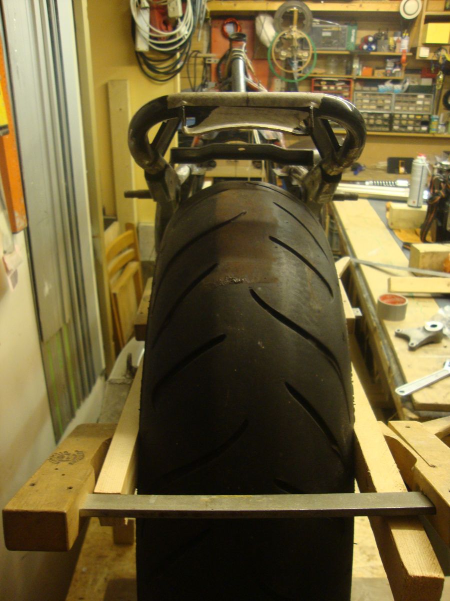

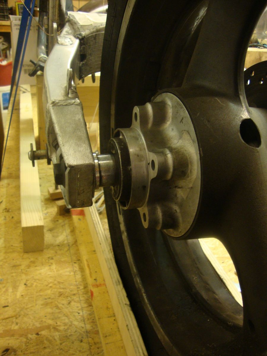

So,things are finally happening again. The Bandit wheel is looking good.

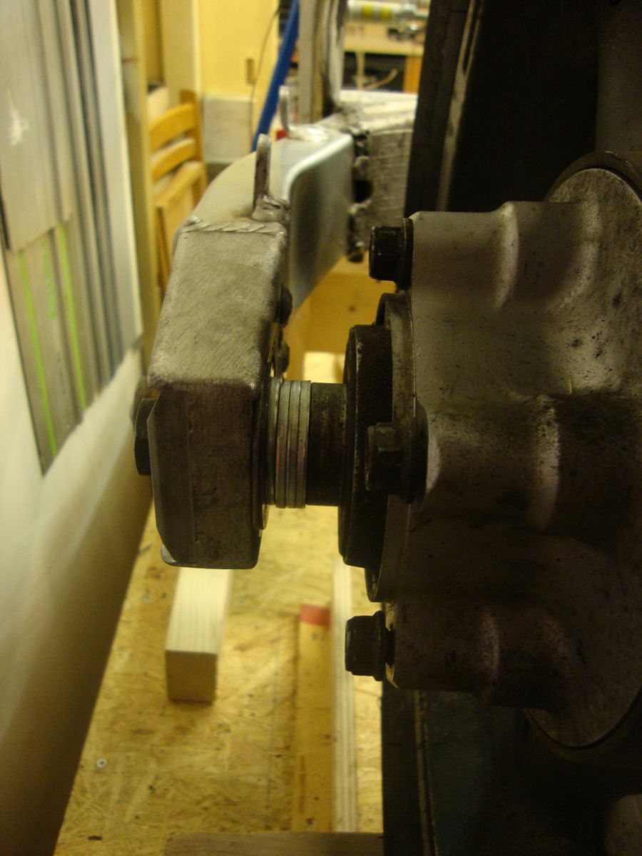

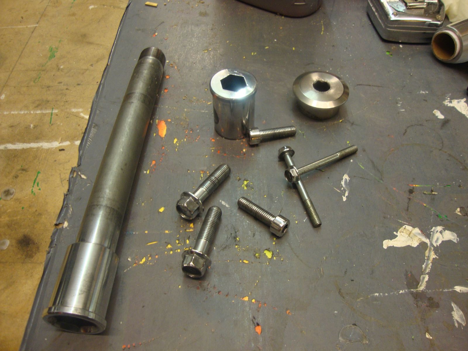

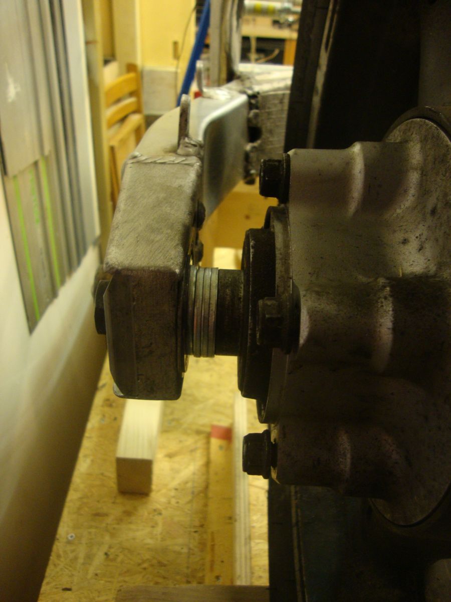

I had some spacers made up to fit the 20mm axle into the huge 30something hole in the gixxer swingarm.

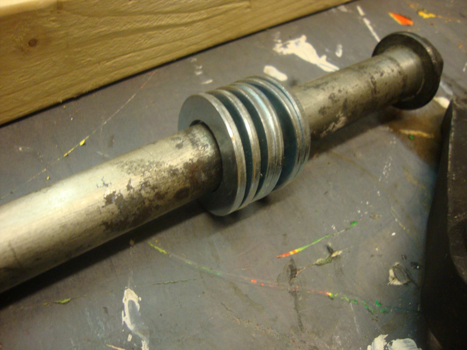

I bought a handfull of washers from the local hardware shop to fill it all out
and got the wheel fitted and locked up

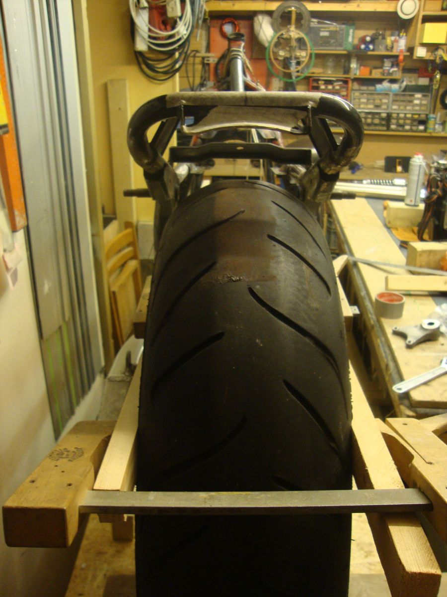

With a little adjustment,its all evened out and the wheel is CENTERED.
Its taken a long time and a lot of trial and error to get to this point but It looks like its all going to work.

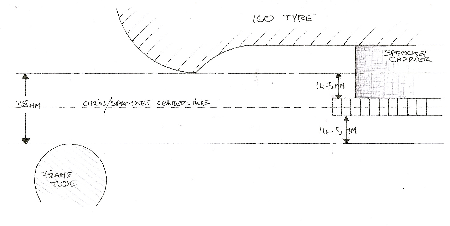

Now,I can get the chainline measured up and have the sprocket carrier turned down.

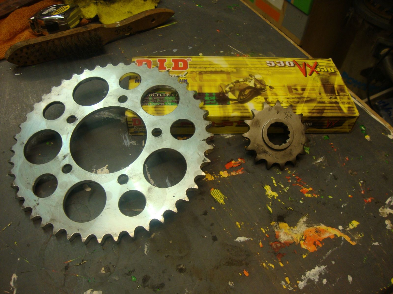

Ive been looking at a 525 or 530 chain set.This should come with a 9mm (+ - ) thick rear sprocket (though I still have to confirm this before I get anything cut)

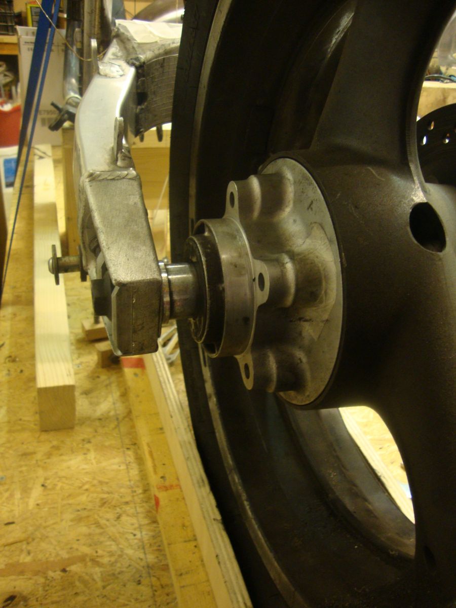

So,based on that,this is where I am at the moment;
and this is where I want to be

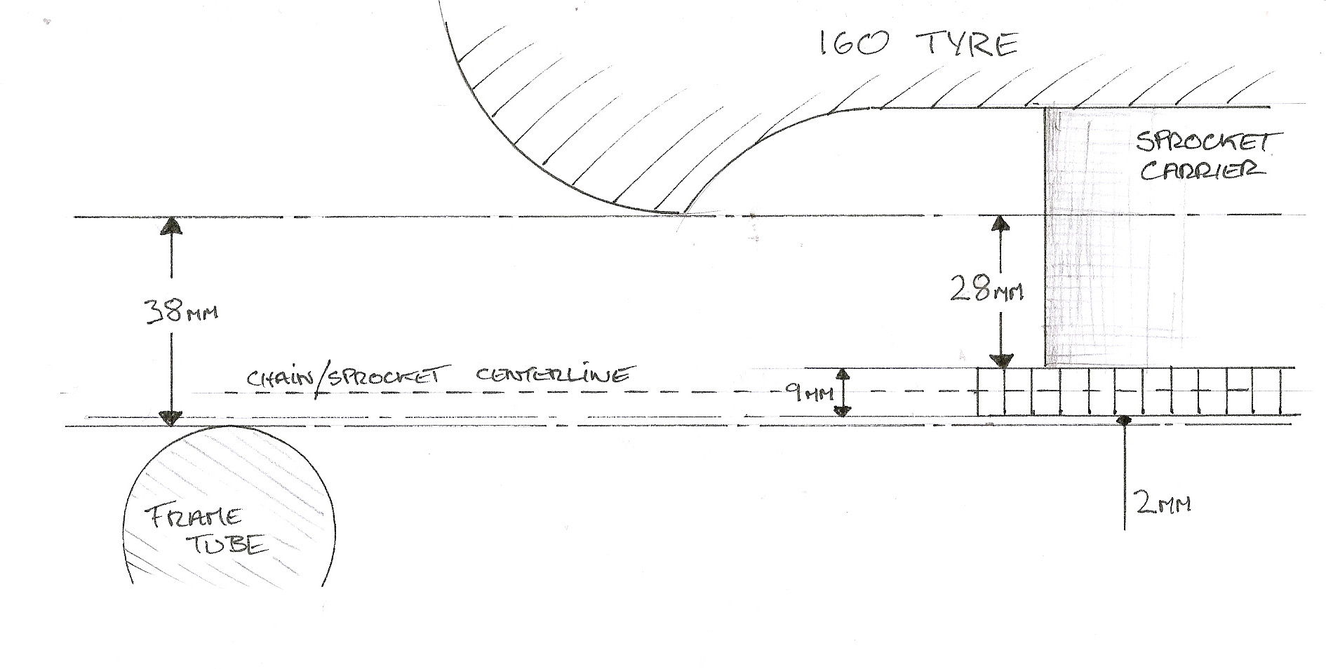

If I get 13,5mm turned down off the sprocket carrier,that should put it right where I want it and give equal clearence either side of the chain.Twixt the chain and tyre and twixt the tyre and frame downtube. Again I have to check the width of the 525/530 chain but I think there'll be no problem. And the Bandit sproket carrier has a lot more meat on it than the ZXR400 that I tried before.
So the next thing is a chain and sprocket set.If anyone has any info on chain/sprocket thicknesses, it would really help,as so far,i can only find diameter/tooth count dimensions.

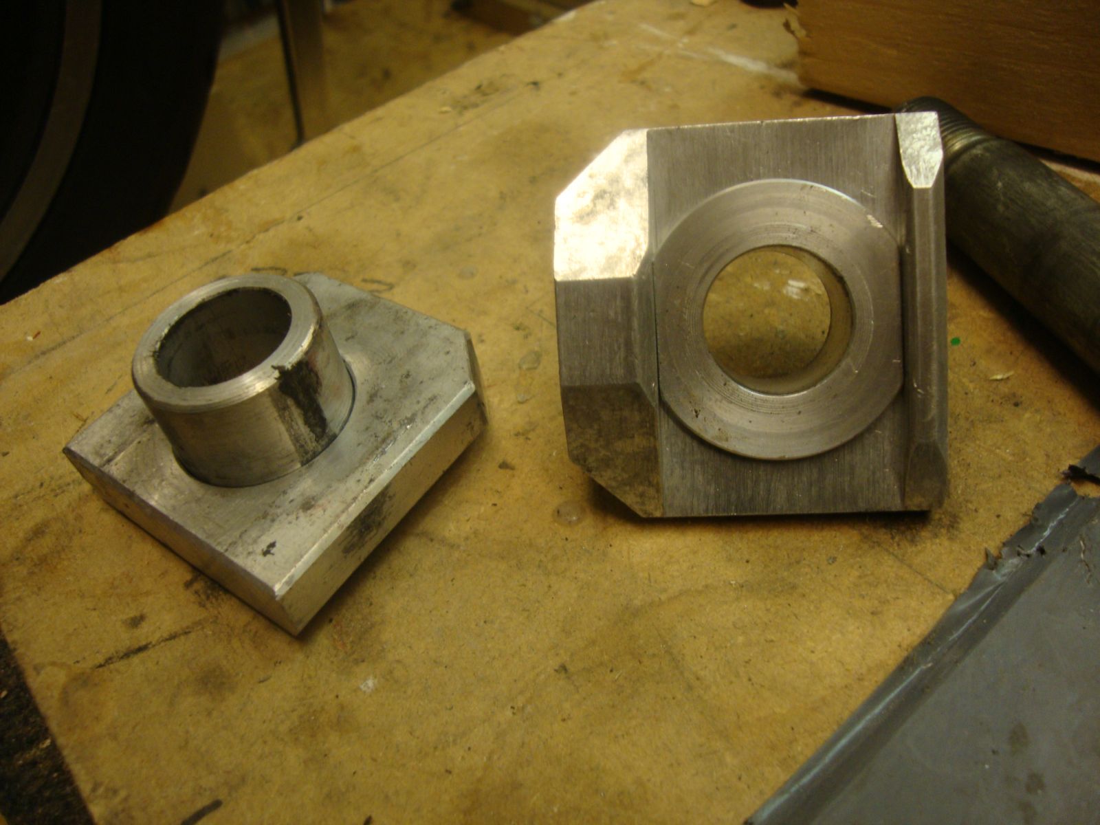

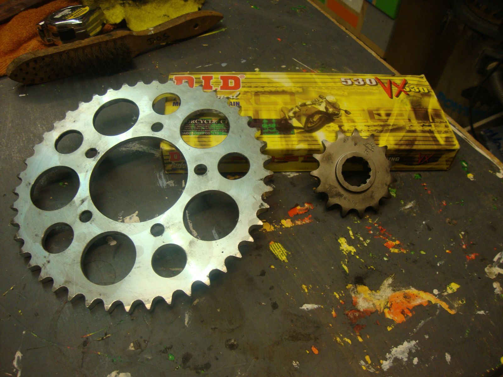

Picked up the sprocket carrier today.12mm off was the final measurement.So its done. I threw it in the bike for a quick look and it seems good. Ill put the sprocket on it and throw the chain around it to be sure but first I need to shorten the sprocket bolts and extend the thread a bit. Ill do that at the weekend.
530 chain and sprocket set

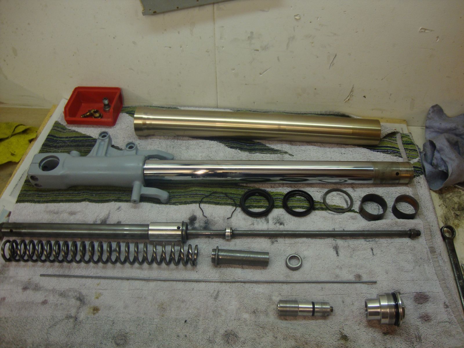

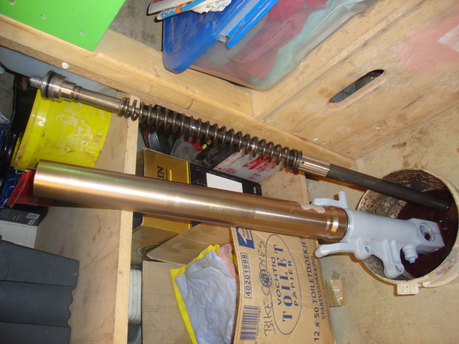

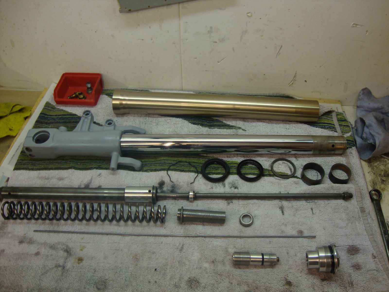

Ive also started cleaning up the ZX9R forks. Got new seals and dust covers and stripped everything down.
Ive just got to get some autosol to clean up the chrome before i put them all together again.
Ive also painted the bottoms a nice satin black but I havent got a photo yet as I only put the last coat on a couple of hours ago.

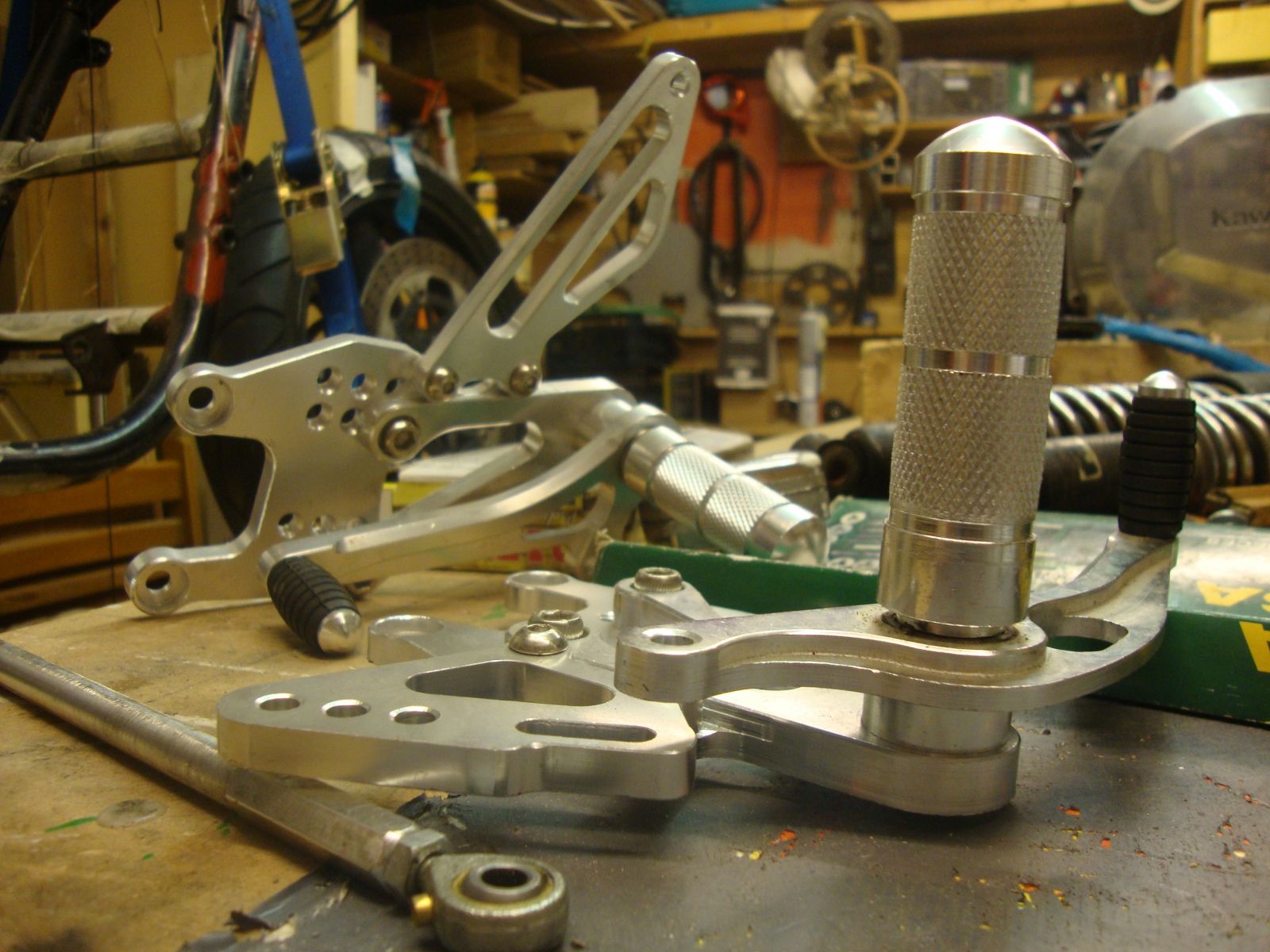

Im not into shiny stuff on the bike but I wanted to clean some bits up and got carried away with the polishing wheel. Anybody know how to polish aluminium to a matt finish?
and I got a good deal on these things from one of my local bike shops.
I thought they were a bit blingy but he let me take them home to try them and they look pretty good.No idea how or where Im going to mount them,but thats for later. My goal still is to get a rolling chassis and Its getting closer to happening.

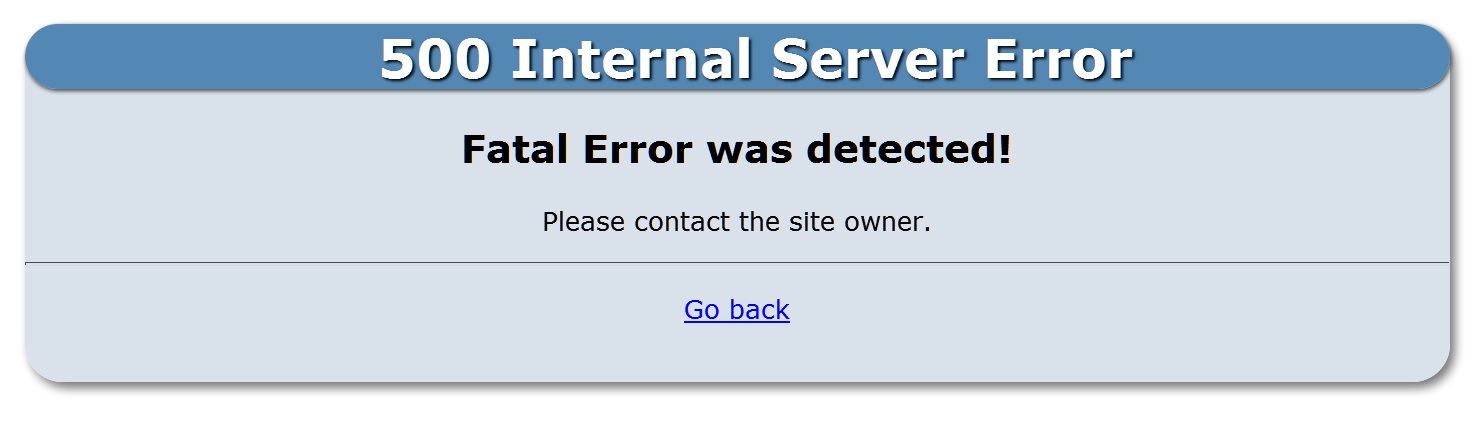

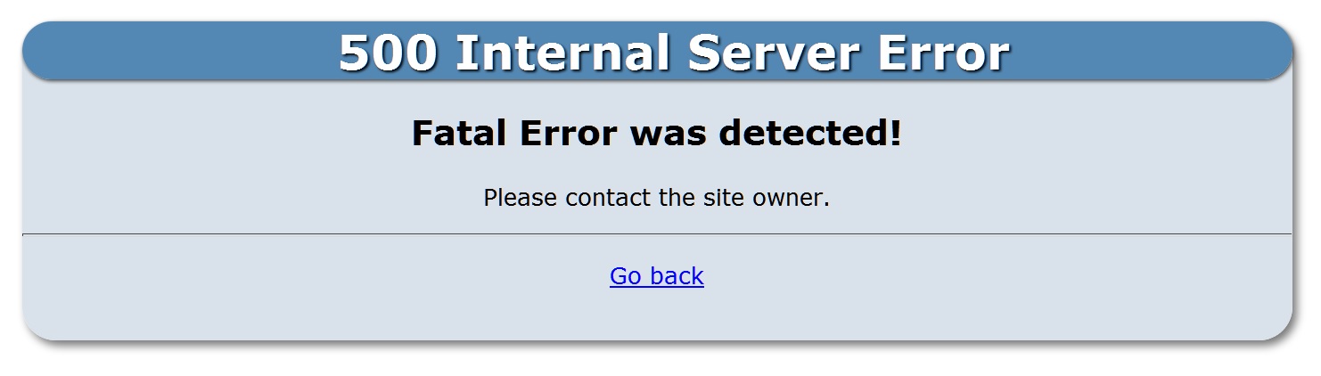

No,Not working.
'500 internal server error
Fatal error detected.'
Whats going on there then?
Is it me or the KZ site?
Please advise Admin.

your pic it to big

OK,Resized.

Chain/sproket set
Fork strip
Forks internals ready for cleaning

Rearsets
Thats it for now
