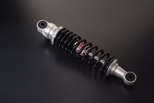

Just lost out on a very nice Harris pipe on ebay.Whacked over the head in the last minute!! Consoled myself by ordering a pair of YSS shocks

08 Jun 2015 17:37If you don't mind me asking, how much were those shox, and where from? They're gorgeous!
1980 KZ750H LTD-- pods-- vance & hines 4-1 --speedo/tach/blinker/switch deletes -- brat style
- davido
- Posts: 1602
- Thanks: 304
Re: CSR1000 Project Build
08 Jun 2015 17:45

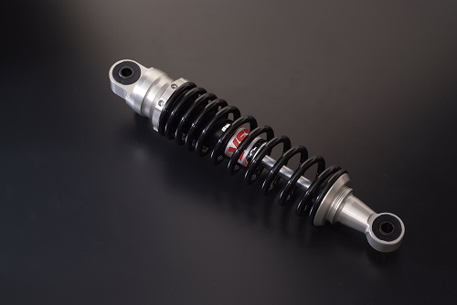

No eBay APP ID and/or Cert ID defined in Kunena configurationThey are nice,arent they! I think theyre from Thailand but Im not sure. Theyve been getting very good reviews and are pretty popular among classic enthusiasts here in europe. The ones Im going for (those in the photo) are the cheapest model.
But they have others for different price range. The piggyback ones are very nice but out of my budget.
www.yss.co.th/index.php

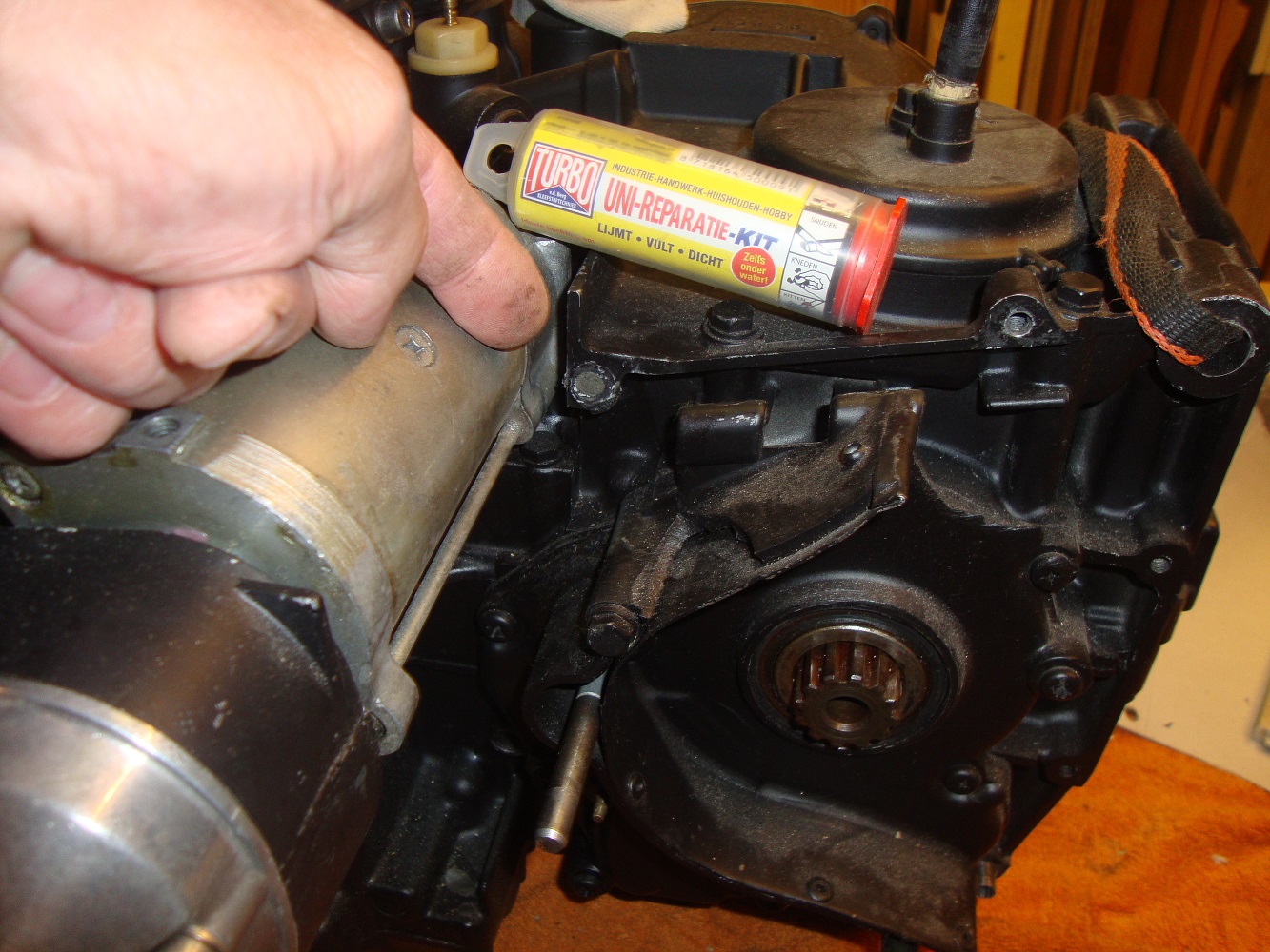

Back to the clutch conversion. One of the bolt holes was munched up,so Ive filled it with liquid metal and plan to thread an insert into it.
The problem is,its in a very awkward place (of course) and I cant get the drill onto it. I bought and extra long one yesterday and if I pull the
generator cover off,I hope to be able to get at it. Could someone do me a favour and get out the verniers. I need to know how deep the hole should be. I dont want to drill through into the crankcase.
Its the hole at the end of my finger.Top left.
Thanks in advance

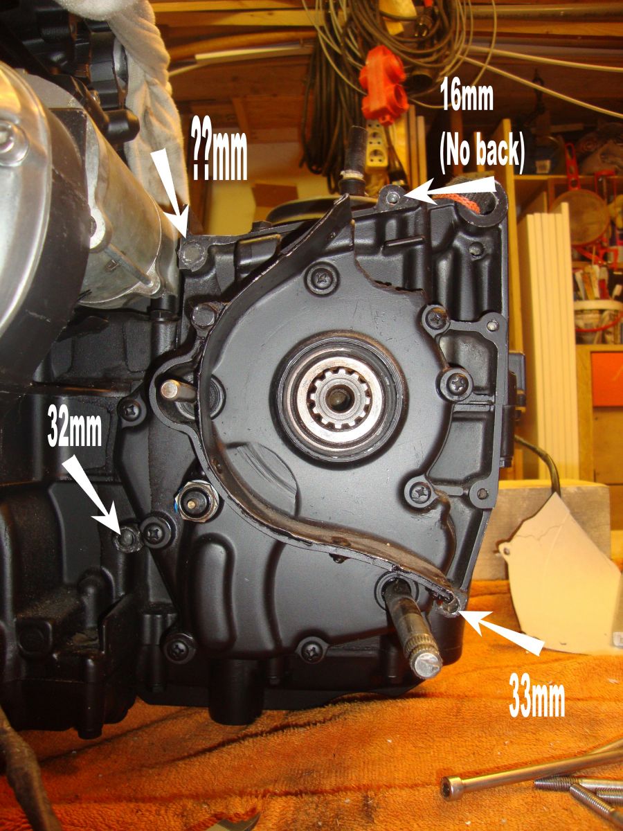

kaw-a-holic. No problem,Im not going to get anything done until tomorrow anyway.Its a 1981 J model motor and I did a picture of what I have.
If the other (known) measurements add up with yours then it should be good enough.
Thanks
Thanks

Bummer mine is different Davido. Mine passes through.
