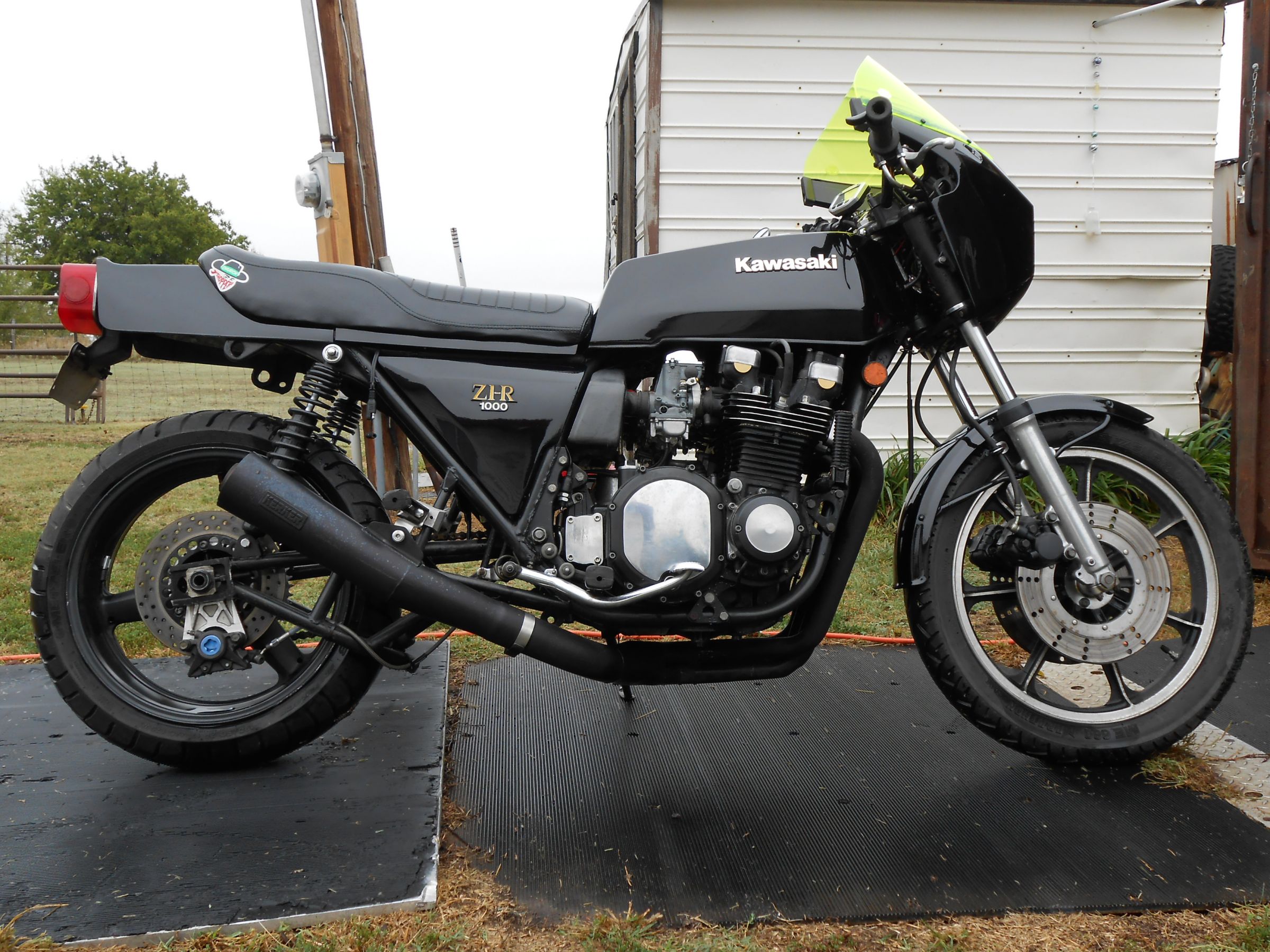

Well, it is 90% complete. I am just waiting on my side cover emblems to come back from my painter and have yet to decide on what to do about a pipe.

Looks great! I think a black kerker would be killer
Re: Neighbourdave's Z1-R resto
24 Aug 2016 13:11
Very nice.

24 Aug 2016 17:36DoctoRot wrote: Looks great! I think a black kerker would be killer
Agreed! You MUST get one.

Beautiful bike !
Have you taken it around the block yet ? I bet it rides as great as it looks.

25 Aug 2016 04:48JR wrote: Beautiful bike !
Thanks guys. Sorry, not much of a build thread.
I still haven't had it out (kids soccer, yard work, blah blah blah) but the mechanic that did the safety on it says it rides like it is brand new!
Hopefully tomorrow.
So what about this Kerker?
