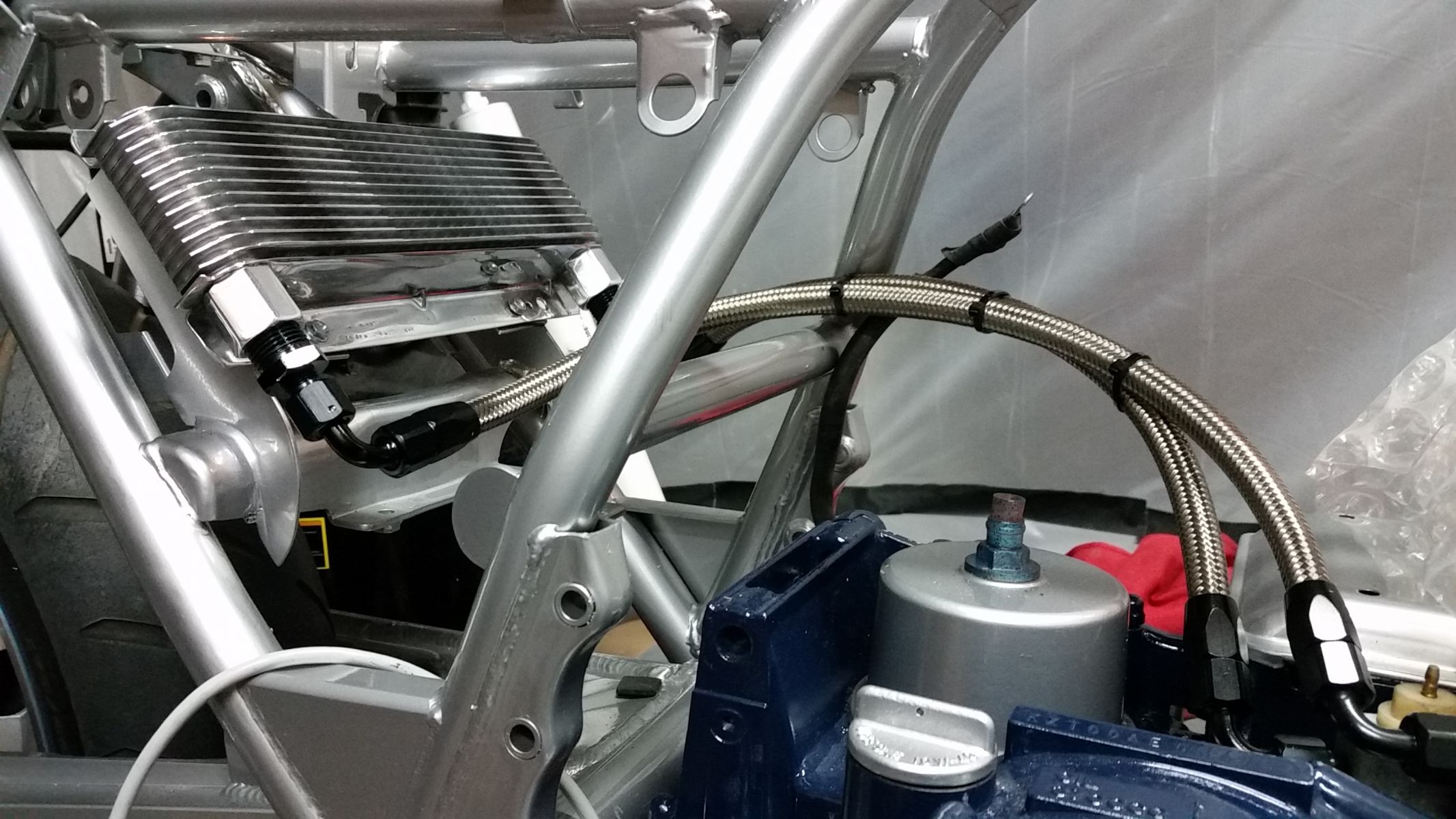

Thanks Dave, let me fill in some blanks for you. I am using a nontraditional oil cooler, a B&M Super Cooler,

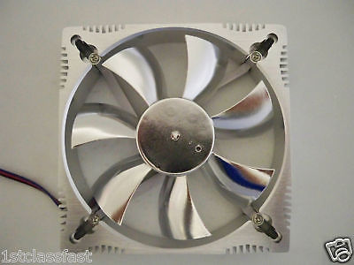

I will be using this aluminum ball bearing fan behind it

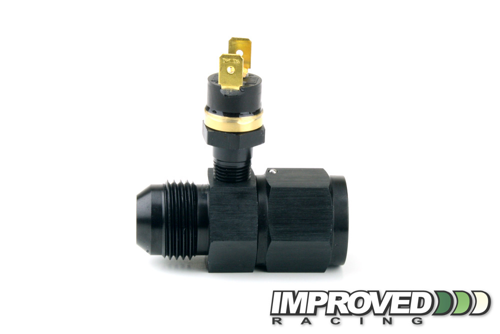

The fan will be controlled by this inline Thermal Switch Assembly for AN Hose you can get one that turns on at 180 or 190
It is very easy to wire, switched power to thermal switch -> to fan power lead ->fan ground lead to chassis.
Should be a pretty clean install.
