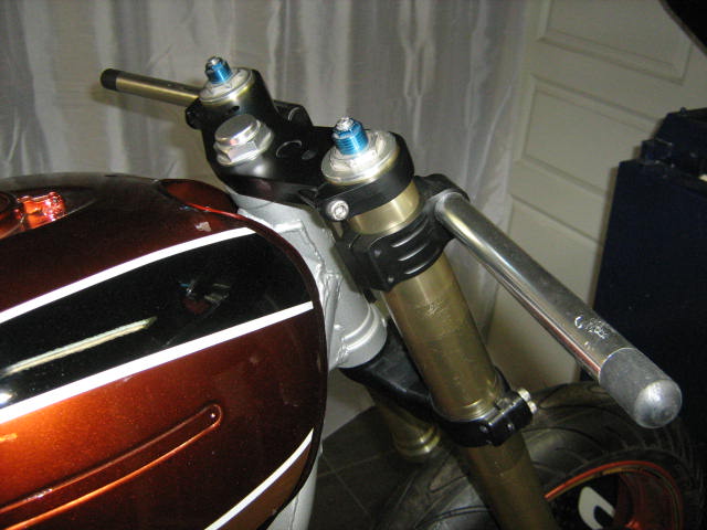

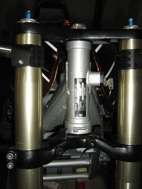

Yeeep...new bearings for the stem. Slight modification of the lock nut and the front end is cloer to final assembly.
Any one know how to get the "blue" spring loaders off ? Do you have to open the fork ?

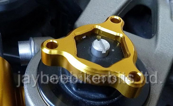

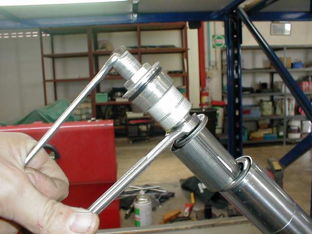

arnold,
you will have to remove the upper hexed cap,
and then remove the preload adjuster from that.
hth,
hth,

Thanx floivanus !
Leo, thax for the pic. :woohoo:
Is it worth the effort if I want to glas blaster and polish the plugs to get the blue color off ?
Wanna do this to get the color right and then add my pre load adjusters.
