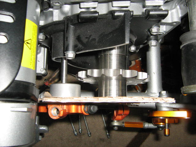

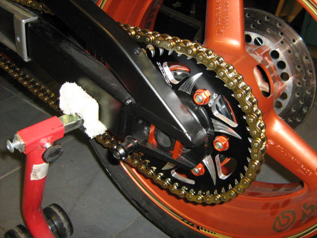

And it´s arc welded ! :woohoo:

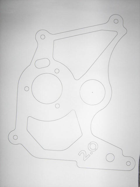

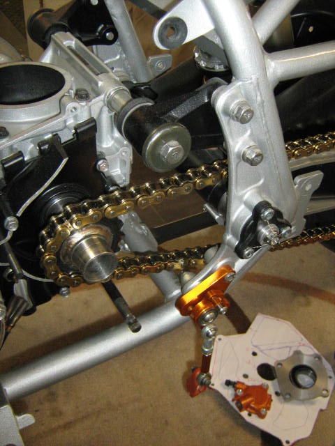

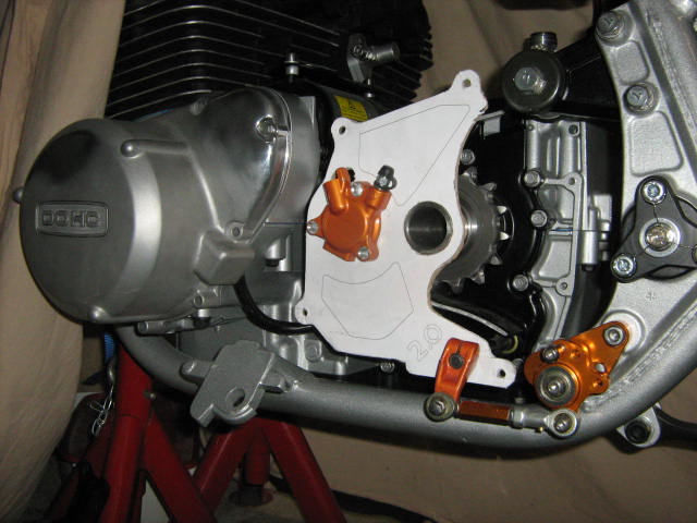

Made a template to find the center of the sprocket..
..and to see how things match up.
PS. This was before the sprocket was welded..

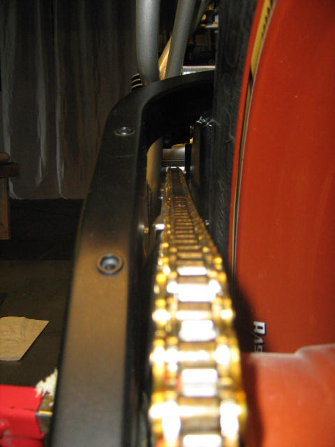

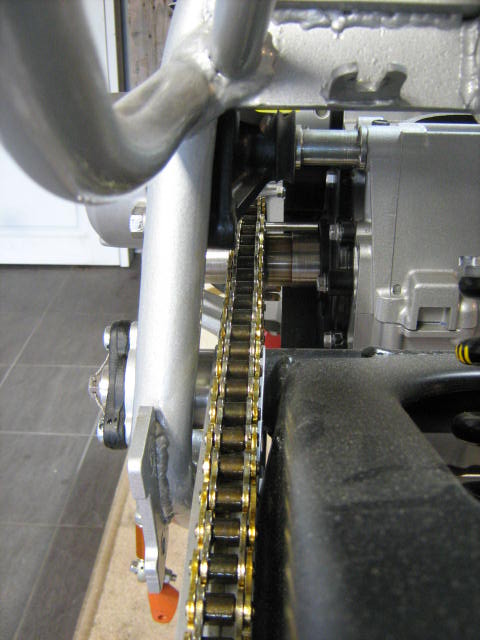

Re: Retro Fighter 2.0 (KZ 1100 -82 goes Z1 clone)
11 Sep 2014 13:47

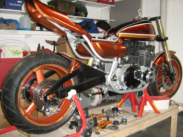

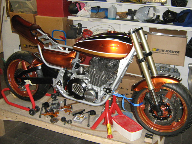

Did I miss something here- did you have to mod the frame at all to have the chain that far outboard? Did you post a pic with the chain alignment? I am super curious to see how you ran that chain! Great work, of course!

wow.....is chain running on the outside of the frame?
12 Sep 2014 05:49

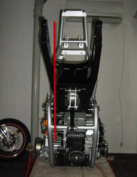

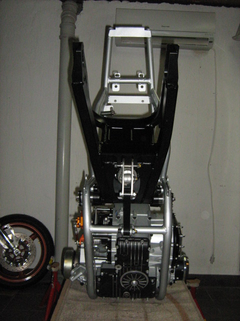

he used a shaft drive frame that is wider at the swingarm pivot than a chain drive frame.

Thank ya all...
And thanx Leo for explaining..
Only draw back with this is that you need to do a small shaft to chain conversion. :whistle:
KZ1100 shaft frame with Yamaha R1 swing arm...

- CruisingRam
- Posts: 643
- Thanks: 16
12 Sep 2014 14:34
I knew that- I just didn't know that the shaft drive frame was THAT much wider! That offset looks crazy in the pics.
13 Sep 2014 12:59
Wow, I didn't know the frame was THAT much wider either. That's another big difference the shaft has vs. the MKII....they kind of look alike but nearly every part is different.
Just curious.....would a standard chain drive motor bolt right into a shaft frame? I always assumed it would but I don't know for sure......
13 Sep 2014 13:4979MKII wrote: Wow, I didn't know the frame was THAT much wider either. That's another big difference the shaft has vs. the MKII....they kind of look alike but nearly every part is different.
I really, really want to know the answer to this question- makes all the difference in the world!
