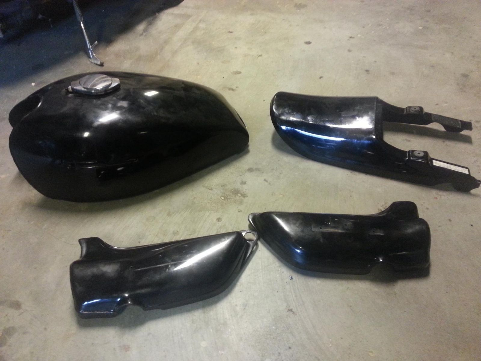

Fron this..
...to this in only 15 weeks. Gee I´m fast :laugh:
Yeah...the color really changes due to the light.
Thanx 650 !
Leon: You had to ge me a hard time about that :laugh:
Did not like the way the rear stripes lined with the front ones....so they got a no go !
Fron this..
Thanx 650 !

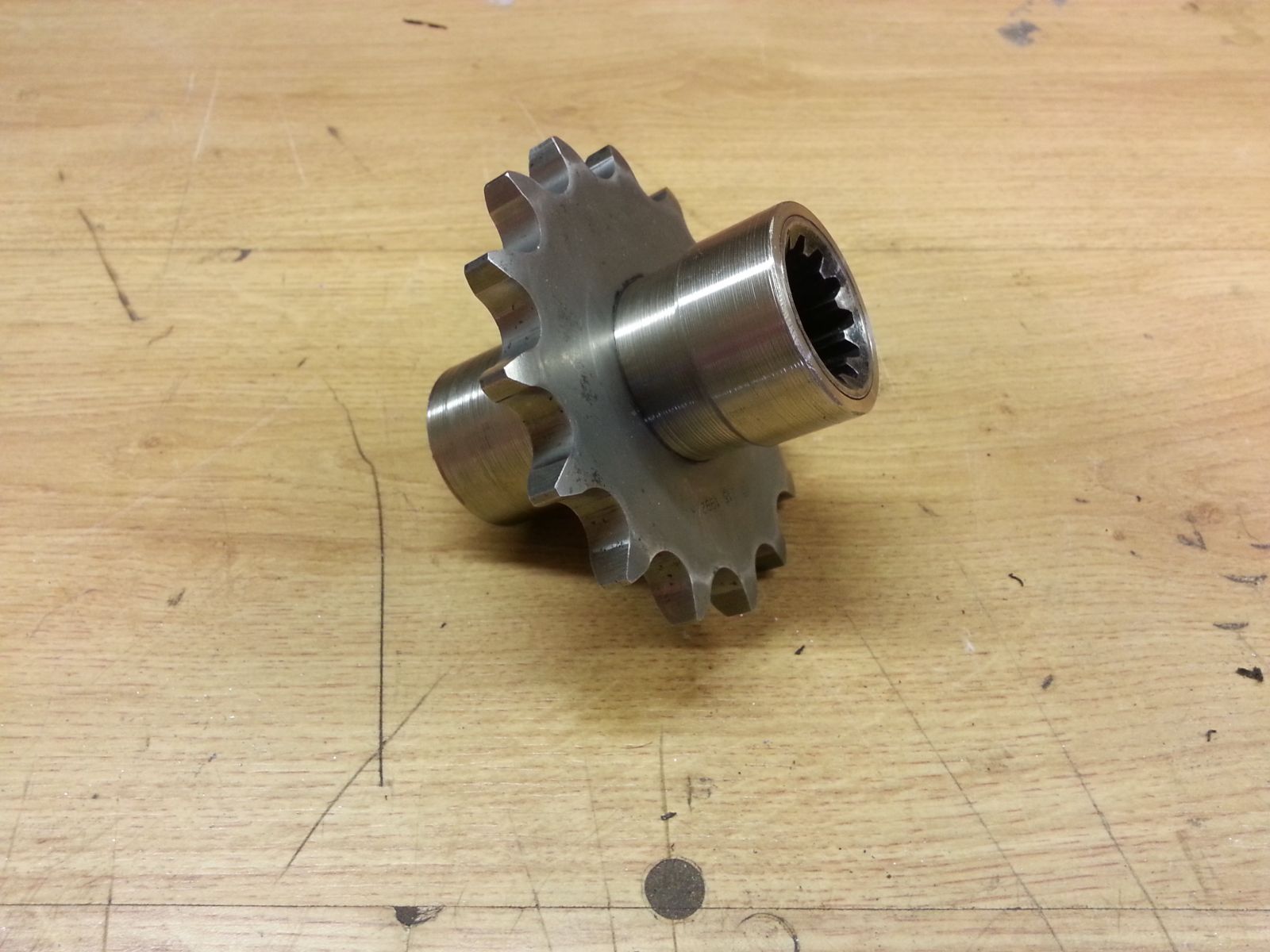

Hey,
The bike build is back in action again..
First I have to redo the off set sprocket due to "shit for barins" measures form my side.
Sorry Leon...but I could use the spline from the sprocket you made me.

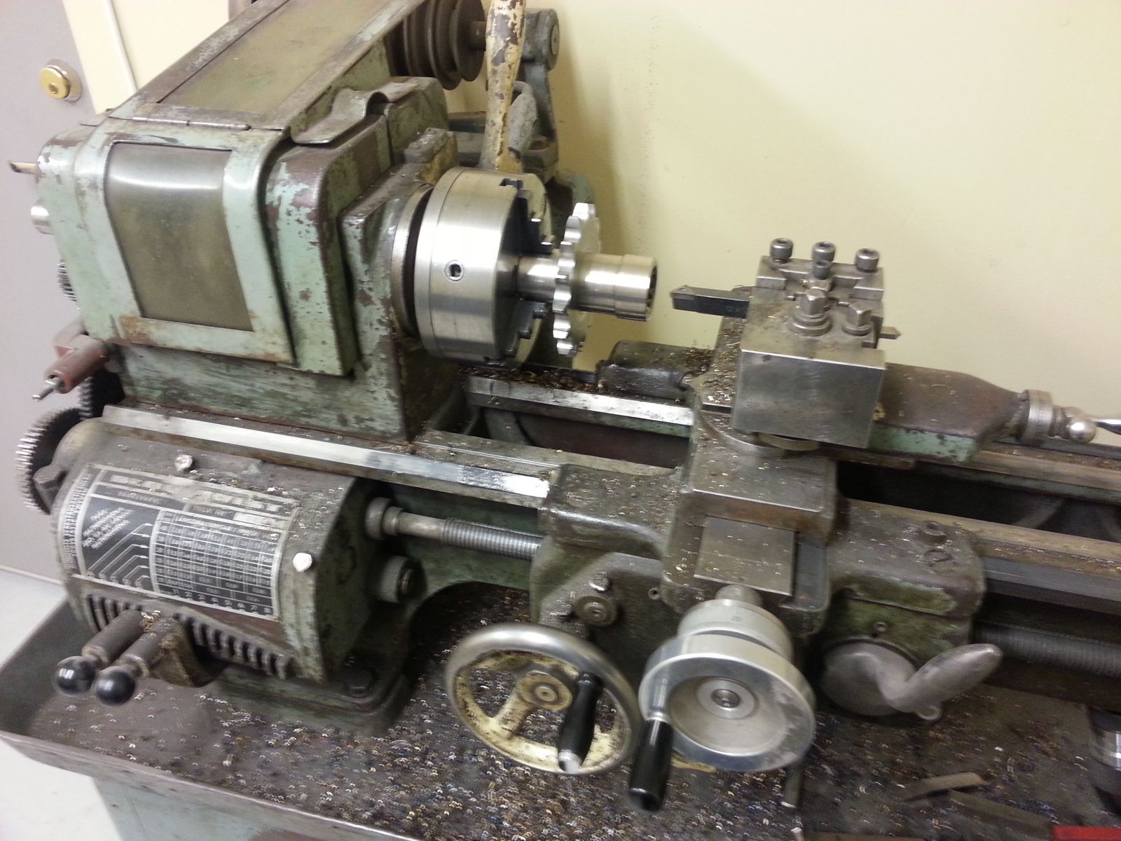

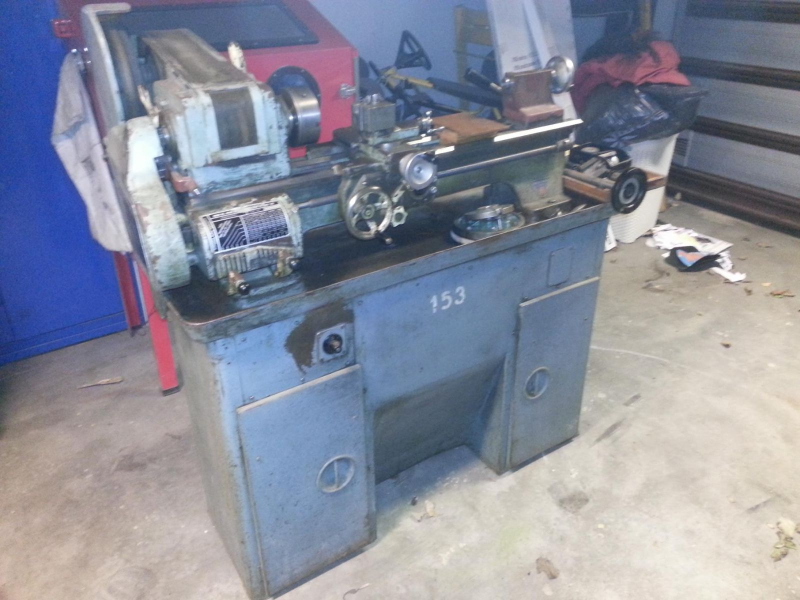

love your old school lathe! what brand is it?
The following user(s) said Thank You: Arnold
- Arnold
- Posts: 397
- Thanks: 14
Re: Retro Fighter 2.0 (KZ 1100 -82 goes Z1 clone)
10 Sep 2014 13:37
Hehe...it´s a Swedish brand called "Blomqwist"
Talked to some mechanics and they told me to go for this one instead of some equivalent china crap :lol:
Guess they were right cuz I managed to drop this baby on it´s side and after dusting it off it was up running again.

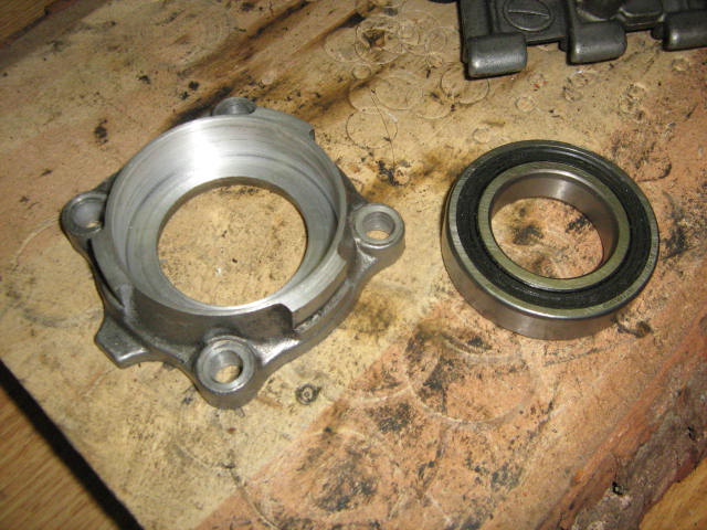

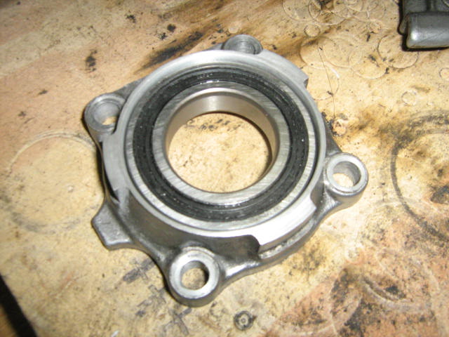

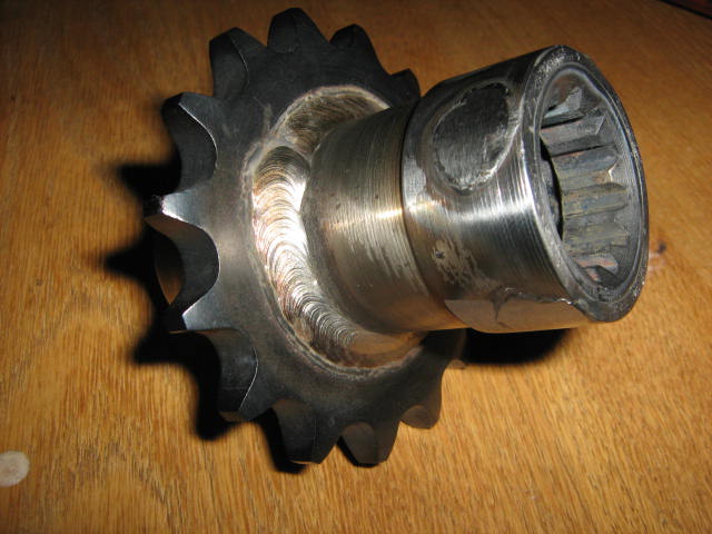

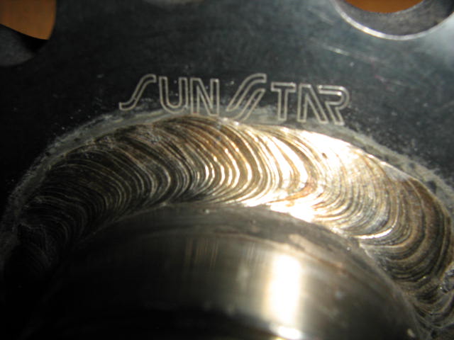

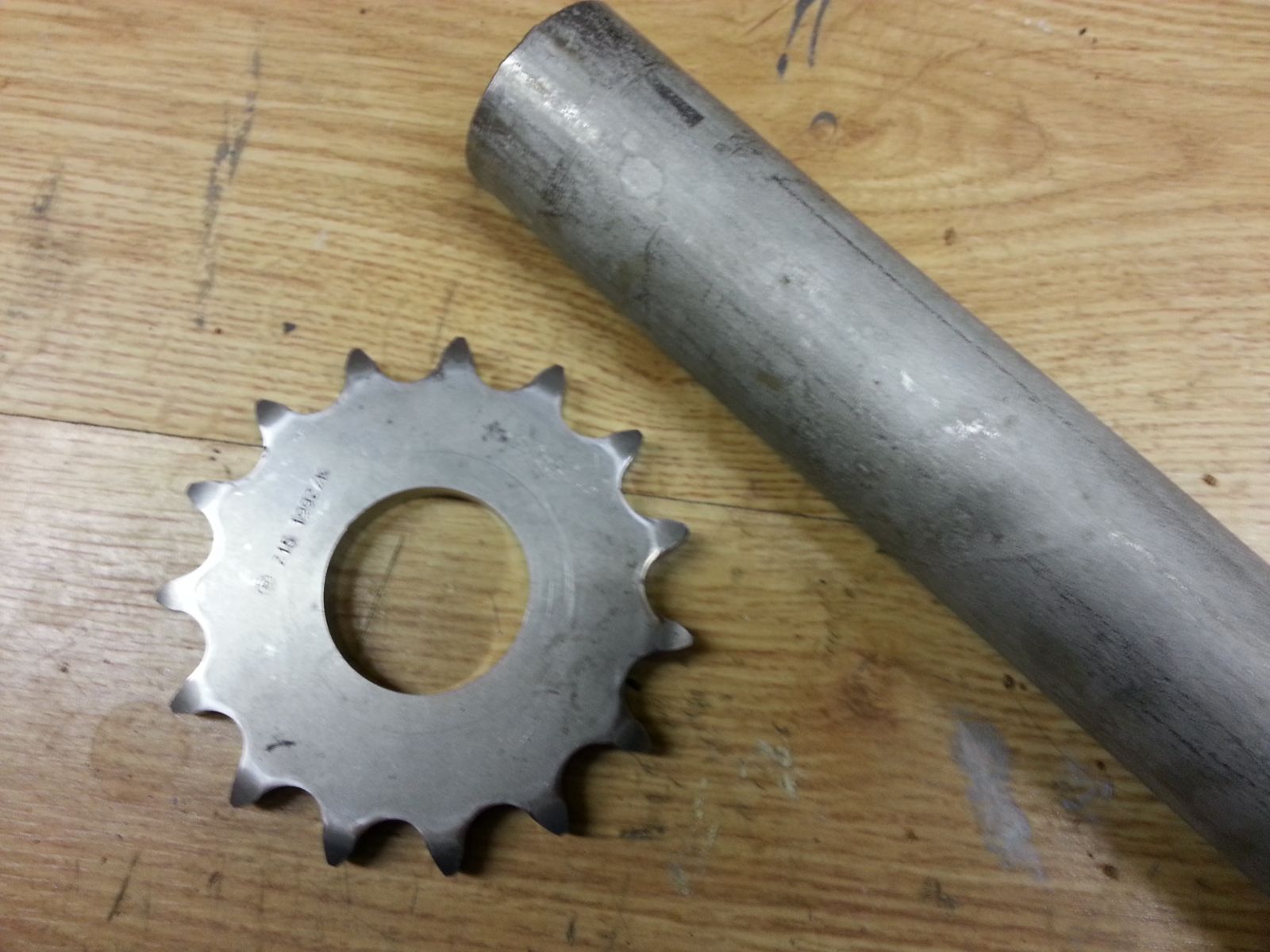

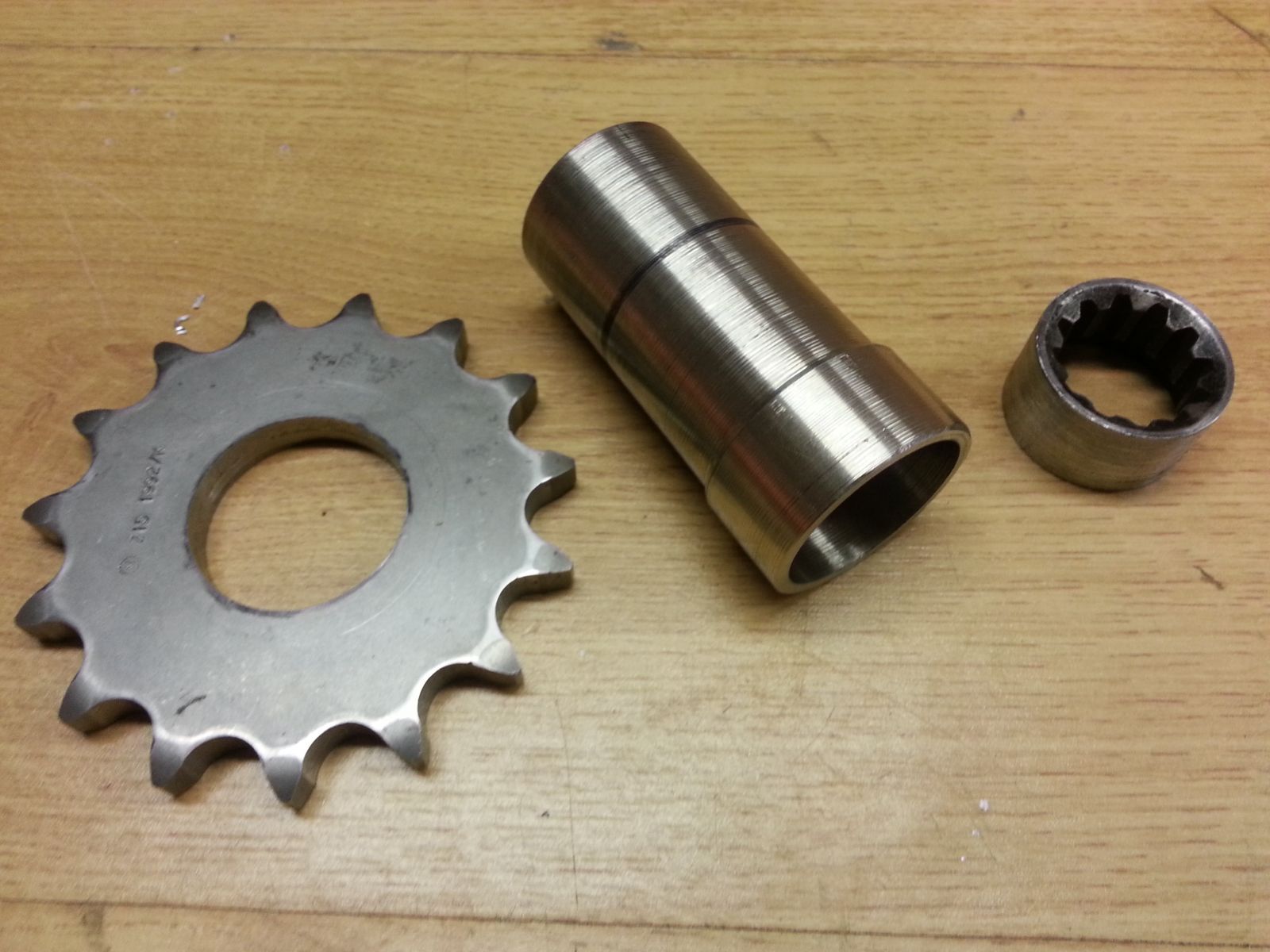

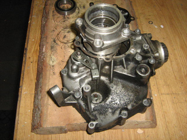

Got the guys at work to weld the sprocket up for me.
The old shaft drive had to donate some parts for bearing houseing.
And after smacking it around in my modern lathe...

Yepp....holy shit how off I was measuring. The offset is now 50 mm --> 2"
So I guess a support is in order... :silly:
