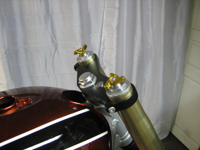

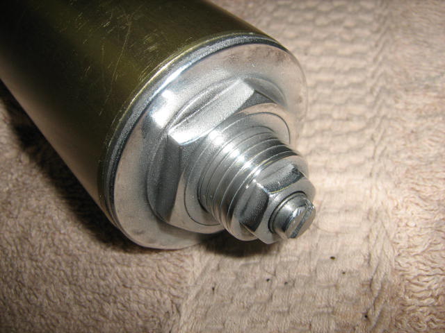

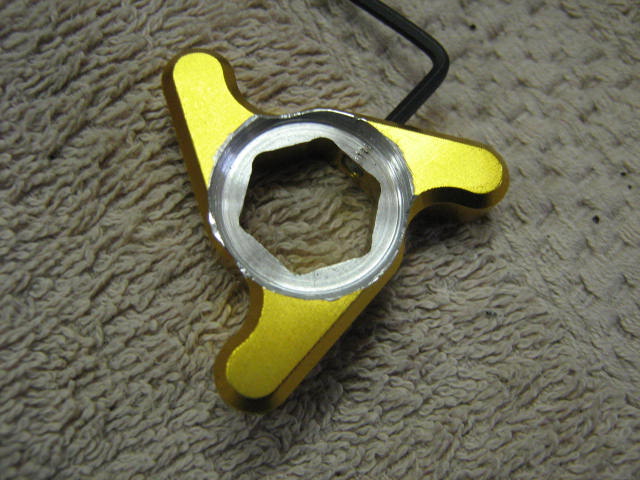

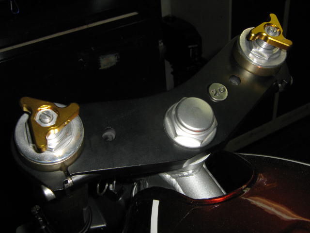

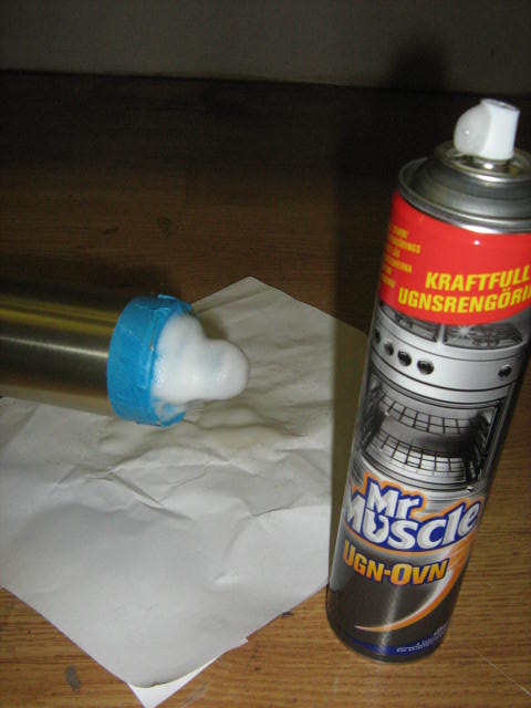

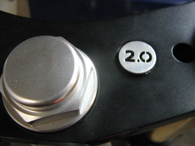

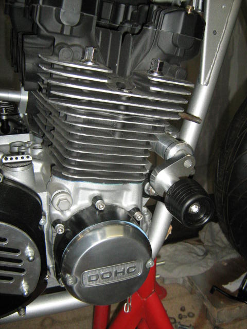

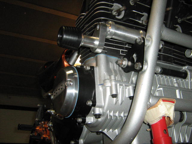

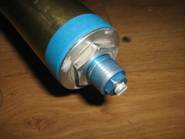

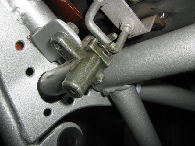

It takes a while to get the blue oxidation off with oven cleaner, but it comes off eventually.

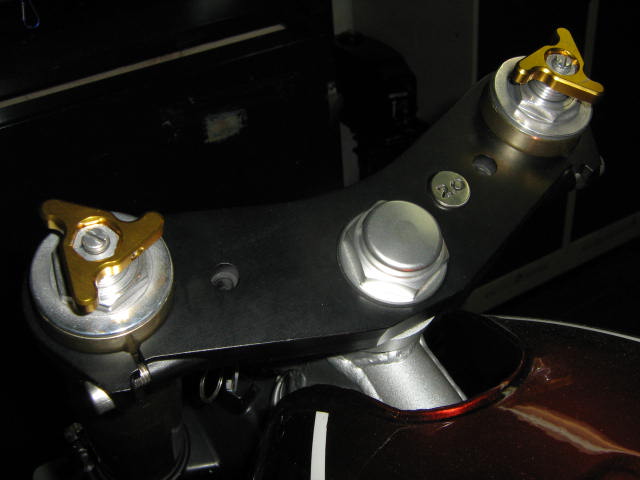

Please note the small 2.0-logo
Apply and let it soak for 10 min.
One more soak is needed...another 10 minutes.
Ploish off the last traces off blue..

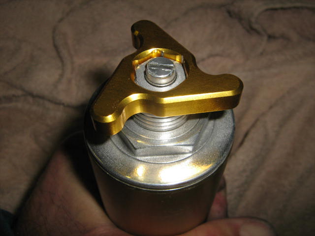

Pre load adjustorn had to be modified to come on nicely..
Assembeled..
2.0 is da shit :hihi

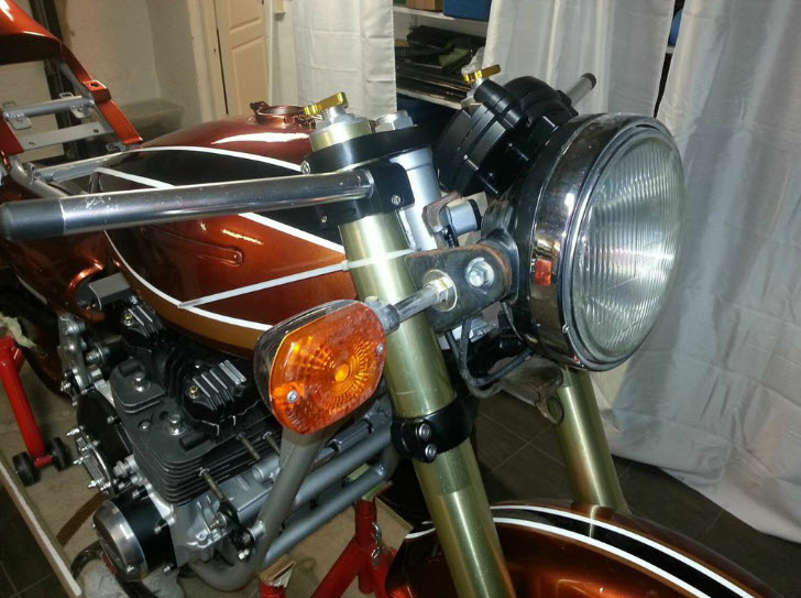

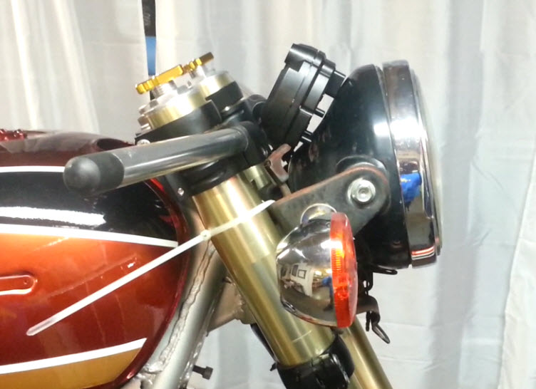

The new look..
Assembeled..
The new look..
