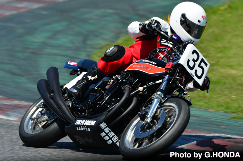

the lower windage fearing is nice on the KAW....like that look.
