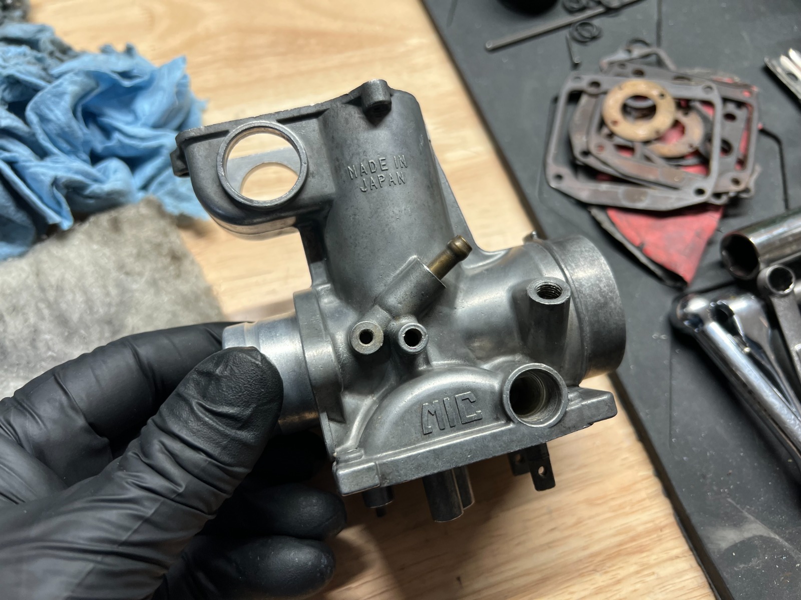

Re: '76 KZ900 (ZRX1200R) Build
18 Jan 2025 13:41 - 18 Jan 2025 13:41

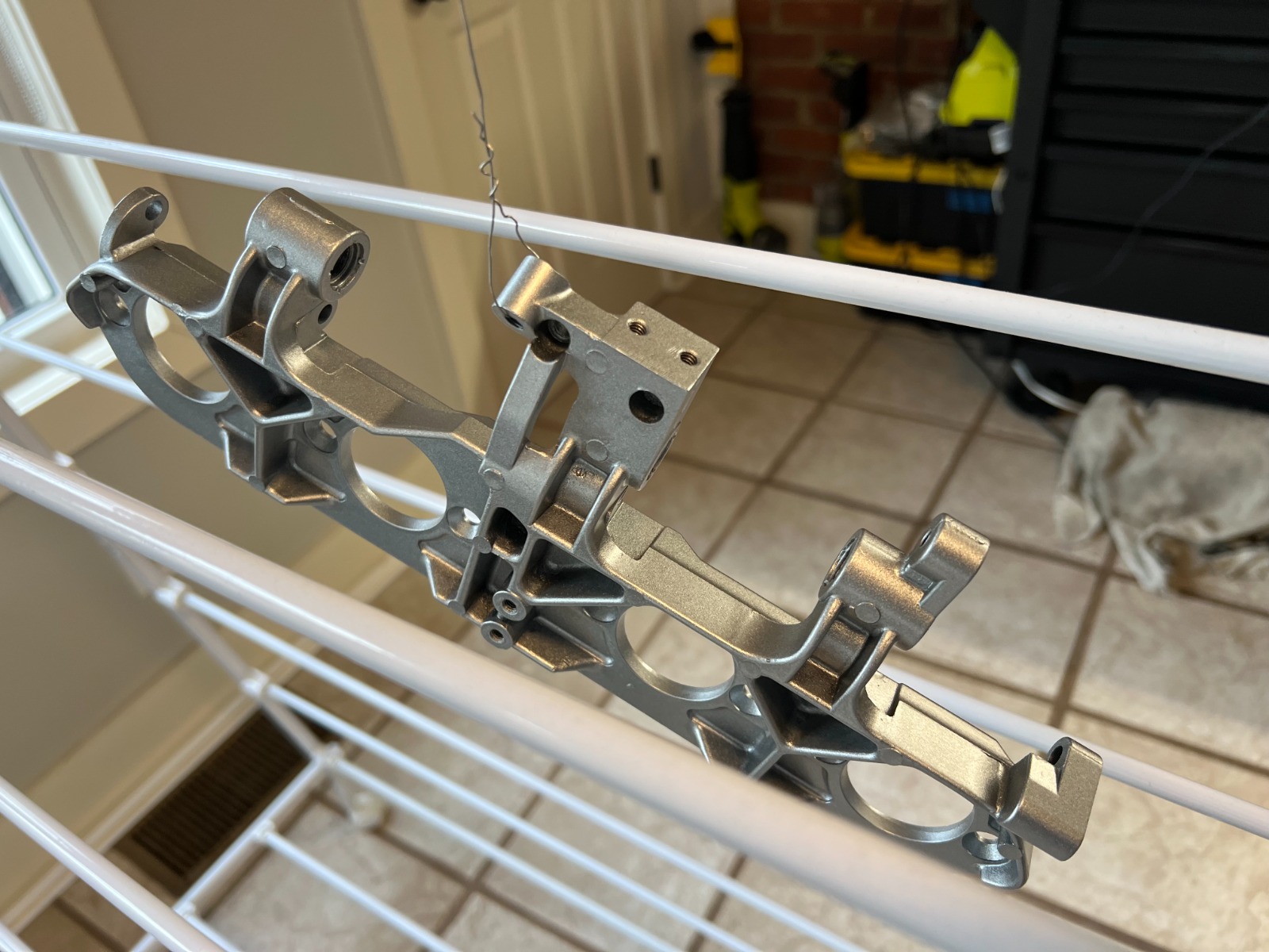

Ok I haven’t typed up the recent update, but need some advice. I got my VM29 Smoothbores and cleaning/rebuilding them. In my process I have cleaned each body and the rack bracket. Given the age, though they are spic and span, they are not like shiney cast aluminum. So I am trying a VHT Engine paint that is a flat/satin ‘Cast Aluminum’ paint. So I took the rack and gave it some light coats and thinking about doing the same to the carb bodies? What say ye?
Cory
Cory
2008 Kawasaki Concours 14
1999 Kawasaki ZRX1100
1976 Kawasaki KZ900
1976 Kawasaki KZ900
Last edit: 18 Jan 2025 13:41 by NakedFun.
- zed1015
- Posts: 3362
- Thanks: 2072
18 Jan 2025 14:36 - 18 Jan 2025 14:37
Painted bodies won't look good for long ..
Better off just leaving them with a clean natural alloy finish.

- NakedFun
- Posts: 1129
- Thanks: 121
18 Jan 2025 14:55
I understand that is a risk, even with this being highly fuel resistant paint. That is what has been stopping me from just doing it. The bracket was something I knew would be a safer bet just to see how it would look.
Thanks for the feedback.

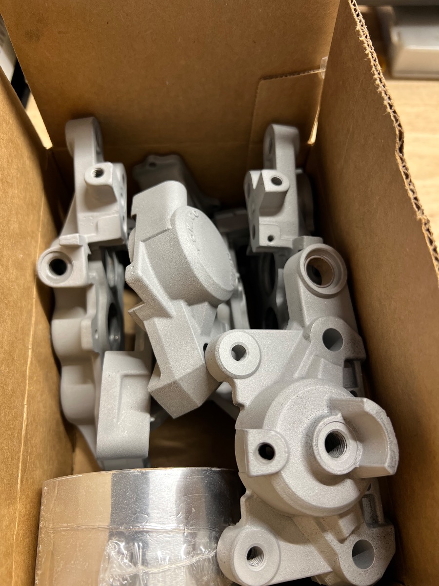

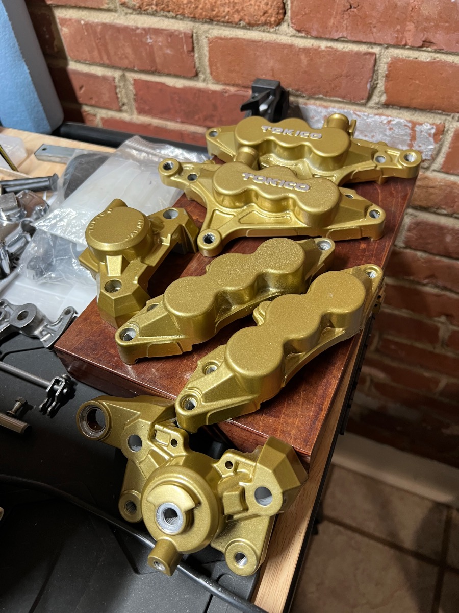

19 Jan 2025 19:36
So I blasted all the caliper and carb tops and spent time getting reaquainted with powder coating. Old powder and plenty of work later, I have all the calipers done. One had a screw up, so I cleaned up the bad spots and reapplied. Still not as good as the other side….I really don’t want to start over again blasting a half a caliper but thinking I may be….
