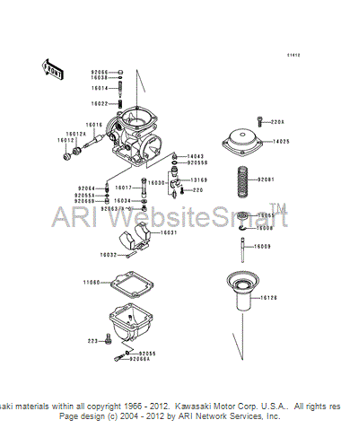

Cuff, I have removed the PAIR system. My main jets went from 127.5 to 132.5, but I have not changed my pilot jets. As for idle air mixture screws, I cant find them. They are prob right in front of me. Either way, I think the bike was just upset about not being ridden for 2 weeks. She ran great today.

The Idle mixture screws will have Anti-Tamper caps, which need to be removed. A small drill, then a self tapping sheet metal screw and a pair of pliers works. 92066 in the drawing.
Turning the screw out will richen the Idle fuel mixture, more than 3-1/2 or so I'd go up a pilot jet size. If there are no vacuum leaks and the carbs are of course clean, with the correct fuel level in the bowls. Use the clear tube test to verify fuel level.

Oh, ok, yea, now I remember. I will pull those caps out and go from there. Thanks
