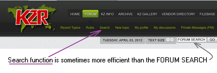

These links point to some helpful info about speed wobble causes and prevention.
www.kzrider.com/forum/5-chassis/500748-r...-turns-normal#500748
www.kzrider.com/forum/25-racing/500376-r...e-ready-again#500376
www.kzrider.com/forum/5-chassis/496196-r...-turns-normal#496196
Could also do a forum search for speed wobble.
