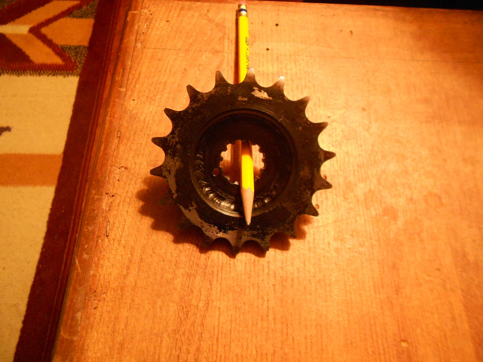

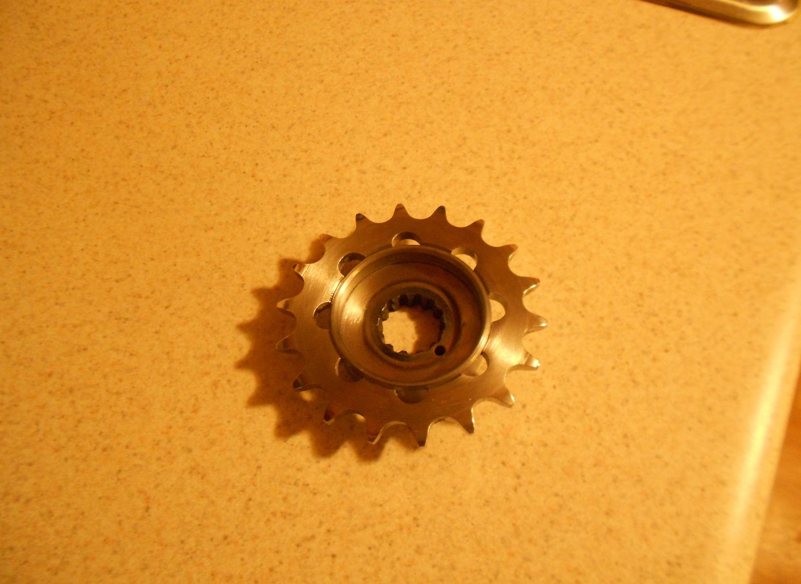

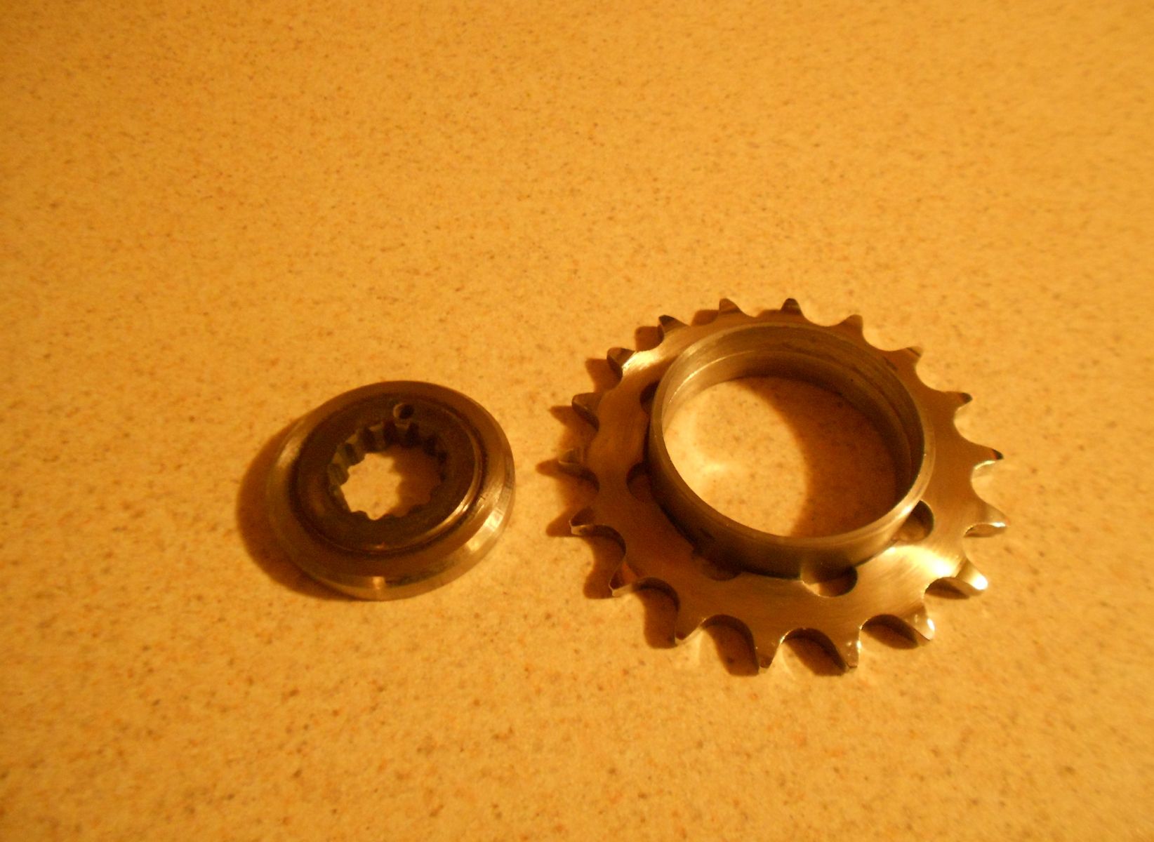

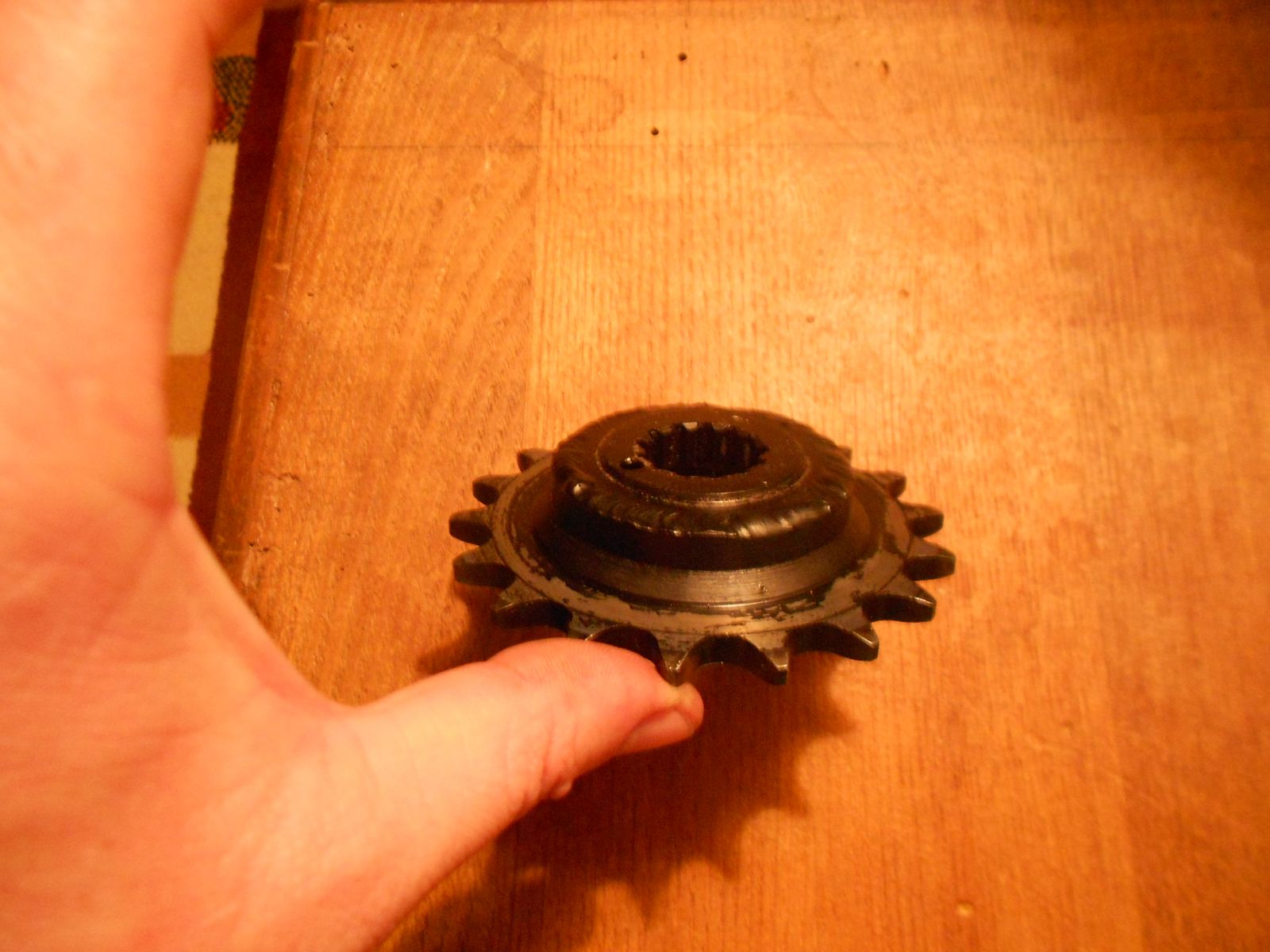

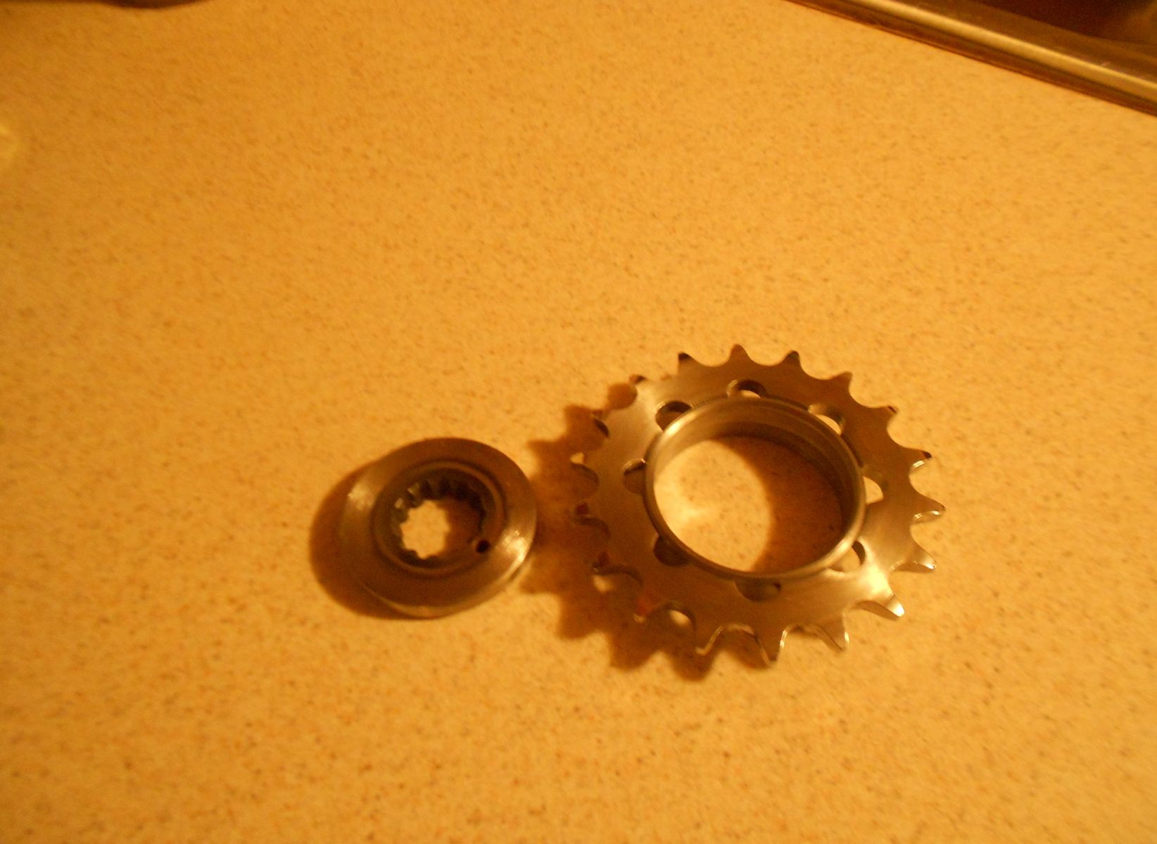

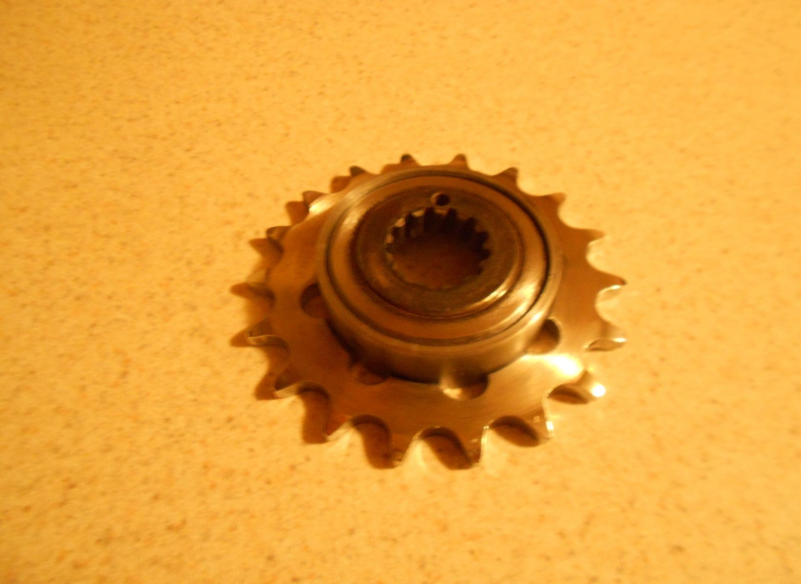

ramtough,
i just got back in from the shop.
i thought i was going to have your sprocket ready to ship in the morn,but alas i am not
but i did make some good headway and got it all ready to weld up tomorrow night,and ship wednesday.
here are the pics,
here are the pics,

Thats better than porn! I can't wait to pull it put of the garage and run it down the road

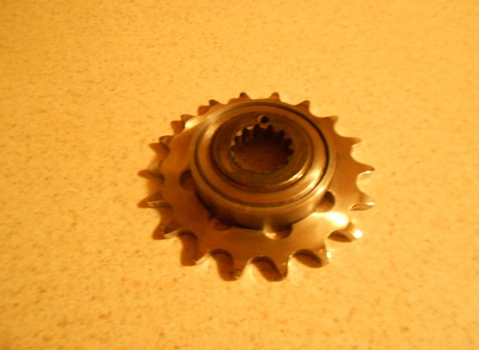

i got your 1/2 offset countershaft sprocket done.
so see even if you did not get to work on your bike today there was still progress made. :evil:
this is what makes kz rider so cool !
all us kawi nuts helpin each other keep these old bikes goin

Leon you are the man! That so rocks my friend! I'm gonna be down a couple days but plan on going up this weekend and fit my seat with any luck I can put the chain on as well.
