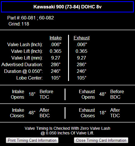

Thanks racer! I already have a set of 29's, so that is taken care of. I'm considering the GPz cams - the do not have a tach gear? That's pretty damn important to me - especially as a stock appearing digital tachometer is something like $200 the last time I checked - for that stuff combined, I may as well buy a set of new Web's!
Do you, or anyone else on here, have experience with Web 118's?

the web 118's are what Larry C recommended to me for a woken up daily rider. have yet to run them though.
- mtbspeedfreak
- Posts: 1413
- Thanks: 36
Re: My pride and joy
08 Jan 2014 09:30DoctoRot wrote: the web 118's are what Larry C recommended to me for a woken up daily rider. have yet to run them though.
Yes sir! i got that recommendation from him as well. I know there are a few guys running 118's on here and they seem like a good improvement from stock on a rebuilt engine.
