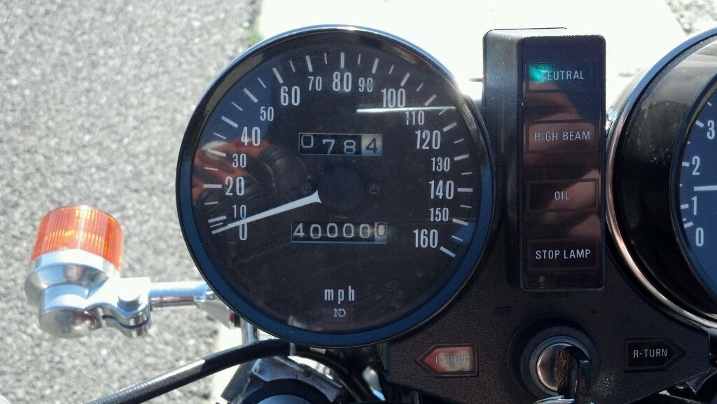

I only managed to ride ten-thousand miles this year so I just turned 40k. We'll git em next year!

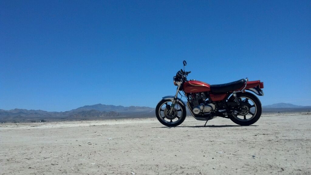

Went for a ride today. Didn't have any particular destination in mind, just wanted to ride. Wound up in Barstow of all places.

I've had a few PMs on my turn signals, so I thought I'd share. I did plenty of research ahead of time and did a full conversion. Here are the LEDs I use (from superbrightLEDs.com):
Turn signals- 1156-A45-T (45 LED, amber)
Tail light- 1157-W45-T (45 LED, white)
Gauge backlights- BA9SF-W-12V (single LED, somewhat larger, 180 degree beam pattern, white)
Indicator lights- BA9S-W-90-12V (single LED, 90 degree beam pattern, white)
Flasher- CF12ANL
I tried the BA9S-WHP9 for the gauge backlights and indicator lights, but they didn't fit- too long.
I like my setup. Only complaint is that the BA9 bulb bases were too long, so I filed a little bit of the ground contact off and they fit right in. Use dialectic grease- the posts on the bases are actually pressed from the ground shell itself, the first time I removed the turn signal bulb, one of the posts was stuck and wound up breaking off leaving a nice little hole. I have it MacGuyvered in there now, but they're giving me problems.

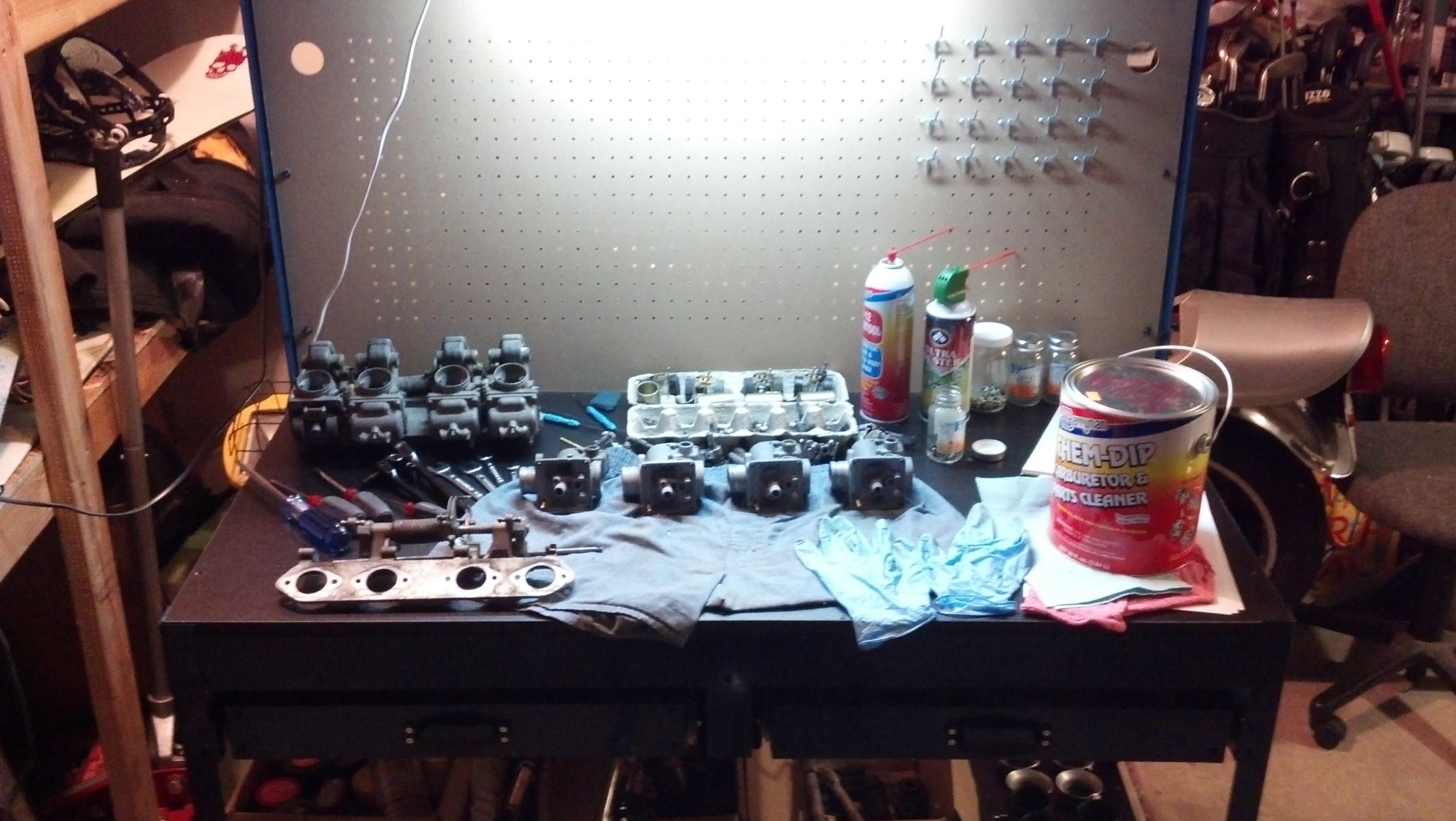

Also, popped my carburetor cherry over the weekend.
It's pretty easy taking them apart and cleaning them! Let's see how well they go back together :evil:

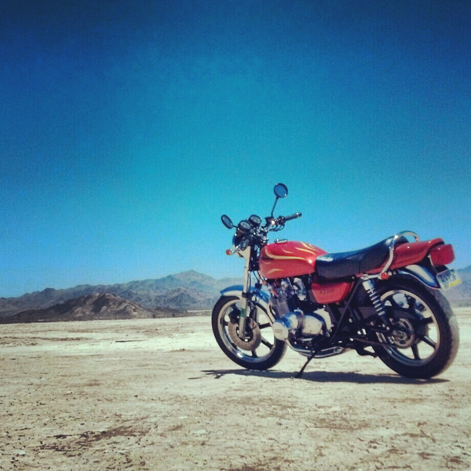

Another picture from my ride up to Barstow. I recently started using the social networking application Instagram. It's pretty interesting... You can tag your pictures with keywords to other users can search for pictures they like. Quite a few folks from Japan have liked pictures of my bike and started following my feed. Interesting what the world is becoming!
