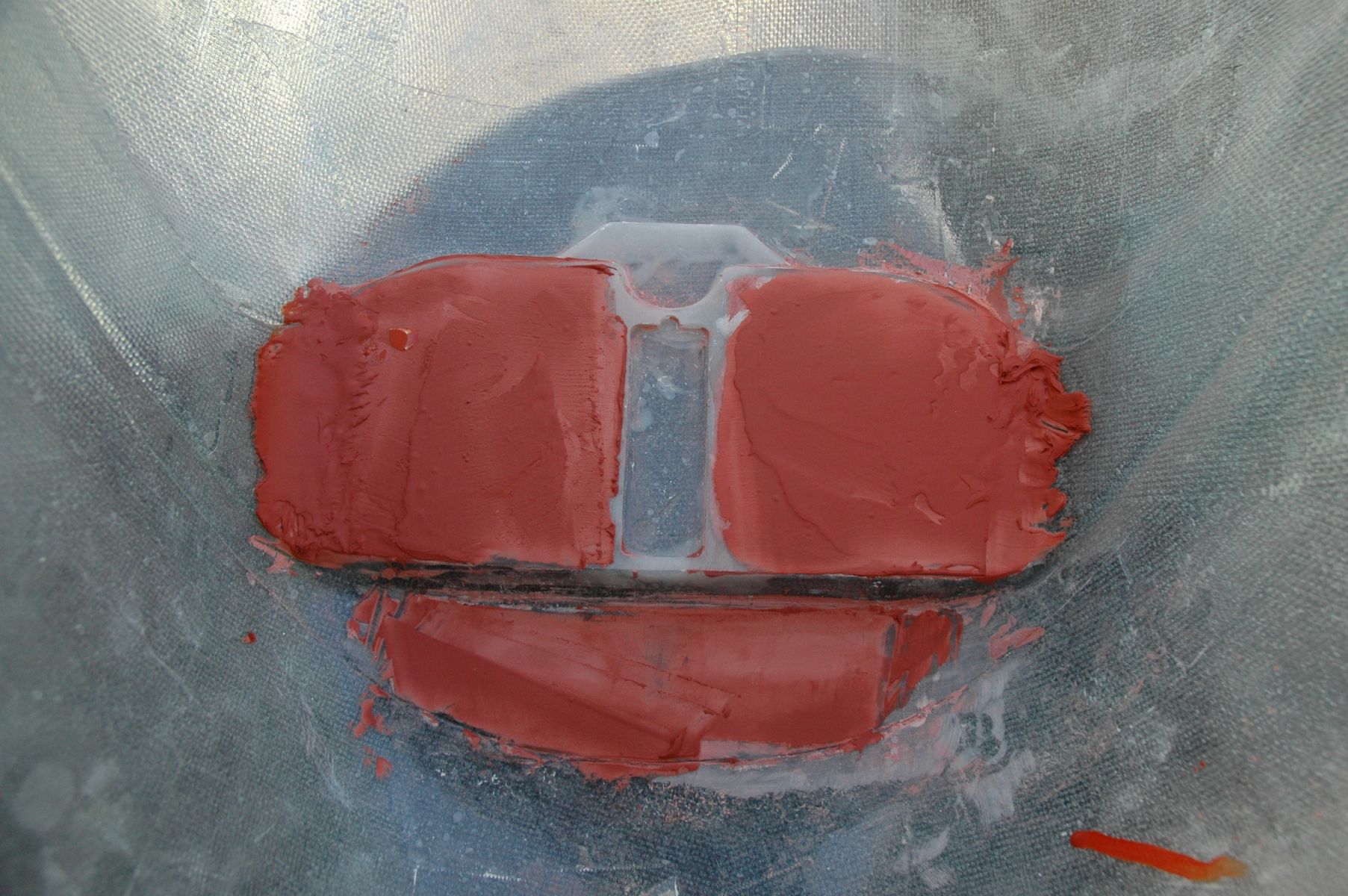

The face of the dash wasn't as flat as I would have expected. Another thin coat of spot putty to fill in the low areas in the dash and in my previous applications of filler :whistle: Of course, this pic looks nearly identical to the last one, but progress is progress, and more than one person is counting on this coming together.....

Progress is progress Adam, Looking forward to seeing it.
Les

shoot adam i am just glad that you didn't just pick up your ball and go home. :whistle:
the carbon fiber parts you are building,at least you have a bike to hang those on.
these z1r dashes,you (in all likely hood) won't get to even use one yourself :pinch: .
so for you to gut it out and get a sweet assed mold built to be able to lay up some kickass parts is pretty freakin cool in my book. :evil:
way to go man.
thanks alot.
