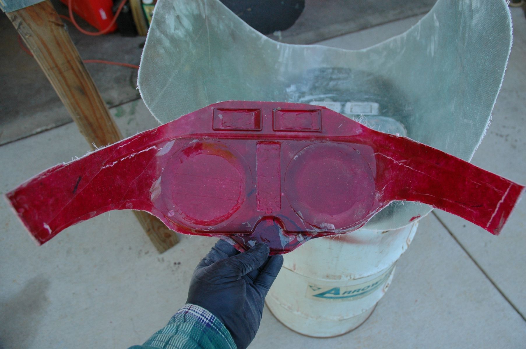

For kicks, I rough cut out the rejected plug. Besides being red...and kinda flimsy... and not good, its not too bad:

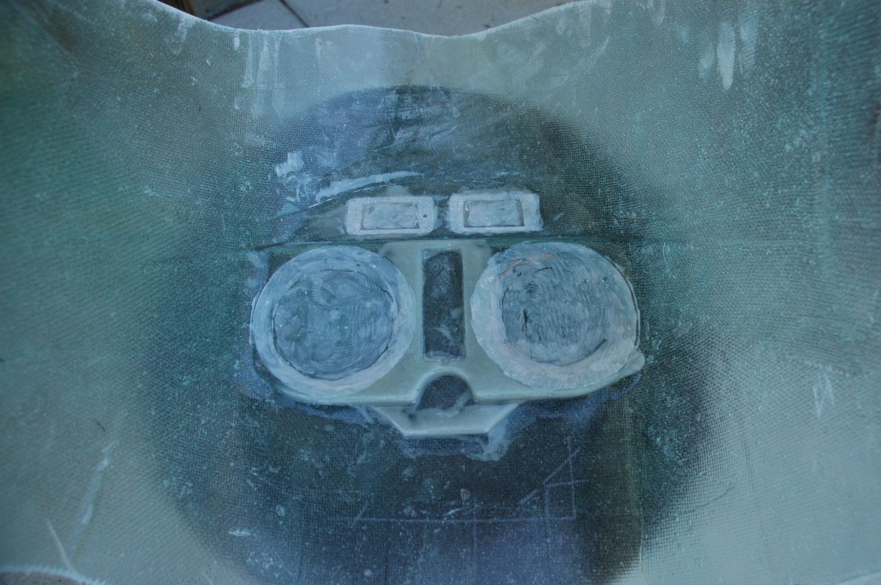

After removing the gauge bezels on the top, I could see that there is nothing left of the opening, so those will be flushed over as well. Here is the plug after prepping the gauge openings:
I'm gonna work on my tank a bit and get it ready for body filler too, then I can do it all in one shot.

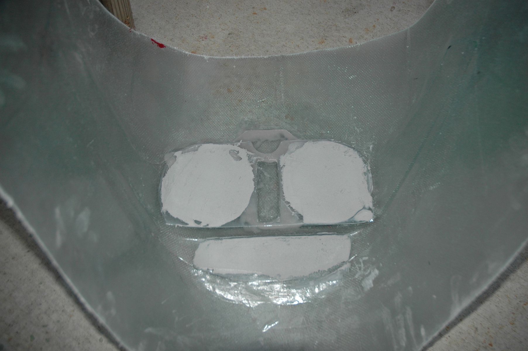

And a smear of body filler to fill in the low spots in the gauge openings......
There will be a few applications of filler/spot putty. But once I get it finished out, the entire mold will get a sanding with 320 or 400 grit, then a coat of epoxy primer. There were some irregularities and scratches in the OEM dash from its numerous repairs that I do not want showing up in my finished mold. Now is the time to take care of those irregularities
