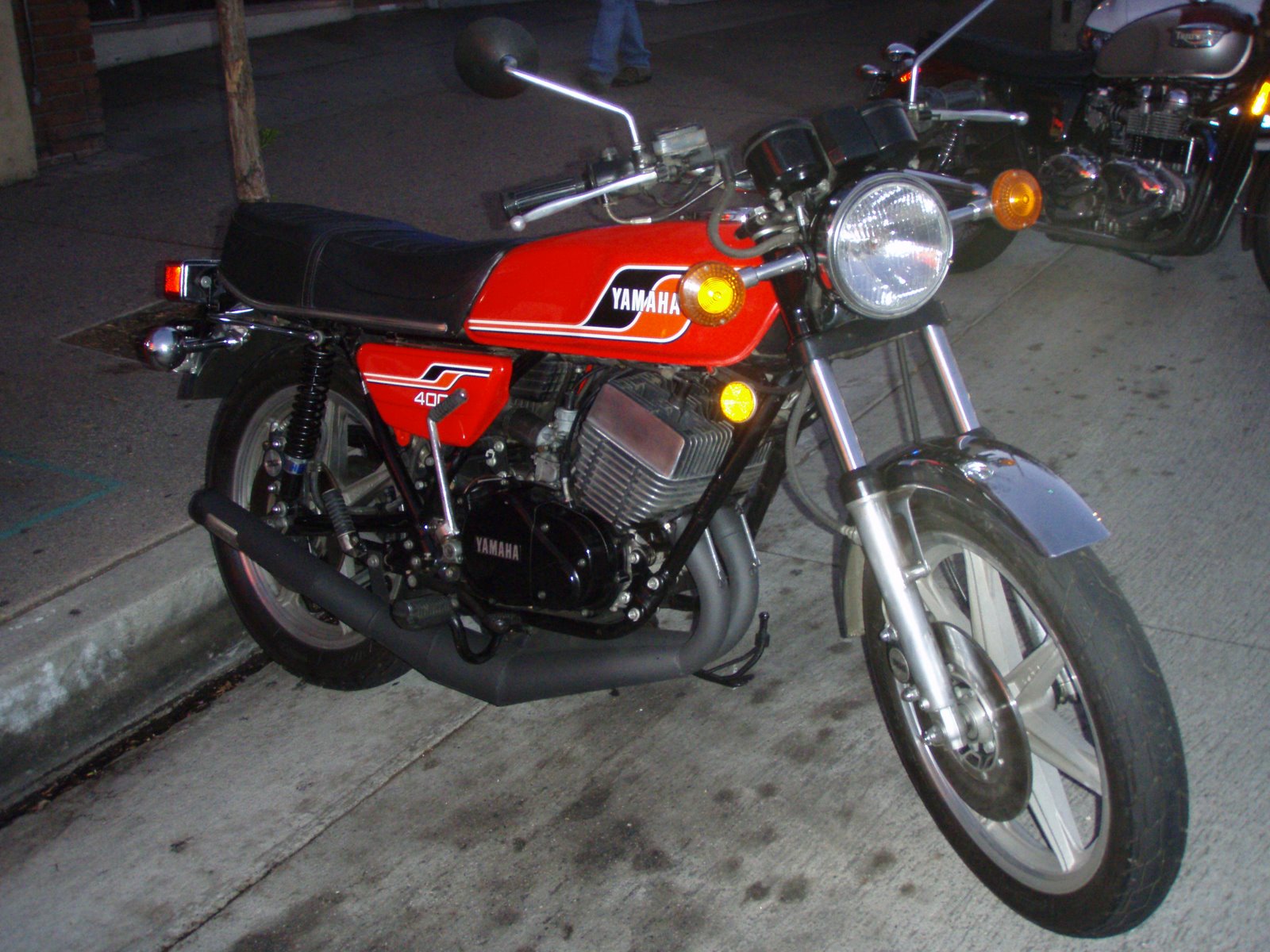

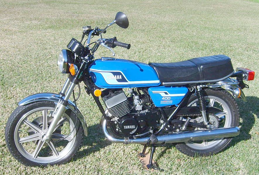

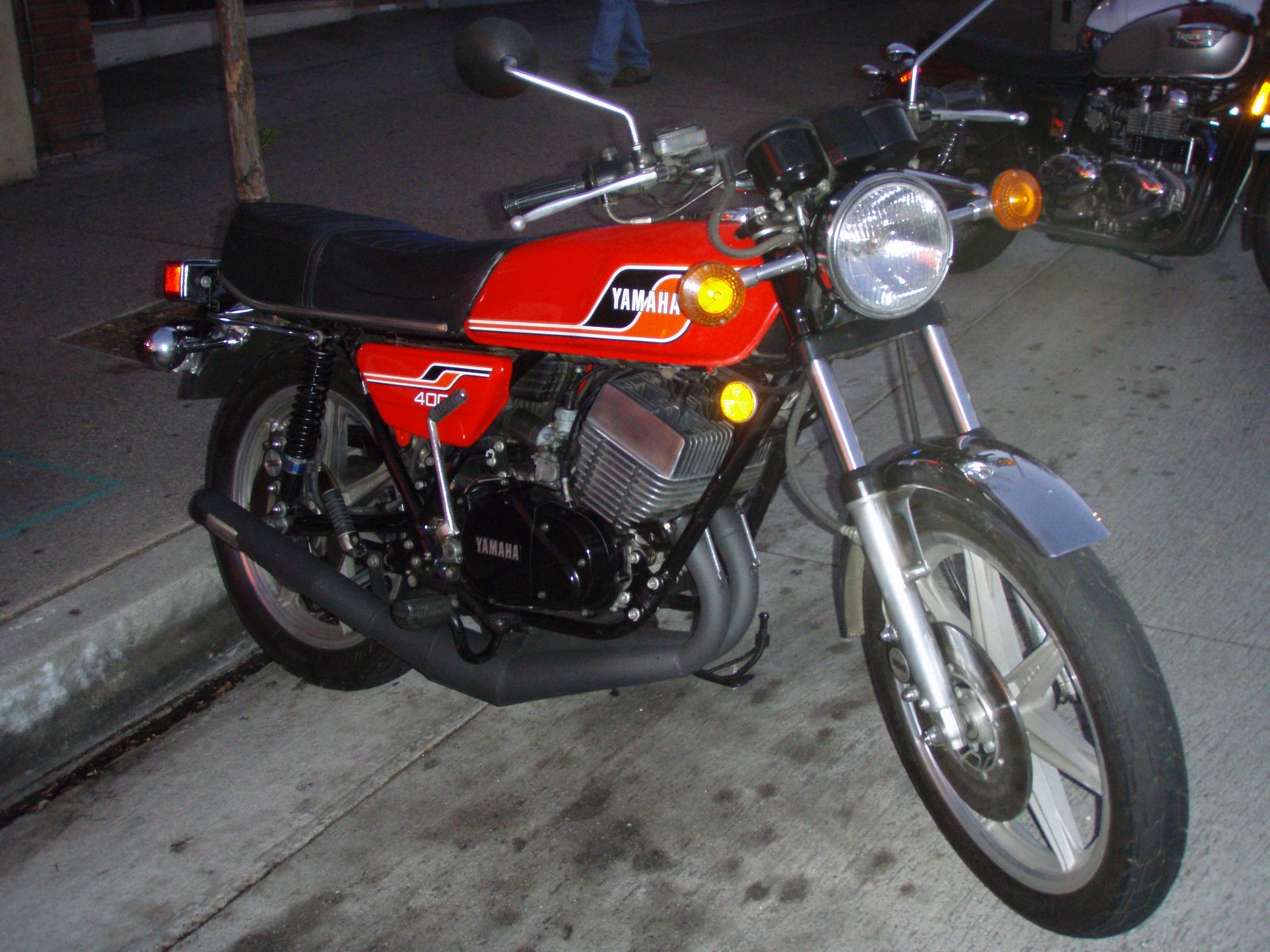

yamaha rd 350/400 pipes look kinda like your originals also.
i would be curious to see inside to see if they are actually straight or if there is some chamber inside of the pipe.
expansion chambers are for performance.
try your straight through style and if it doesn't run good look for some chambers off an rd close to the same cc's as your bike to mod to fit your bike.
just a thought.
just a thought.

- Posts: 7442
Re: 1966 Kawasaki A1 Samurai restoration project
15 Nov 2011 18:25
if you do take some pics if there is anything wierd :woohoo: .
i have always wondered about this.
i have only ever had dirtbikes and banshees and they all had expansion type pipes.
you can have custom pipes built but they can get expensive fast.

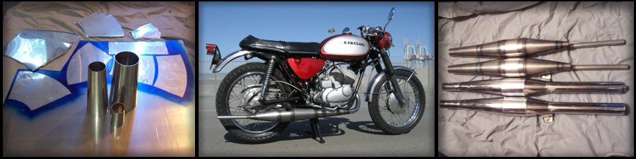

highwaymanpipes.com/?p=8
so that is why i suggested that you find some rd pipes that are for close to the same cc (rd's were built from 125cc through 400cc)and mod those to fit.
if you decide that you need expansion chambers.
