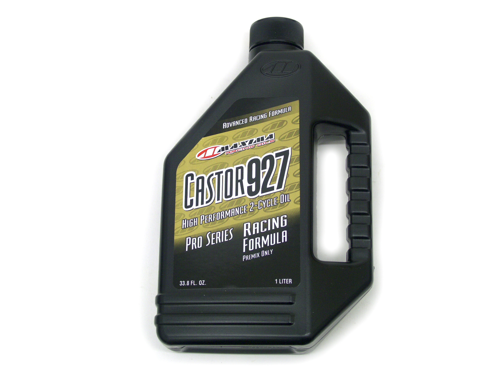

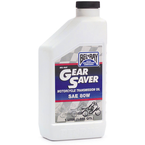

i have had two-strokes my whole life.
i have never had an oil related failure.
i only use
in the transmission.
i only use this
for pre-mix
16oz. to 5 gallons.
i only use
i only use this
for pre-mix
16oz. to 5 gallons.

Thanks for the info. BTW, do you actually use the 80w? Isn't that stick like super thick...or is that the point?

26 Oct 2011 13:33clutch wrote: Thanks for the info. BTW, do you actually use the 80w? Isn't that stick like super thick...or is that the point?
use the GEAR SAVER 80w.(it is thin like atf,alot of folks use atf.not me.i use Gear Saver
NOT the hypoid 80-90 it is the thick stuff you are thinking of.
i am my own machinist,mechanic and rider.
these are the only two oils that i use,period.
everyone has there opinions.
i short track and tt raced for 8 years on a yamaha banshee.
i mix one jug of fuel and use it in every two stroke i own from chainsaws to weedeaters.
blown em up for many other reasons :sick: ,but not oil.
go with my recomendations and you will never have an oil related problem either
or go with someone else's experience and see how it works.
there are a myriad of good lubricants out there,but i tend to stick with what has always worked for me.
thats my .02
