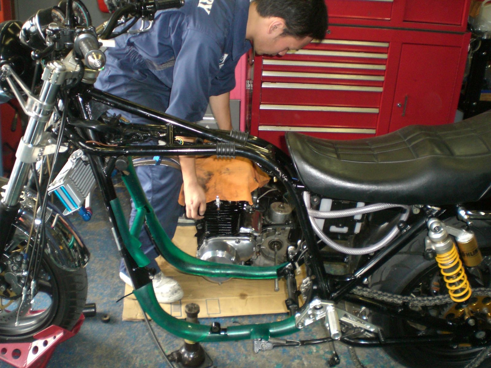

- Posts: 7442
Re: 1966 Kawasaki A1 Samurai restoration project
17 Nov 2011 18:15
here is how the sanctuary guys keep from scratching up nicely painted/coated frames.
some vinyl or rubber tubing split lengthwise and slid over the frame,to protect it.
