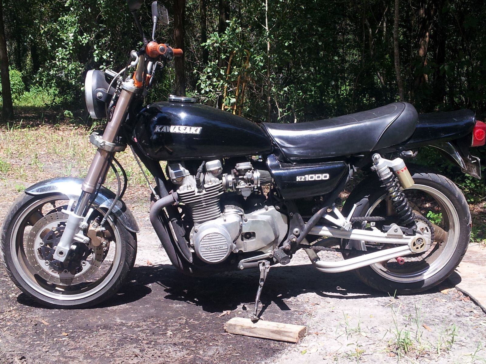

18 Dec 2012 00:09C:\fakepath\20120908_144210.jpg

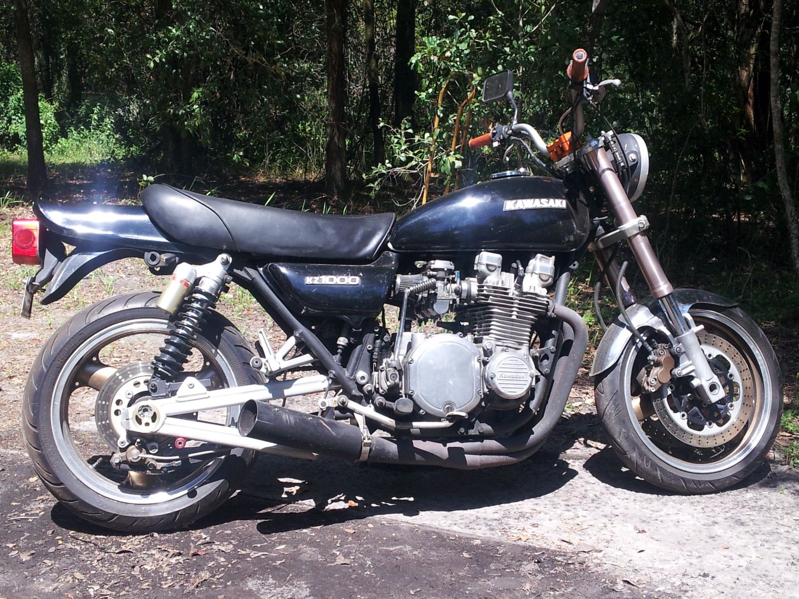

Hello Everyone. I hope you are all well. I have been enjoying my KZ and thought I,d add some pictures.

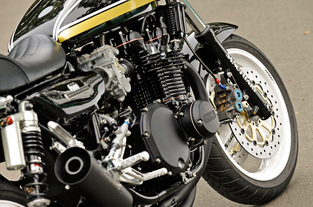

18 Dec 2012 01:41I have a new set of Uni filters now. I plan on getting a real seat, and real exhaust, a rear grab bar and a real paint job.
I have seen the Japanese doing oem style paint schemes with brighter colors or morphed designs. They are athletic and racey but not the same old stock colors.

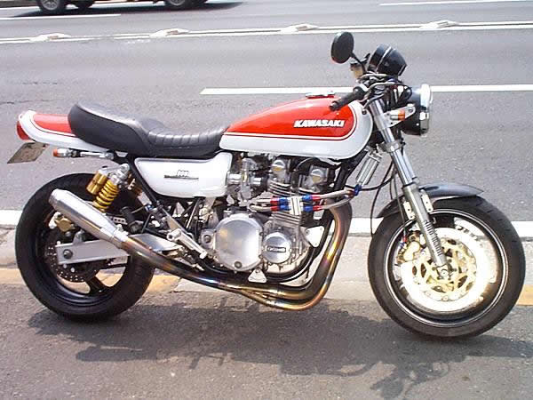

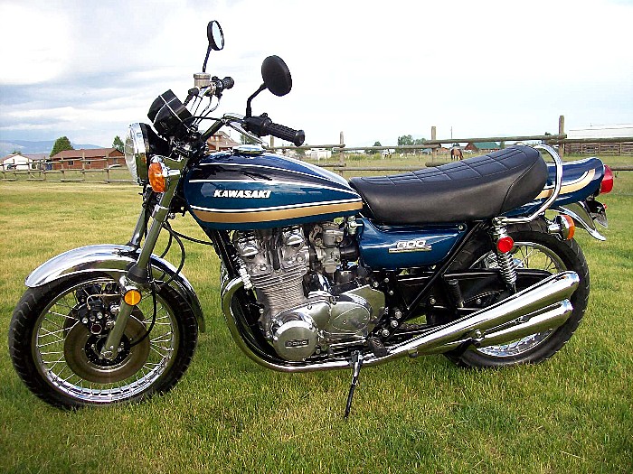

www.a-magic.com/original/cp/or_z1.htm
still love this stuff!
