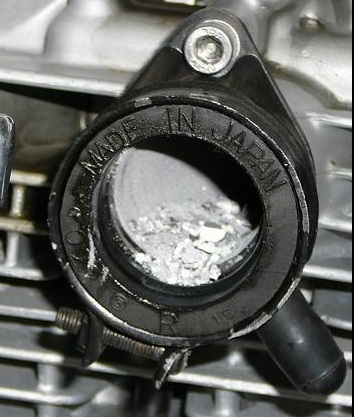

01 Nov 2011 09:19 - 01 Nov 2011 09:20Old Man Rock wrote: ... What punched the hole in the cases? ... head exhaust port shows signs of aluminium dust but no pieces as seen on the intake port... how the hell did this get in here (intake)....
Be interesting to see condition of the intake valve seat, as valve was perhaps blocked open by piston debris which allowed remnants to pass "backward" into the port.
Any parts missing from #4 carb?

Maybe, a manufacture defect in the piston?

The scrap metal on the intake side - that may make sense. Once the piston performed its vanishing trick, there's no downward motion of that piston to draw air in - so when the valve opens you have slightly positive crank case pressure that's going to exit the easiest way it can.
I'm curious about what you find when you do tear down fully - I still can't understand how the darned piston just disappeared without the valves being trashed....

04 Nov 2011 10:53mtbspeedfreak wrote: I wonder if an oil passage was clogged on the RH side of the case/block?
That usually takes out the cams & bearing inserts. Having ventilated a few sets of cases in my day, it looks like maybe the pin seized /galled /failed & took out the #4 hole...$.02 CDN., not valid in Quebec.
