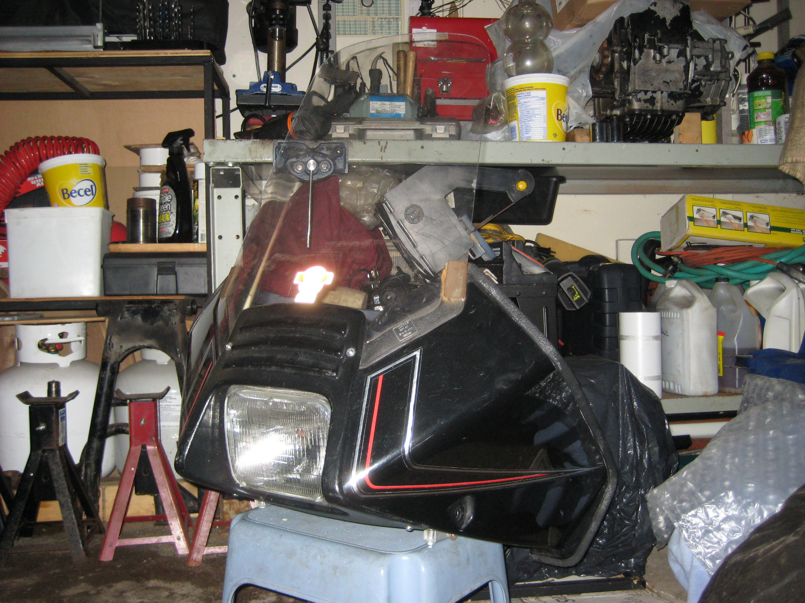

A couple of weeks after I brought this home I found a used 1982 Vetter Quicksilver fairing without the mount frame for $40 local to me. This is how the touring idea started.

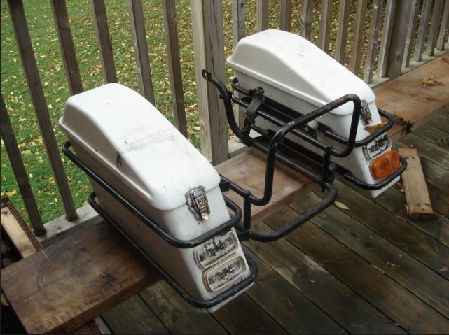

It took me a while (2 years) but I eventually found some used 1980's? Shoei hard bags local to me for $40.
I got the bag frame mocked up on the bike and welded up a luggage rack using that frame as a base.

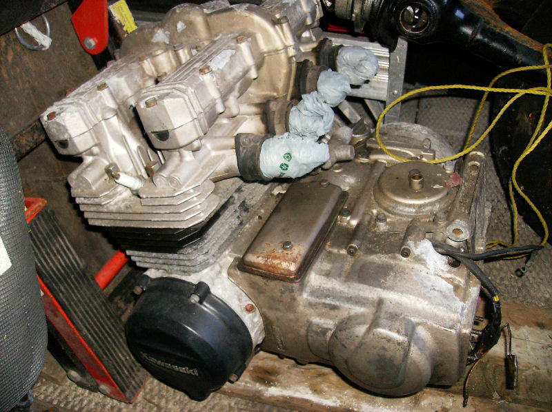

After searching locally in 2018 I quickly found a 1982 KZ750 Spectre engine complete for $160. Upon picking up the engine the guy also sold me a spare head and barrel for another $20!
