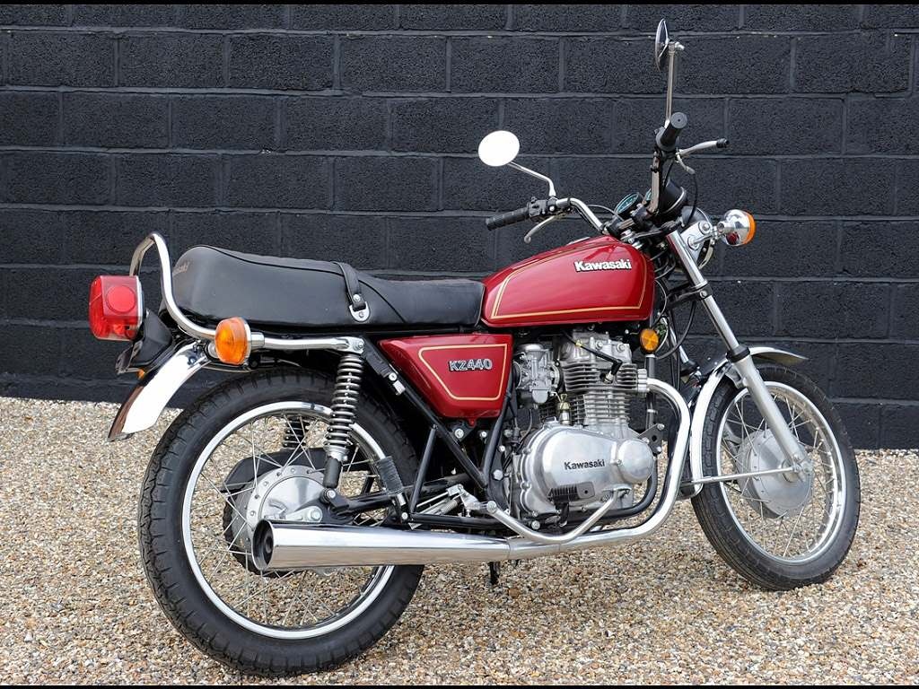

This is strange, muffler blocks bolt removal... any images I look at of kz440 show muffler forward of bolt.

I am fairly sure that most of the non-LTD versions had mufflers that extended beyond the axle.
Like deez won.
