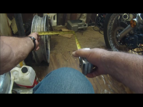

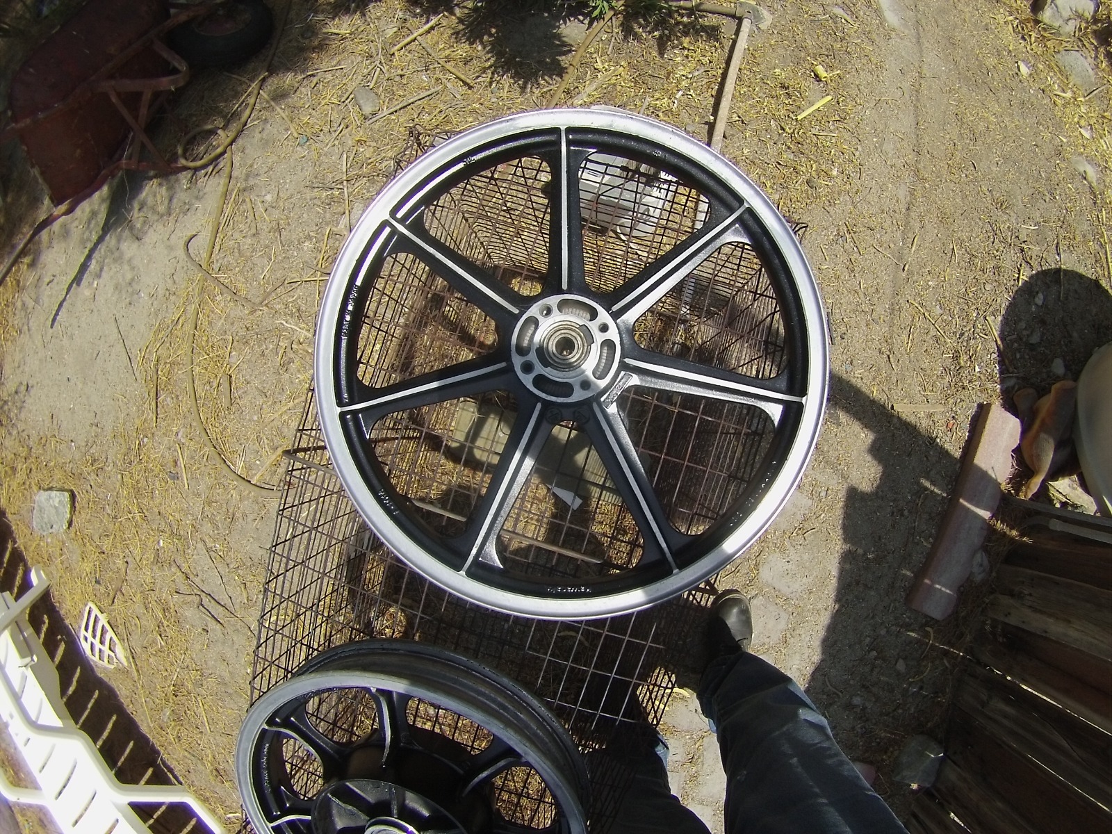

I like wire wheels. I don't care about the loss of the rear disc brake. I also don't care about the loss of the 16 inch rear wheel.
Anyone ever done it, or know enough about the two bikes to suggest how to do it?
Thanks and happy Sunday.

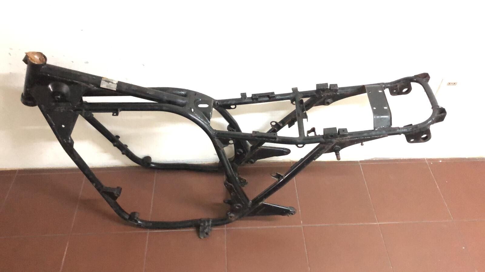

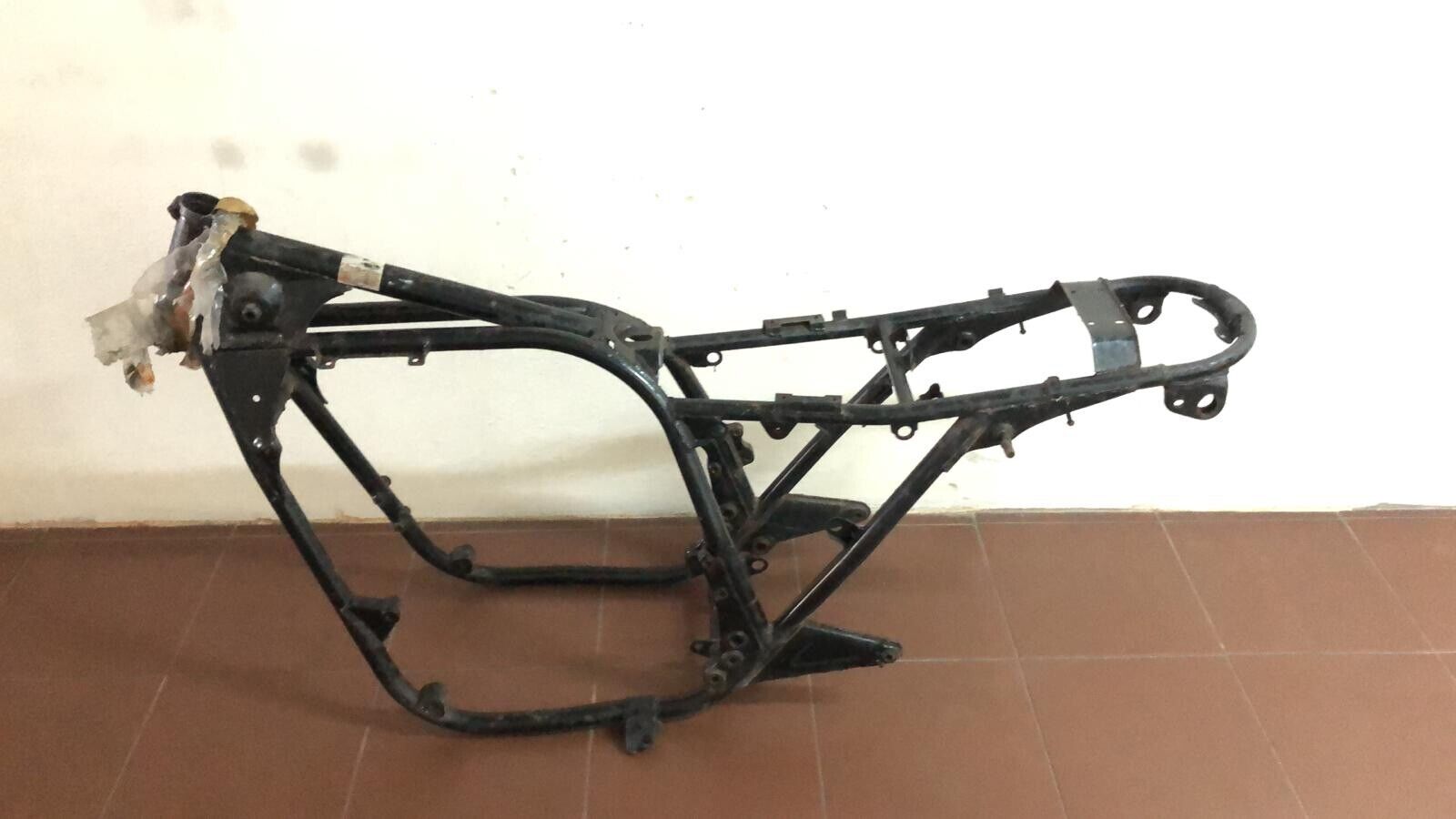

Here are photos from auctions for an SR and B frames. The brake level busing looks to be in the same place.

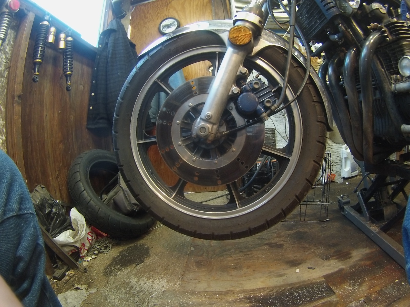

Thanks to everybody here, last summer I added a front disc to my KZ650B milk crate bike. So that would be an easy swap I think.
Did the mighty Kaw ever offer a wheel/hub/ in 18 with a rear disc? That would be very very cool if they did.
Before someone jumps all over me this is when the bike was still single disc.
