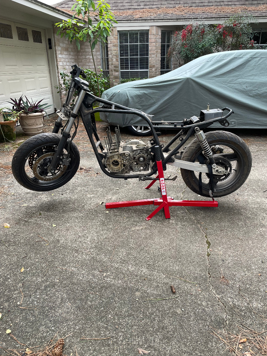

Welp, the first thing I had to do was to take it all apart, because, um, you know, because.

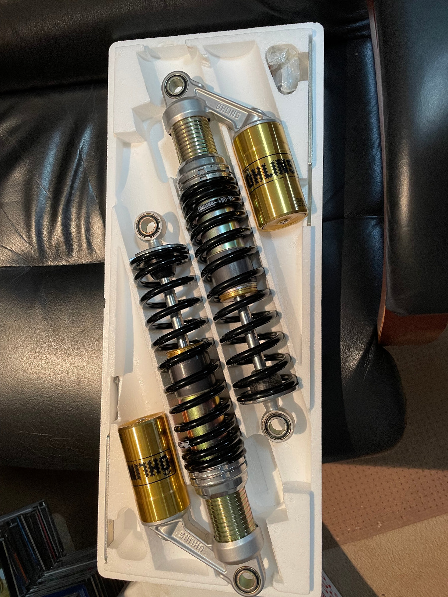

Next I figgered some better suspenders were in order. First, my buddy that I bought them from offered me a GS1100 swingarm that he had saved for a three-wheeler project that he had lost interest in. I decided to have it modified to take KZ style shocks, because, you know, because. I then ordered these--

Clearly, something had to be done with those wet-noodle LTD forks. I reckon some 90 wight oil could have done the trick, but why bother with simple and cheap when I could spend a pile of money on something much more complicated, like the forks, triple clamps, stem, handlebars, wheels and complete brake system from a 1995 GPz1100?

I am sure some of you wise guys are thinking, well, with that wider rear wheel and the 530 rear sprocket, sumpin aint gonna work so well at the output shaft end of things. If you look closely in the last picture, you may see a front sprocket from and early 1100 Ninja that seems to solve the chain pitch and offset difficulties.
