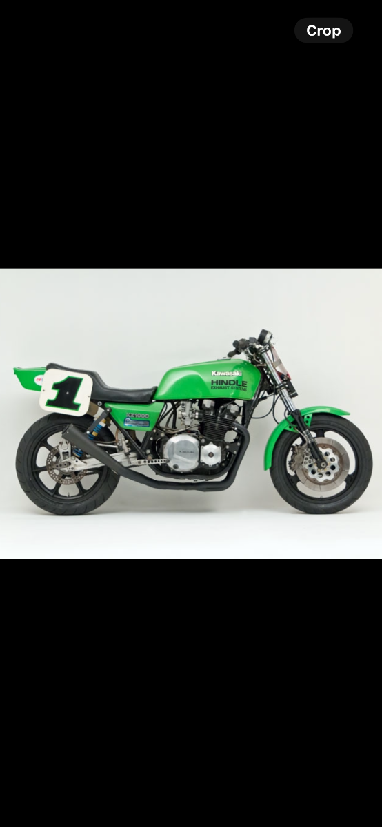

I am stoked.
I have been ruminating over what exhaust system to get. The Delkevic system seems nice and is popular and is very reasonable priced, but.........
Webike has a titanium system that gives me goosebumps, but I have no idea how it performs and the price makes my knees wobble.
Then there is Hindle. Designed by a guy who actually races these old beasts. A true 4-2-1 system. Lightweight stainless steel. Kinda wish the muffler came up at more of an angle and wish it was just a touch less expensive. Wonder if it is too quiet. Noticed that their website, well actually the Ripple Rock Racing website, that they list three KZ1000 models and wondered if there were any differences, so I called.
YEEEEHAAAAW! Actually, they make two entirely different systems, one of which I did not see on the website. After chatting for a bit, I decided I should just explain what I am building and its intended use, and let him recommend something. Welp, I am getting a slightly modified race system with stepped primaries and an upswept muffler with a street-ish baffle in it.
Oh, and all this for considerably LESS money than I expected. He even sent me a pic of the system on Brock's super bike.
I wish my bike was ready to install this thing and fire it up.

I apologize for breaking the cardinal rule.
Here is a pic of the system on Brock's bike. My system will be brushed stainless rather than black.
