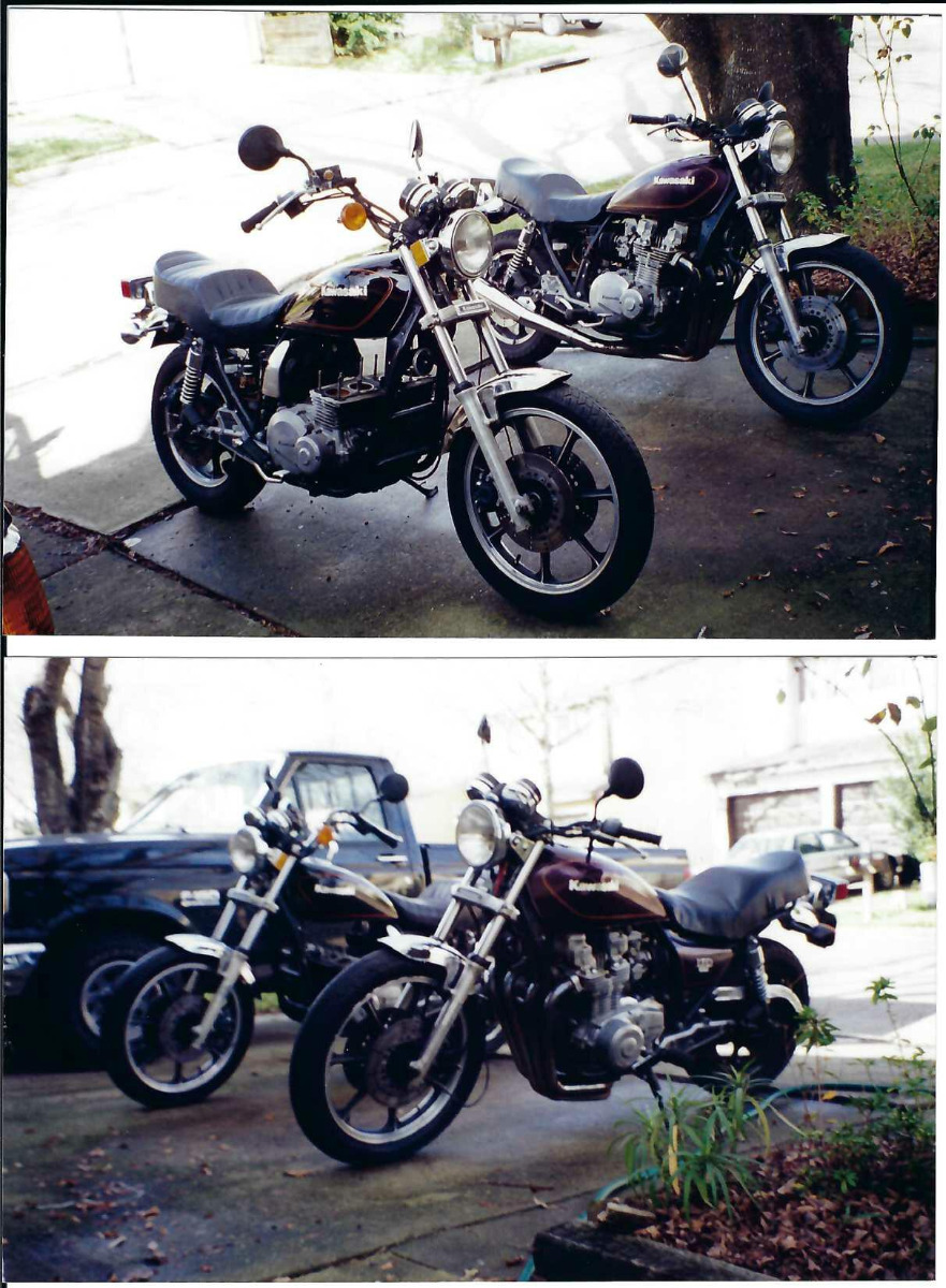

The purple one would start, and it had a badly abused Kerker system and 29 smoothbores on it, so I could have easily freshened it up an juts rode it as it was. But what is the fun in that?
Honestly, much of it would have had to come apart anyway. The fork seals were long gone, and all the fork oil was on the front brakes and all over the engine. The cam cover gasket was leaking so much that the po had tied a couple of shop rags on the frame cross member to catch some of it. The chain and sprockets were several thousand miles past needing replacement. the exhaust system was fairly well smashed on the bottom and about 20% of the chrome was peeling. Et cetera.
I began to slowly disassemble, taking note of what needed to be repaired or replaced, carefully bagging and tagging as I proceeded.
I bought the bikes from a friend who owned a repair shop. Both had been brought in for repairs, then abandoned. As you can see, the shop had already begun parting out the black one. Th owner of the other one, finally decided to cut his losses and brought the title to the shop to have them sell it. I began talking to the shop owner, and his mechanic who had built a number of drag race KZ engines, about what I wanted to do. I decided on a mild performance upgrade of the engine, consisting of a Wiseco 1075 kit and some bumpier cams. I also knew that I wanted to improve handling and braking, and hoped that i could change the wheels so I could use more modern tires. I was in grad school at the time, so money and time were not plentiful for me. Every now and then, I could purchase some parts, slowly adding to the collection.

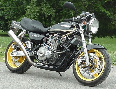

I knew that I needed a clearer picture of the end result, so that I could make rational decisions along the way. I began poking around on the interweb and finally stumbled across a website belonging to a fellow in Indianapolis, who had a modified KZ1000 that really caught my eye.

I don't love everything about it, but he really inspired me. I continued poking around, looking for more ideas, and stumbled across KZR. My checkbook may never recover.
