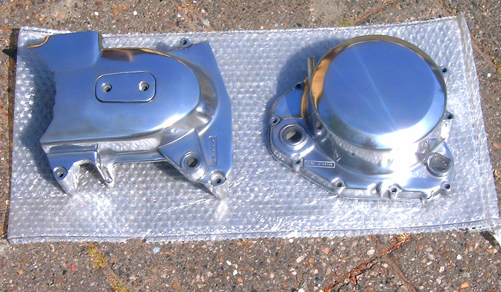

My covers weren't deeply gouged but had a few nicks.
Started out with a sanding disc (120 grit) in my electric hand drill to take out the nicks.
Once the nicks were gone an obscene amount of hand sanding followed: 240 dry, 400 dry, 600 wet, 800 wet, 1000 wet (don't forget to change water and wash the parts with every grit change) - all this to gradually make the sanding marks finer and finer.
Last step before polishing was a soda blast to remove the last traces of the 1000 grit and any possible leftovers from the sanding paper.
Then I stuck my hand drill in a vice and used three different cloth wheels for polishing: first one with a red polishing compound (block), then one with a finer white compound (also block), again don't forget to clean the parts (solvent) when switching compound and wheel.
Final touch was a polish with Solvol's Autosol for the mirror shine.
Here are the covers after the soda blast :
And after the final polish - points and alternator cover got the same treatment along with a few other bits (fork lowers, calipers, swingarm etc.):
A few things to consider when polishing with a wheel:
- Mask off your working area, polishing compound et al will be flung around and make a mess. I used some cardboard and duct tape to make an improvised polishing cabin around the hand drill/wheel.
- The wheel should spin with the top towards you and the bottom away from you.
- As you would on a lathe, always work below the center of rotation or nasty things can happen.
- Be careful around the edges of the part you're polishing. If the wheel catches on the edge it will rip the part out of your hands and set you back 5 or 6 steps in the process when your almost finished part hits your garage floor (don't ask...) Always work from the inside towards the edge, never from the edge and inwards.
- Wear gloves, polishing develops a lot of heat. Work gloves initially, cotton gloves for the final polish.
- Some kind of face mask is practical. As far as I know polishing isn't toxic but it will make your boogers go black for a week.
- Mandatory: wear eye protection. Being hit in the eye by a piece of polishing compound is no fun, I learned that the hard way.
Here's a nice article from Caswell Plating: CLICK
Btw, next time I think I'll just paint the covers black.....
