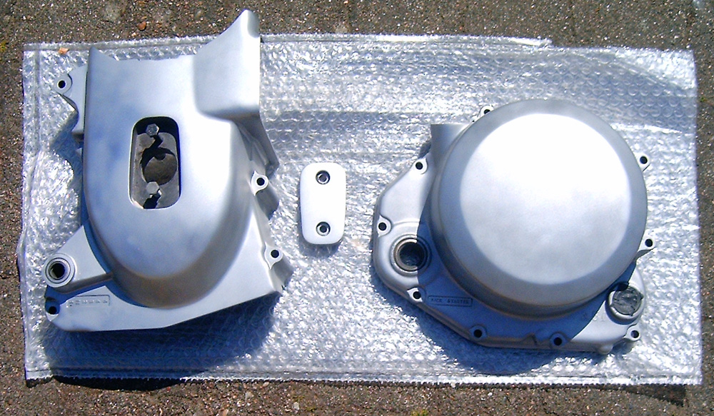

My covers weren't deeply gouged but had a few nicks.
Started out with a sanding disc (120 grit) in my electric hand drill to take out the nicks.
Once the nicks were gone an obscene amount of hand sanding followed: 240 dry, 400 dry, 600 wet, 800 wet, 1000 wet (don't forget to change water and wash the parts with every grit change) - all this to gradually make the sanding marks finer and finer.
Last step before polishing was a soda blast to remove the last traces of the 1000 grit and any possible leftovers from the sanding paper.
Then I stuck my hand drill in a vice and used three different cloth wheels for polishing: first one with a red polishing compound (block), then one with a finer white compound (also block), again don't forget to clean the parts (solvent) when switching compound and wheel.
Final touch was a polish with Solvol's Autosol for the mirror shine.
Here are the covers after the soda blast :
And after the final polish - points and alternator cover got the same treatment along with a few other bits (fork lowers, calipers, swingarm etc.):
