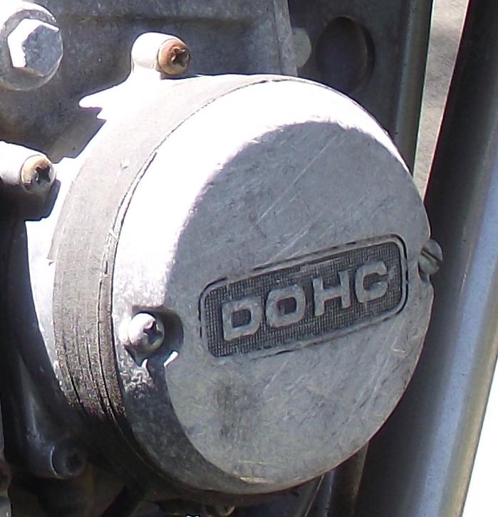

Here is one side, the other side is about the same.
Sorry for the poor phone pics
Maybe I should add that they have already been polished at one time, I have only kept them cleaned and hand polished with some Mother's cause I was afraid of scaring them even more. But I really want these scratches out!

without polishing tools just start sanding wrap a piece of sand paper around a paint stick put a towel in your lap and sand while watching the speed channel
gradually getting finer with the paper until you get to 2 or 3k grit
I keep a spray bottle and sand wet but I dont really think it matters
jmo
it will look worse before it looks better

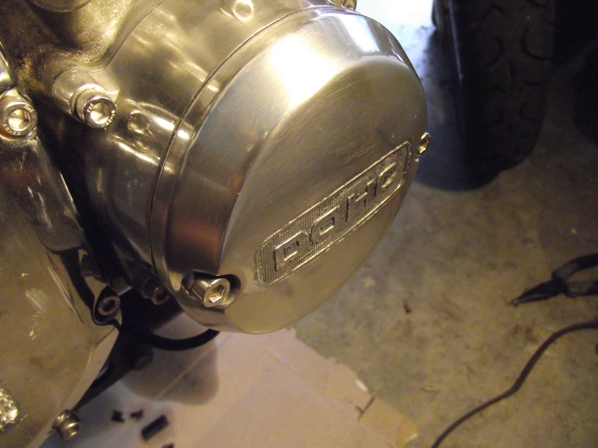

Everything everybody said about the sanding process. But you may have to start with a fine metal file. Use light pressure because because you want to avoid getting file marks which are still a pain to sand out as you can see from the second picture below. You can the cover was gauged up pretty good from a fall or crash. With enough force that the points housing had a piece missing (therefore the black tape). Replaced the housing but saved the cover.
